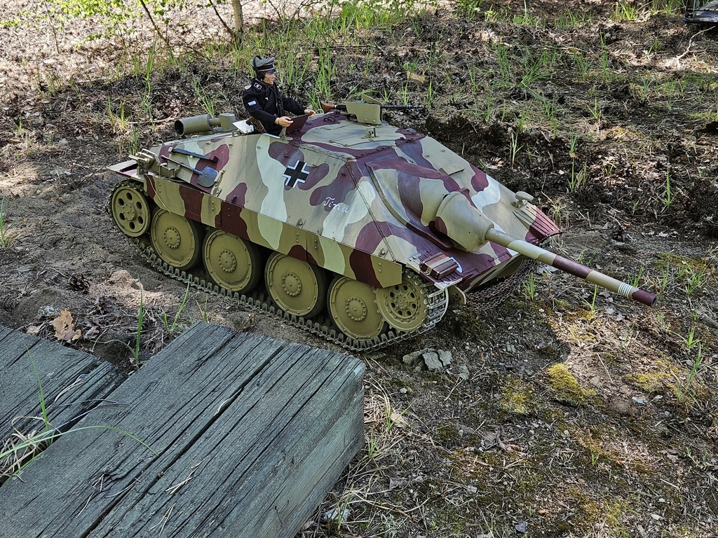

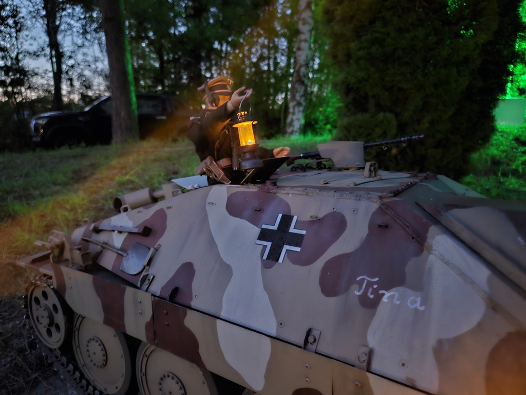

al long time there was not really any kind of update of the building process here. This was because of personal trouble and the time pressure to finish the Hetzer for his first engagement.
I promise I will fill the gaps in the building documentation, but here a the fist pictures and some small videos from the RC meeting in Röthenbach an der Pegnitz here in Germany. It was a great meeting with a nice team onside. Many thanks to the Modellbaugruppe Röthenbach an der Pegnitz!
