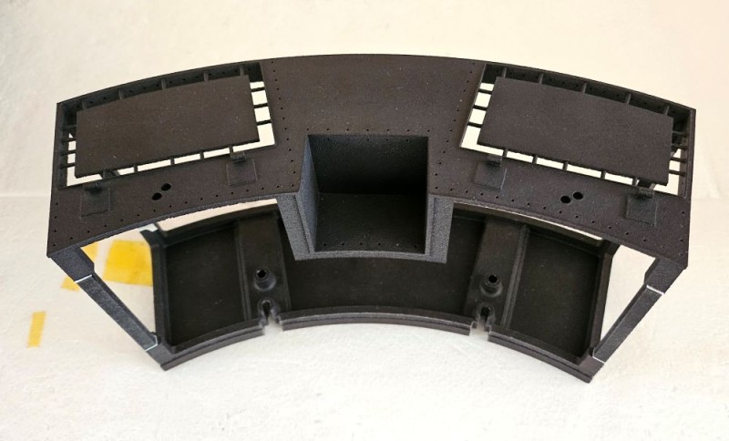

Although I have a Sixth Scale Icon brass kit I have decided to go the 3D print route for better durability. The first thing to tackle were the lower supports. Using drawings from Tiger 1 info I marked up and drilled new holes for a revised fixing that mimics the actual lower bracket but provides more support and allows the bin to be removed by sliding it upwards.
Drilling holes in correct location
Lower supports
Supports in situ
The bin floor is designed to be quite stiff, lock into the supports and allow the use of 30 thou Plasticard skins for the front, sides and rear of the bin.
View of the floor from below showing how the supports mimic the prototypical brackets when the bin is fitted.
That's all for now...
Alastair

Interesting idea for bin. What material are you using for the printed parts? Your details are really good. Enjoying your build.

The material I use is Nylon PA12. The printing is out sourced to ensure consistent quality and high resolution. The company can turn round the order in less than a week :) . I usually specify black so that should the paint wear off in the future I get a reasonable weathered look.

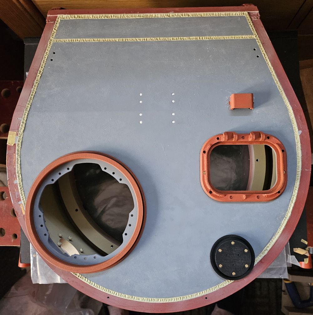

Update 9 Mar 25
Painting the turret interior.
As with the chassis, I have decided to paint it Elfenbein (RAL 1001). So, on top of Upol Acid #8 etch primer I airbrushed UMP oxide primer in the nooks and crannies, then used Halfords red primer.
Once dry, several light coats of AK Interactive RC046 were applied…
Note the deliberately mottled coverage intended to give a weathered appearance. The Interior is now ready to be fitted out.
Roof supports
Rear support epoxied in place…
All supports in place…
Roof welds
‘Trough’, formed by upper steel sheet and Evergreen angle epoxied to outer edge, filled with Milliput…
I decided to start with the straight sections and ‘stiffen’ them up with the welds before tackling the curves. Cling film used to stop Milliput sticking to the turret and ease roof removal when putty has set.
Finishing off the ‘trough’…
Getting there…
Next job is to secure the cupola base ring and apply some weld detail. (Note: I will be replacing the cupola, see below)

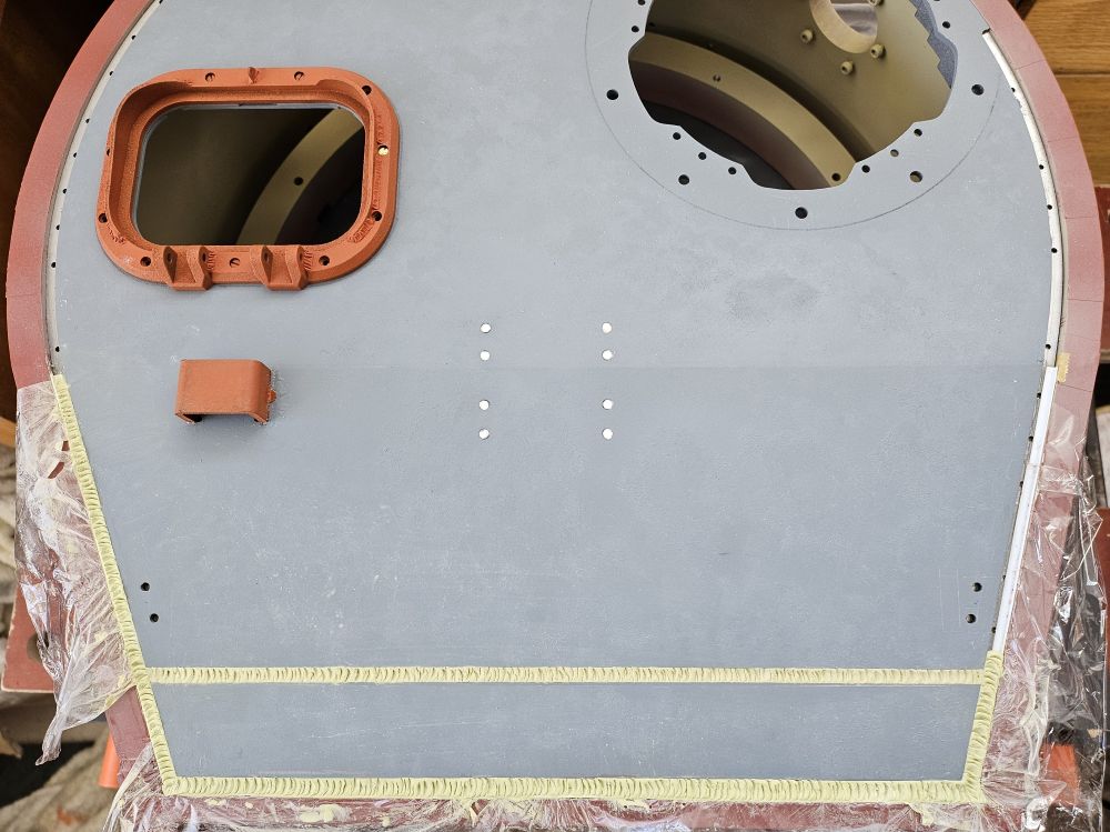

Update 19 Mar 25
The cupola base ring weld is now finished. Once completely primed the ring will work with the roof plate to give the impression of the actual cupola mount (Reference: A Modern Study of Fgst. NR. 250031, Pg. 40, Fig 115).
At a quick glance it looks like the ring is welded to the turret wall. In fact, it is part of the removable roof plate. I plan to do something similar with the towrope/cleaning rod holders as they reach the outer edge of the chassis side plates.
Track hanger hinge points installed and epoxied in place…
Major roof welds complete on both chassis and turret...
Escape hatch

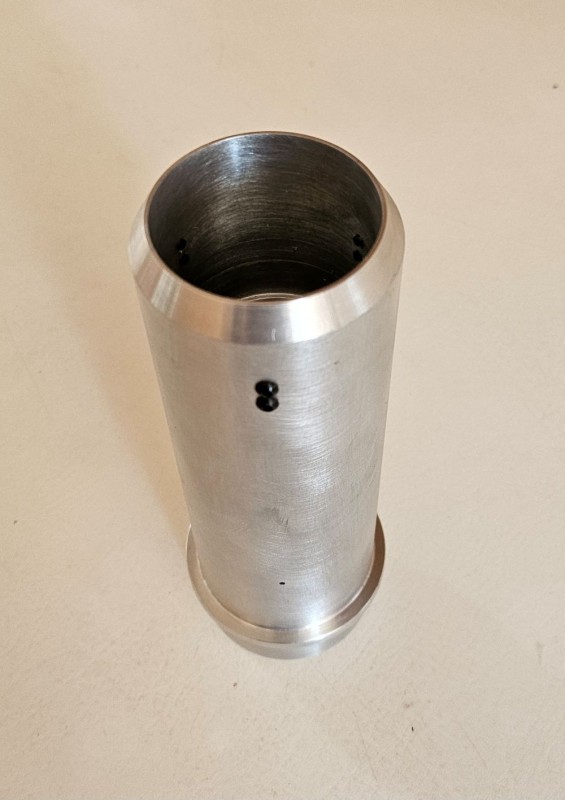

Recoil sleeve
The sleeve can be improved with a few tapped holes and a single drain hole. The actual tube uses cheesehead bolts to secure a rubber seal. However, I decided to use slotted grub screws as it would avoid having to counterbore or countersink the holes. In addition, I could use a slightly larger tap.
A job for my rotary table. The wood acts a chock to stop any downward pressure from dislodging the work piece.
M2.5 button head screws used to protect the threads whilst I acquire some grub screws.
I took advantage of having two photo-etch frets to split the sleeve locking washers into two parts…

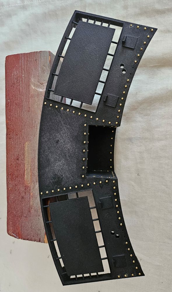

Turret bin
Preparing another replacement part :wink: I needed to loosely assemble the internal skeleton for the bin to check that it can be slotted in place around the rear lift lug. (BTW I have a brass Sixth Scale Icon turret bin kit that is now surplus to requirement.)
Rivet detail added to top piece…
Primed ready for assembly…
(Note that I have included filler pieces for the bin apertures to prevent the part distorting during printing and assembly. They will be cut out when the bin sides are secured.)
