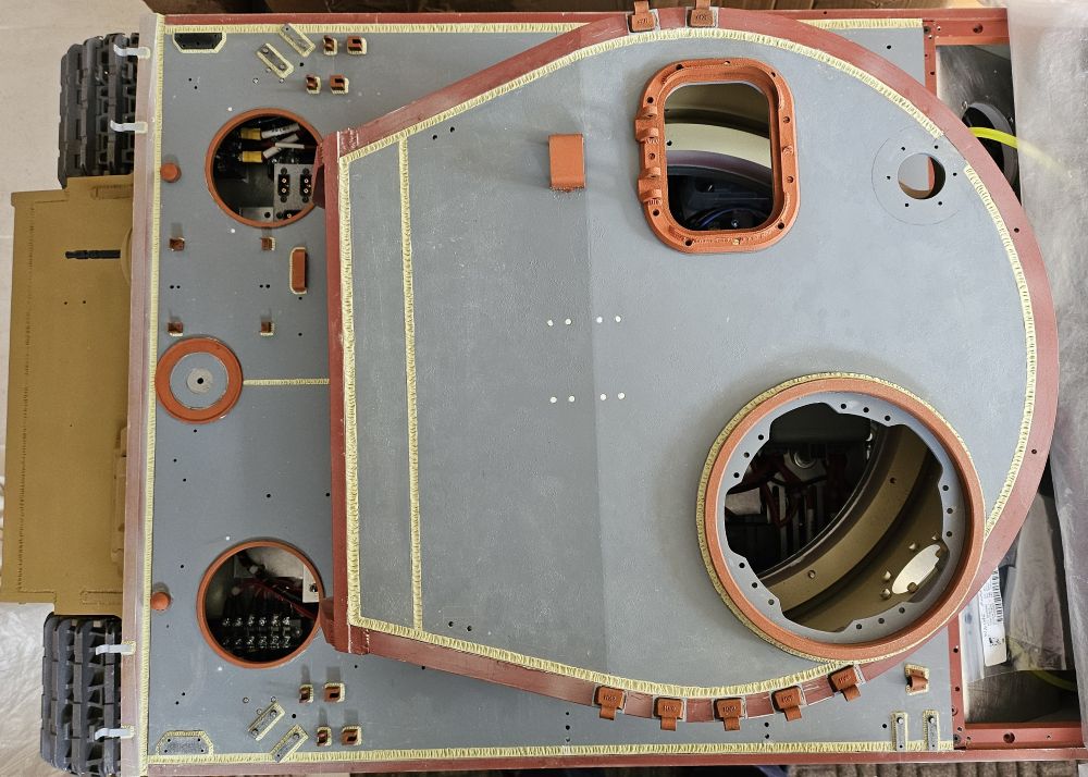

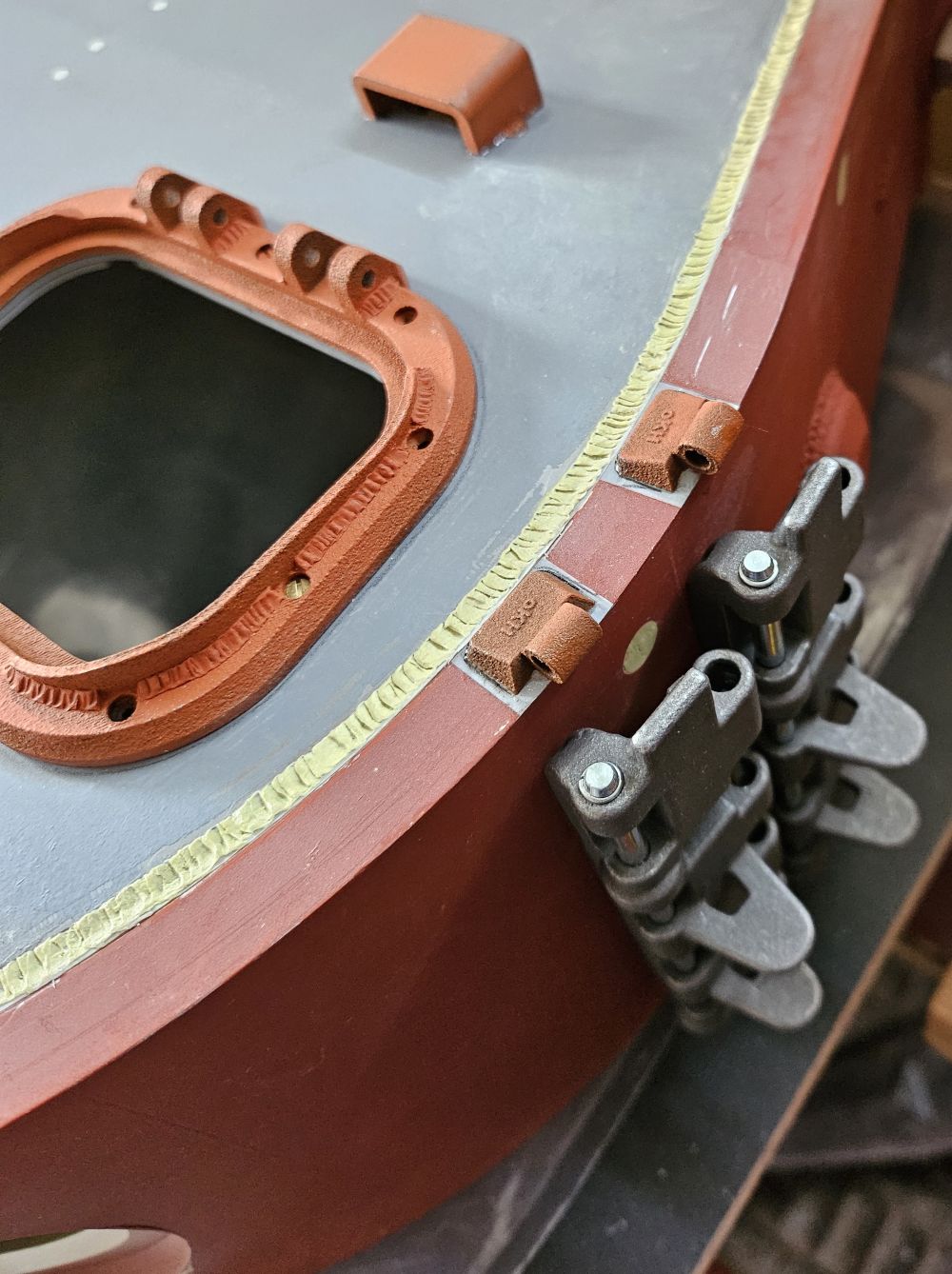

Update 19 Mar 25
The cupola base ring weld is now finished. Once completely primed the ring will work with the roof plate to give the impression of the actual cupola mount (Reference: A Modern Study of Fgst. NR. 250031, Pg. 40, Fig 115). At a quick glance it looks like the ring is welded to the turret wall. In fact, it is part of the removable roof plate. I plan to do something similar with the towrope/cleaning rod holders as they reach the outer edge of the chassis side plates.
Track hanger hinge points installed and epoxied in place…
Major roof welds complete on both chassis and turret...

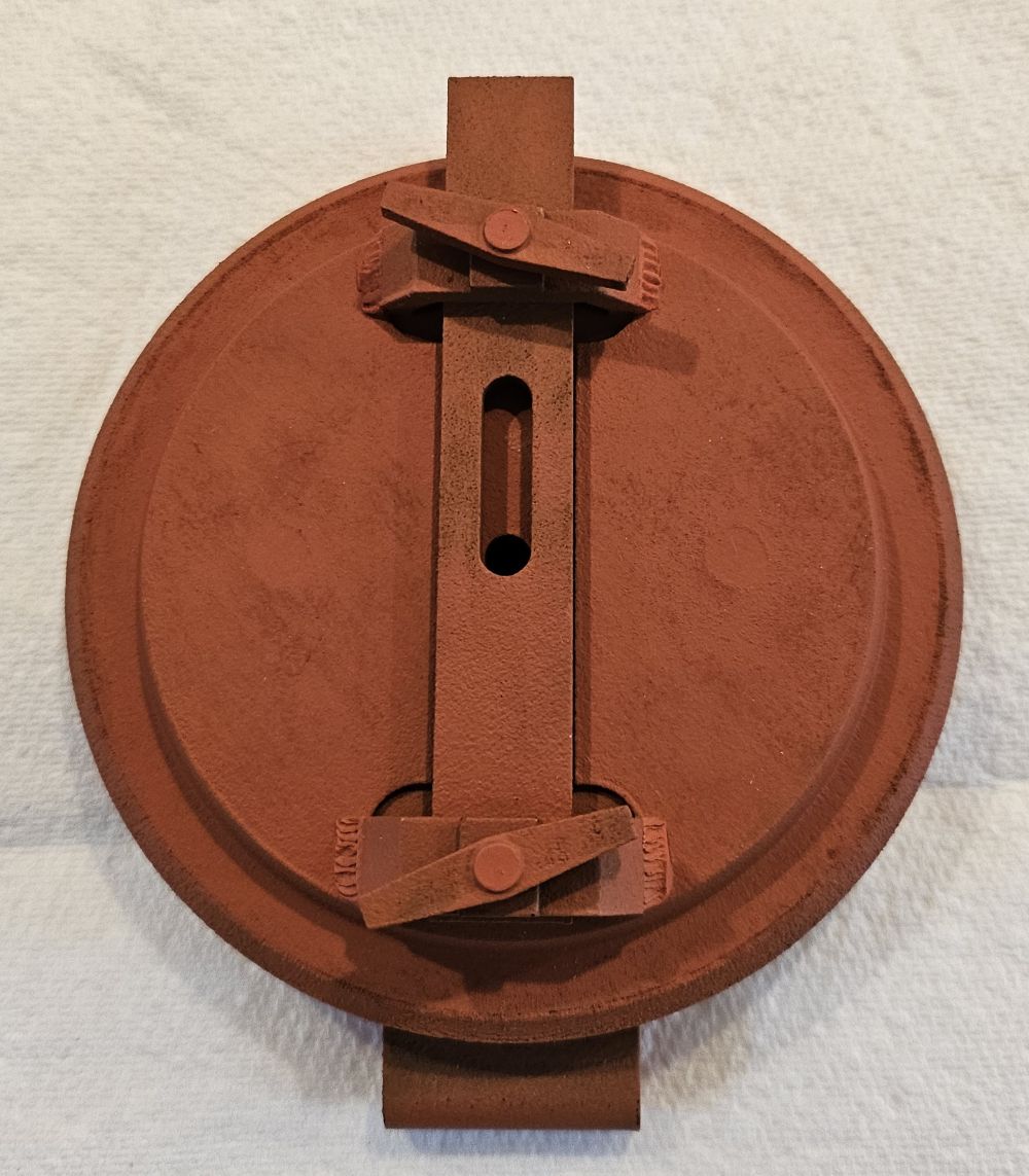

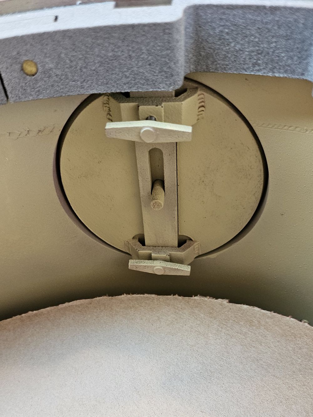

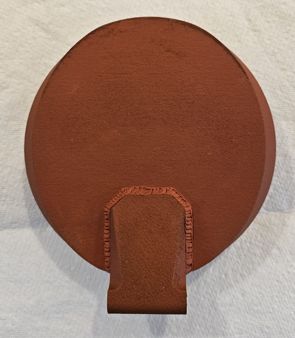

Escape hatch
Replacement hatch finished and primed. Ready for base coat on the inside and Zimmerit on the outside… Trial fit with interior base coat applied… The peg for the locking bar will be installed permanently when the hatch is fitted. I have decided against making the hatch functional as it would require a notch cut into the turret side. There is no real need for the hatch to function as I have very little internal detail, just loads of electronics, and I am not sure if the required notch would be prototypical.

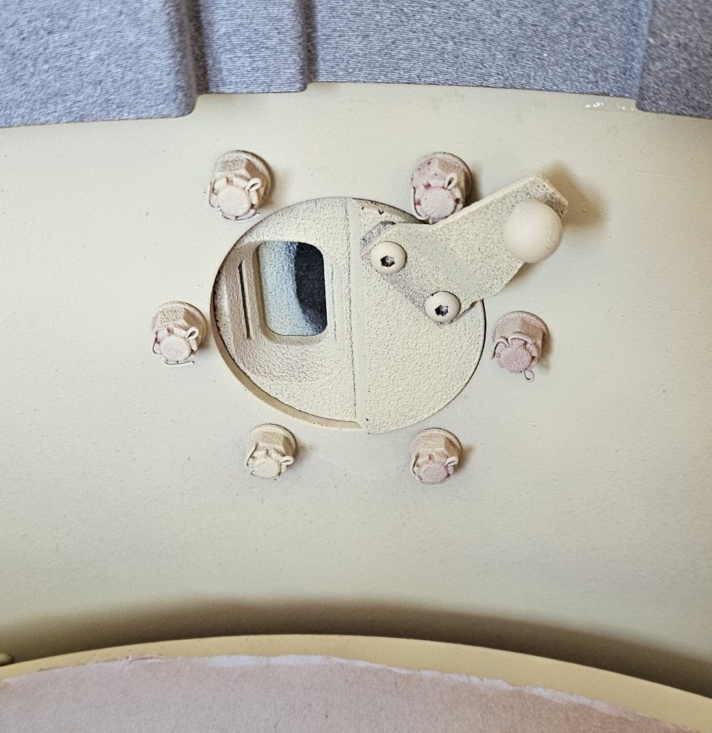

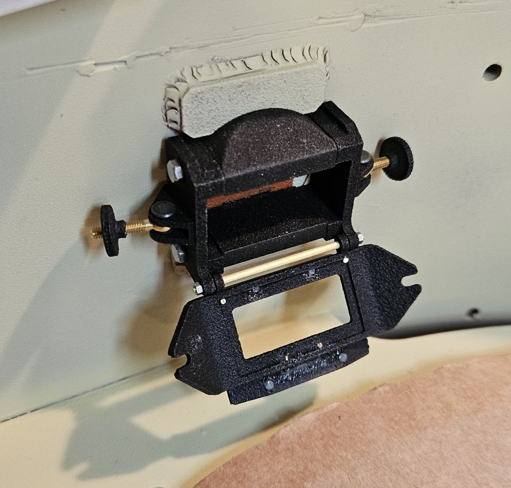

Pistol port
Trial fit of internal detail… Just needs a touch up with Elfenbein and some scale fasteners for the rotation handle.

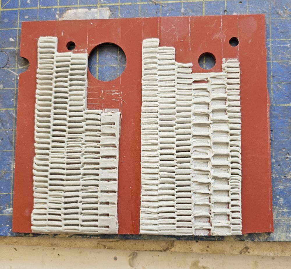

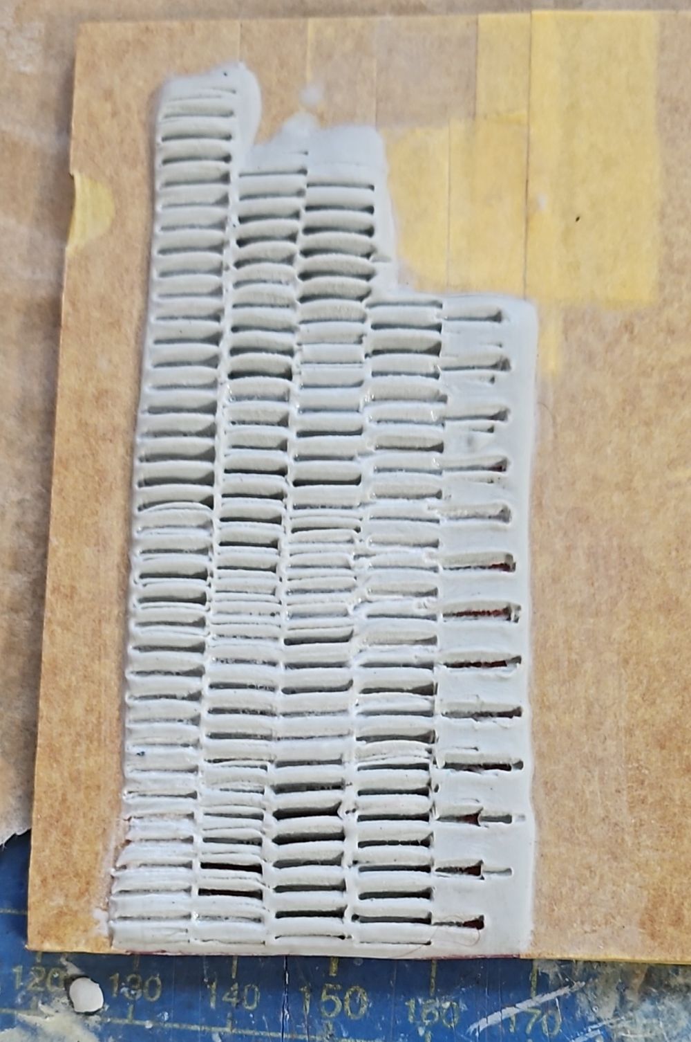

Further Zimmerit experiments… Did not like the pattern left by the ‘larger’ tool so I redesigned it… And got a better result… About ready to start on the turret

Pistol port

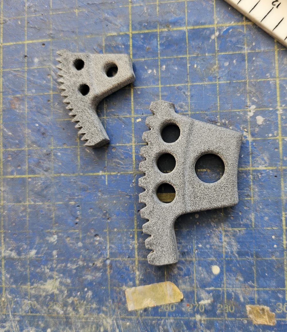

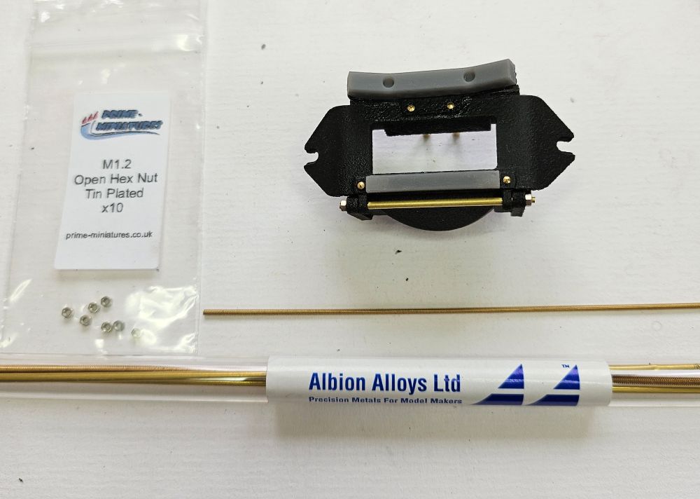

Update 27 Mar 25
Turret vision blocks
I treated these as detailed ‘standalone’ models even though they will only be visible with the roof removed. I wanted to try out the combination of MJF Nylon PA12 plates with SLA resin head pads in preparation for the cupola vision ports.

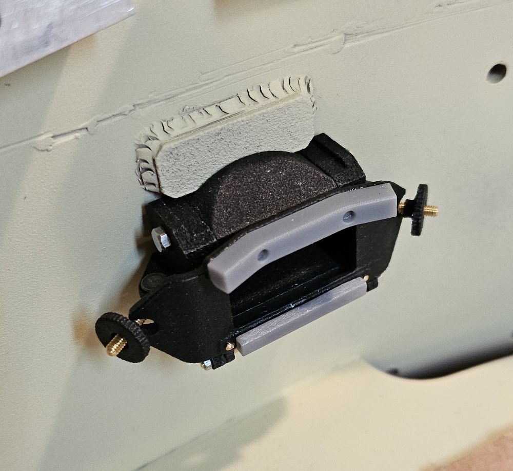

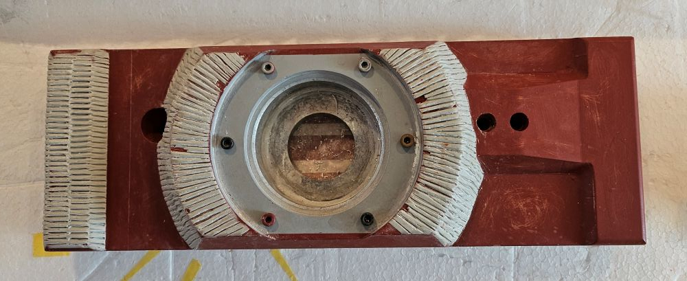

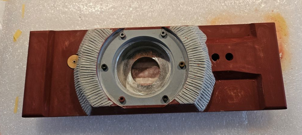

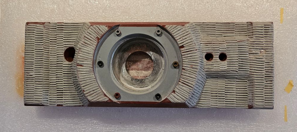

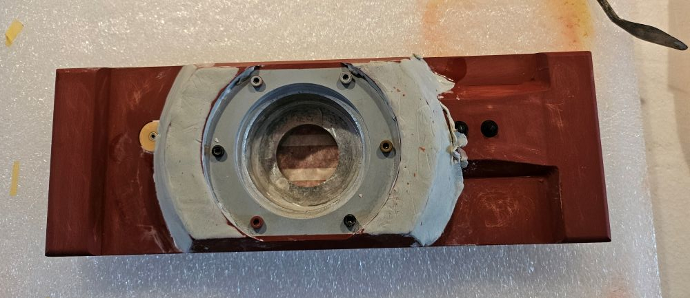

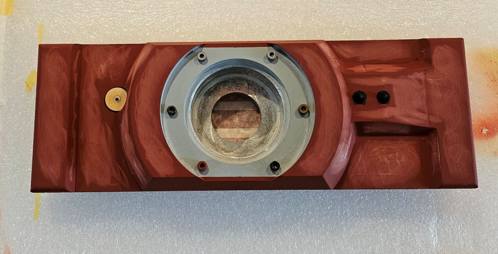

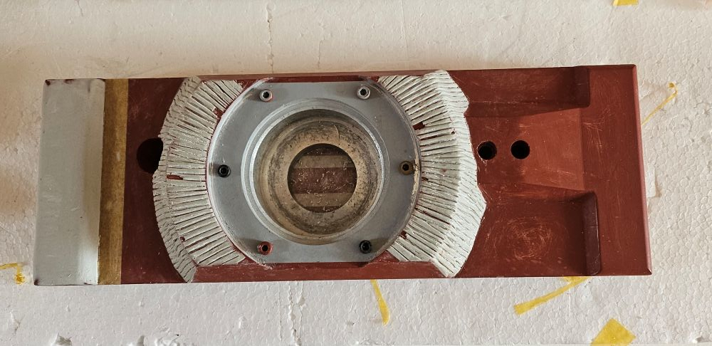

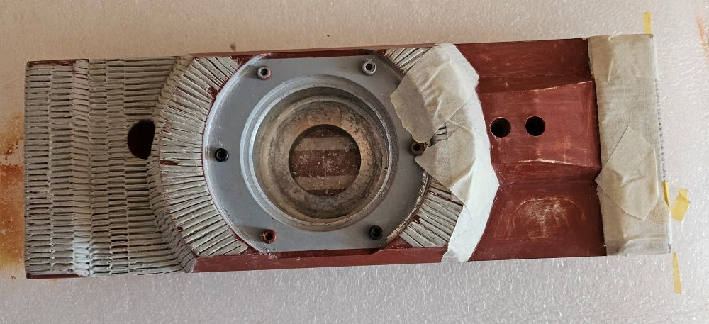

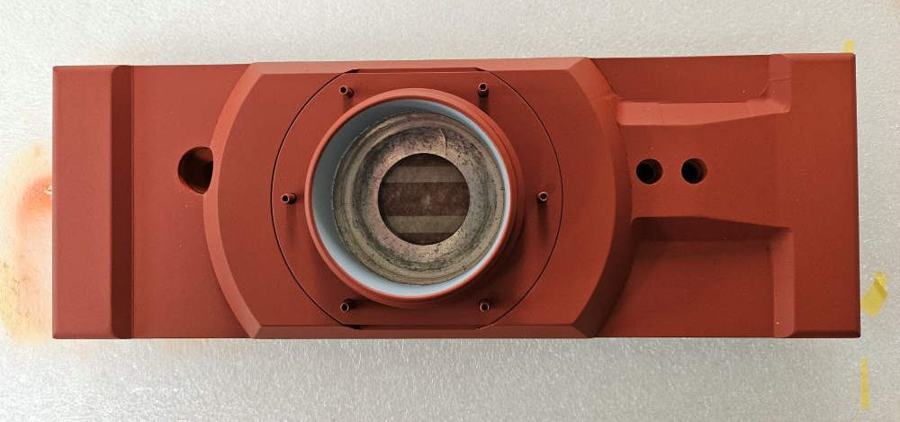

I have decided to leave the vertical turret sides until last. So next up is the mantlet as I can apply the Zimmerit with it flat on the bench. First a coat of red primer as this provides a good contrast with the grey Sylmasta Magic Sculp. (Note: grub screws were used to stop paint getting into the threads.)
I decided to use this putty as I ‘rediscovered’ some 500g tubs languishing in my ‘stash’. They were bought, probably 8 to 10 years ago, in anticipation of some large-scale figure modelling that is firmly on the back burner whilst this Tiger 1 adventure continues. The putty does not seem to have suffered as the tubs had never been opened.
Surface scuffed to help the putty grip… Coat of putty applied. I am working on small sections at a time and will allow the putty to harden before progressing. That way the pattern is less likely to get damaged whilst working on other areas. Central section covered in putty to a depth of about 1mm… Basic pattern applied, will finish it off when the putty has hardened.
Working on the next section… Texture added. Again, I will emphasise the grooves with a micro chisel when the putty has hardened.
Getting there… (Note: Masking tape applied so that the putty can be worked into the surface without it covering finished sections)
Finished mantlet…
