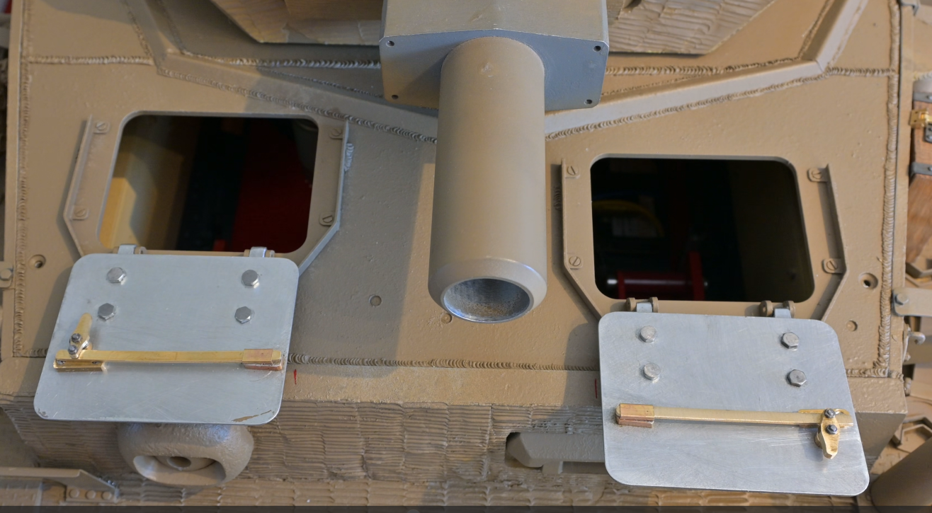

I have followed the drawing above and can confirm gear case now fits perfectly and pulleys clear the hatches and hull,(just about).

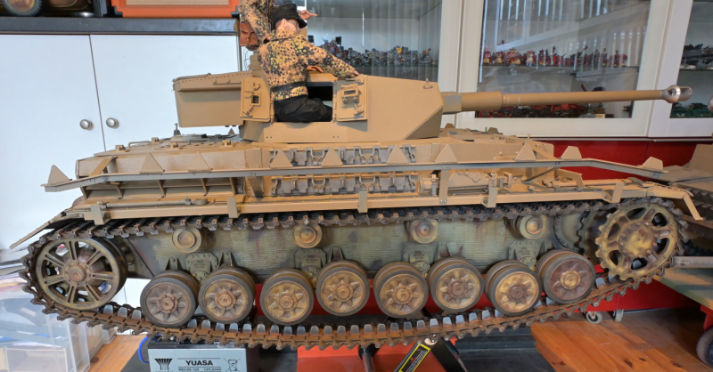

Re: John's Panzer IV no. 004
Another update on progress with the Panzer IV. I have been having a go at painting the wheels. I have not done much weathering in the past. I usually let the tanks pick up wear and dust with age. A bit like myself. Chipping and rust is something I want to add to the Panzer IV.
I also did some work on removing the machine marks left on the wheels.
Here are some photos. I am working on a video also.
Still busy working on the Panzer IV. Painting and weathering tracks. Improving the armour appearance with mt surfacer 500.

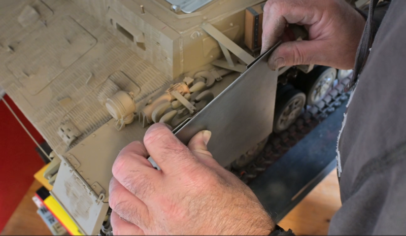

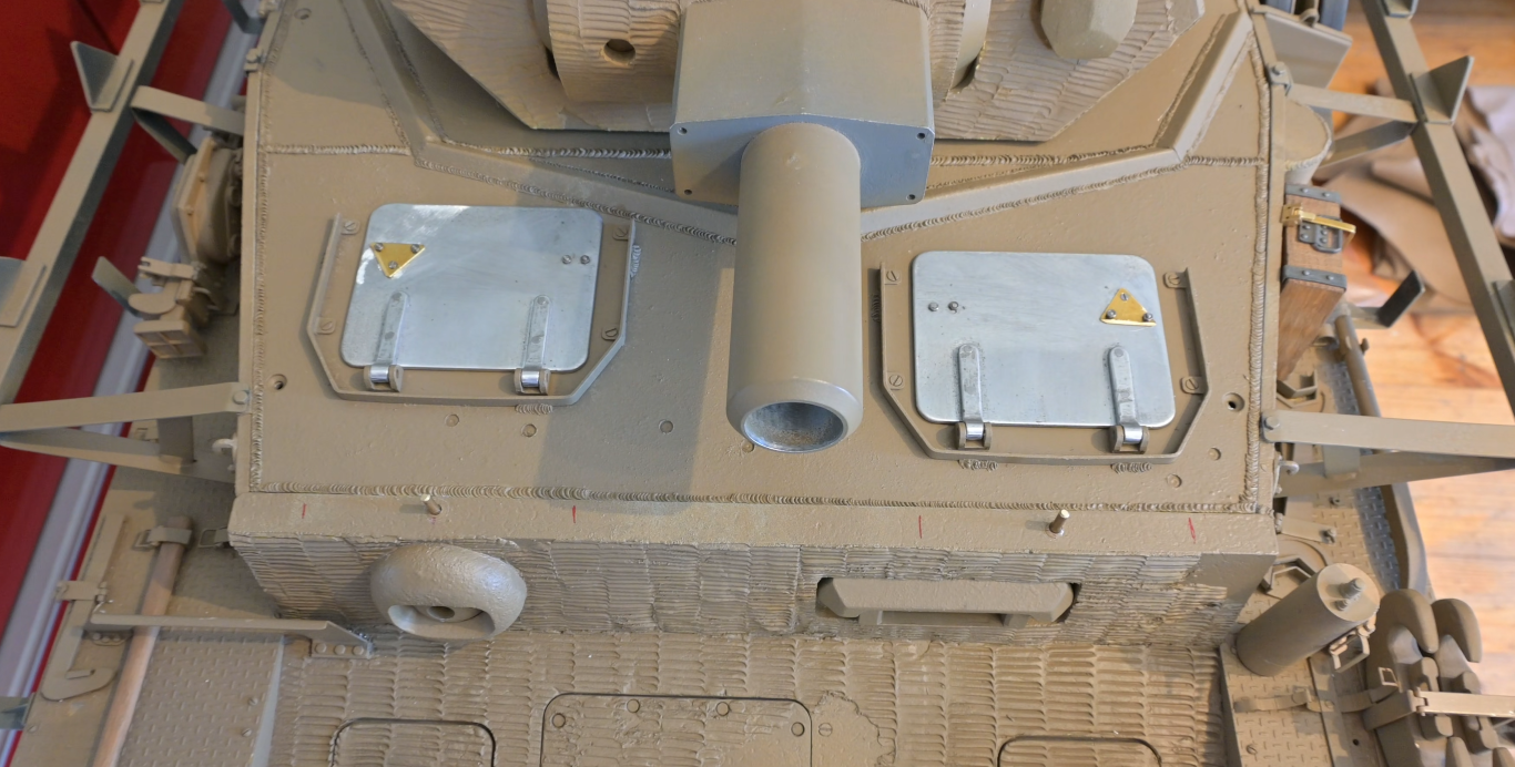

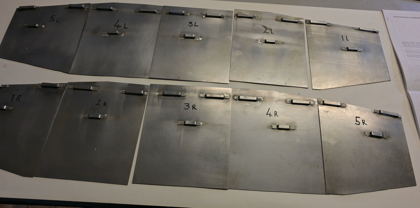

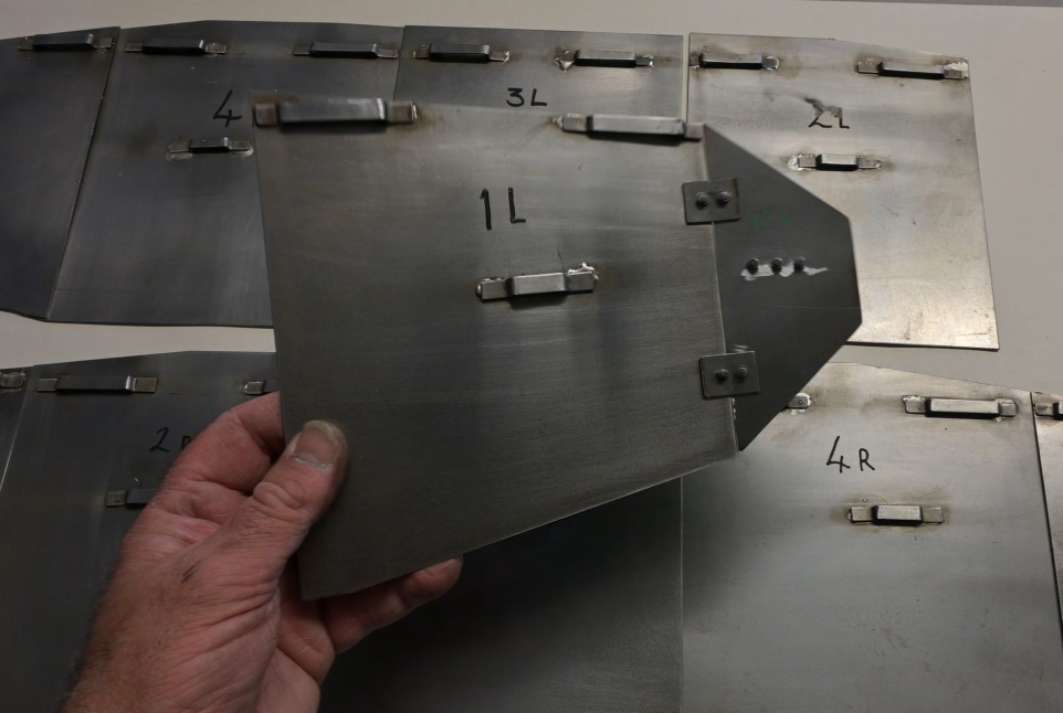

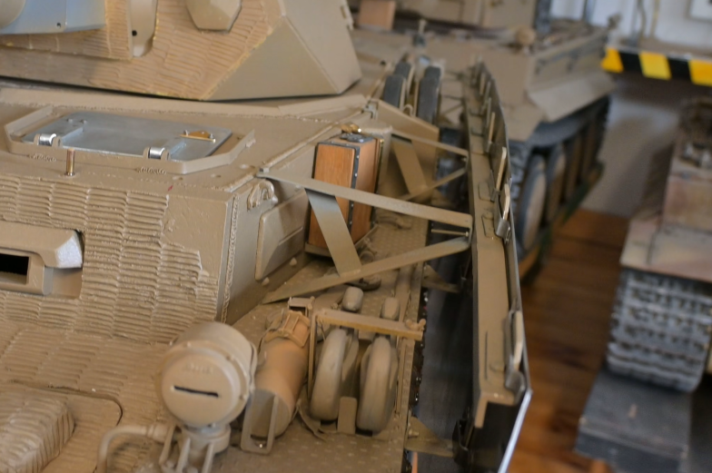

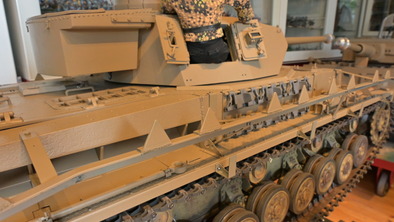

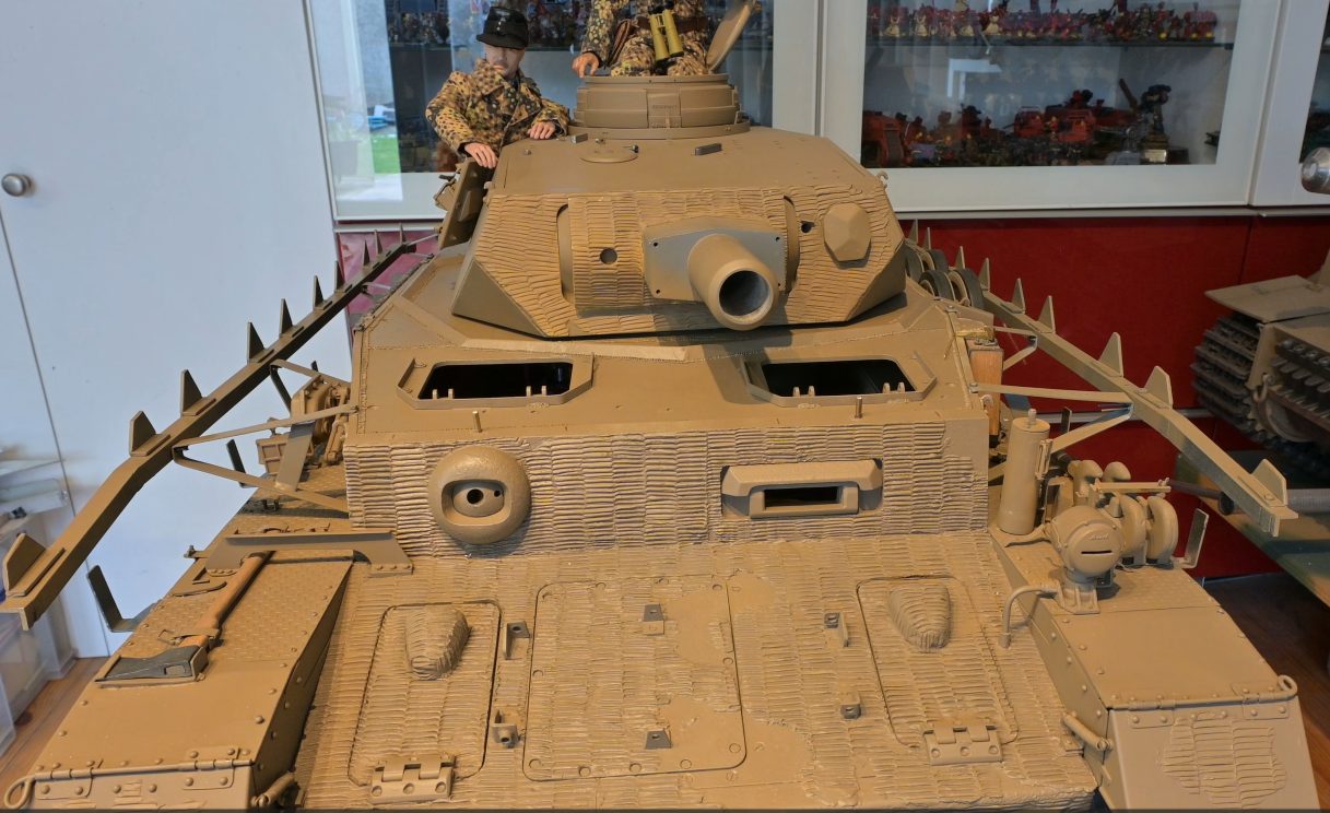

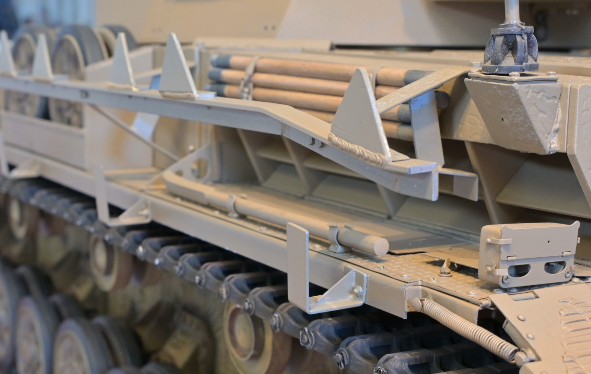

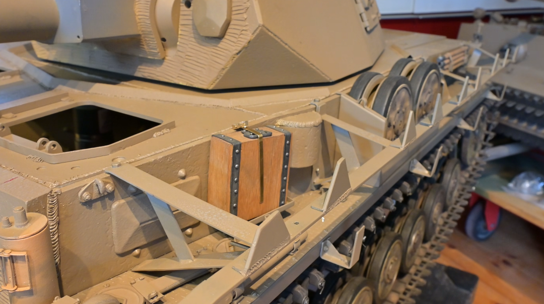

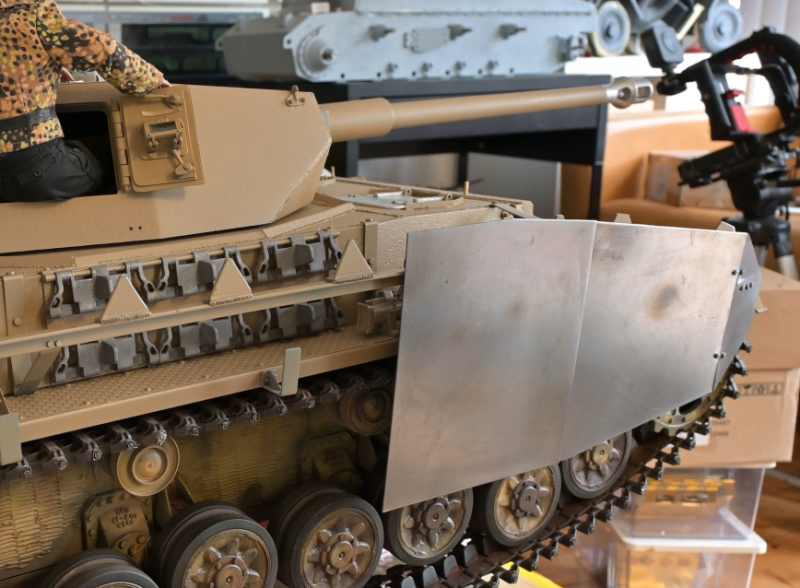

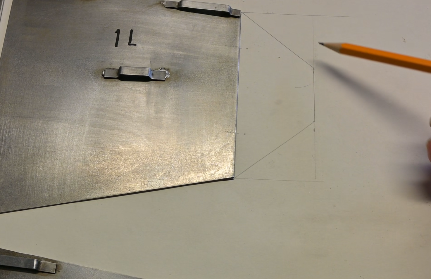

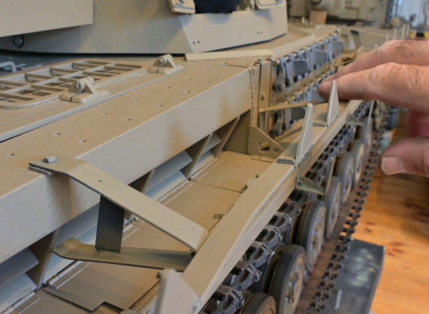

I have finally started work on Shürzen. At least on hull. Working from bottom up. Turret will follow. Using drawings from Panzer Tracts which are in 1/10 and 1/20 scale as template. Scaled up to 1/6.
I made up the brackets from the drawings without checking the model. Credit to Armortek, the brackets are a perfect fit without adjustment.
Now ready to start painting the upper hull. Not certain of what to paint. Have one in mind but might alter camo style a bit.
Here is a link to channel on YouTube
https://www.youtube.com/@16rctankworkshop-yv8kl

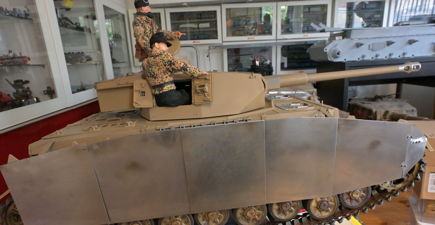

Hi all,
Here is a video on how I made and fitted shurzen to the hull of the Panzer IV.
Those look outstanding John. I like that they are steel. Very nice addition.
- Posts: 1871
- Has liked: 6 times
- Been liked: 822 times
Thanks Bob. I might see if steel angle is available next time for framework as easy to assemble. Aluminium worked well though.
