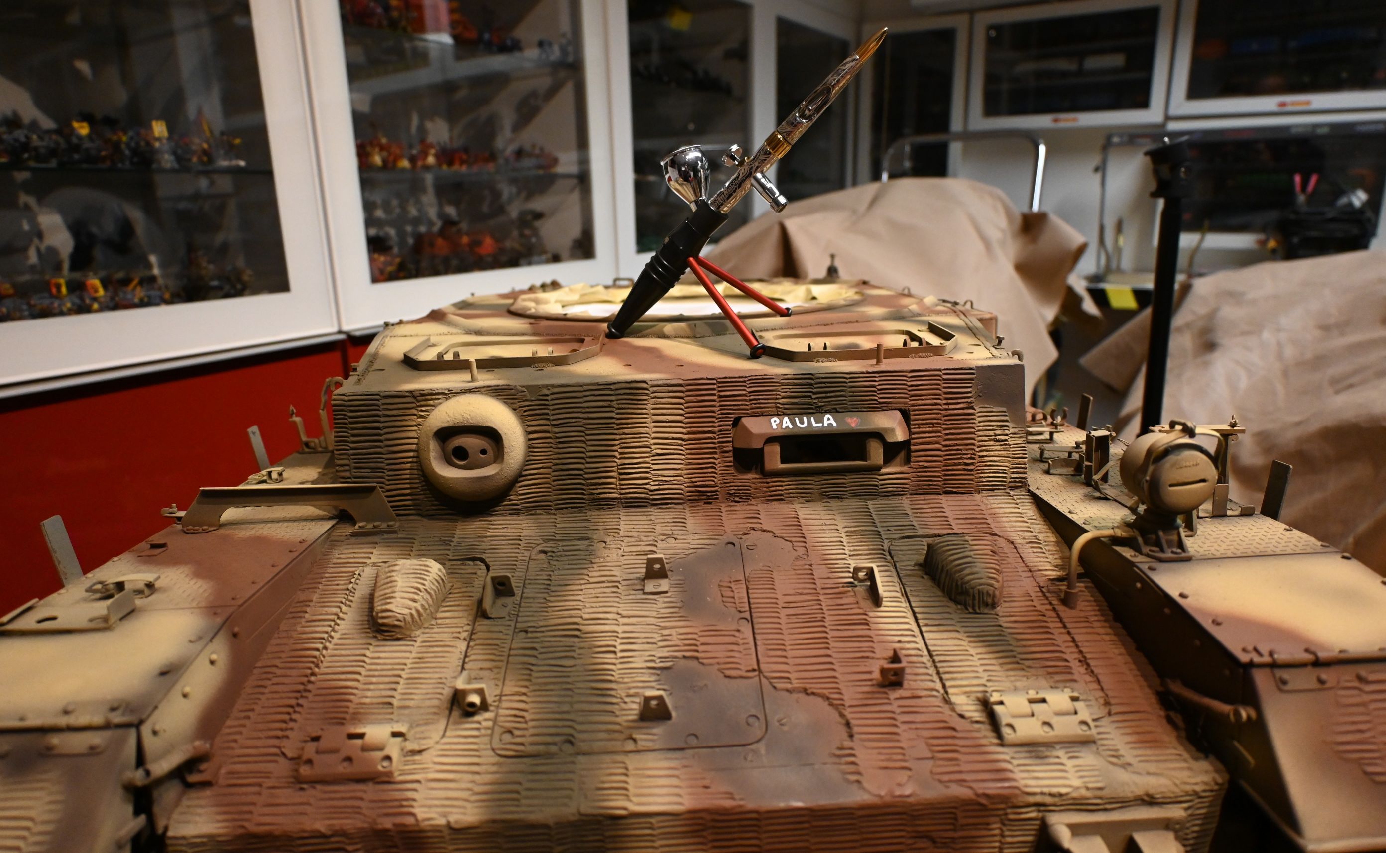

Started camo scheme. Good few photos of this vehicle but not trying to follow camo in photos. Just my own random camo.
