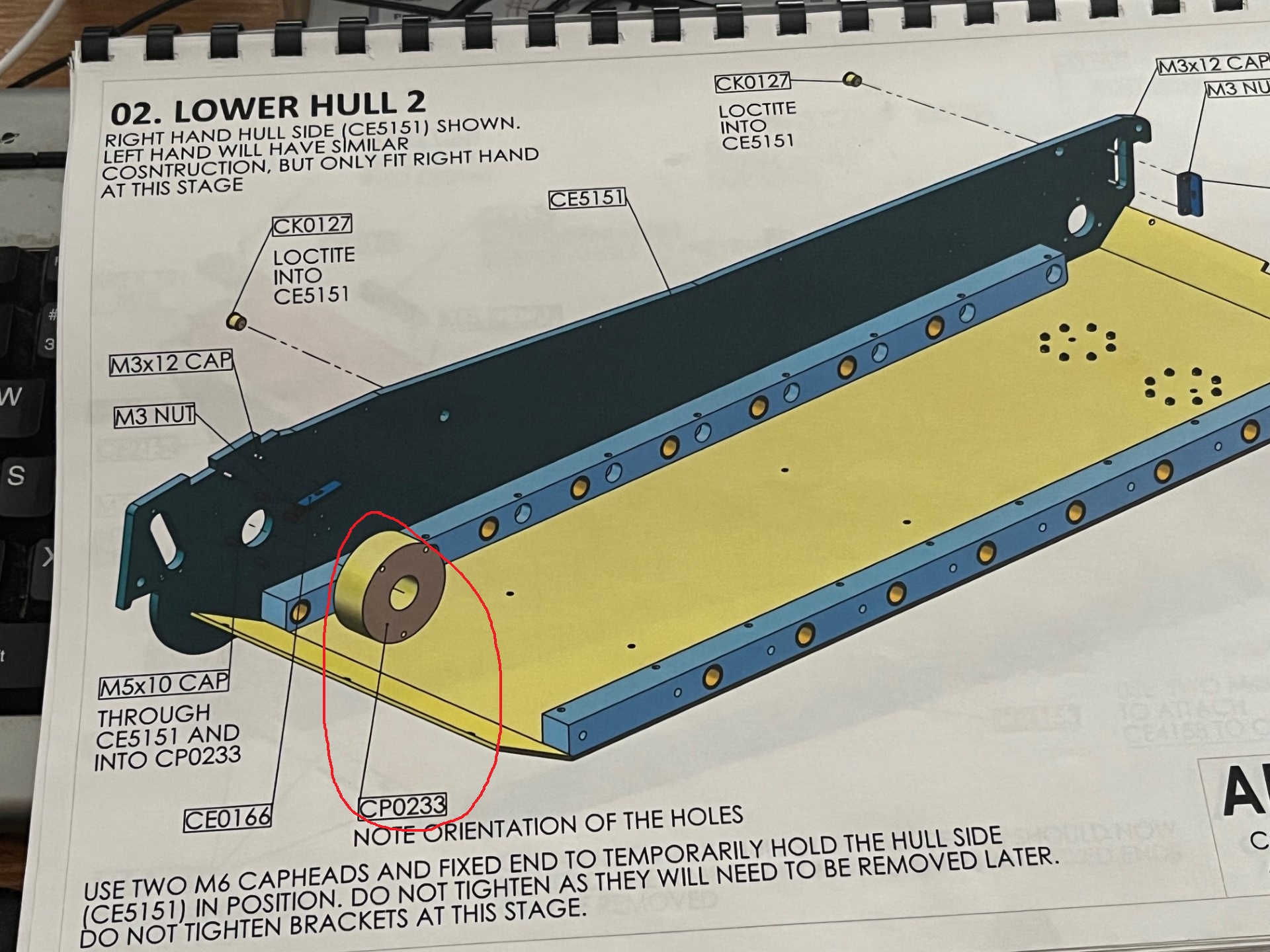

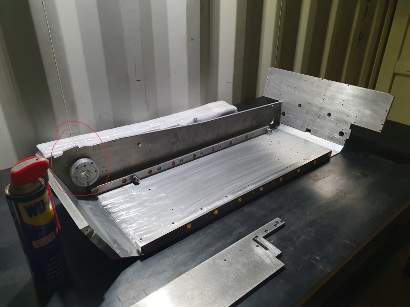

I am at the stage in my build where I now need the motion pack (I am about to put on the drive casings), I was about to purchase from AT.
However, another builder is selling the unopened option packs that came with their 2021 Late Tiger 1.....and they are in Australia already....seems fortuitous. While I would like the latest motion pack, the latest smoker pack and the updated machine gun part....it seems like the sensible option to buy something that would otherwise not be used and save a bit of money. Win-win.
I have a 2023 Early Tiger 1 which did not come with the two CP0233 which was used with the older motion packs. (see image)
The Late Tiger comes with a similar (or identical??) part (see image)
OK, thats the list of facts..... my questions are:
1 - Is the 2023 Early Tiger 1 compatible with ALL of the options packs that came with the 2021 Late Tiger 1 ?
2 - Is the CP0233 in my instructions the same/compatible with the part on the Late Tiger? (Note: there seems to be more holes on the Late Tiger part than my instructions)
3 - Following on from 2 I guess...should I just ask Armortek for the CP0233?
4 - Are there any other parts I may be missing?
To be very clear I do not want to drilling any holes or otherwise do anything too complicated. Yes I know some will say drilling/milling/bending/etc is easy....but I am really not at that level, I am working with basic hand tools only.

Those holes on the motor mounts look right I would verify with the factory but I think the parts would all fit. The kit was designed around the motion packs you are considering. The new design was later.

Thanks Brian, I didn't get any other responses to my messages or this post....I am confident it will fit though confirmation would have been nice.

Hi Neil - we don't check all the forum posts every day hence the lack of reply from us.
I can confirm that the 2021 Tiger 1 options will fit the 2023. Only thing you will be missing are the motor mounts.

Thanks for the response, its very good to know the only bits I am missing are the mounts, which Tom is sending to me
