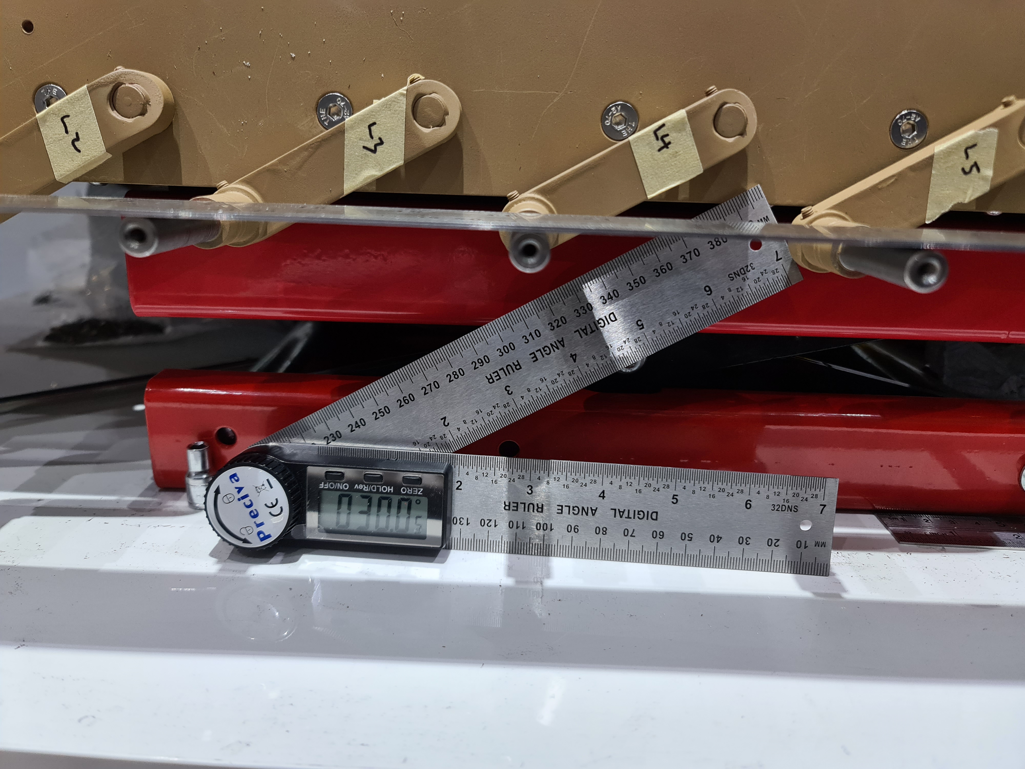

Just made a start on the lower hull, suspension arms and torsion bars.
Had a few issues assembling the suspension arms, but nothing a 12mm tap would not sort out. Thread locked with Loctite 628, so hopefully will not come apart in a hurry.
The flats on the torsion bars filled by hand, but not sure how criticial the 30 degree angle is for the suspension arms?
They all look around 30 degrees as good as dam it, and the metal rule sits across them all with no gaps.
Gone down the route of priming before assembly, the inside will stay Red Oxide.
Rubbed over with abrasive pad, wipe down with Upol System 20 degreaser, Upol Grey Etched Primer, followed by a coat of Simoniz Red Oxide primer. Though I have seen on a lot of the builds that Upol Acid 8 seems to be the perfered choice. Unfortuntally only saw this after I had sprayed the parts, hopfully this will not come back to bite me, technicial data sheets form Upol show both are suitable for aluminium, so should be ok :wink:
