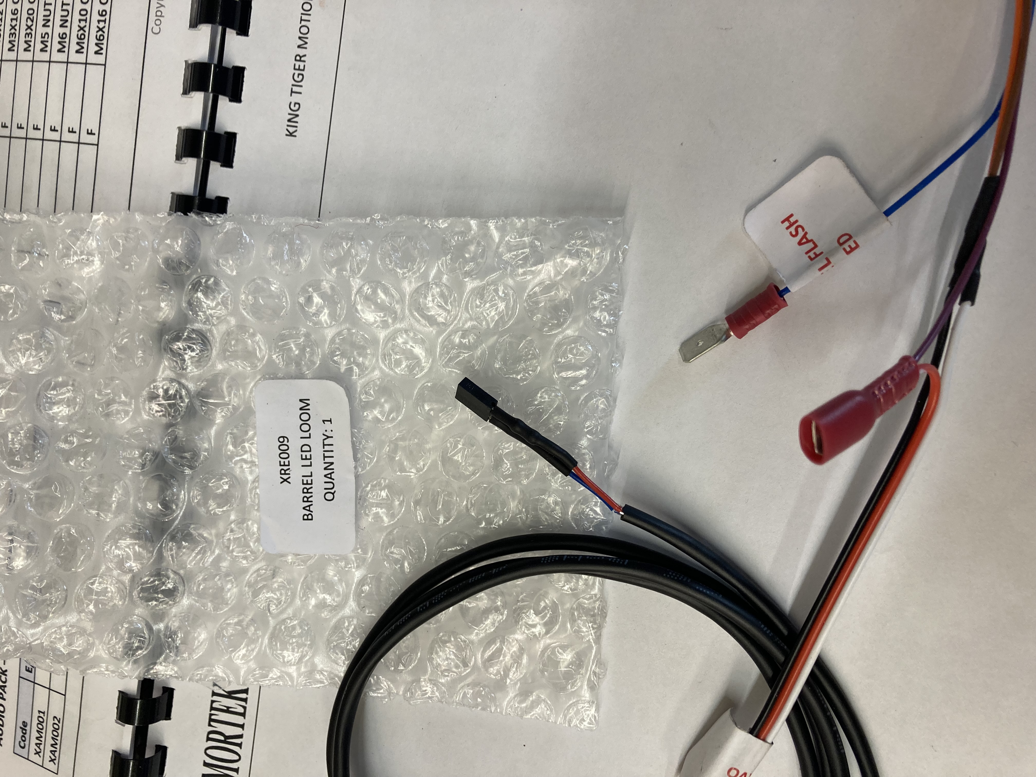

I don’t know if it is related at all but I have two spade connectors on the slip ring loom, one of which is labelled Barrel Flash Loom that I’ve no idea what to do with. The only cable I have that could be relevant is part no. XRE002 possibly XRE009 but this does not have spade connectors attached.

Do I have to cut the connector soldered on to part no. XRE009 - Barrel LED loom and refit spade connectors for it to fit onto the two spade connectors on XMP011 - Slip Ring?
If not can anyone advise where to plug in the Barrel Loom and what to do with the connectors on the slip ring.

Michael has a different wiring setup, where the recoil module is in the tank hull and not the turret, so the spade terminals are for the barrel LED and not the elevation system.

I can only assume as I said earlier that the connector on the barrel loom is incorrect but I can’t risk making the changes unless someone confirms that my assumptions are correct.

Photo of loom, one male spade connector marked barrel flash ( male is not insulated so it plugs in somewhere to get power ) One female spade connector ( insulated so gets power ) on a 3-core cable. Output from the Rx going to the recoil motor ?? If so, plug them together. In my experience supporting the tanks on the ranges, a big flash from the barrel and the barrel recoiling did tend to happen together.

> If so, plug them together... ...a big flash from the barrel
There'll be a flash but not in the barrel.
The insulated connector is being fed from the 5V supply to the recoil servo.
The non insulated connector comes from the recoil module main gun LED output.
Plugging them together may well destroy the recoil module.

I’ve not absolutely sorted the issue with the barrel loom but AT are sending alternate connectors for me.

I have also received the following connector which should solve the riddle of my barrel loom connections to the slip ring loom. Many thanks to those who made contact to resolve this
