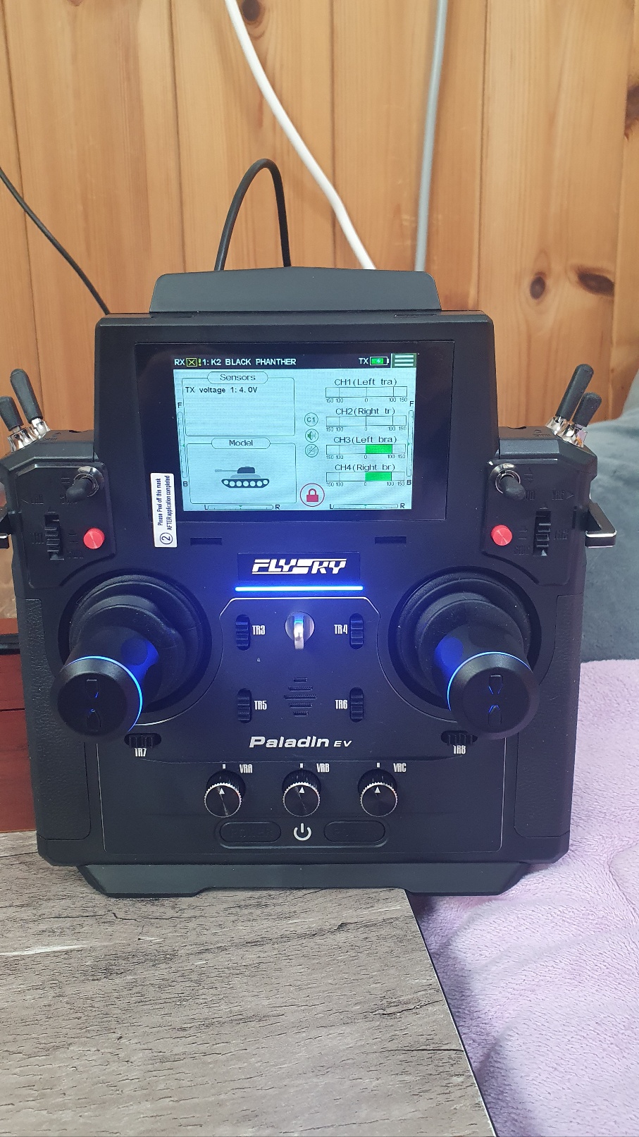

Recently, I came to an interesting conclusion while testing RC transmitter from several companies.
When controlling an RC tank, it is common to adjust with both sticks or control with one stick through V-TAIL mixing or Elebon mixing.
In my case, I prefer to control the tank with a single joystick.
By doing so, I can pursue the convenience of controlling the turret or main gun with the other hand while controlling it at the same time.
What I want to explain is that large and heavy tanks, such as brushless motors or engine-powered ones, can be easily moved forward/backward and left/right pivot rotation, but if I want to make a simple left turn or a simple right turn, there is a problem that the inner track, which becomes the axis of rotation, does not stop reliably and makes an unwanted rotation along the outer track that rotates, and I would like to share how to solve this problem.
To ensure reliable performance, brakes to hold the left/right track of the tank must be included on the left and right sides.
To explain purely from my experience, the existing Chieftain or King Tiger tank I had could be controlled by 2 channels in implementing output, direction, and brake functions using a gearbox-integrated brush motor.
The tank powered by an outrunner brushless motor required a total of 4 channels, allocating 2 channels to control output and direction and 2 channels to a brake system that held each rotation.
In the case of an engine tank, 5 channels are required because the output of the engine must be controlled in addition to the brushless method.
Whether it is a brushless motor method or an engine method, front/back and left/right pivot turns are possible with a single joystick, but there was no answer other than the double stick method to enable simple left and simple right turns.
This is because the mixing stage of the transmitter ends in the first stage of any manufacturing company.
In other words, it was impossible to mix the left and right brakes once more after such mixing because Elebon mixing or V-tail mixing was required to control with just one joystick.
However, in the case of the stick method, the relationship between master and slave can be set based on each stick, so the left and right sticks can be easily set as the master and the left and right brakes as the slave. In the case of the engine method, the left and right sticks can be set as the master at the same time. By using the throttle as a slave, 5 channels could be organically controlled with 2 sticks.
This time, I purchased flysky paladin-18ev among transmitters with left and right slide bars and joysticks and set up the transmitter's model to apply the method of using double stick mode and single stick mode while exchanging modes with one switch.
Youngjae
