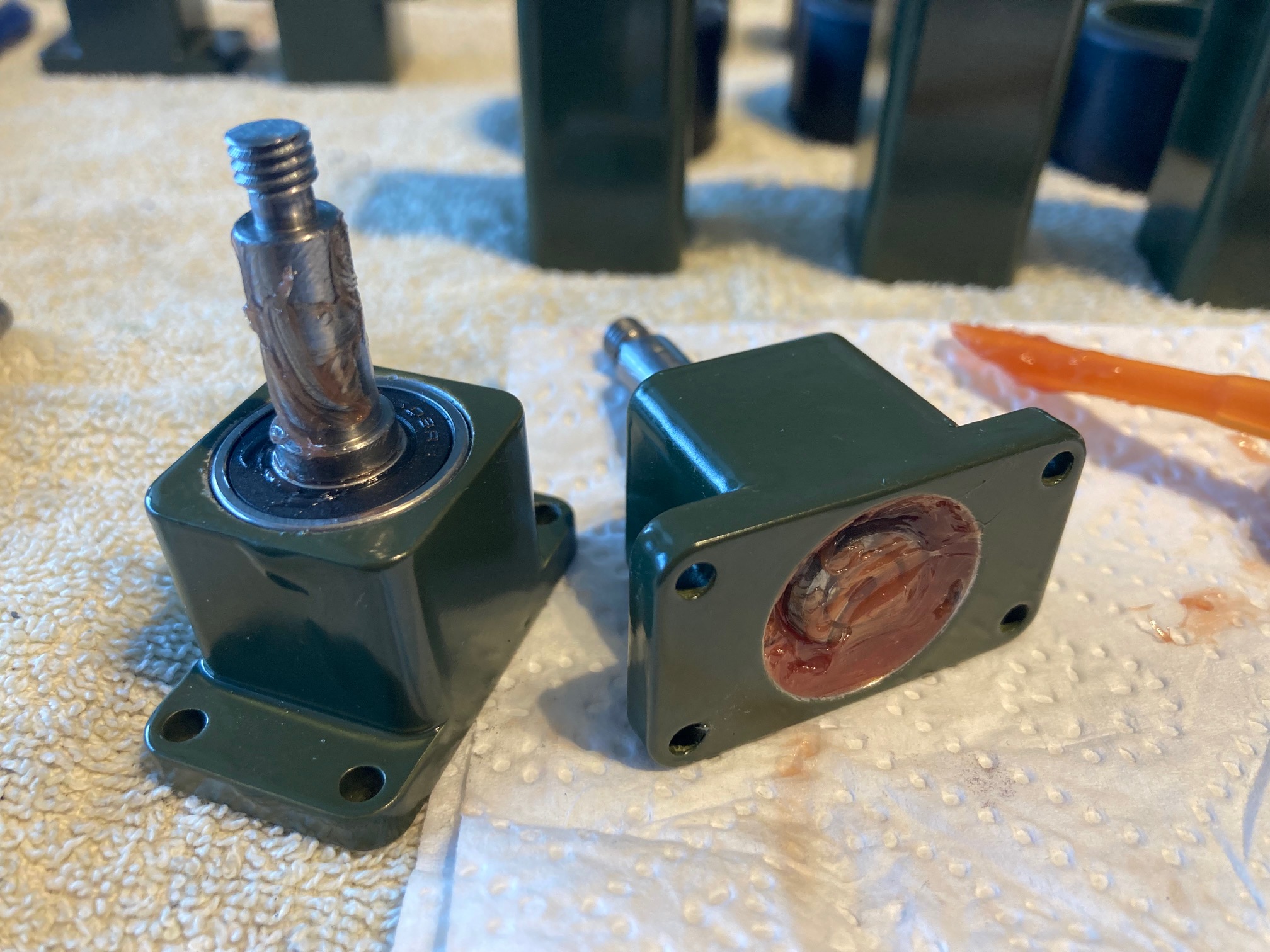

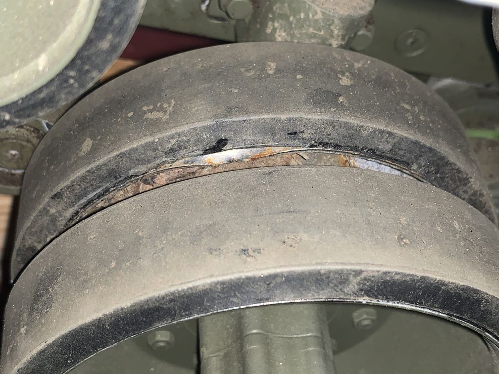

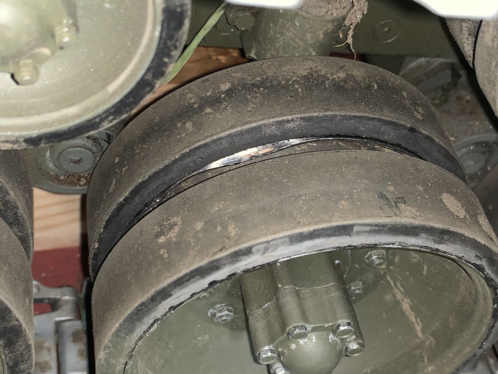

I ran my tank out back for a few test runs. We've had a lot of rain this summer and the grass is wet, really wet, like stepping on a wet sponge. The humidity is also high, consistently above 80%. The tank got wet especially the suspension. On my last run three of the hubs on the return rollers (EV0316) were missing and the outer wheels came off. I was able to retrieve one hub, the others are somewhere in my back yard.
Upon inspection many of the return rollers were hard to turn, two were almost locked in position. So I disassembled and discovered that rust on the return roller shafts was causing binding. The EH0315 bushing in some cases stuck to the shaft, in other cases the shaft had rust and I think it stuck to the housing EV0305A. So I'm pulling them all out (not fun, I have to disassemble the entire top half of the tank) and need to come up with a solution. I was thinking coating the shaft with dry lube, but maybe grease would be better? Would dry lube prevent the rust? If not any suggestions on what type of lubricant to use? - Thanks

That is what I think happened to one of my return rollers right next to the idler wheel on one side. I did not take mine apart - yet. It does not look like it will be easy to get to all the hex head bolts now that all the electronics are stuffed in the hull. Plus, as you said, I will have to disassemble the top half of the tank. I am not ready to do that since I have just completed it and have hardly even driven it outside yet.
I did lube the those shafts with a WD40 Dry Lube product. So far all the rollers are in good rolling shape but I have not gotten anything wet. I really don't plan on it anyway, but damp grass may be enough. Time will tell. I will be running it mostly on a dry area of dirt/sand and bark nuggets.
If I take mine apart, I will be using a heavy grease I think. This may be something that needs occasional maintenance just like any metal to metal rolling part.

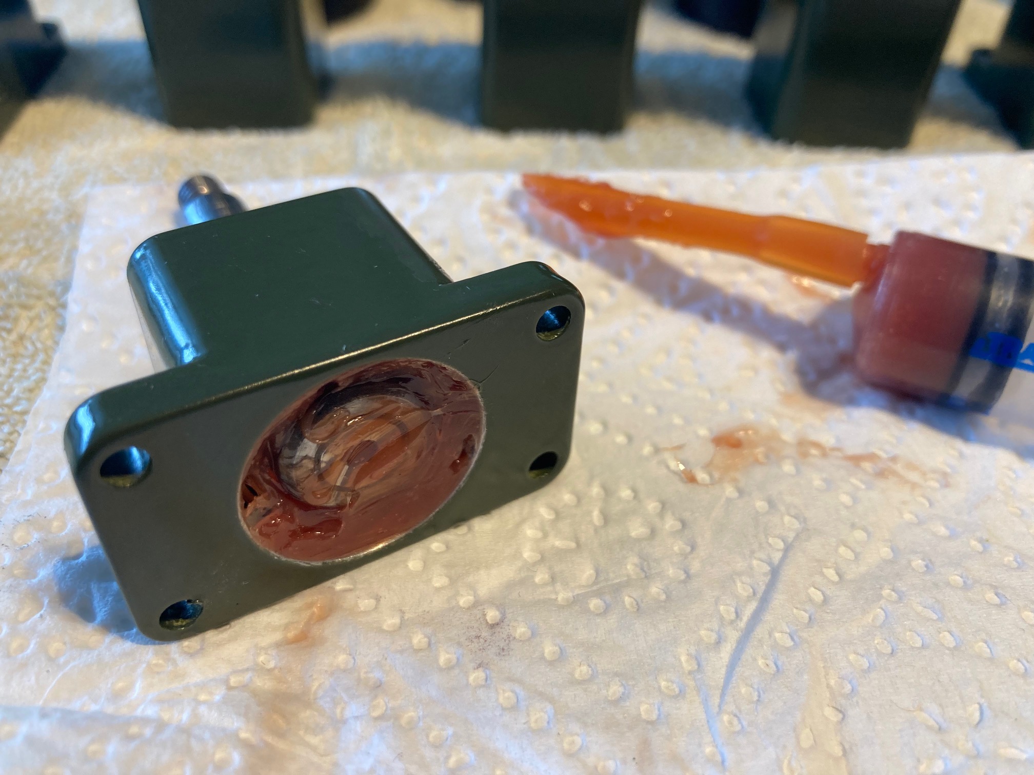

After reading the comments here l think l might take my return rollers out and grease them with marine grease before l start installing the electrics. l did lube them with normal grease but on reflection marine grease should be more effective with our climate.(I hope)

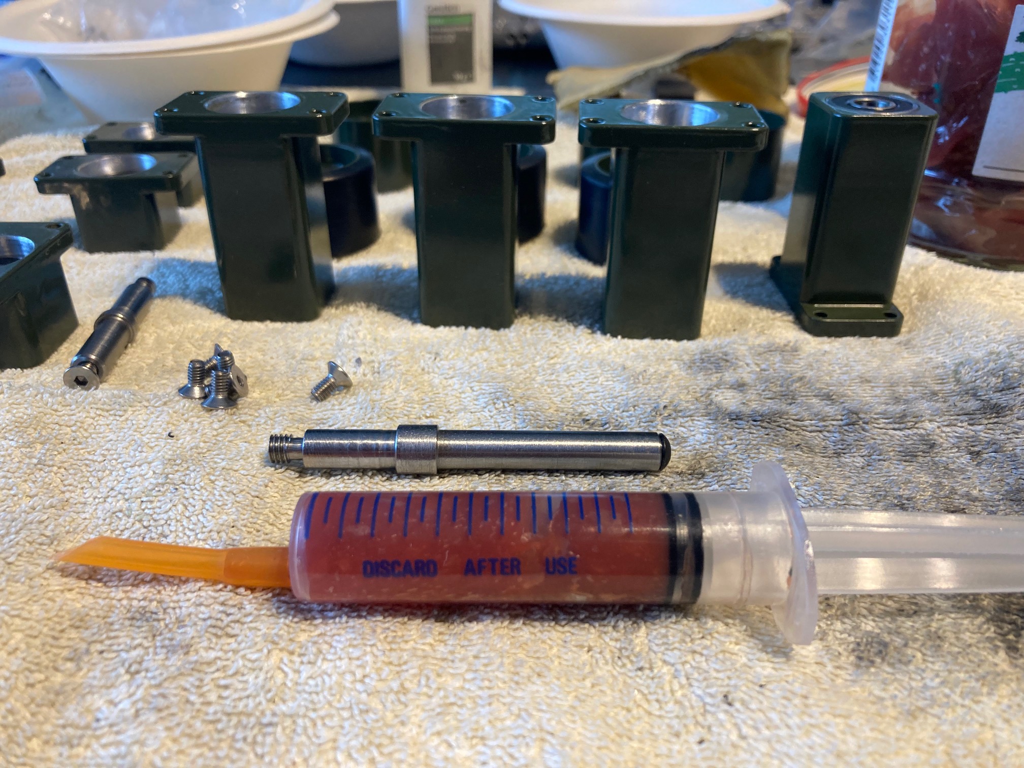

Hi Nick, I was just thinking about my rollers ... if I destroy something when I do it my way ... there should be always grease in my opinion. Working at a regional bus company, I took wheel bearing grease from the large coaches (some red grease, don't ask me ...) and it looks like in the photos shown.Nick Chiocchio wrote: ↑Fri Sep 29, 2023 12:50 amI ran my tank out back for a few test runs. We've had a lot of rain this summer and the grass is wet, really wet, like stepping on a wet sponge. The humidity is also high, consistently above 80%. The tank got wet especially the suspension. On my last run three of the hubs on the return rollers (EV0316) were missing and the outer wheels came off. I was able to retrieve one hub, the others are somewhere in my back yard.
I use alot of it ... the complete room between the bearings is filled with it ...
Cheers, Andre

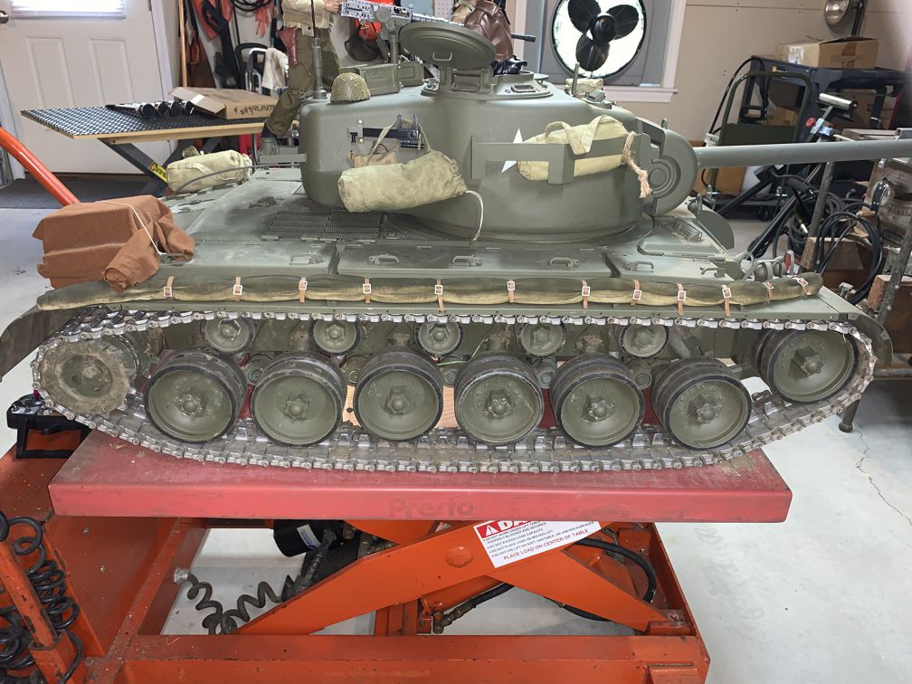

Re: Track Tension
I set my track tension with the tank supported and the tracks off the ground. I leave a little bit of play because if stuff (tall grass, small rocks) gets caught up in the suspension and it is too tight damage may occur. I had some of the steel wheels bend from small rocks. With some play in the suspension you may avoid damage if something gets caught up in it.
I will try and remember to take some photos of my tank suspended so you can see how much play I have and some of the bent wheel rims.

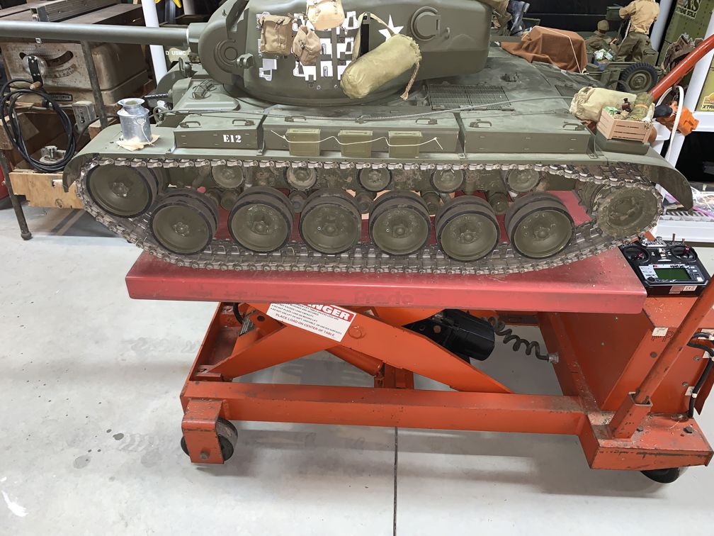

Re: Track Tension
I'm not sure if you can determine much about the track tension from the photos of the tank on the lift suspended. The bent rims can be seen.
As you can see the tank has some wear and tear and hasn't been cleaned from the last time I ran it.
I made a video of the tank with the tracks resting on the lift (not suspended) and tried to pull the track off the sprocket's teeth. The top portion can be lifted but I don't think it can come off all the teeth that are engaged when running. I did run this on mowed grass and dirt and did not have any issues. Maybe it could be tightened a little more?
