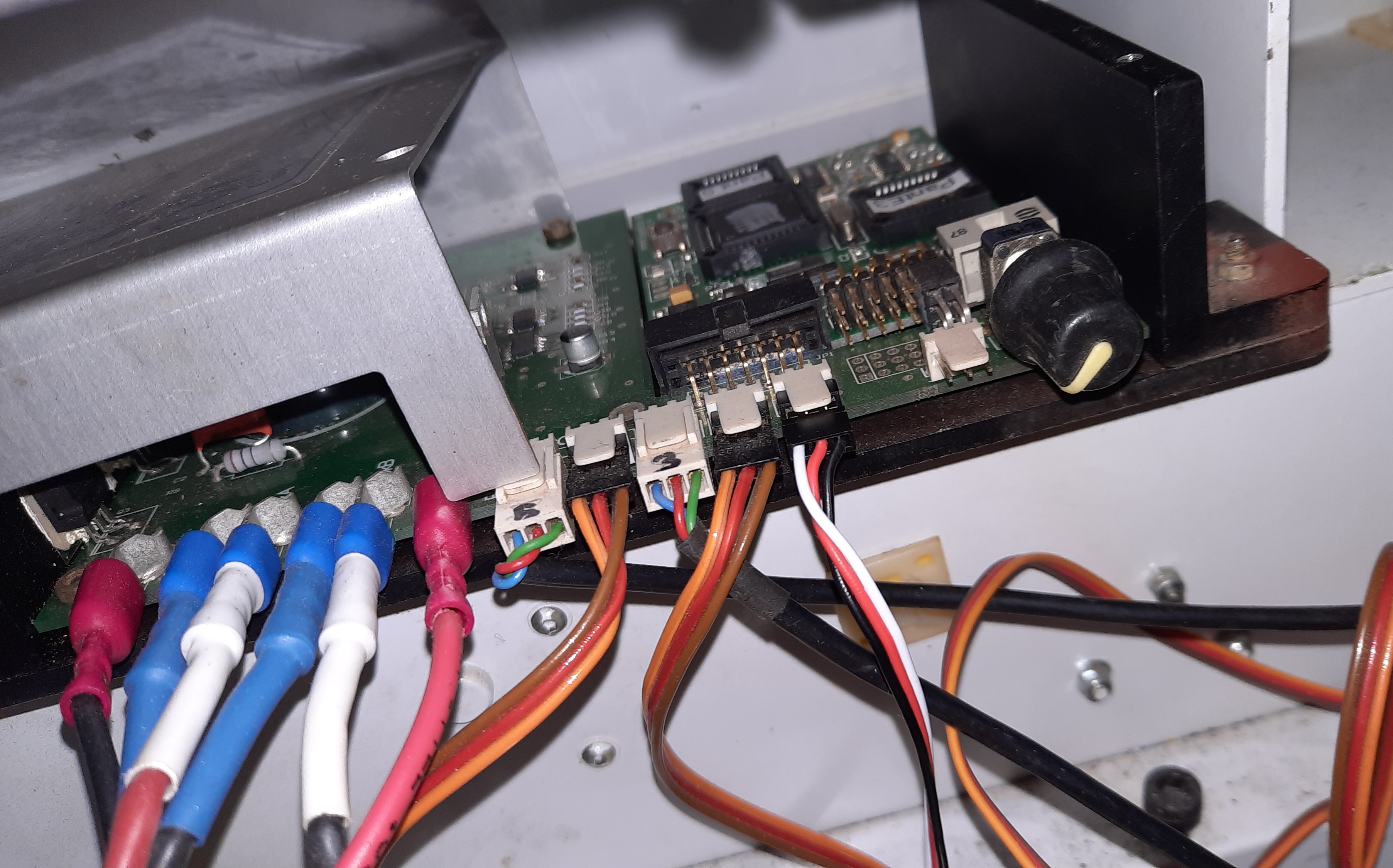

I connected the MG LED as described above. Unfortunately, the light is still only continuous.
Here is a picture of my Amplifier module.

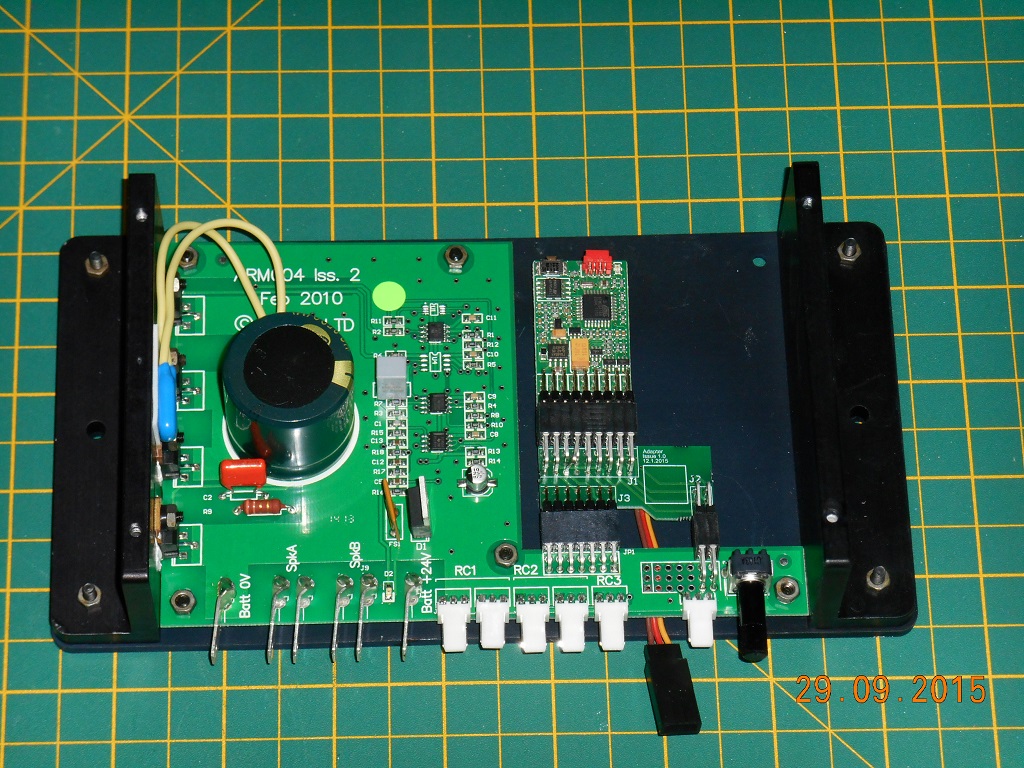

When they switched from TBS5 to TBS MIni, Armortek produced a daughterboard to allow for the change:
If you don't mind spending some time with the manuals, you should be able to recreate this with short male to male servo leads:
You used to be able to return the TBS5 to Thomas for him to replace the chips with the new sounds but I don't think he offers this service any more.

Which generation of sound module is that in your picture?
That would be exactly my idea of installing the TBS Mini in my Armortek box.
Did Armortek provide some kind of adapter board for this?

Re: Silver colored Sound Module-MG flash
That's the first generation Silver Box Amplifier Module, with the Armortek daughter board fitted in place of the TBS5.
Adrian
