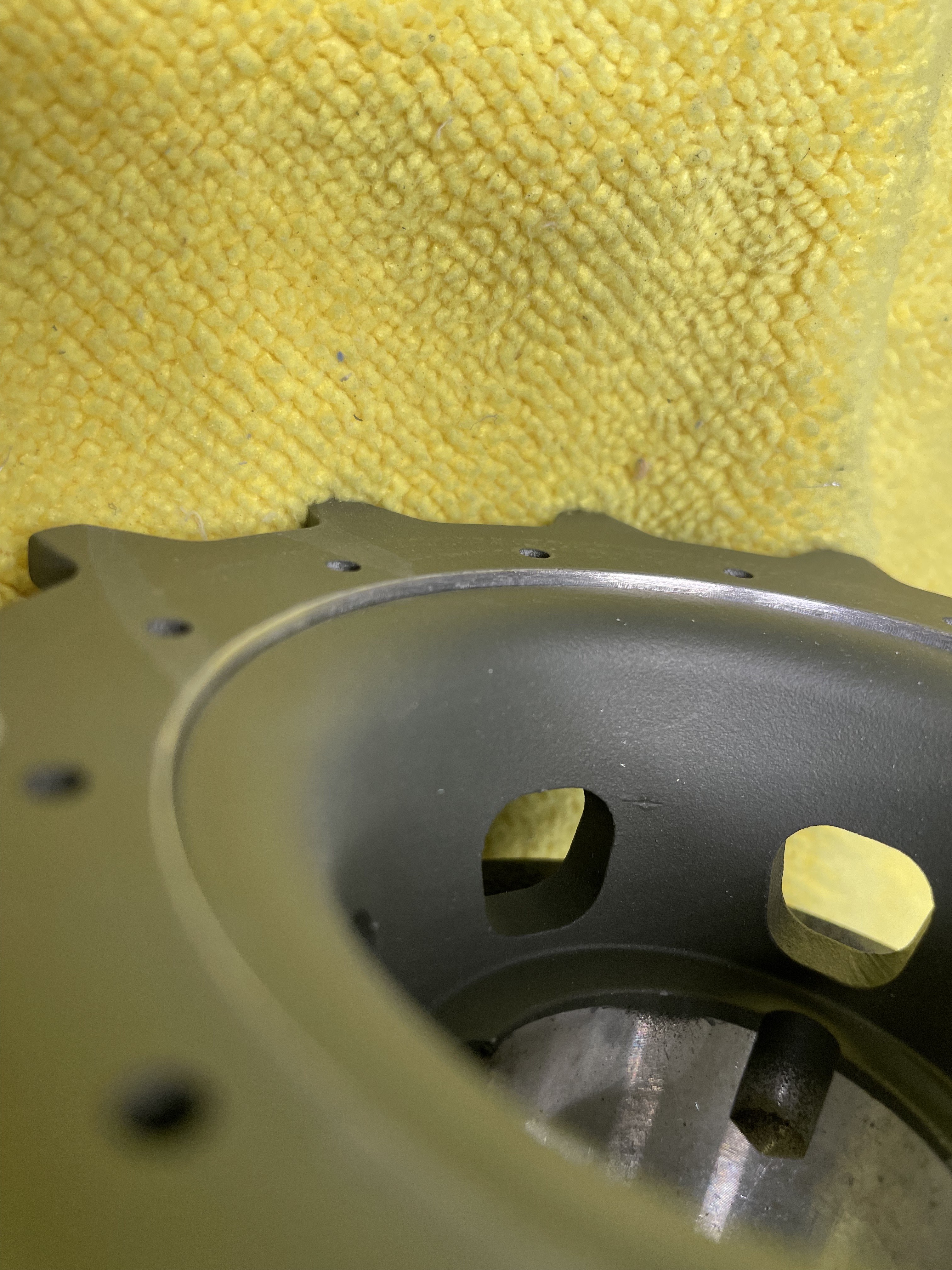

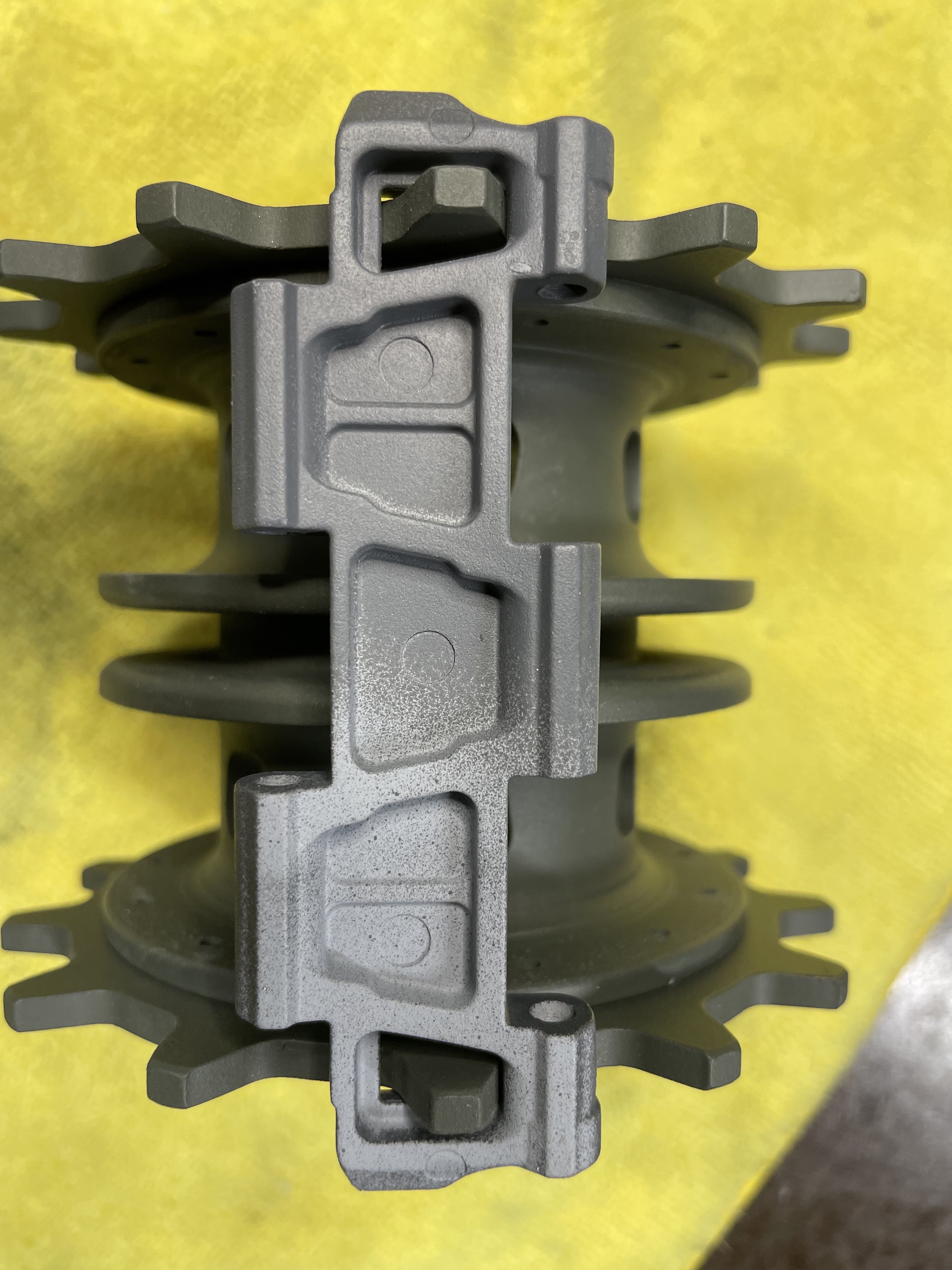

Nick,
Can you tell me if your sprockets sit proud of the hub that they are mounted on? See my pic attached. As a result, the tracks sit on the extreme outside edge of the sprocket teeth with very little play. Just want to be sure before I assemble any of them. I have them pre-painted so I thought maybe there was paint build-up not allowing them to sit fully flush on the hub.
-Ray

Re: Attaching the sprocket
Hi Ray,
I've got about a little over 1mm of play where I can jiggle the track on the sprocket.

- Posts: 141
- Joined: Wed Jan 18, 2023 9:44 pm
- Location: Michigan, USA
- Has liked: 18 times
- Been liked: 116 times
Thanks Nick. That sounds close to what I have. Since I pre-primed and painted the sprocket and hub, I thought maybe I was losing a dimension that needed to be held. I actually had to remove the final color from the edges of the hub and the inside of the ring so it would seat. Very close tolerances on those parts!
Thanks again.
-Ray
Thanks again.
-Ray
