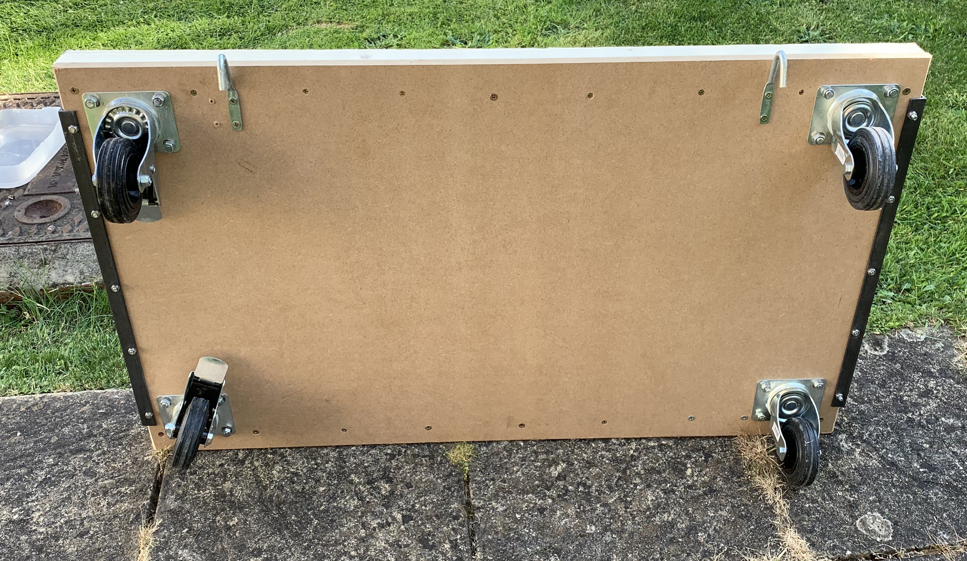

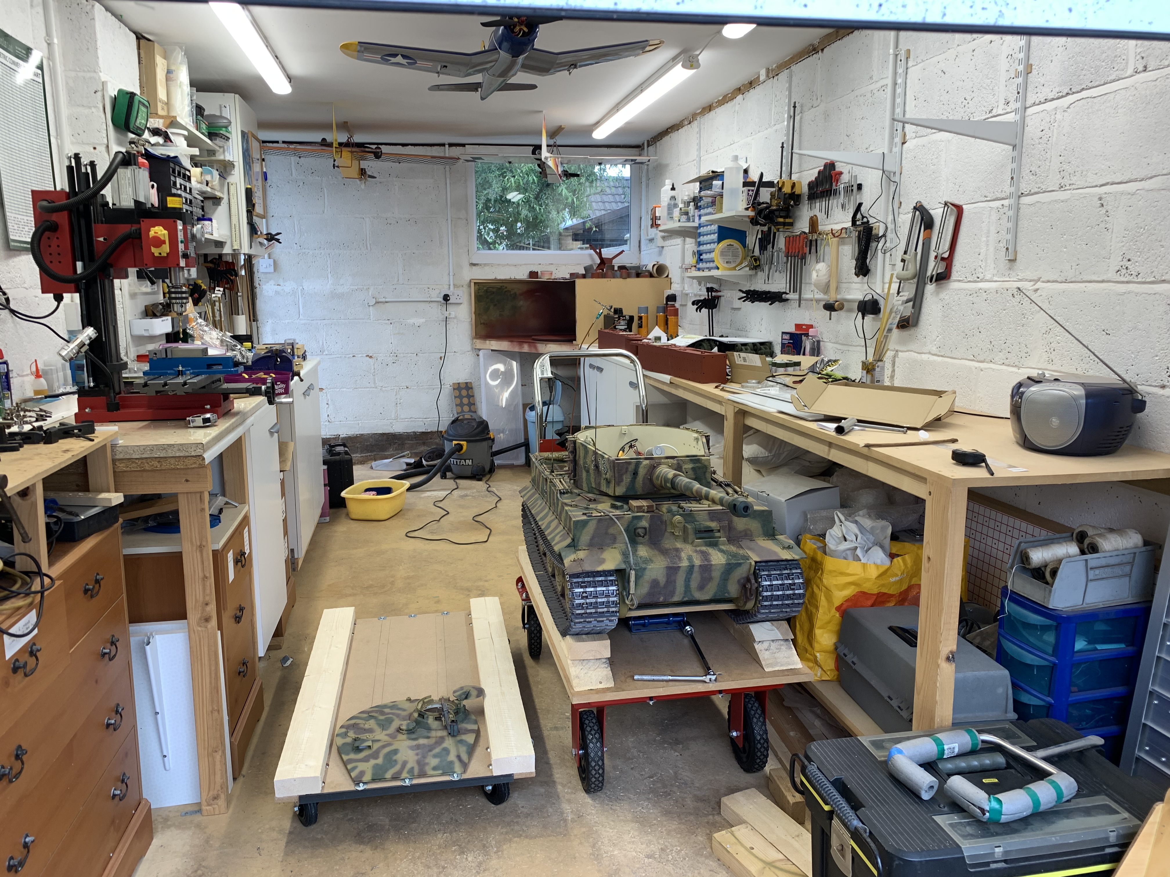

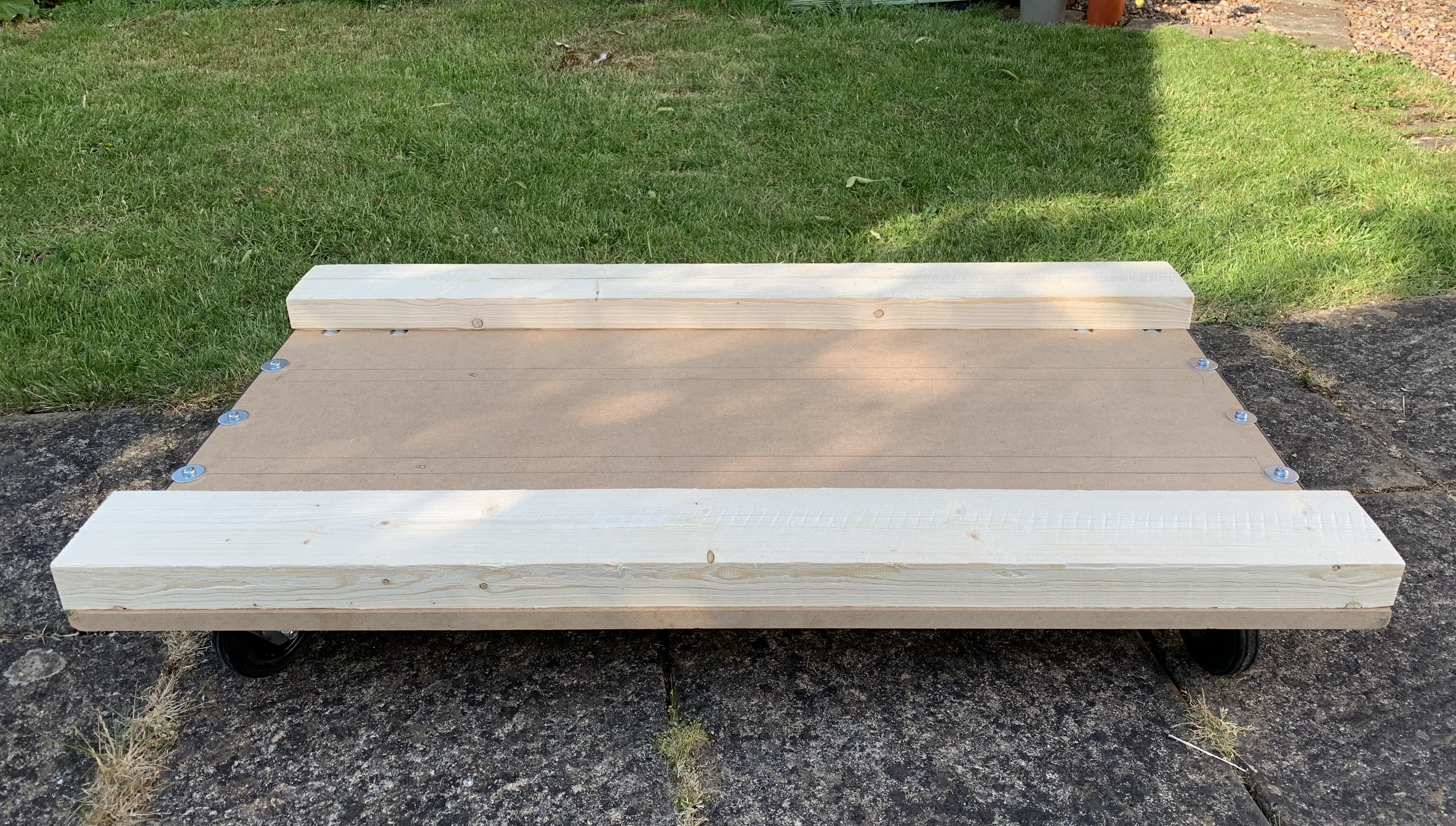

Having converted my garage to a workshop and getting to the point where I will need access need the trolley lift, I needed to find a way of storing the Tiger. The need to keep the space between the work areas clear means I will have to alter my clean workbench area so the Tiger can sit underneath but be easily accessible. The solution was to build a dolly with 4 x 2 timber for the tracks to sit on which will enable me to use a scissor lift to take the strain of the suspension while in storage.
A quick trip to my local DIY store and I returned with two braked and two unbraked 75kg castored wheels, a sheet of 1200 x 610 x 18 MDF cut down to 1050 x 610, M8 nuts, dome head bolts and washers and a length of 4" x 2" timber. Cost was about £65 all in.
The construction is fairly obvious from the photos so I won't bore you with the details, the two metal hooks on the side are to stop the Tiger from hitting the wall when I push the dolly under the workbench. Next step is to rebuild the work bench with a wider top and remove the bottom shelf to allow the Tiger to go underneath. I will get a plastic curtain ( shower curtain ?) on rails to stop the Tiger getting covered in dust etc while I work on the Churchill.

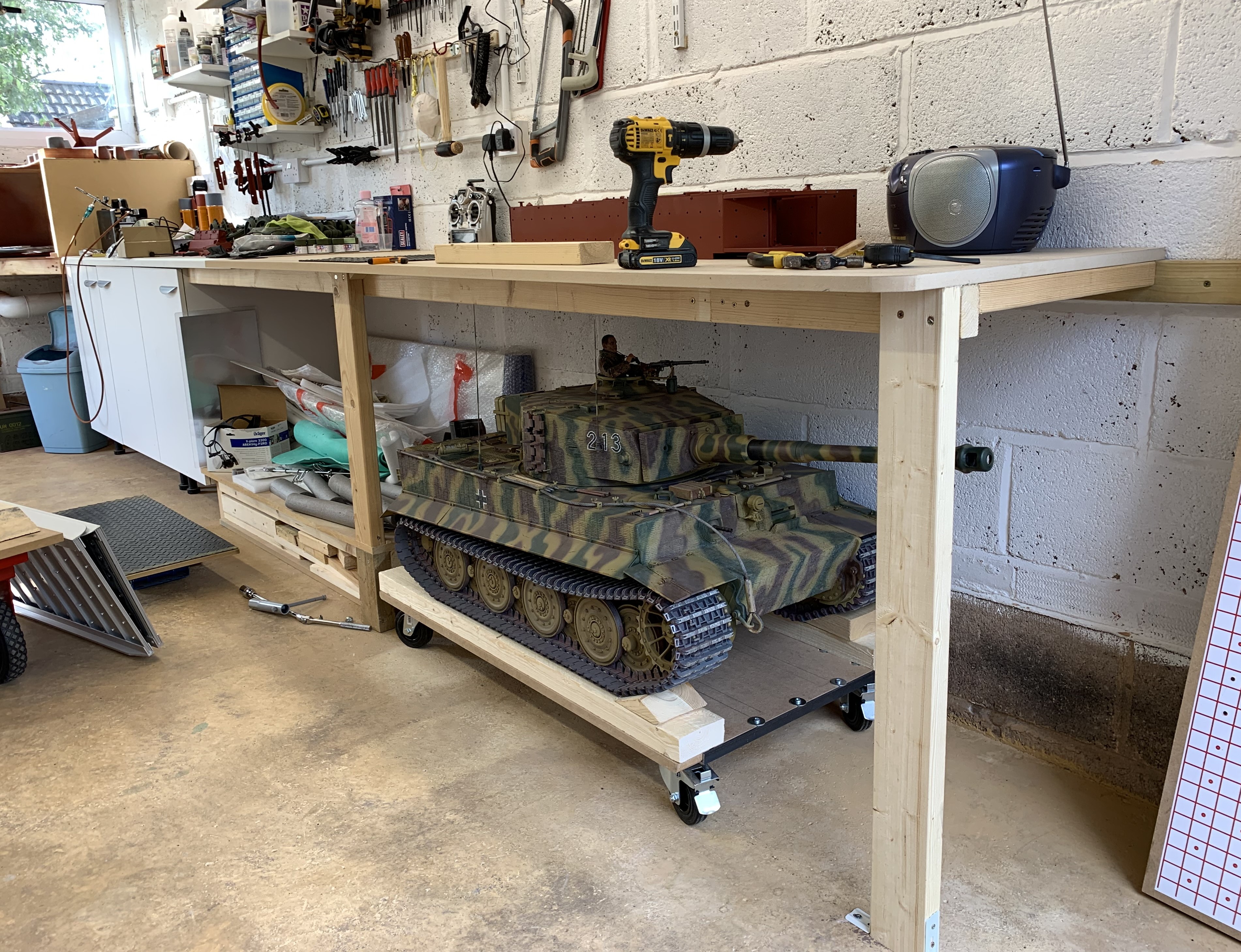

Just thought I would show the difference having the Tiger on the dolly has made to the workshop. I did replace the worktop with a wider and longer one made from 18mm MDF and judicious use of some stout timber.
