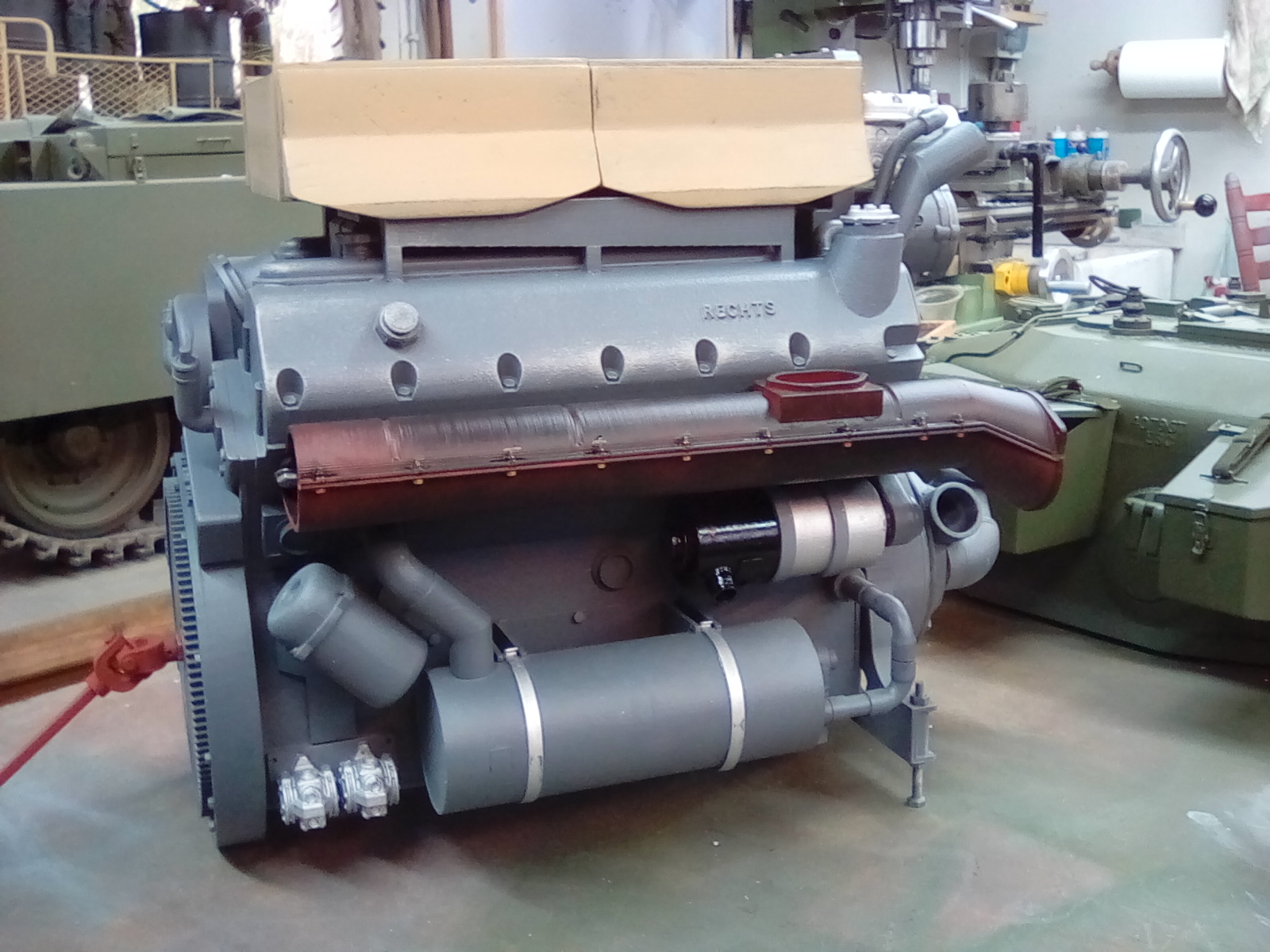

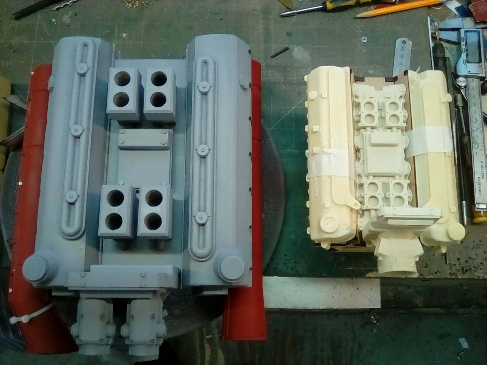

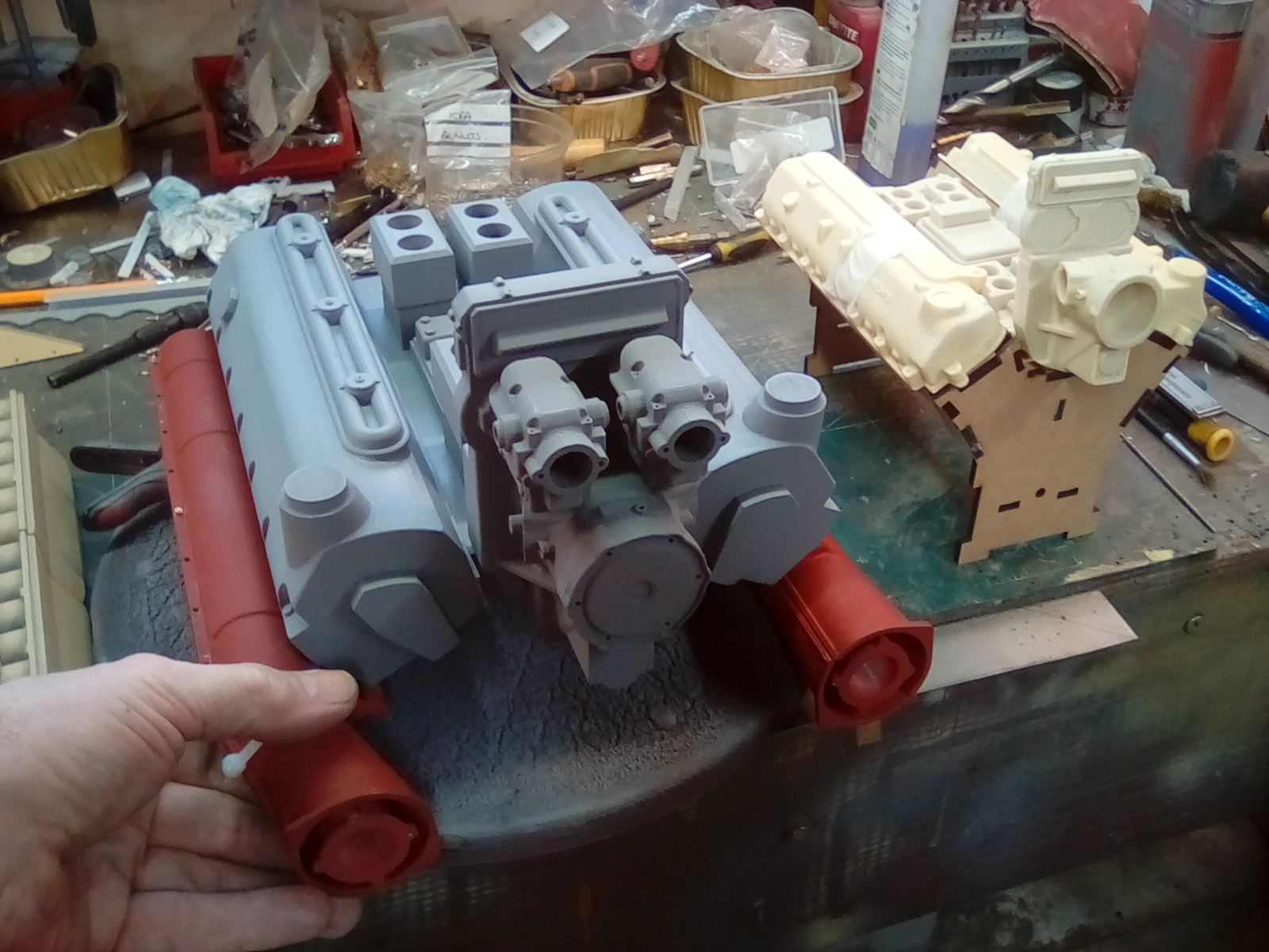

As it's quiet I thought I would share a few photos of a HL230 that I've been printing , stick with an Armortek 1/6 it's more manageable. Thanks go to Vince and Ivano for their help with this lump.
Oh and as it's valentines day do spare a thought for those of us that will be on are own tonight........and maybe spare an even bigger thought for all those poor devils that won't be on their own!
That's one of Ivano's 1/6 on the right
Vince is drawing some working oil bath air filters for me that will actually contain oil!

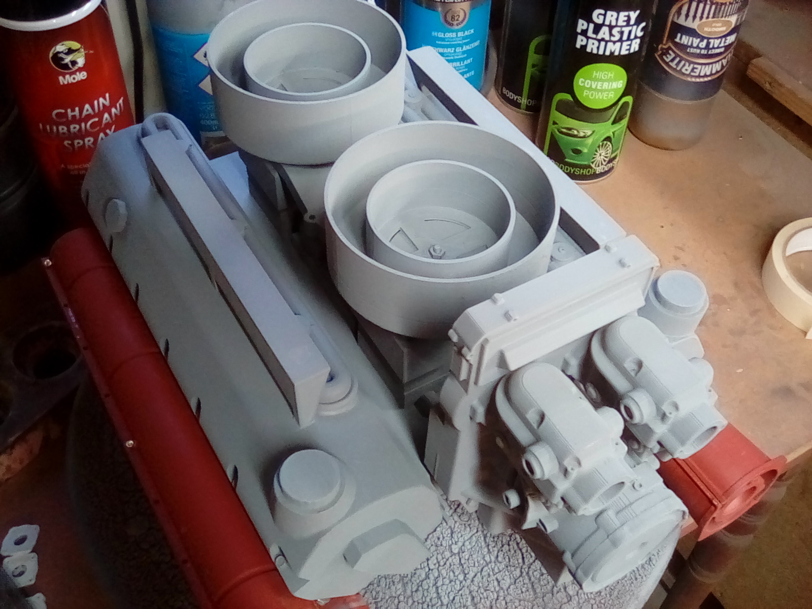

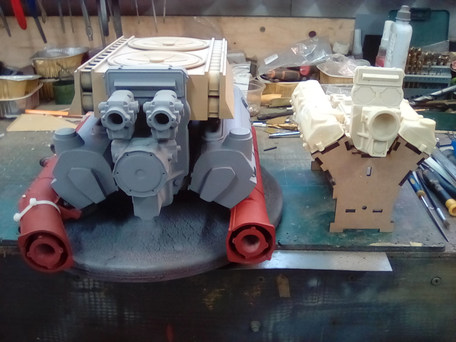

The oil bath air filters look the business, thanks Vince .
Right now I'm not sure how much detail to add as not much can be seen when it's in the engine bay

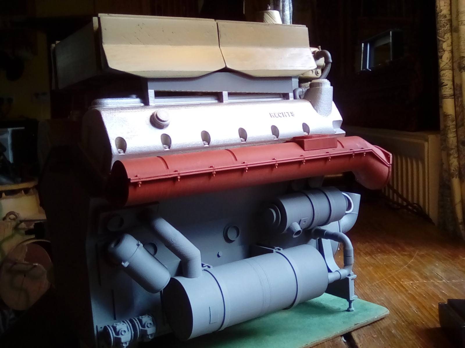

Printed and fitted the cyclone air cleaner supports, they bolt to the rocker covers.
Just need some scale period oil containers

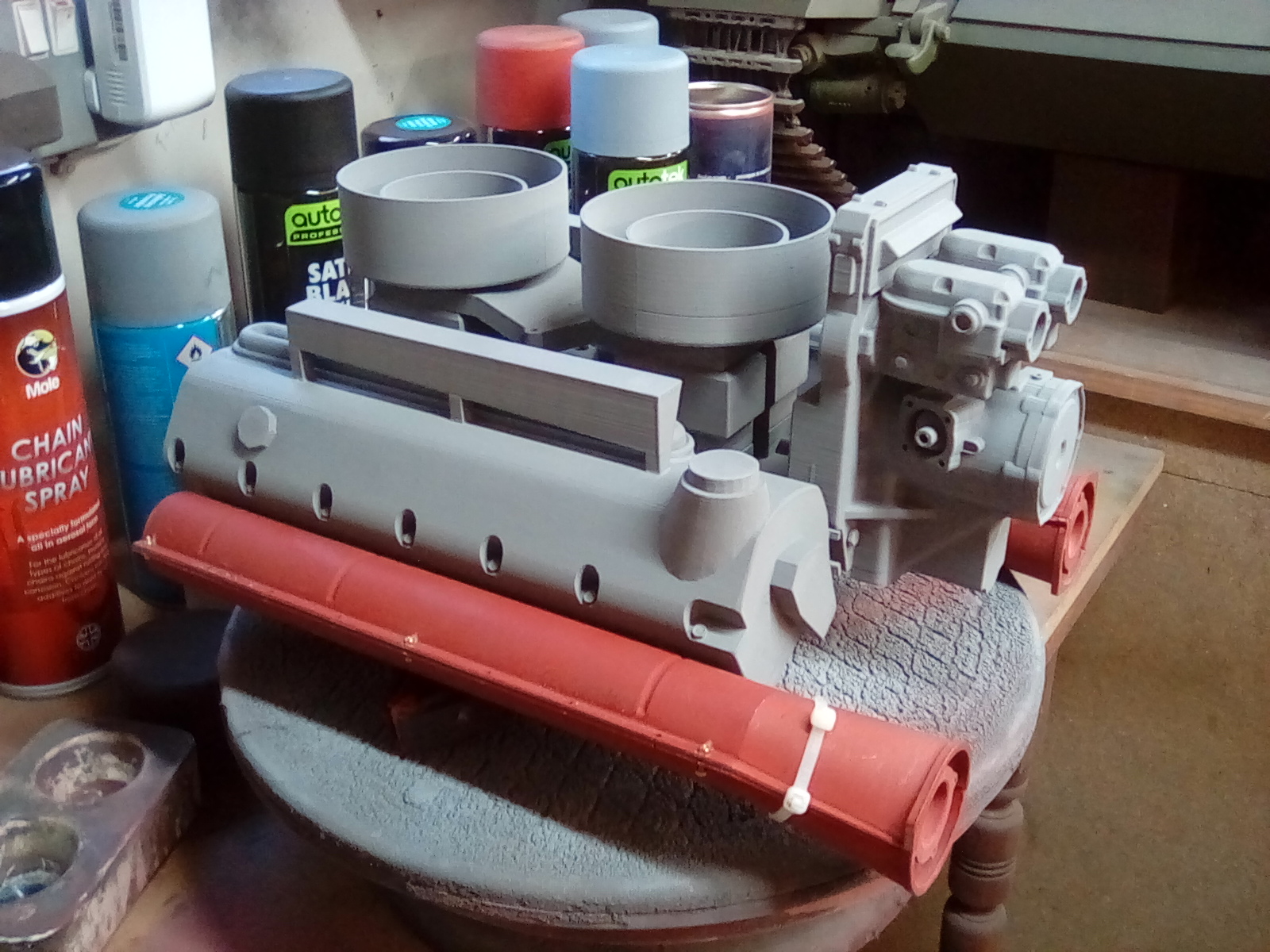

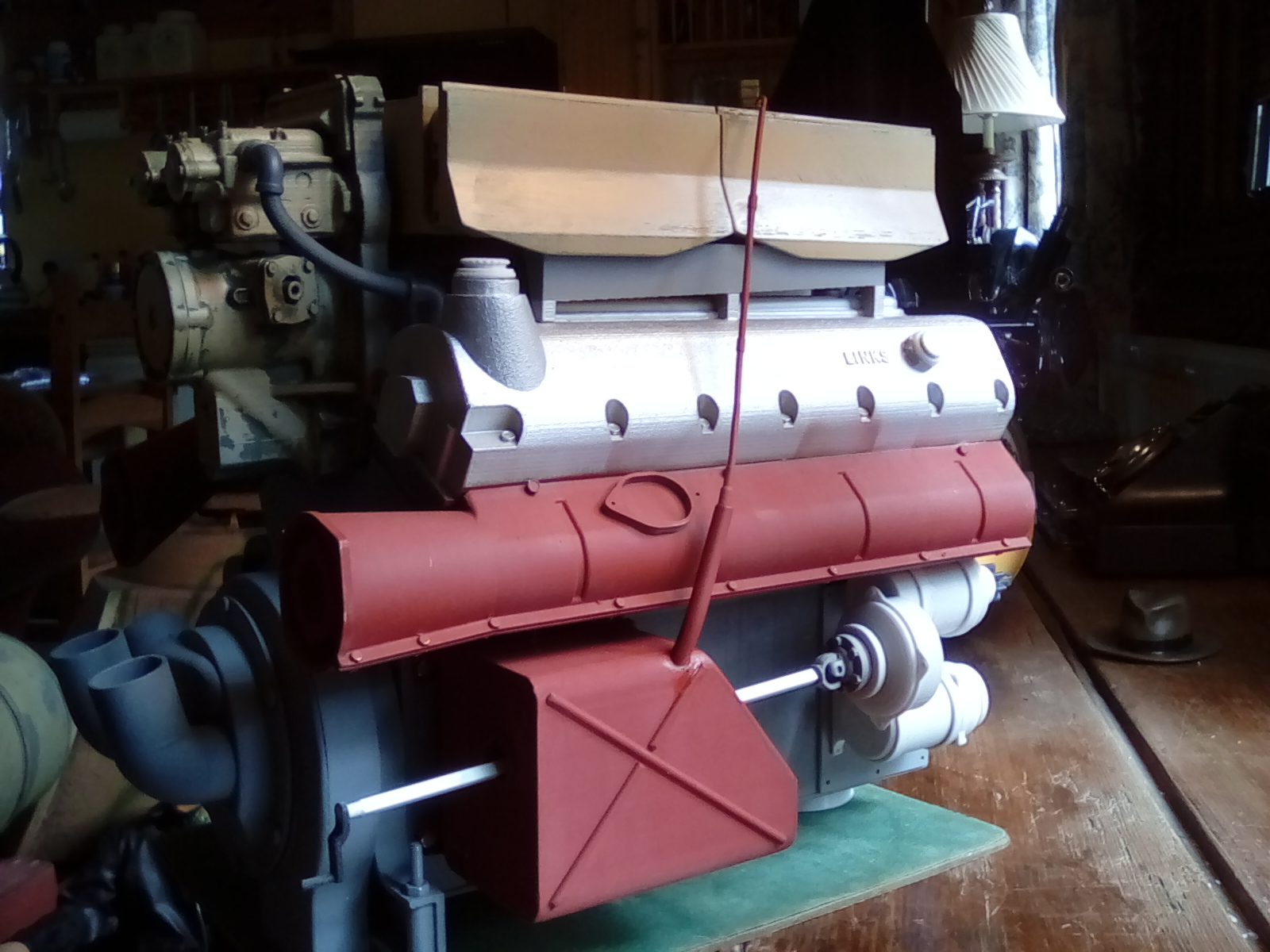

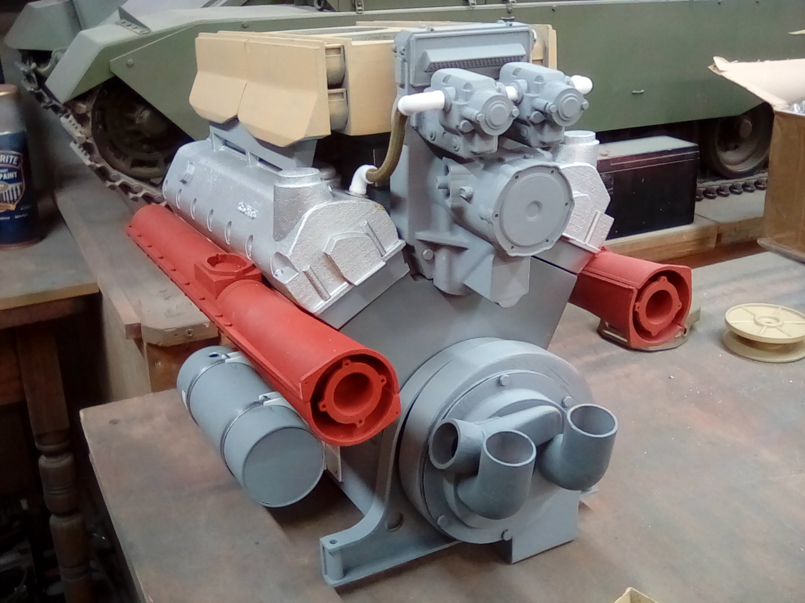

Our 1/4 scale Maybach is getting even bigger, I'm now into the third kilo of filament.
I've opted for the sirocco fan assembly which may be just visible through the engine hatch

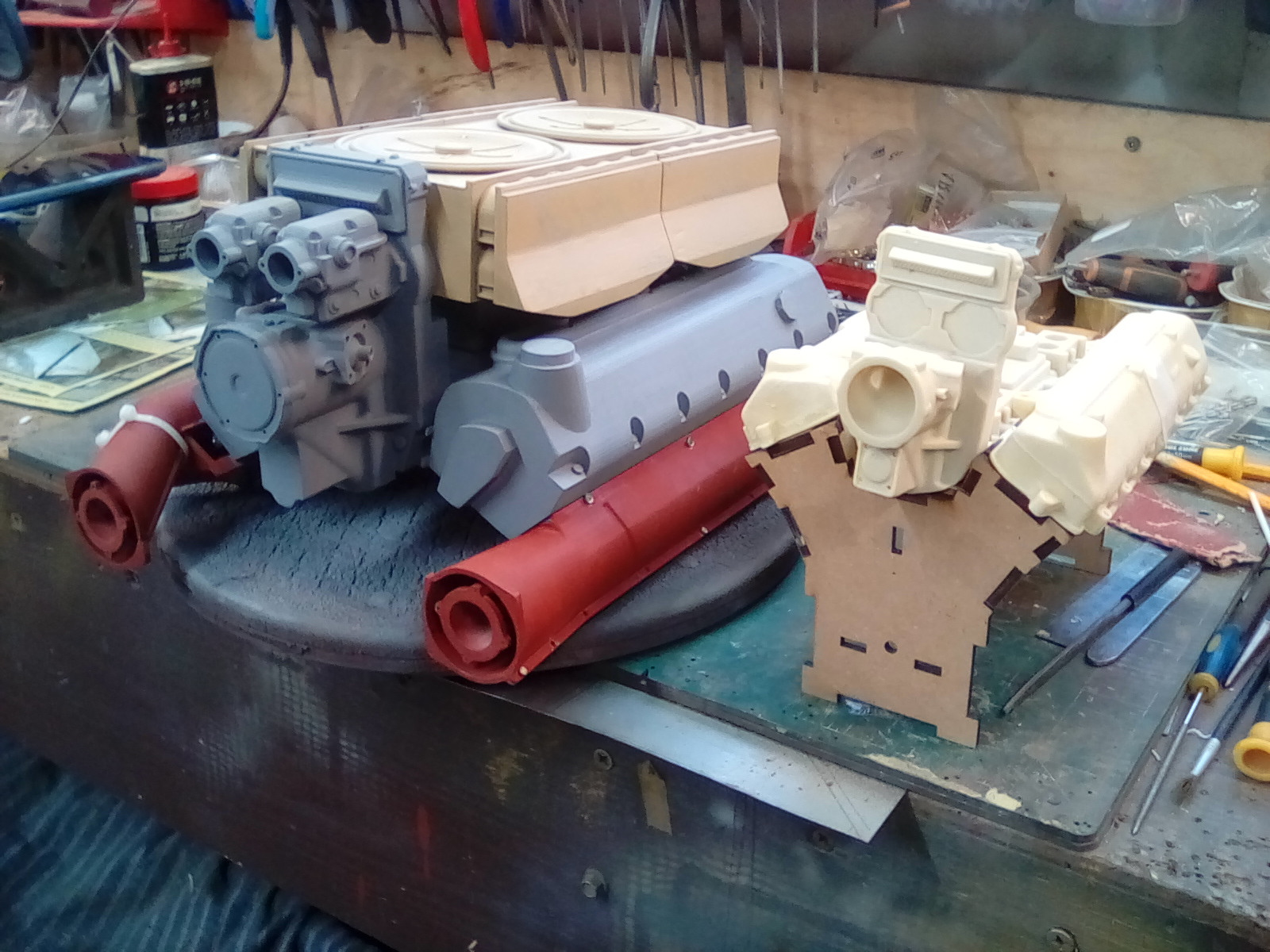

Our Maybach is coming along. For Ivano, I have gotten this far regarding the inertia starter, I'm just adapting/editing non related stl files in Cura to achieve parts that look very much like they should, well I think they do. I have attached a simple crank to the end of the inertia shaft for now, obviously the correct two man crank would be used with that device that the crank connects to, I shall look for references of that device on the internet, if anyone can help with any information on the inertia device that would be very much appreciated.
You can clearly see the inertia shaft universal joint in front of the reduction gear box
The Maybach stands at 12" tall in 1/4 scale, the real thing weighed 1500 kgs.

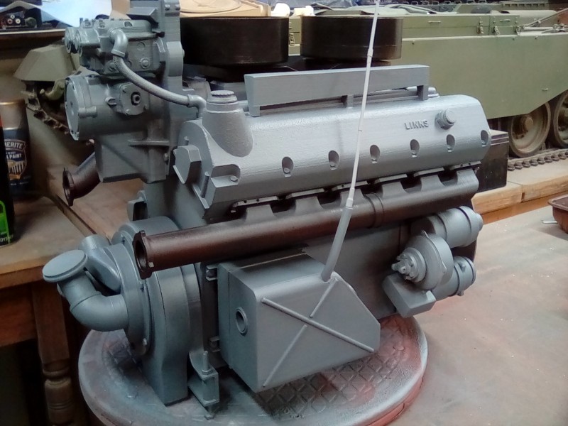

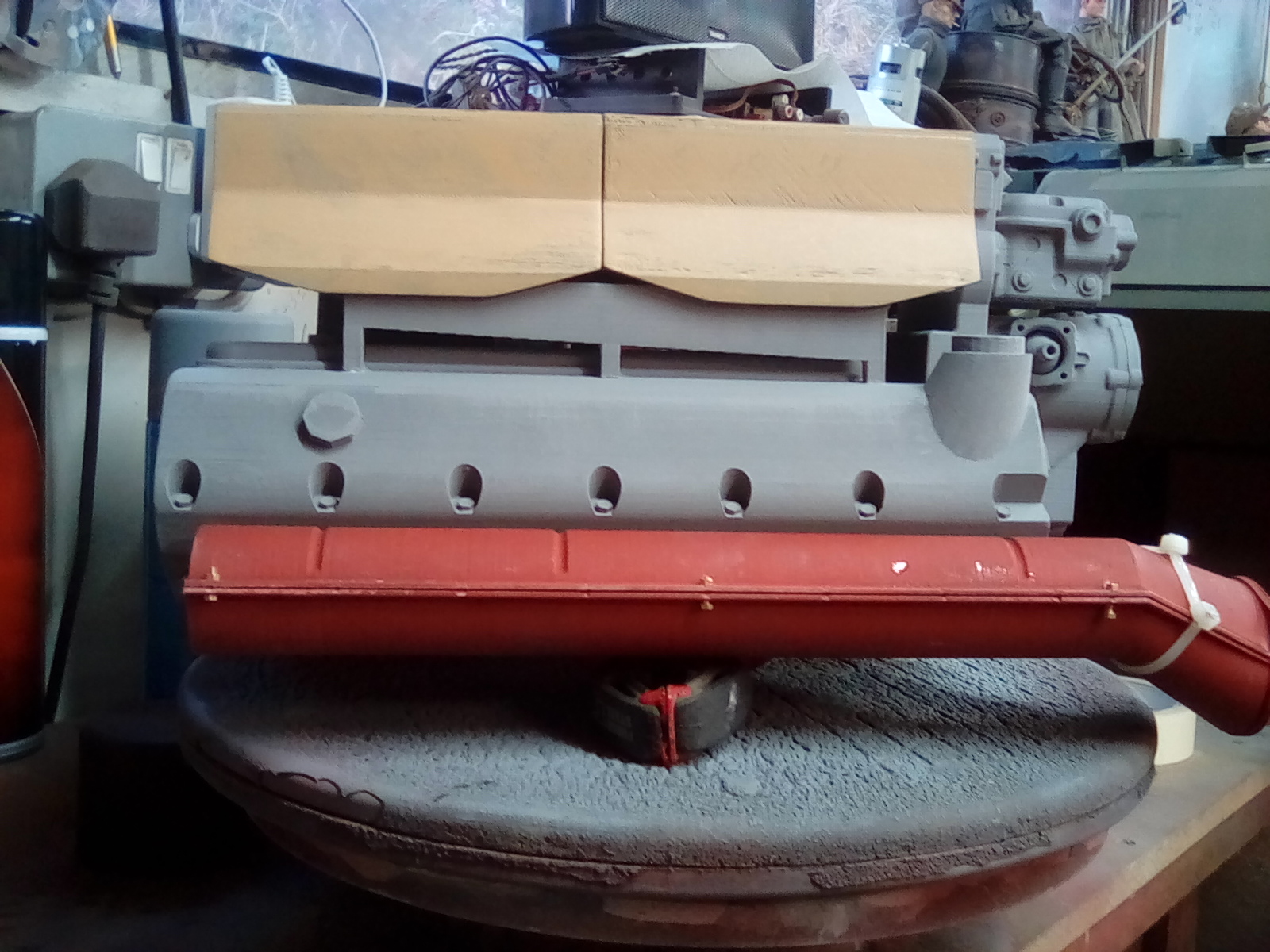

A little more detail to the Maybach, it was not my intention to go into this much detail but I'm enjoying it immensely. The front and back of the block/head pieces should arrive very soon.
I didn't like the aluminium head colour so I've gone for the Weald Foundation Jagdpanther German grey/blue shade.

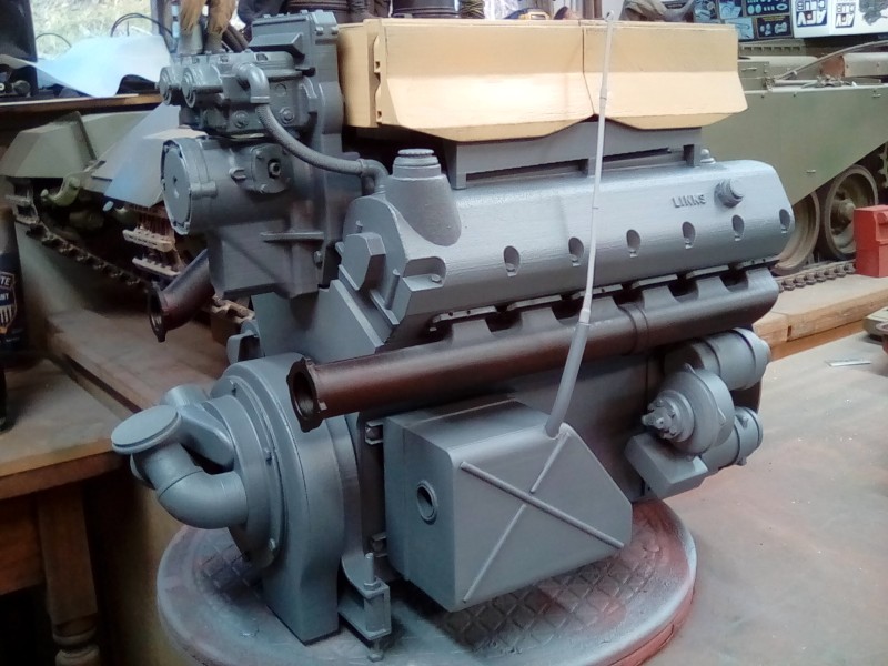

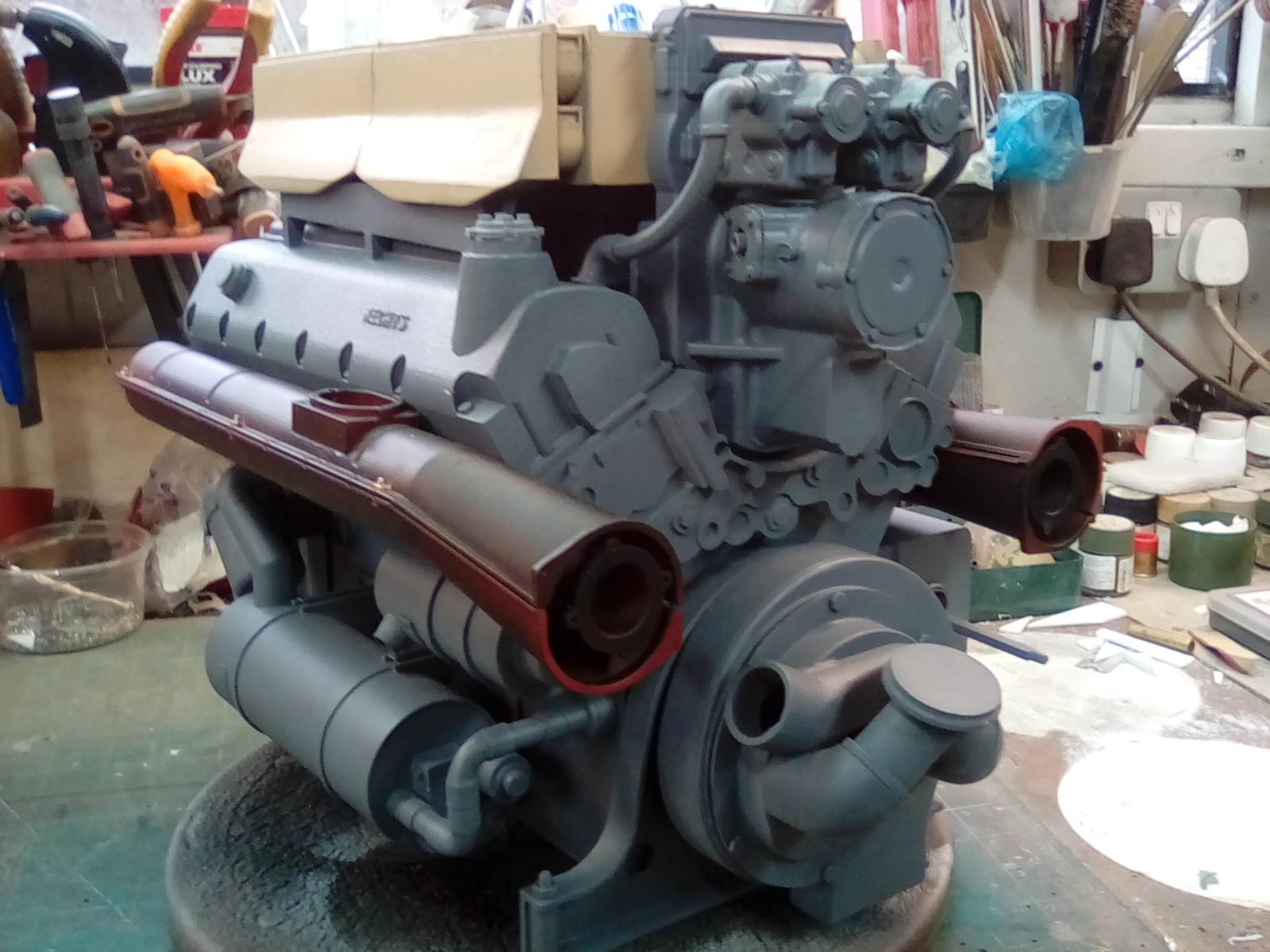

It's getting ridiculous now but I'm enjoying every minute, soon be on to the plumbing.
I now know what all the ancillary units are.
Is the motor a P45 or a P30?

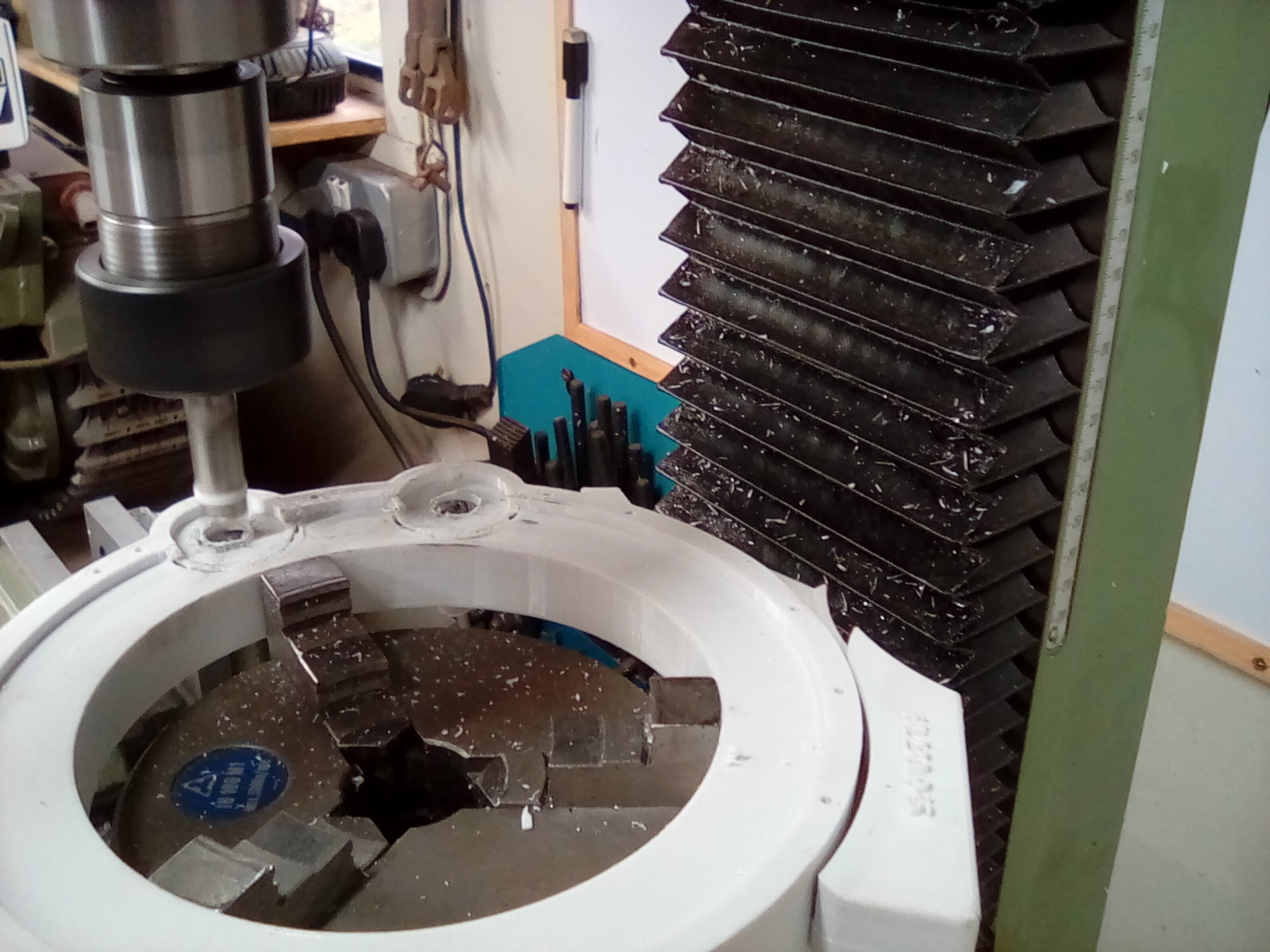

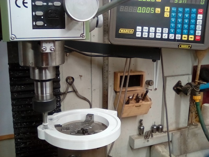

Don't know how to delete it, so I will drop a couple of the machining photos in instead.
You can appreciate just how big the parts are once mounted on my milling machine
I'm milling the holes for the starter gear position bushes, plural as there are two.

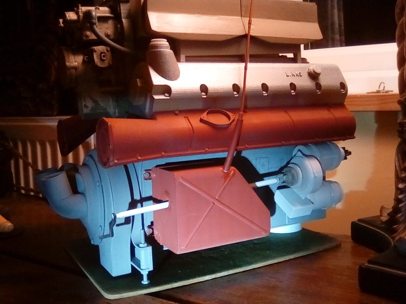

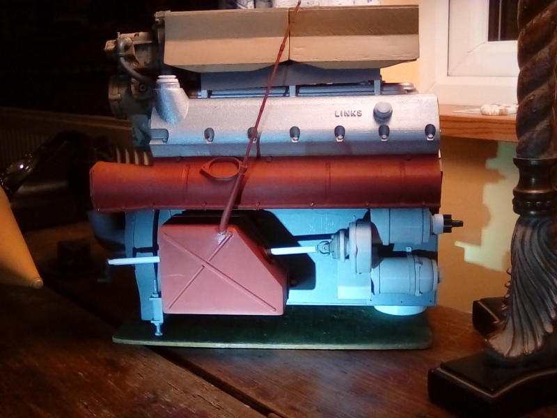

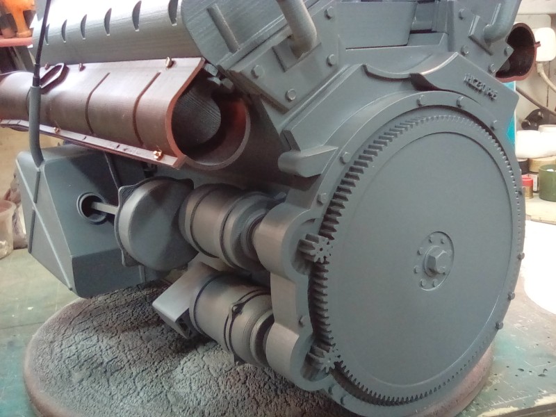

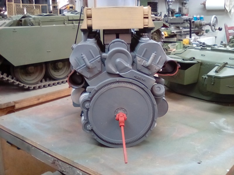

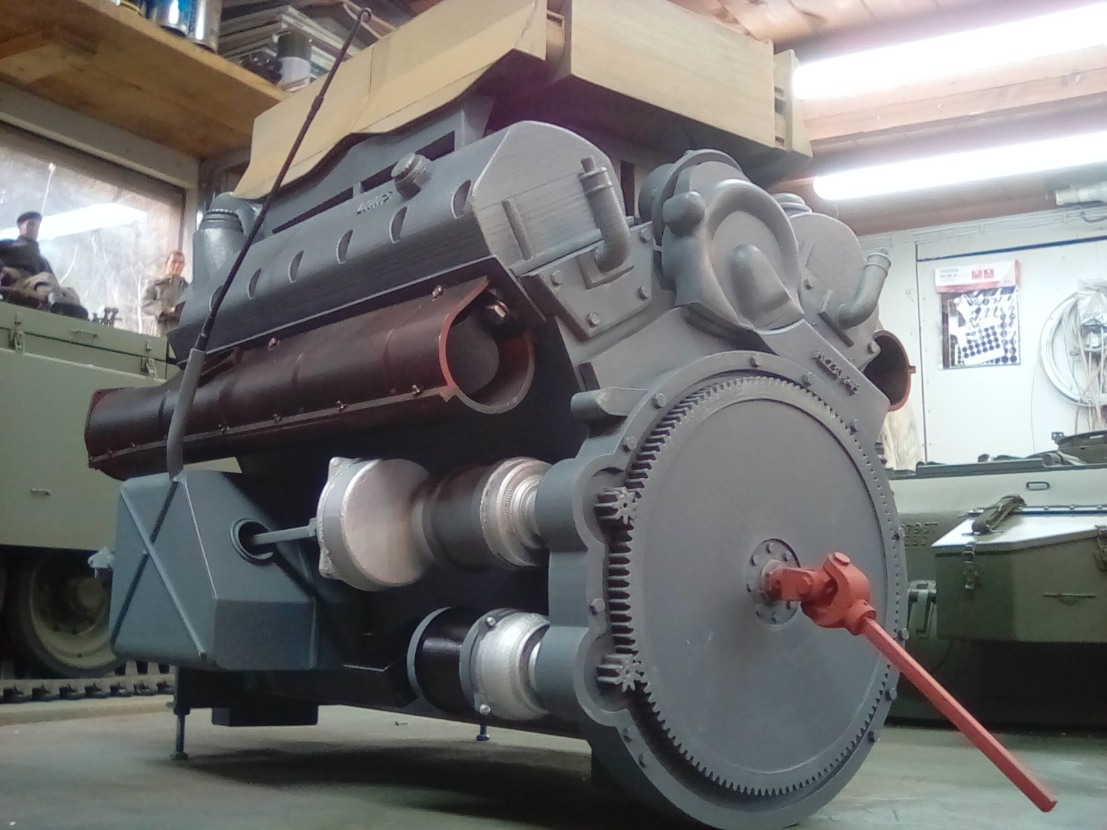

Couldn't sleep last night so spent some time detailing and painting the Maybach.
A good cad example of the flywheel that I shall attempt to make
I think that the universal joint needs to increase in size a little, there's no way that could handle around 600 hp
I must try and make a flywheel from my collection of stl files, I'm hoping with a little tweaking in cura  the chieftain flywheel may work
Good old milliput was used for the generator driven gear casting bulge , what would we do without it.
The water pump housing was made using an Armortek Tiger one turret roof vent and a Armortek Centurion fitting with milliput to form the impeller snail profile
