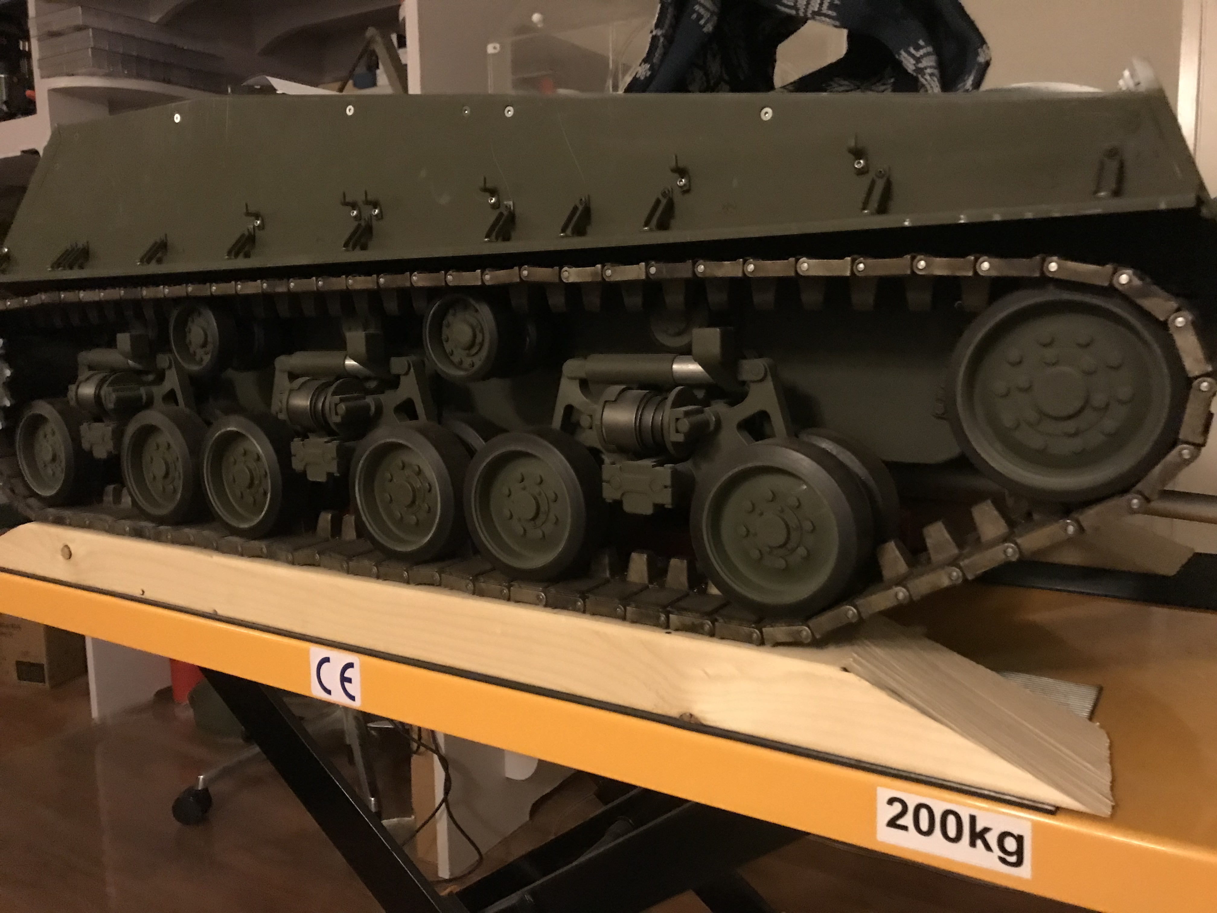

Just wondering about upper track level on the AT kits . When looking at the real easy eight the top of the track runs level all the way through to the rear idler . Looks like the kit needs one or two more links so the idler can be wound up higher or the bracket move it up a hole Just my thoughts . Has anyone else looked at this ... I have and easy coming my way soon , Dale

The upper track level was also a concern for me when I compared the model pictures with the real ones. But after assembly it worked out fine, it is possible to turn the idlers high enough so the top of the tracks is level, this with original amount of track links.

Yes Chang I got straight onto Phil when I saw the add . The chance of an easy eight for sale down under is rare ... Nice to have a brake from torsion bar suspension so I can spend more time on detailing the hull ...Erik nice to see we are on the same detail track . Yes your setup looks spot on make a very big difference to the over all look . I really like your dark olive drab I will be etch priming with Wattle super etch black primer then dark olive drab like you ... Dale
