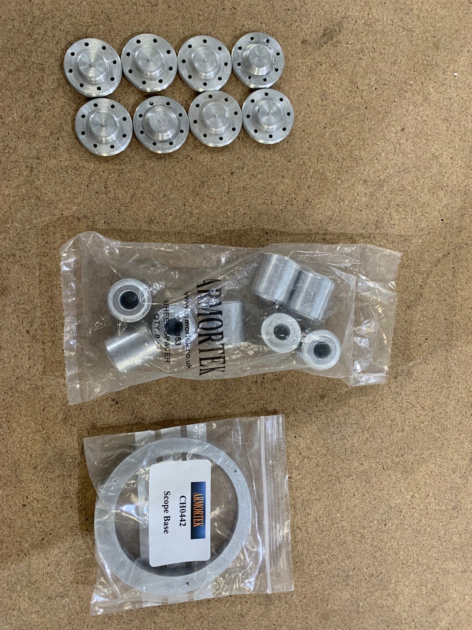

Hub caps drilled and tapped for tiny hex head bolts

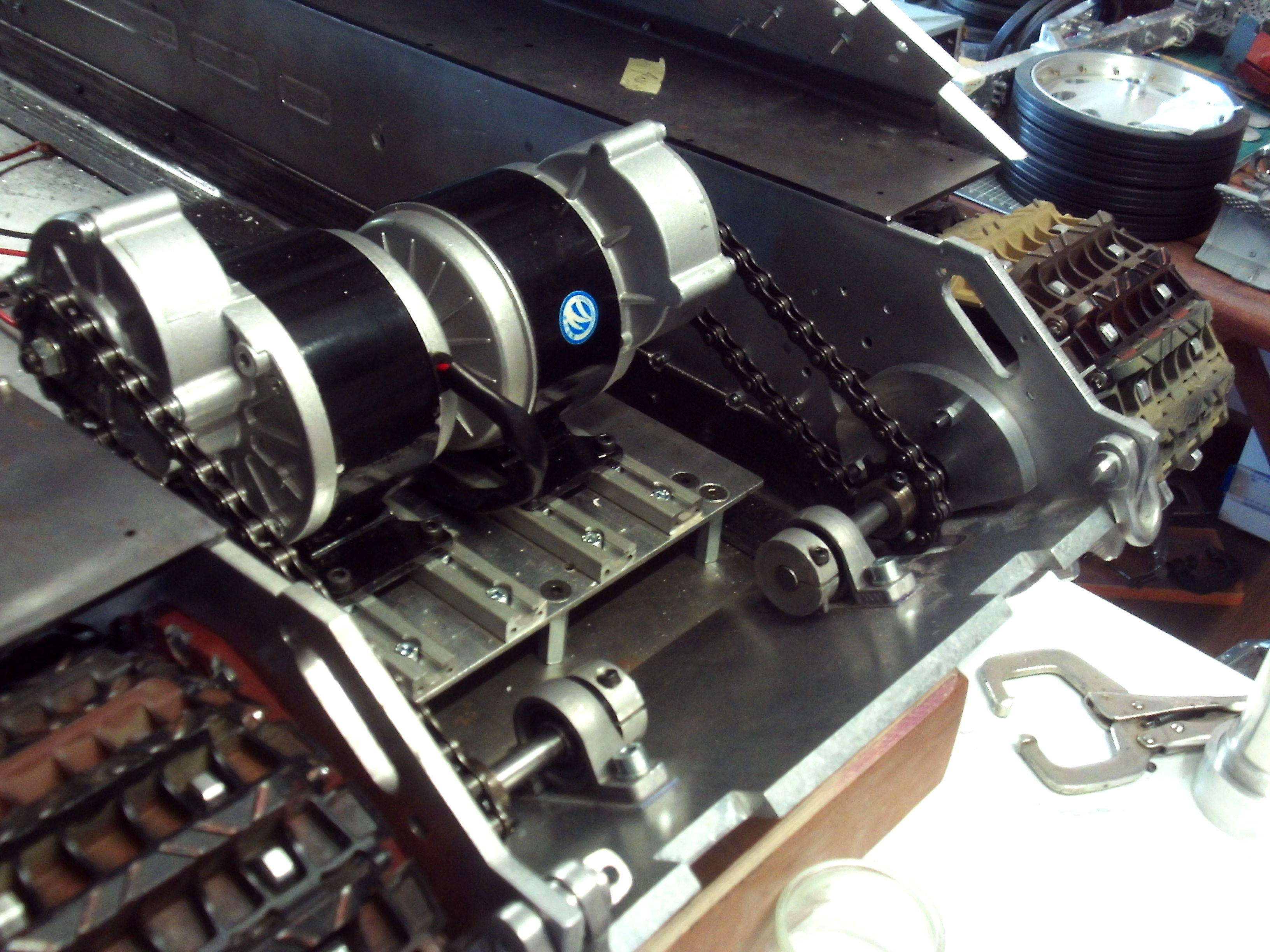

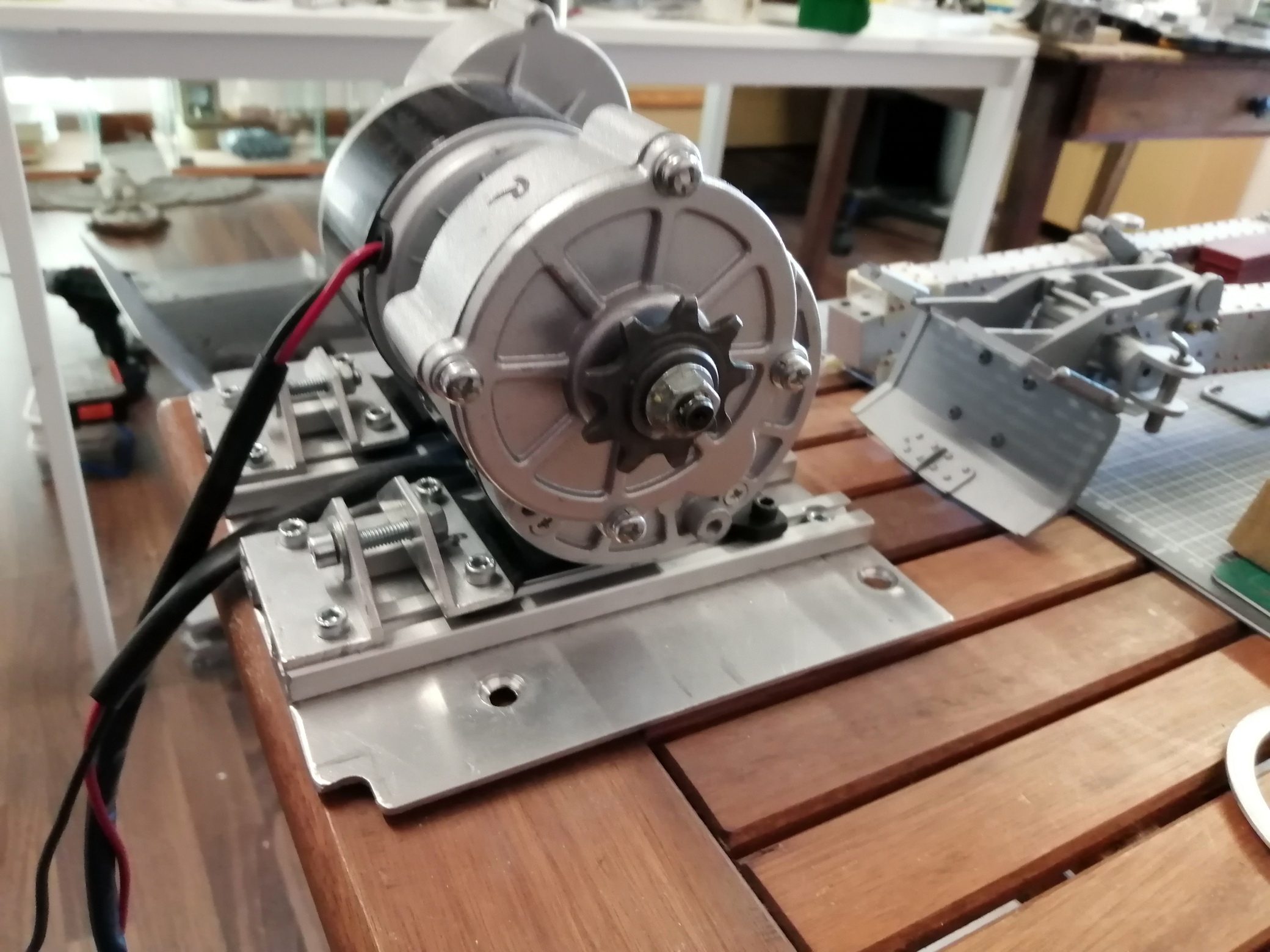

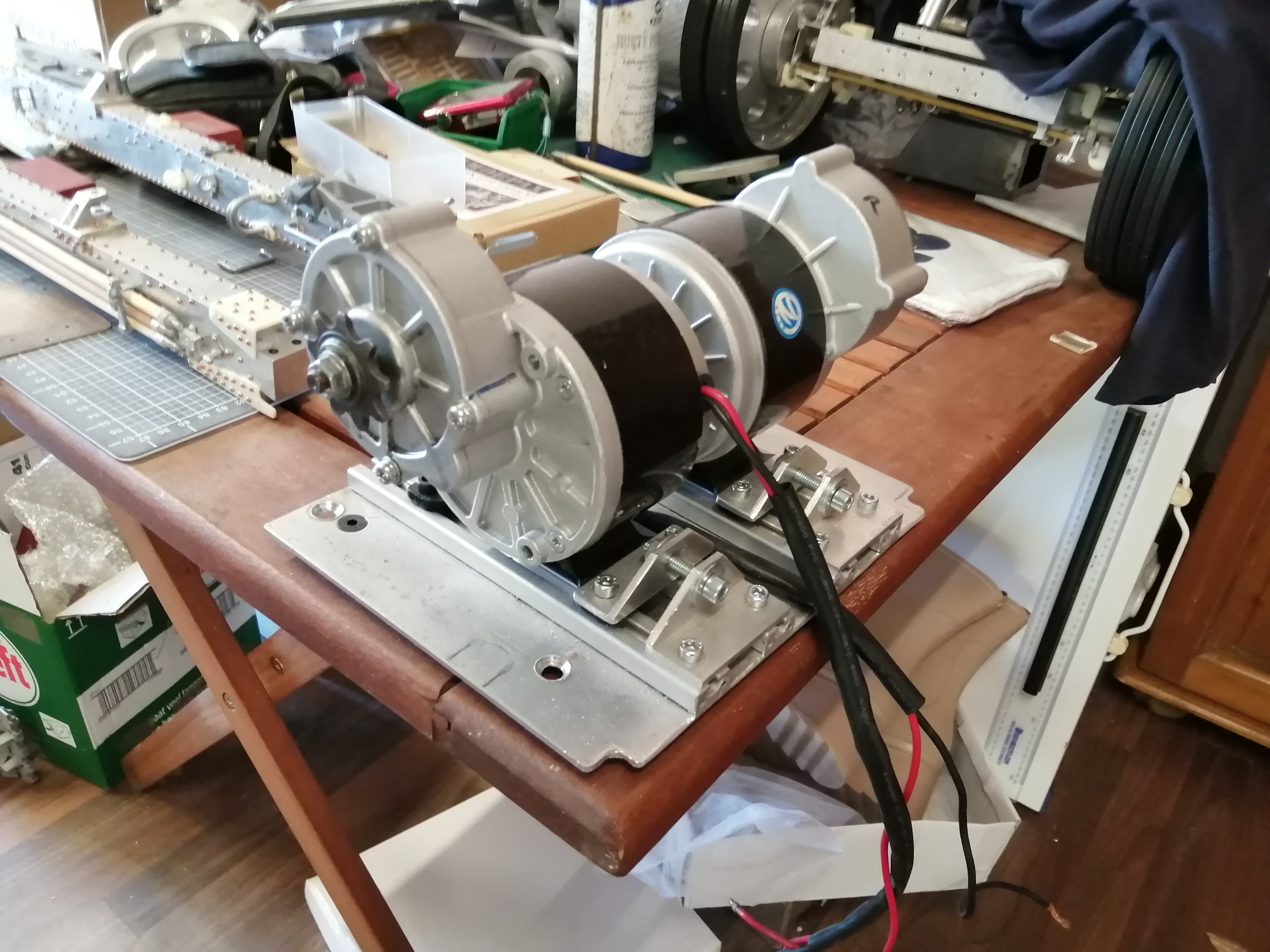

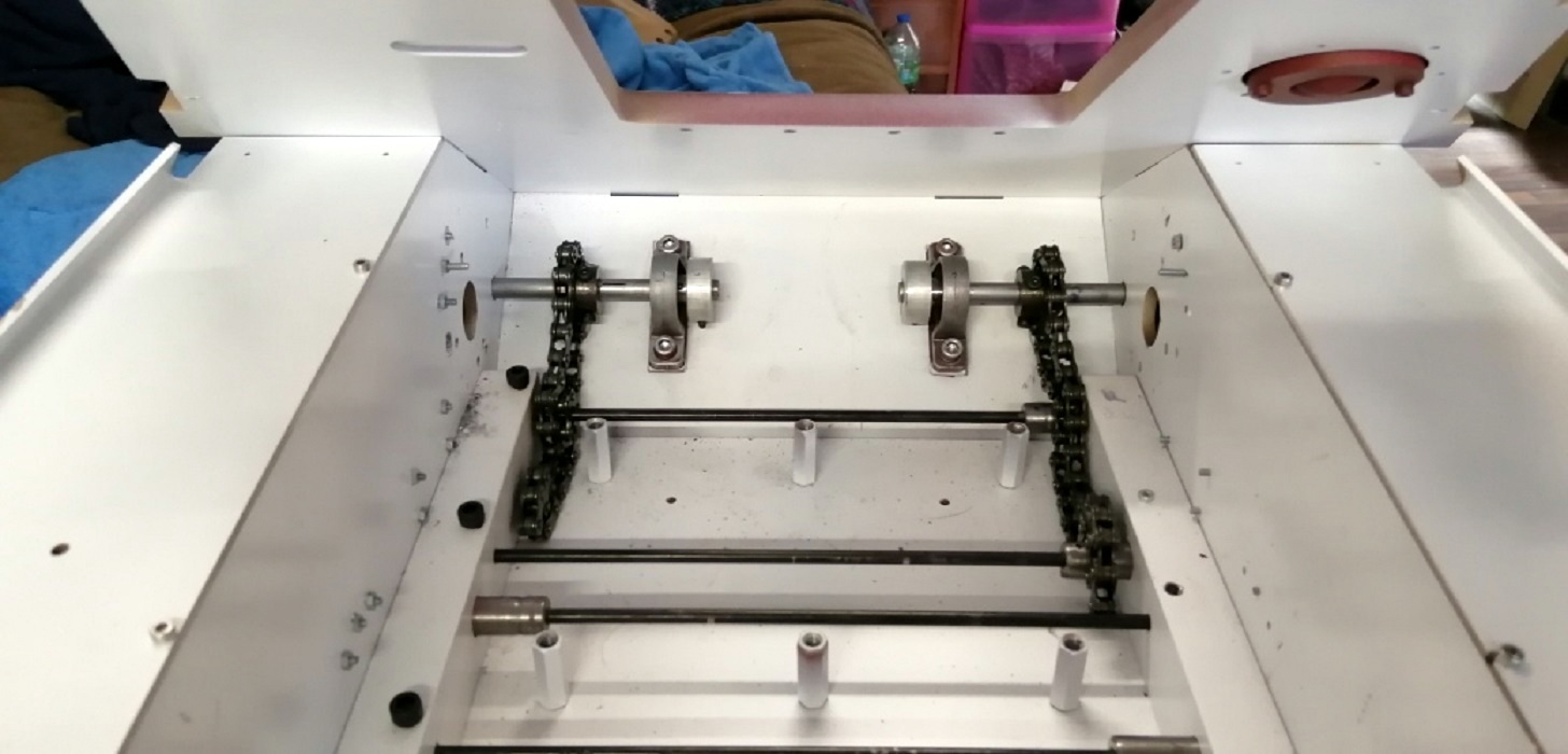

As I was using a different motor and drive system, the sprocket drive shafts extend into the hull with the inner ends supported by a pair of self aligning “plumber block” bearings and locking collars. Drive is transmitted by a chain and cogwheel system at 1:1 ratio with the 12 volt motors having a built in reduction gear set.
The motors are mounted on an adjustable sliding bed with tensioning screws and the whole unit fitted to the hull on 6 hexagonal standoffs which space them just above the hull side bars. Testing proved the gearing to be just right with the sprockets turning smoothly and quietly. Chain adjustment was also dead easy thanks to my tensioning system. And yes, I could have bought Armortek motors, side gears, etc. but my budget was not infinite so I stuck with the motors taken from the donor vehicle.

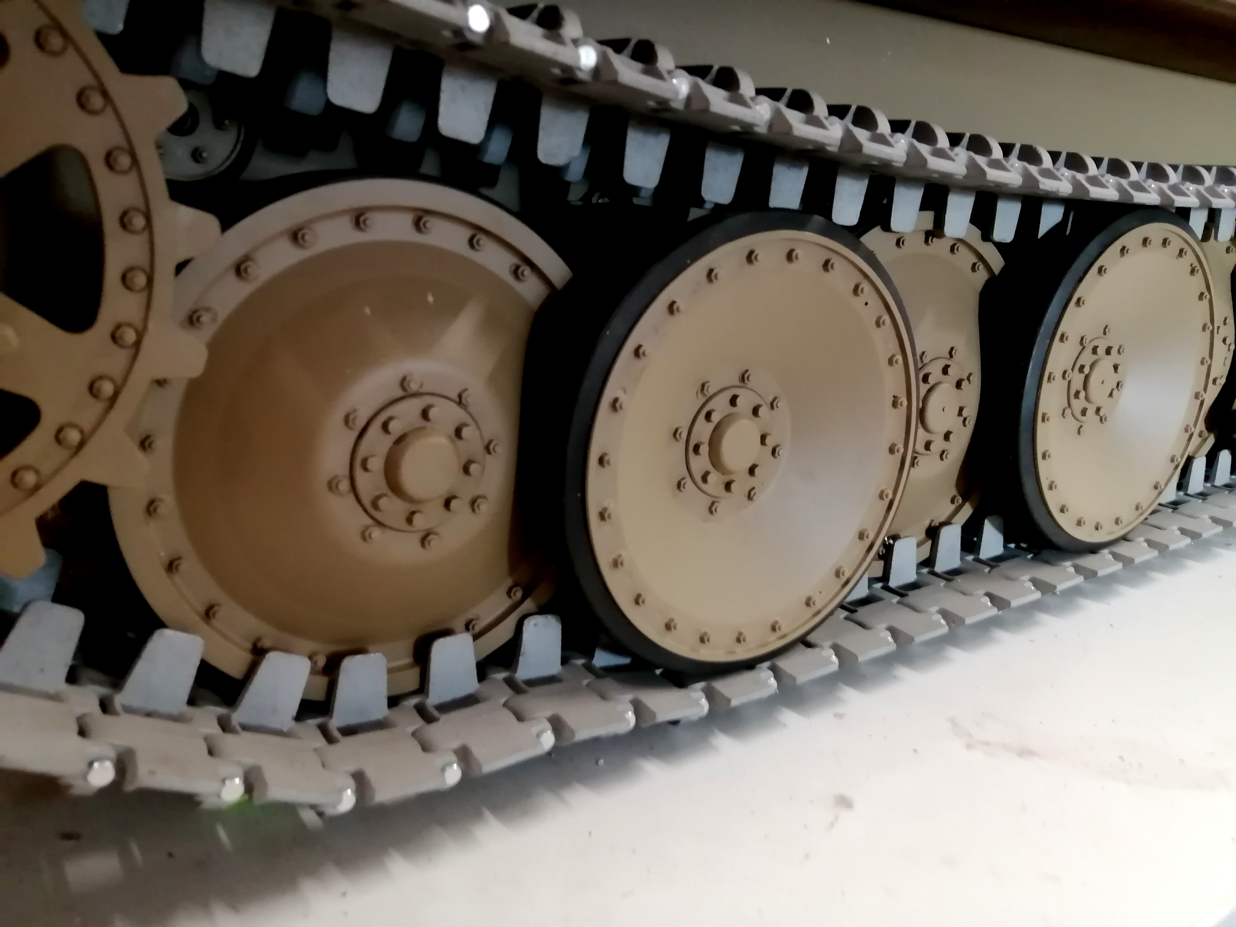

As already mentioned, I inherited 32 modified FOA plastic wheels with new Armortek tyres and custom spacer hubs. These I replaced with new aluminium wheels, again courtesy of Monique. However, the only ones available were really old stock they took over from Mark and Gill which, for some bizarre reason, had the wrong number of bolt holes – 20 instead of 24.
Up until 2014, I had been running a Wehrmacht vehicle restoration business in the UK and latterly in France. One of my projects was the restoration of the wheels, tyres and some track for the Weald Foundation JP so I was somewhat familiar with these wheels. Making 32 good examples from over 50 we had sourced throughout Europe, I knew that the Panther used a 24 bolt pattern. The original Ausf D stared life with 16 but, following many failures in the field, were modified with reinforcing rivets 'twixt the bolts until the new 24 bolt models became available. Not exactly a good idea as tyre removal with riveted rims would have been nigh on impossible!!
One could have ignored this discrepancy but it offended my eye and I couldn't just leave them as is. Therefore, all but 4 holes on each wheel were filled (the ones at 3, 6, 9 and 12 o'clock positions were accurate), a marking jig created and 320 fresh holes drilled. The dummy nut/studs supplied by Armortek were Loctited and pressed into place prior to blasting, etch priming and top coating in RAL 7028 Dunkel Gelb. Laborious work but well worth the effort. Kian tells me the new Panther G has the 24 bolt pattern wheels!

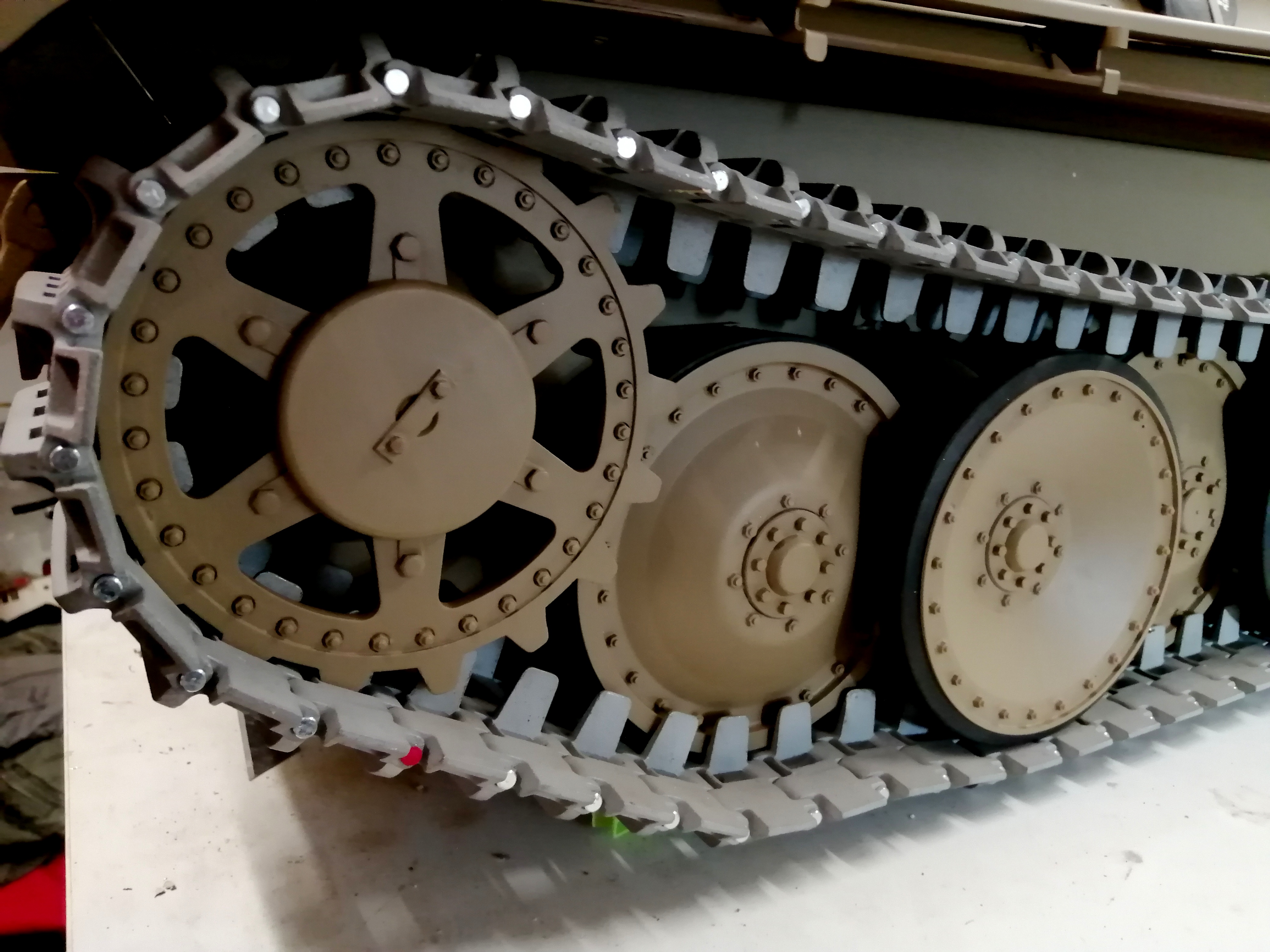

32 sealed bearings were acquired from France's largest online bearing supplier at a very good discounted price which then allowed the wheels to be fitted. New hub caps came from Monique which I then modified by drilling and tapping to accept 128 tiny M2.5 hex head bolts, Kees' tyres were fitted and voila, wheels done!
The tracks from the donor vehicle were well used with all the chevrons shaved off from use on concrete and rough surfaces, the pins were all corroded and generally, the tracks looked quite rough. Dismantling, glass bead blasting all 174 links and the fitment of new pins with the push on locking washer system in lieu of tiddly split pins, saw the tracks done and fitted. I used the “golden rivet” master pin method of joining the free ends – i.e a special pin with an M3 thread cut on the washer end which uses a tiny nyloc nut to secure. The pin flat head is painted red to aid with locating same.

12 volt geared motors from the donor vehicle
Trial fit of drive system

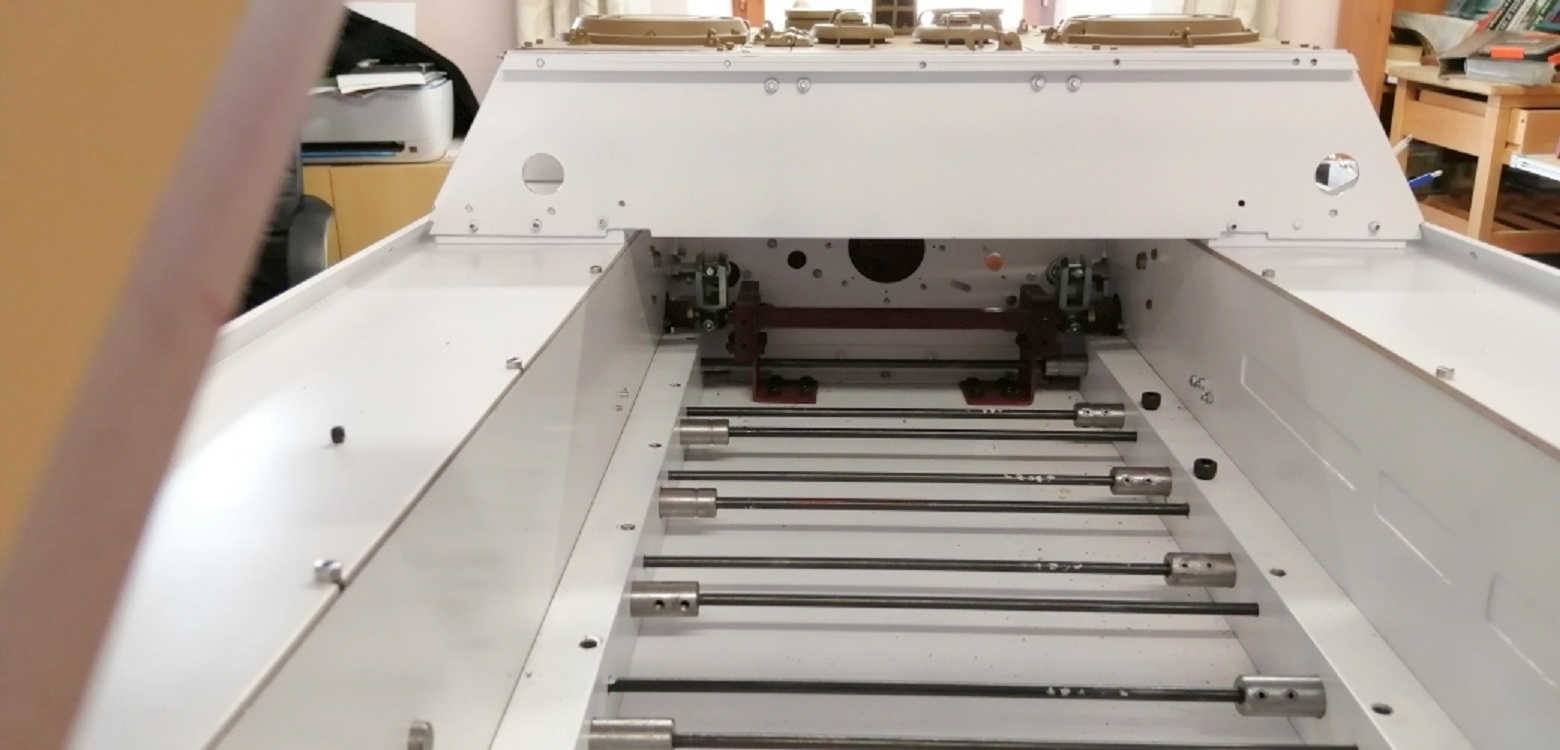

Internal shot of hull before drivetrain installation
