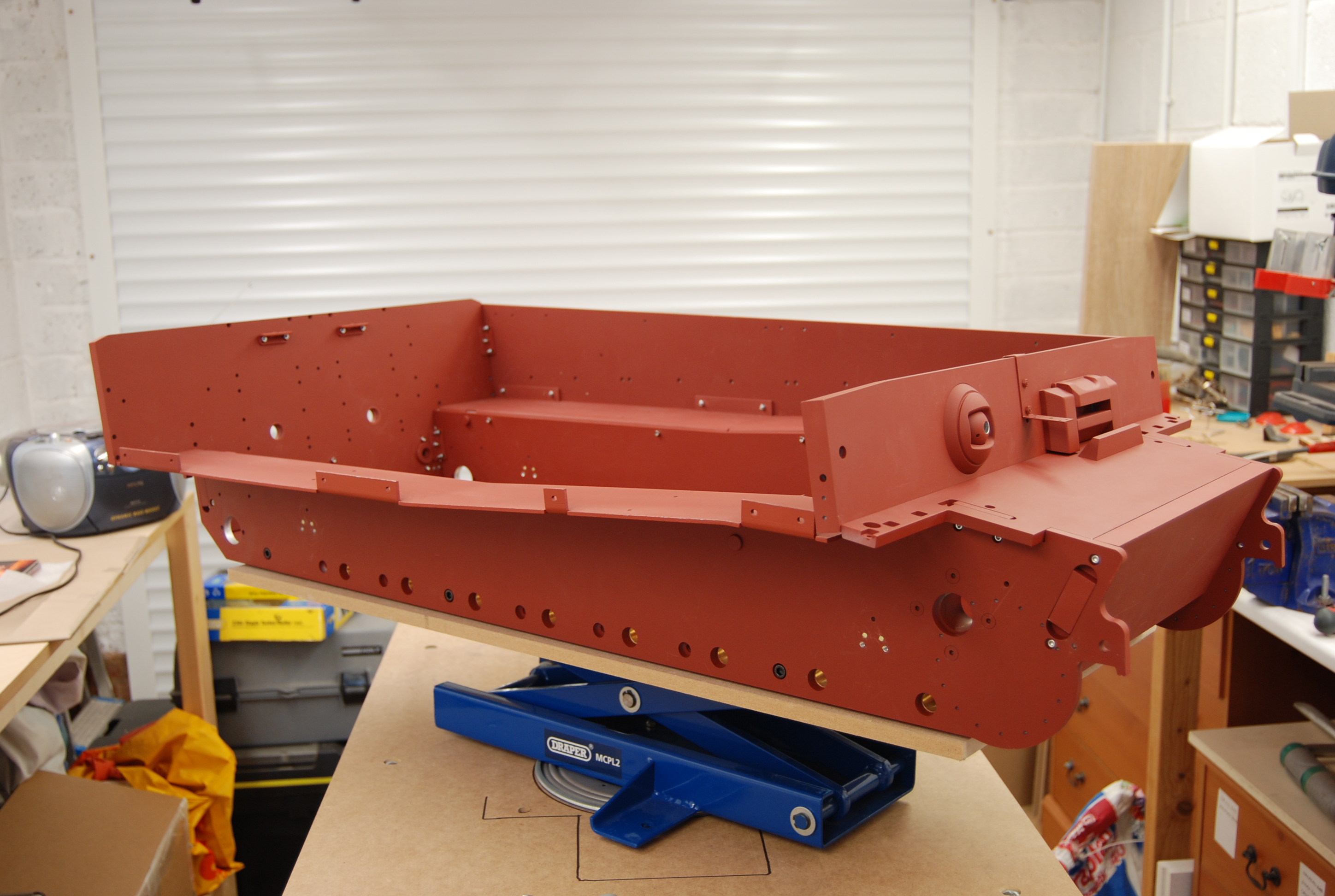

Re: Best height for model assembling bench.
Hi Doug
I bought myself a 250kg lift table with a screw thread jack rather than a hydraulic actuator. I found my previous hydraulic lift table could sink with time. I was a bit wary of having all that weight held up using only hydraulics and no back up locking method.

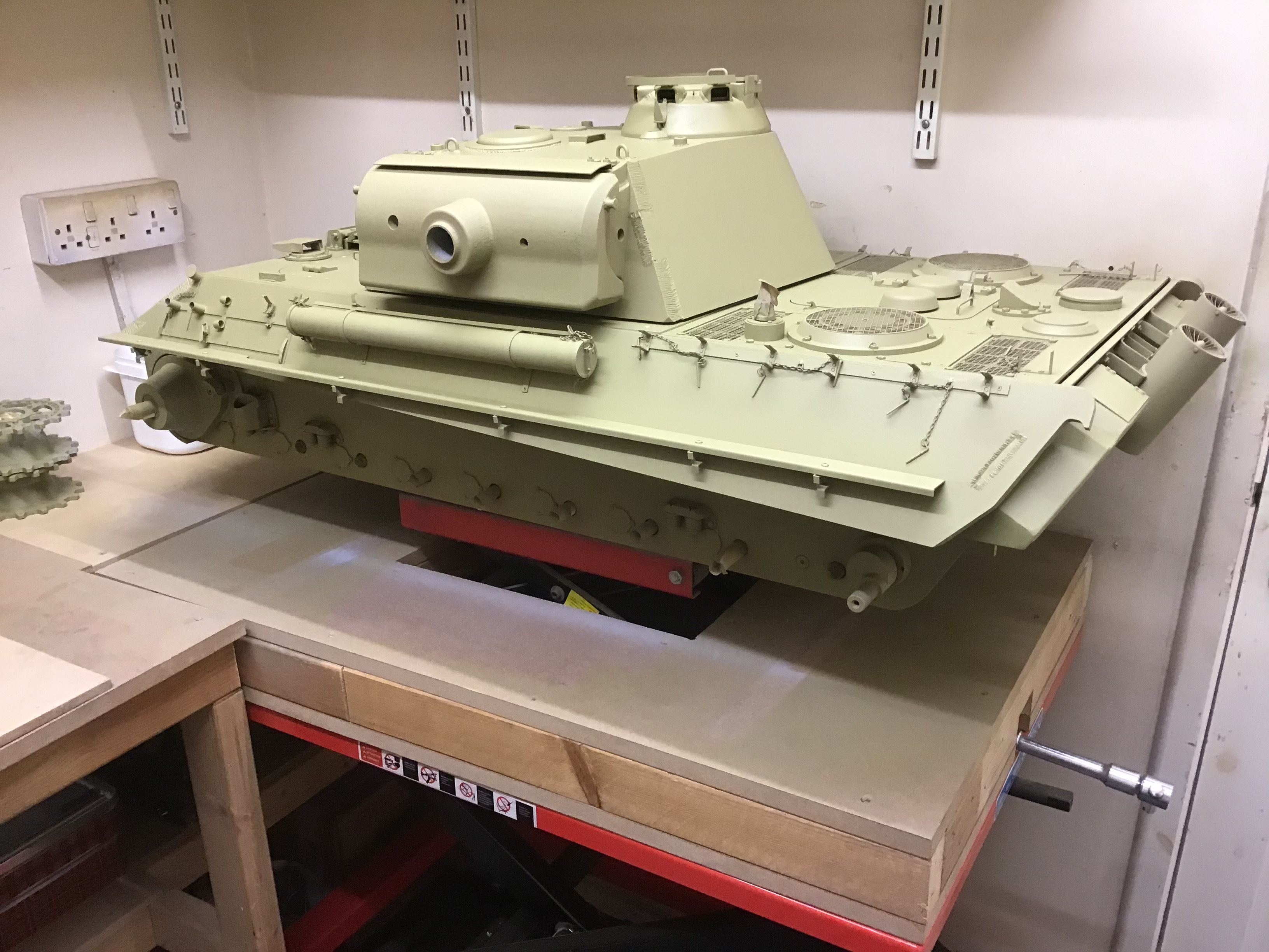

This is the set up I have.
Motor cycle lift built into the lift table top, this makes working on the wheels, tracks and drive system easy and safe.

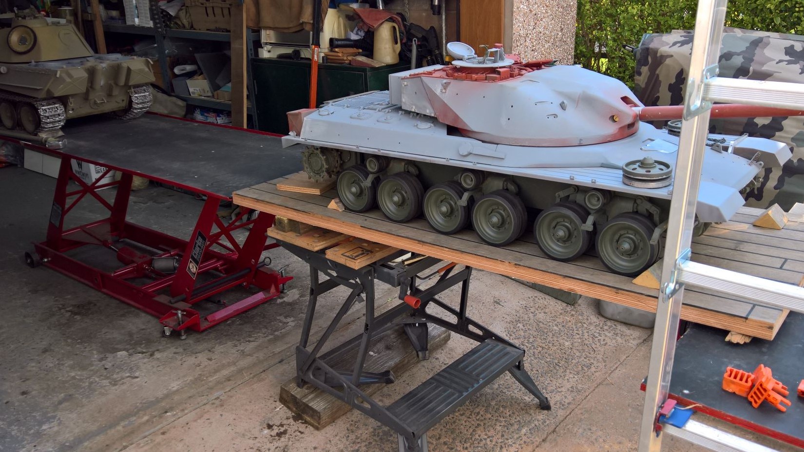

Hi Doug.
Welcome to the world of Chieftain.
If you ignore the Mr. H. Robinson extension, the motorbike lift I acquired was a 2nd from a well-known high street supplier of mechanical stuff.
It is hydraulic in operation and wheeled. once raised a 1" steel bar prevents the unit sinking, after releasing the hydraulic pressure; holds two vehicles too. This you could be useful as the Chieftain's turret requires quite a bit of space.
I also rivetted rubber onto the deck and chocks are ever present.
hope this is of use and look forward to your build.
Cheers Charles
