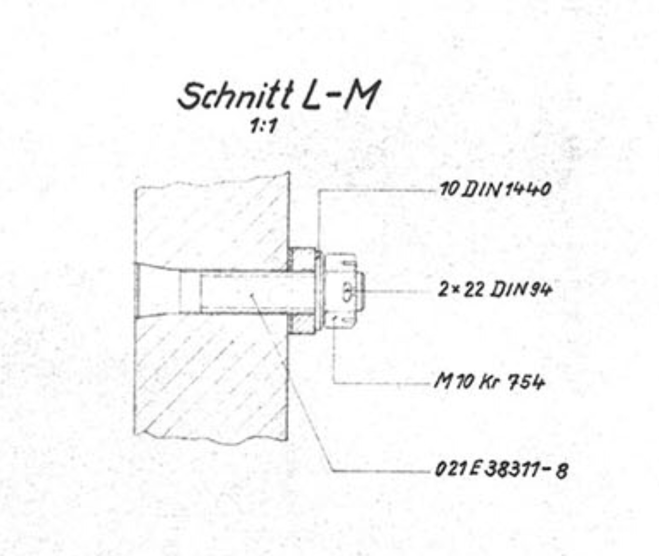

Hi Dan,
They used bolts with a coned top pressed down in the hole from below with castle nut and spacer.
This type of fastening was a common use on Panzers on a number of places.
The drawing below gives a hint how they looked like.
The hex ones seen on the Beda Panther is a post war addition.
Hope this was of any use for you
Kind regards
Kent
Kind regards
Kent

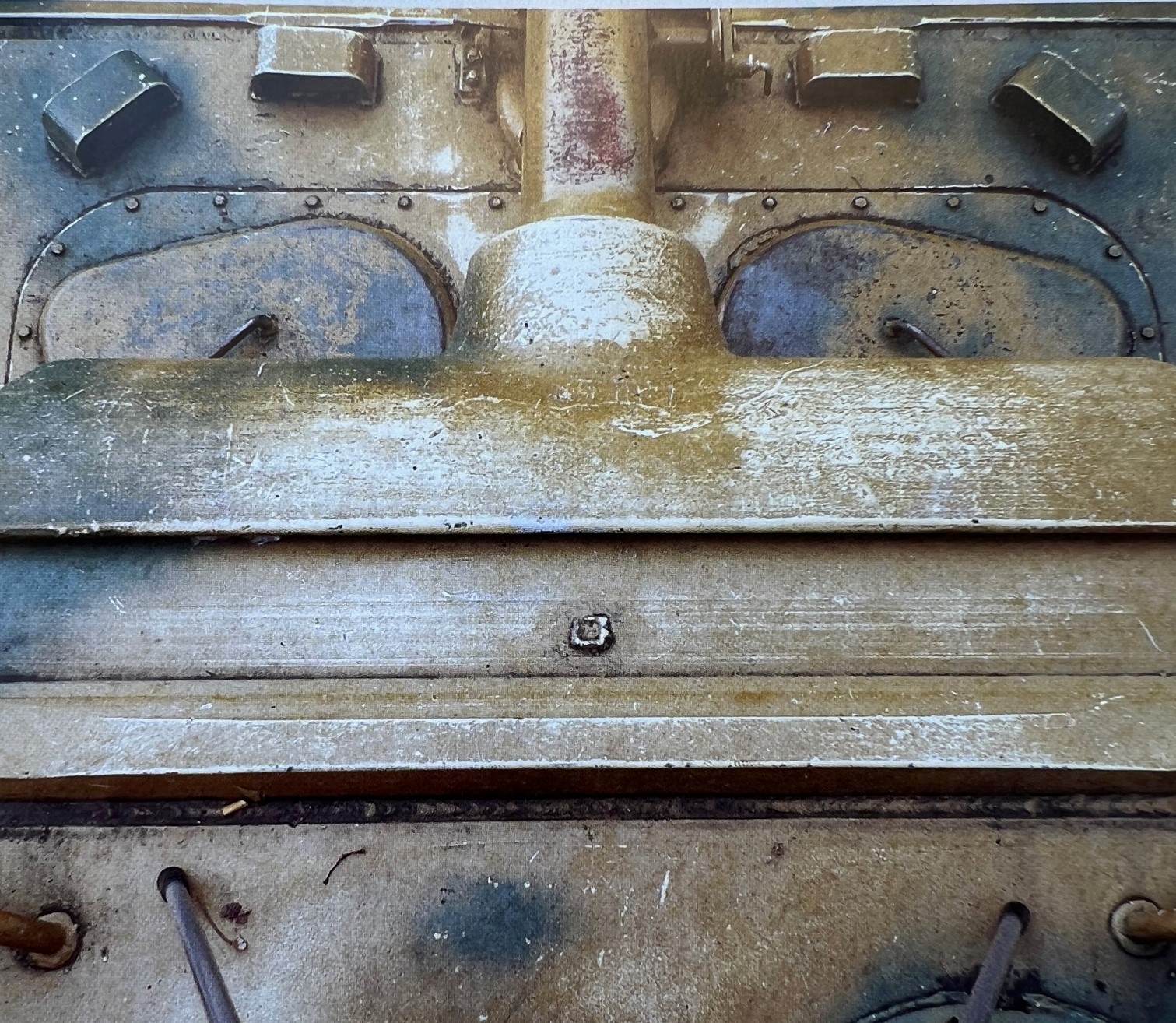

You can see them here in this pic.
/Kent
/Kent
