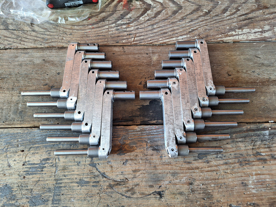

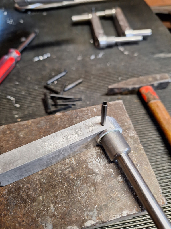

I started on the famo.
![Image](https://i.postimg.cc/Y2xv9bWF/20230528-000830.jpg)
Re-tap the thread (deburr)
![Image](https://i.postimg.cc/vZx8Wzc3/20230528-131507.jpg)
Drill and put m3,2 split pins in the suspension arms.
![Image](https://i.postimg.cc/sDD4DBvV/20230528-152717.jpg)
[img] ttps://i.postimg.cc/x1mRBwXH/20230528-161458.jpg [/img]
![Image](https://i.postimg.cc/tCC8Q4b6/20230528-152634.jpg%20%20%20%0A%5Bimg%5D%20%20%20https://i.postimg.cc/x1mRBwXH/20230528-161458.jpg)
![Image](https://i.postimg.cc/tCC8Q4b6/20230528-152634.jpg)
![Image](https://i.postimg.cc/x1mRBwXH/20230528-161458.jpg)
Best regards Yves

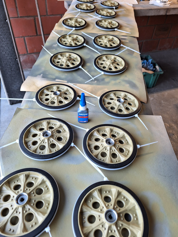

Hello,

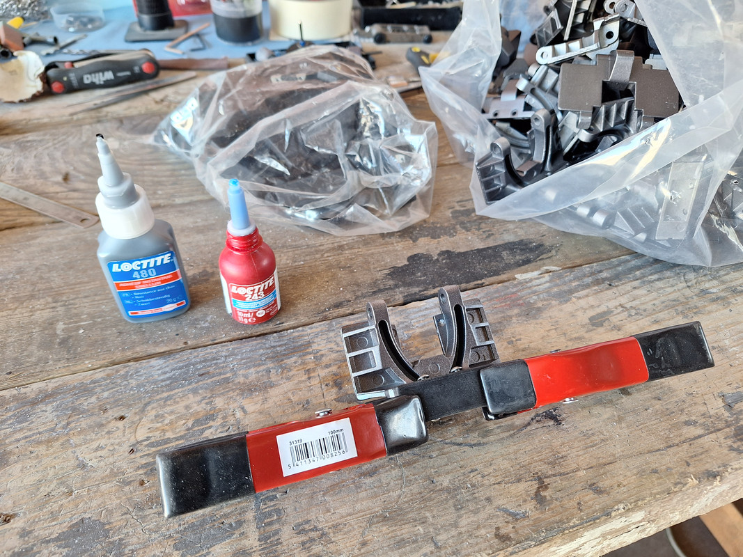

A little update on the Famo,

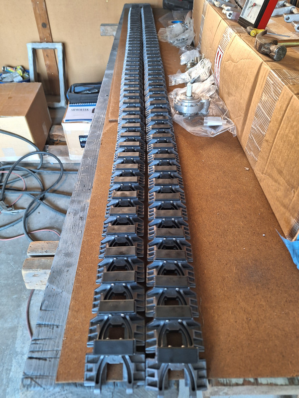

Work this weekend on the tracklinks.
![Image](https://i.postimg.cc/3xqX9fnr/20230601-183320.jpg)
I put Loctite 480 on the sides of the rubber pads.
For the screws i use loctite nr 243 ( blue )
![Image](https://i.postimg.cc/qM56dhnj/20230604-081507.jpg)

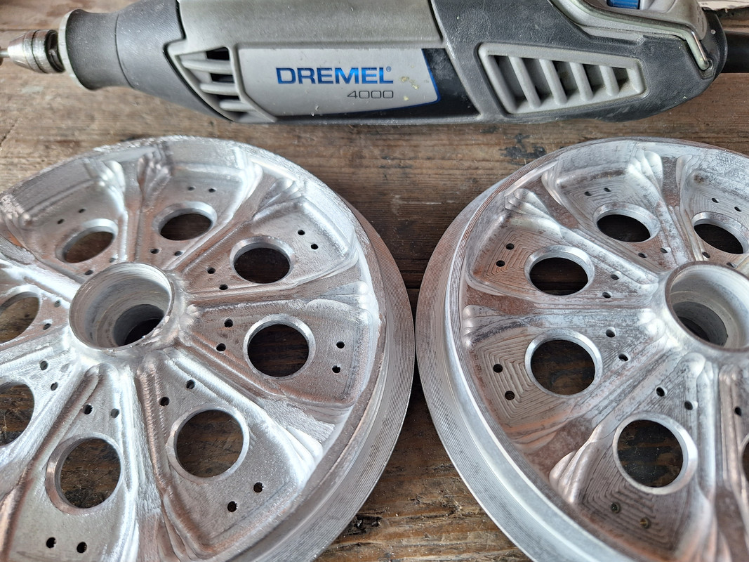

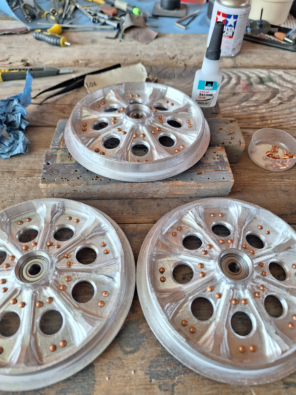

![Image](https://i.postimg.cc/MT6pBqVn/20230604-090201.jpg)
![Image](https://i.postimg.cc/qM56dhnj/20230604-081507.jpg%20%20%20%20%20%20%20%20%20%20%20%20%20%20%20%20%20%20%20%20%20%20%20%20%20%20%20%20%20%20%20%20%20%20%20%20%20%5B/img%0A%0AI%20also%20started%20on%20the%20wheels%20%28%20a%20lot%20of%20sanding%20to%20do%20%29%20with%20a%20Dremel%0A%5Bimg%5D%20%20%20%20%20https://i.postimg.cc/MT6pBqVn/20230604-090201.jpg)
Also put the rivits in the wheels
![Image](https://i.postimg.cc/dVGsSL97/20230604-102818.jpg)
Al the rivits are done, now i started on the idler wheels.
Best regards Yves

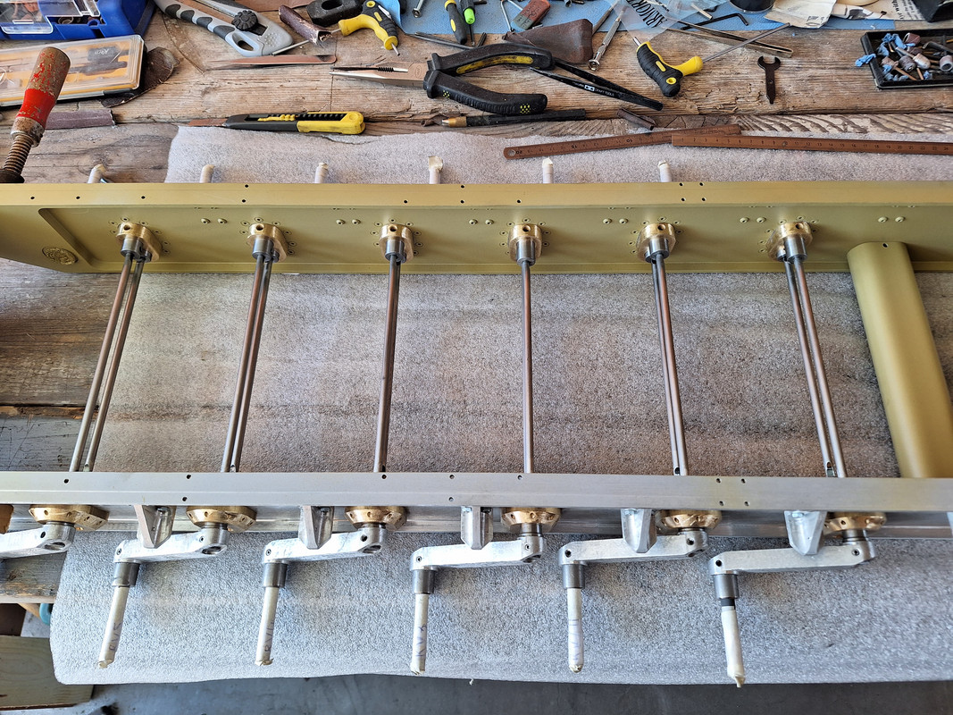

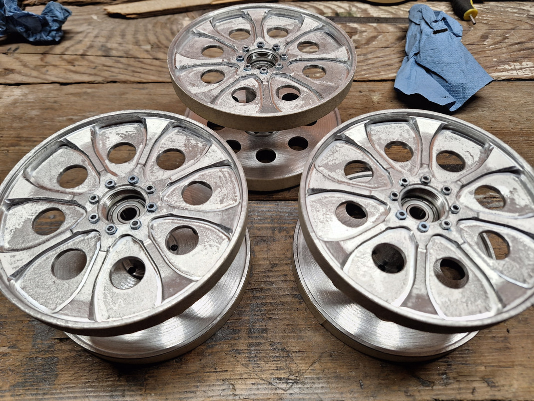

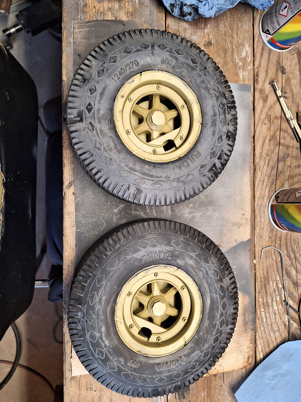

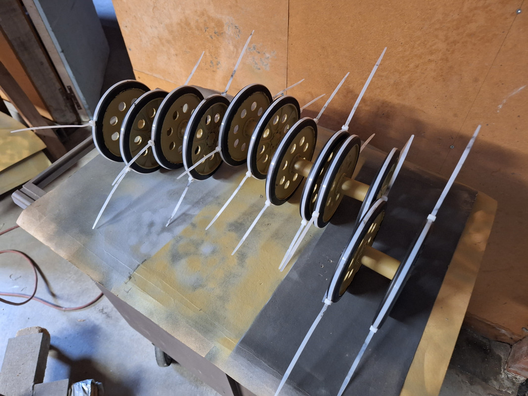

Hello,
A little Famo update,
Working on the wheels and sprockets and torsionbars
![Image](https://i.postimg.cc/j5W1T28f/20230604-102818.jpg)
![Image](https://i.postimg.cc/151dx9Dg/20230606-211950.jpg)
![Image](https://i.postimg.cc/hvtfhFdV/20230606-212005.jpg)
![Image](https://i.postimg.cc/g2ZrxHnt/20230606-224306.jpg)
![Image](https://i.postimg.cc/L6r8FgNt/20230621-193939.jpg)
![Image](https://i.postimg.cc/3x5Yc5x9/20230621-193954.jpg)
![Image](https://i.postimg.cc/HWrJGmTC/20230621-194002.jpg)
![Image](https://i.postimg.cc/dVj3RtjG/20230625-153726.jpg)
![Image](https://i.postimg.cc/7PzxMZxb/20230625-153744.jpg)
Suspension bars test fit.
Best regards Yves

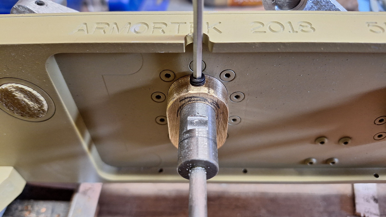

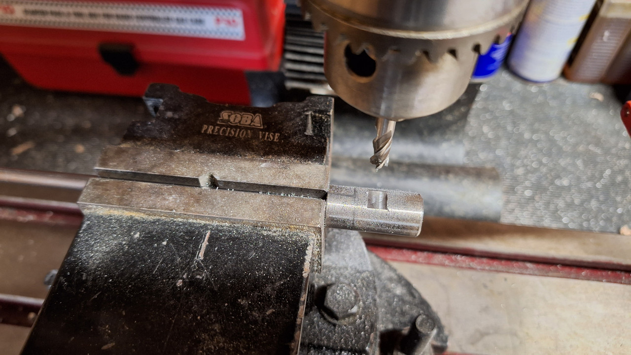

Did some little mod on the torsion fix ends.
I cut a flat surface for the grub screws.
![Image](https://i.postimg.cc/9XD7Sq0Z/20230703-193709.jpg)
![Image](https://i.postimg.cc/k46gjKs5/20230703-192552.jpg)
Best regards Yves

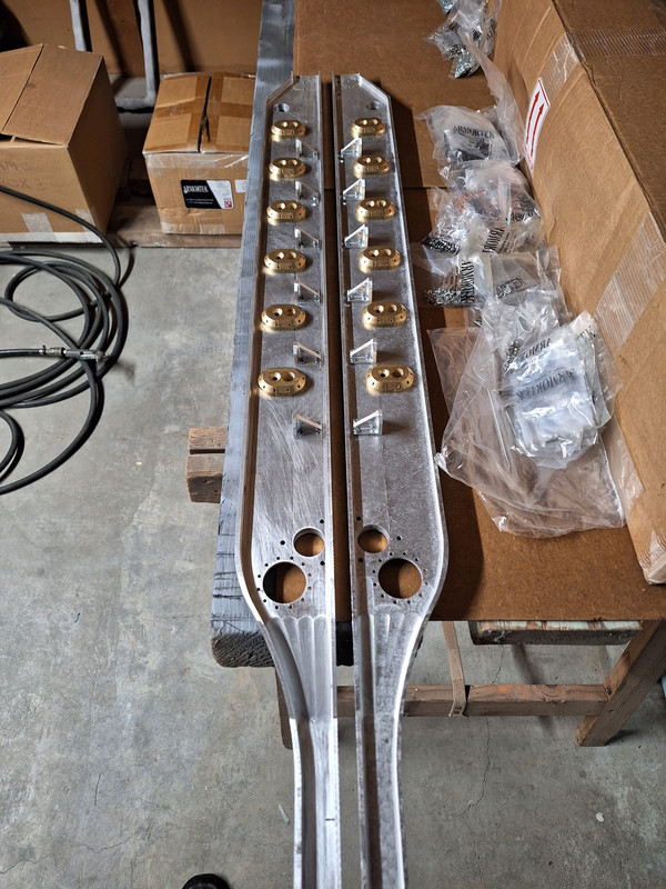

Is there sombody who knows what these are for in the famo build??

Those are back plates for the canvas tie downs.
There should be bent wire bits to go with them .
