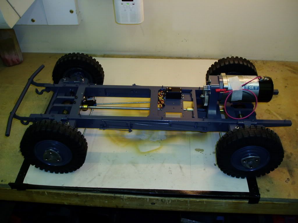

Hope fully this time you should see a couple of shots of my completed chassis.

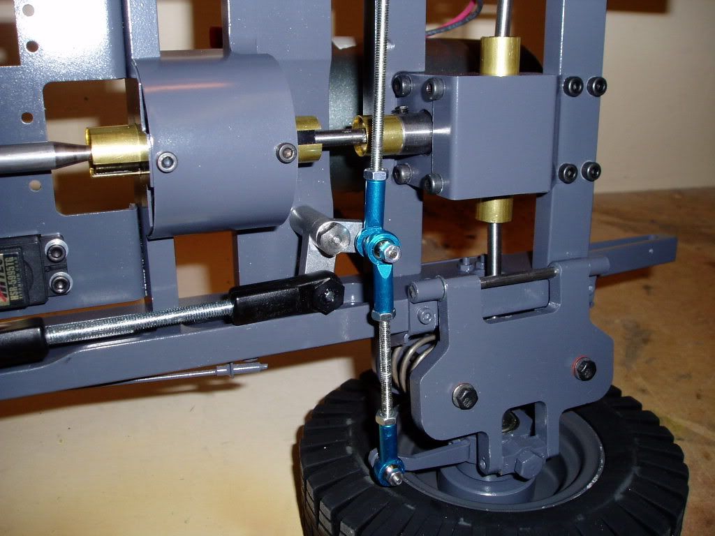

I have pinned the King pins, pivot blocks and hubs to make them more secure and i have also added sleeving to the cup joints to prevent the drive pins from dropping out.

First rate work, just like on your Panther. That is one tough looking chassis! It looks like a stout little bugger.

Good looking chassis Steve :D
Are the levers etc on the chassis rail part of the kit or have you scratch built them :?:

Your right it weighs a ton :shock: . Its a real handful with the body on and should put me in traction for a month if i try to lift it when completed.
The levers are not supplied but are easy to scratch build if you have suitable reference material.

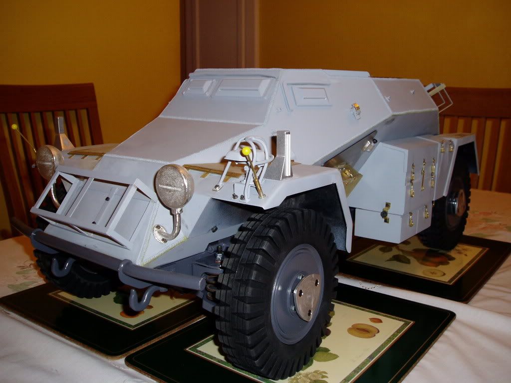

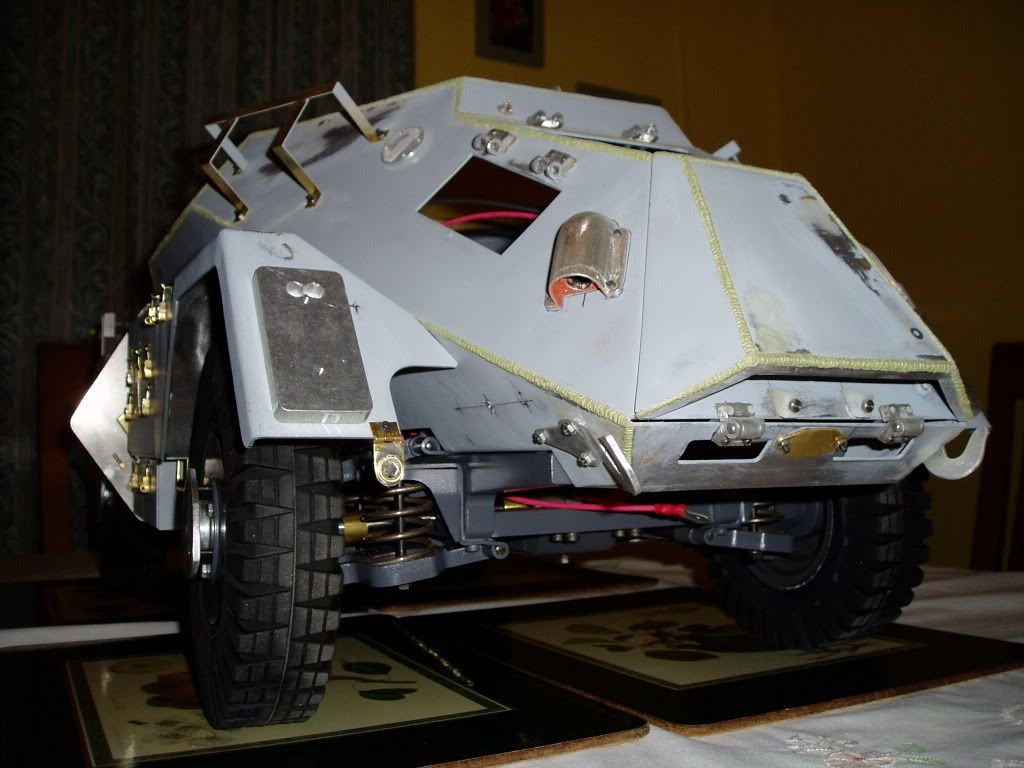

here,s a few more images of the chassis and partly completed body.
I will post more images of the work done on the gun assy soon.

Very nice looking work on this model, and lots of extra details. Its the first time I've seen the chassis without the body on. Are you going to run the model? If so are you going to try and sort out the traction issues with the diffs?

Yes it will be a runner. I have filled the centre diff with un-mixed Milliput (one half of the two part mix), this allows the diff to turn with a lot of effort applied. I will not know how successful this is untill i run it, but at least it can be stripped and cleaned if it dosent work. If someone wants to try this method on there runner and let me know how they went on it would be appreciated.

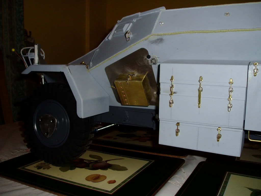

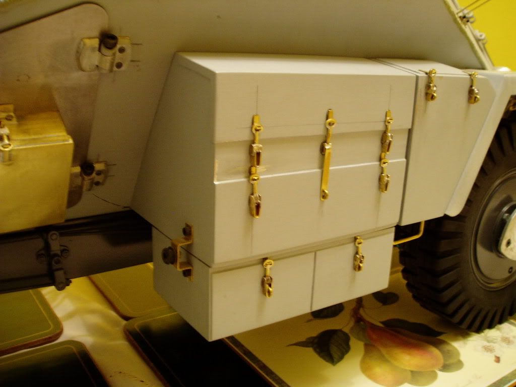

I love the catch detailing on the stowage boxes.
Are they cut-and-filed or etched :?:

I fancy getting a PIII to go with the 222 but would have to sell the Panther to afford it, Difficult decision to make :?
The catches are all cut and filed

Realy nice work on all the fittings and latches. Glad to know others are making their own! Awesome!

Your 222 is looking great :D :D . Can't wait to see it running around Leighton Hall. Quality as usual :wink:

Hopefully it wont take to long to complete, most of the works done now. Ive been spending some time detailing the gun and will post some photos when its painted.
