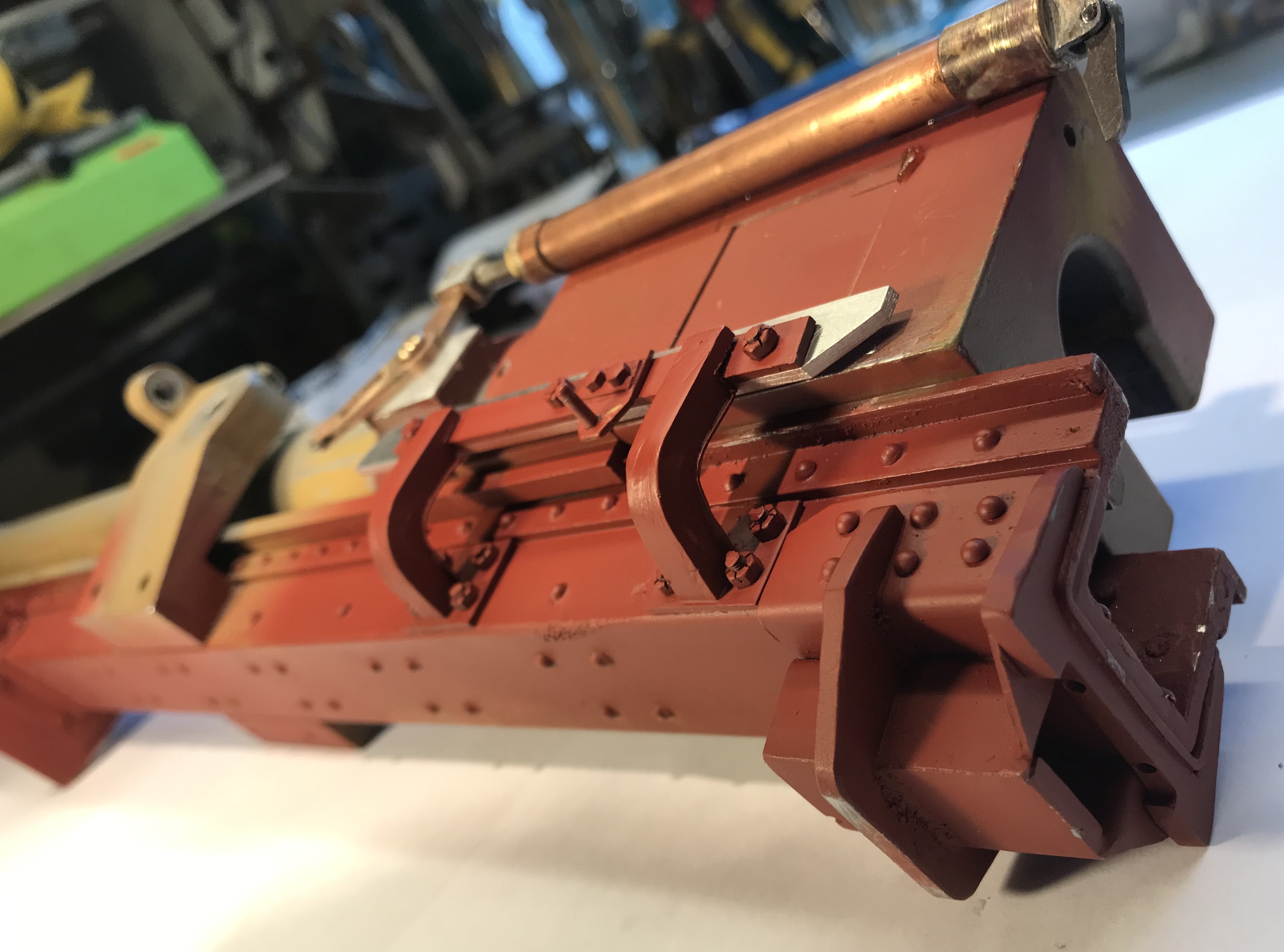

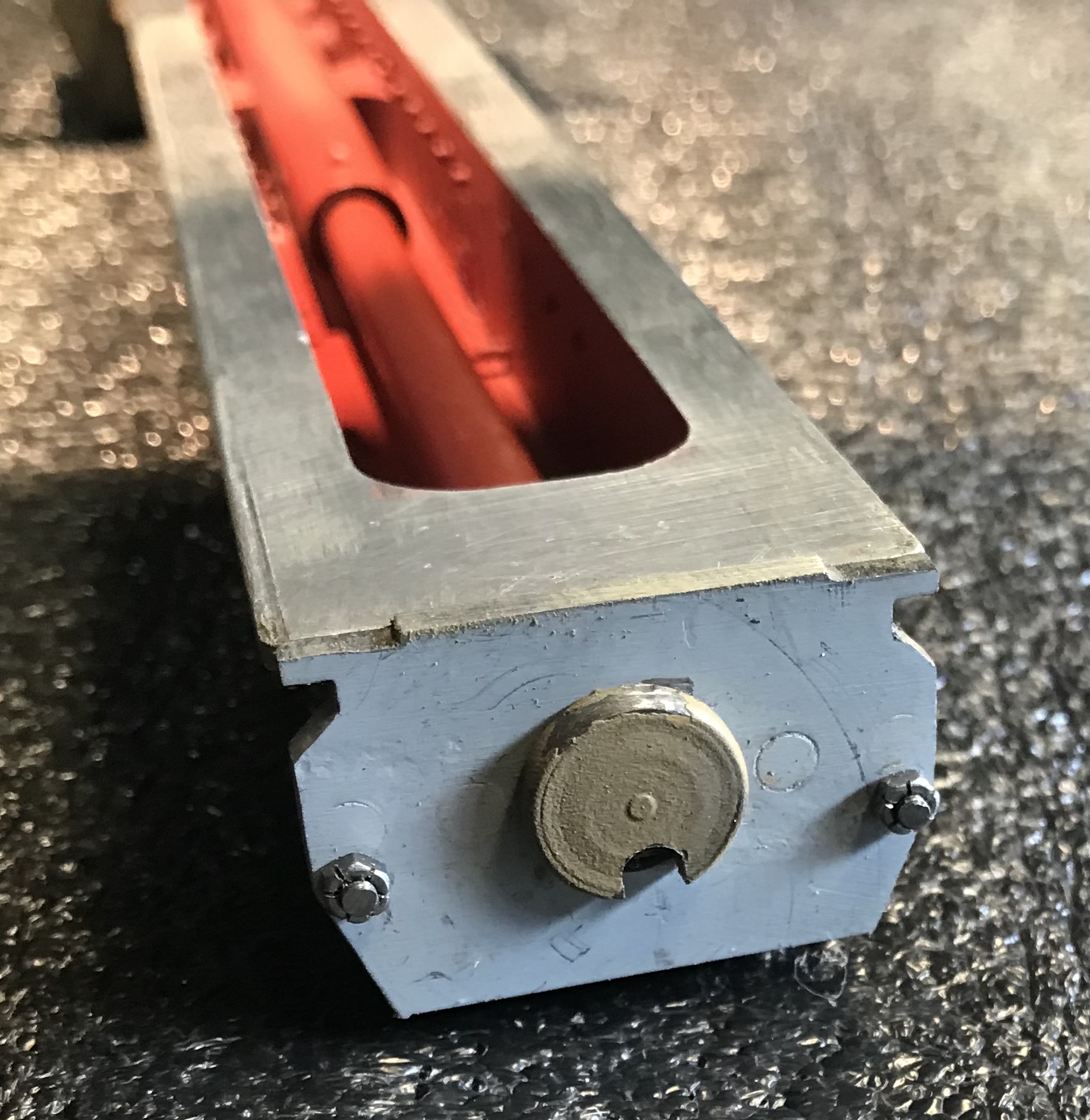

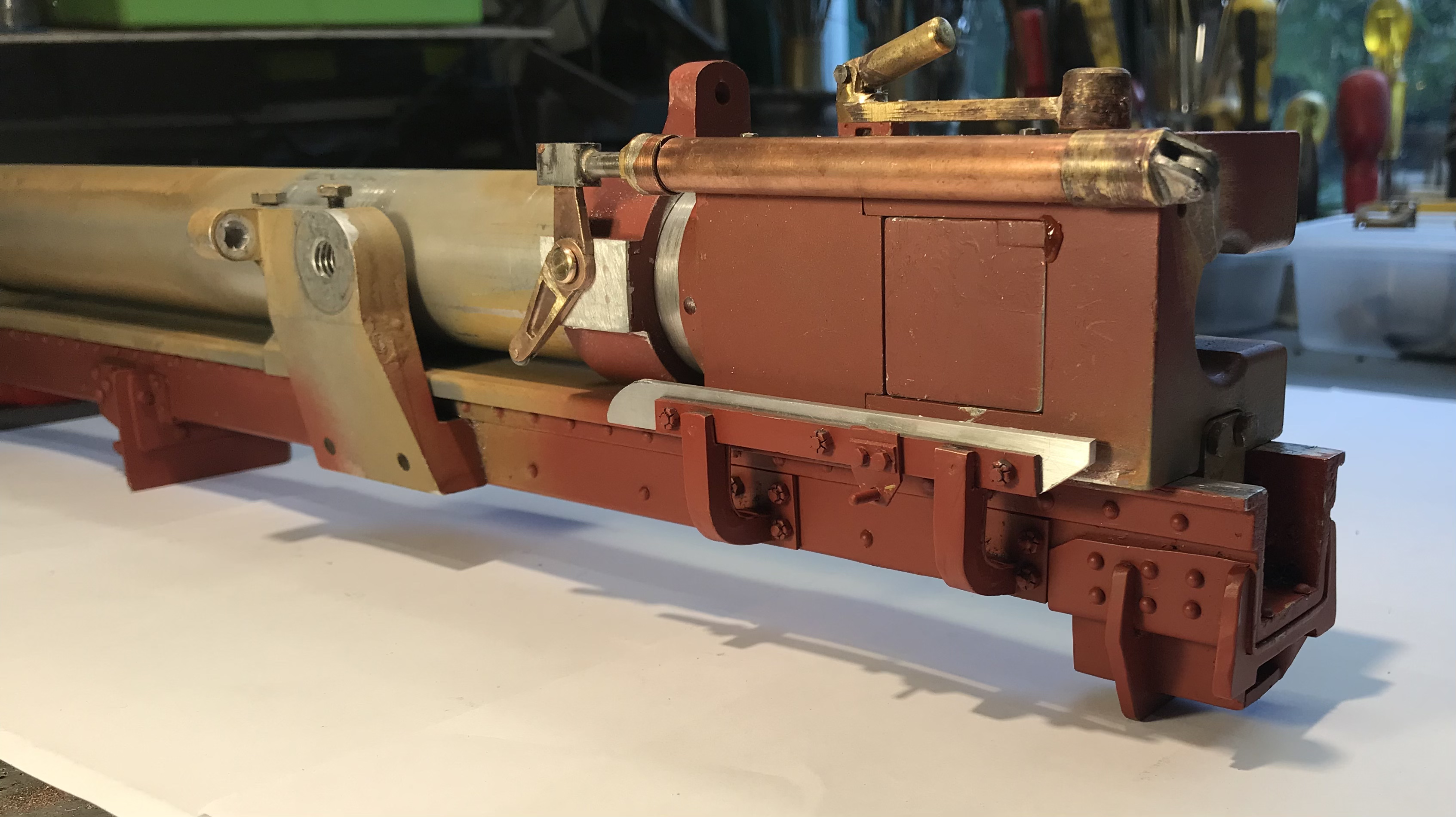

Hi all it’s been a while since I finished my 25 pounder, and was looking for a project, and acquired a built example, this has been dismantled, and my aim is to make as many functional parts out of brass steel and alloy, and of course plenty of fun.
Started on the slide, not sure if this model came with recoil, as It did not come with any assembly instructions, recoil made and the front stop plate altered and now secured with working side bolts
Regards Jeff

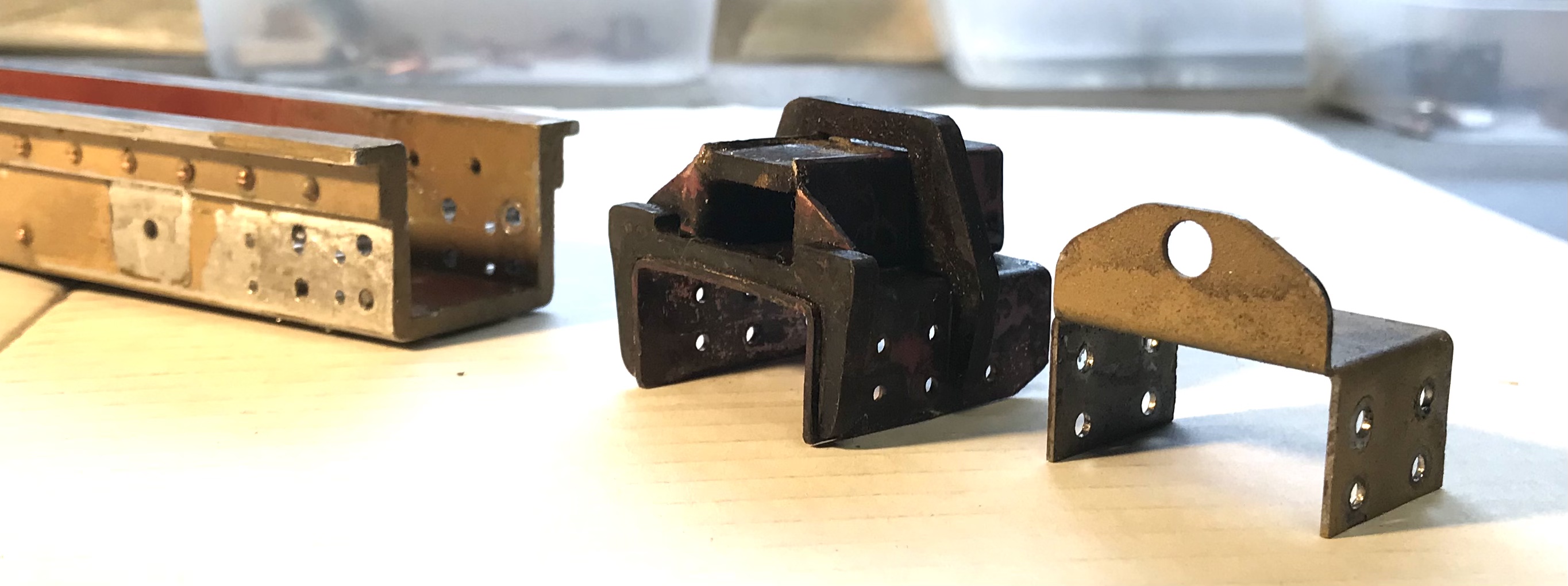

Replaced the kit part for the barrel lock, with a more prototypical part, multi piece silver soldered together, still covered in fire scale and loosely fitted, will clean and rivet tomorrow
Regards Jeff

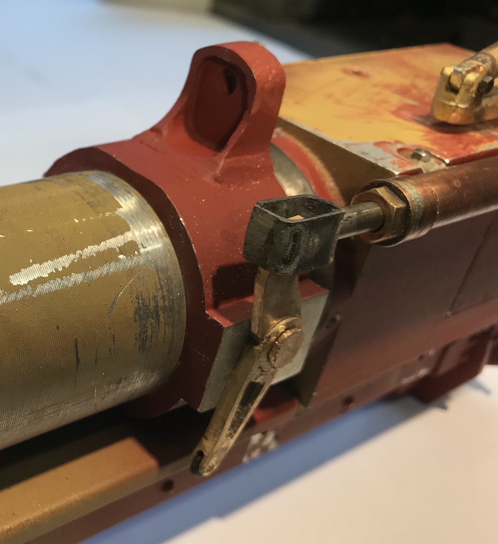

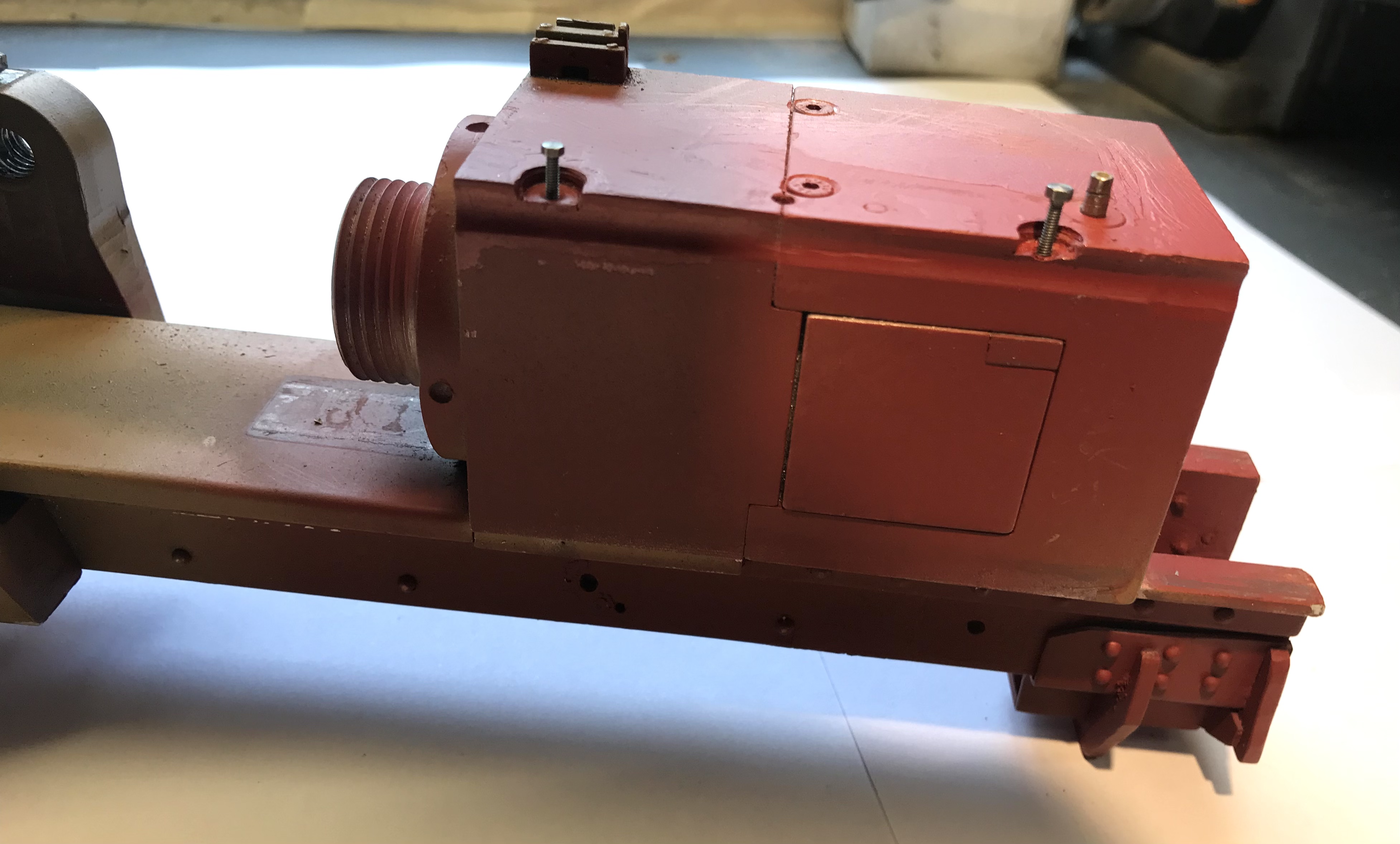

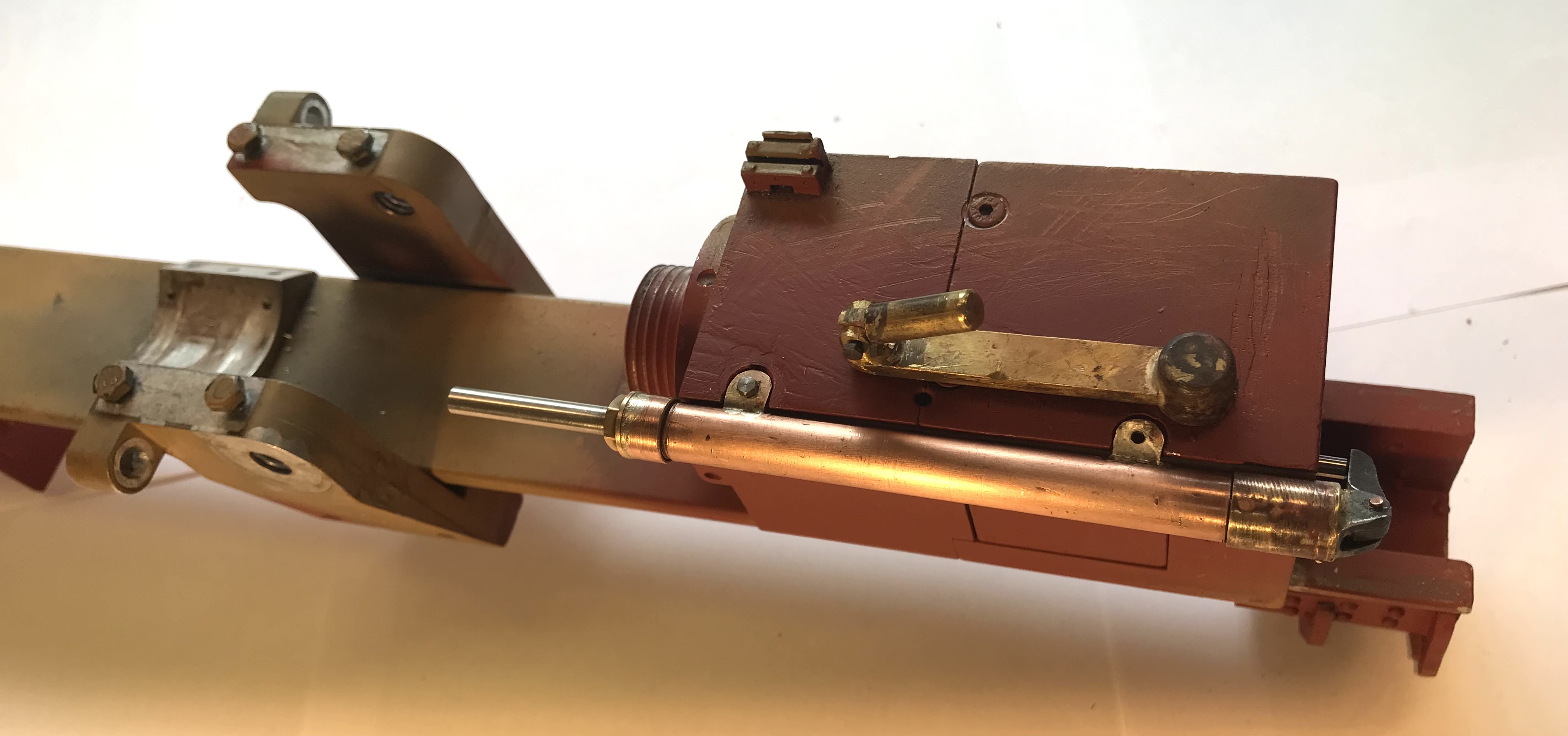

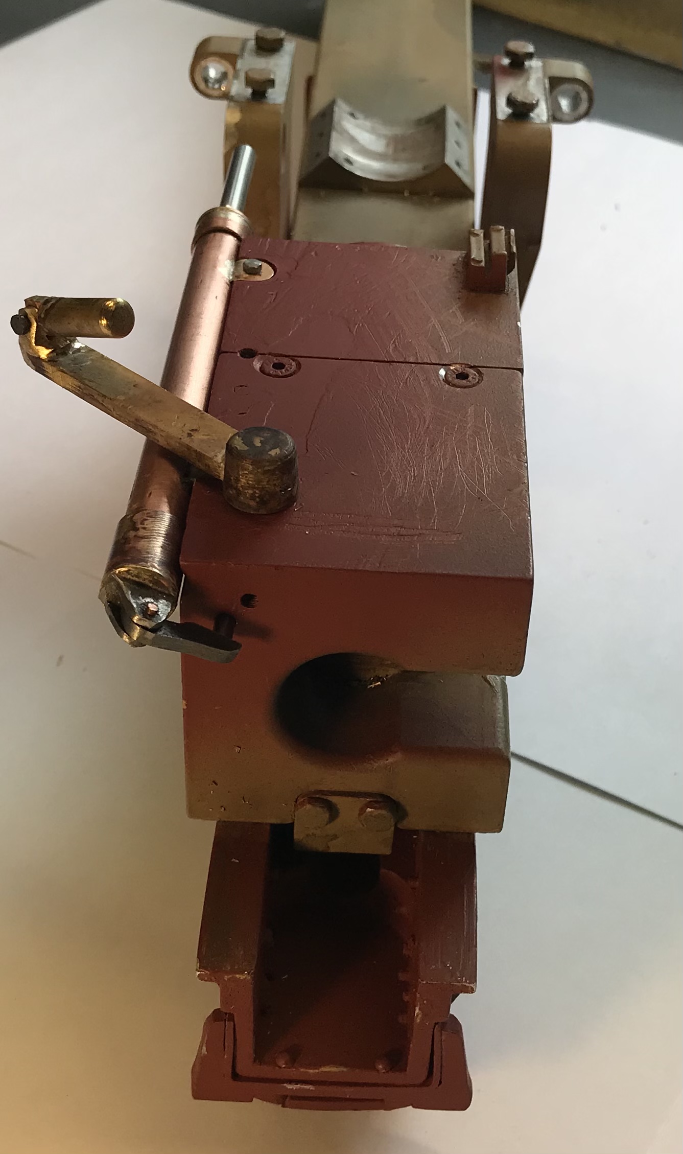

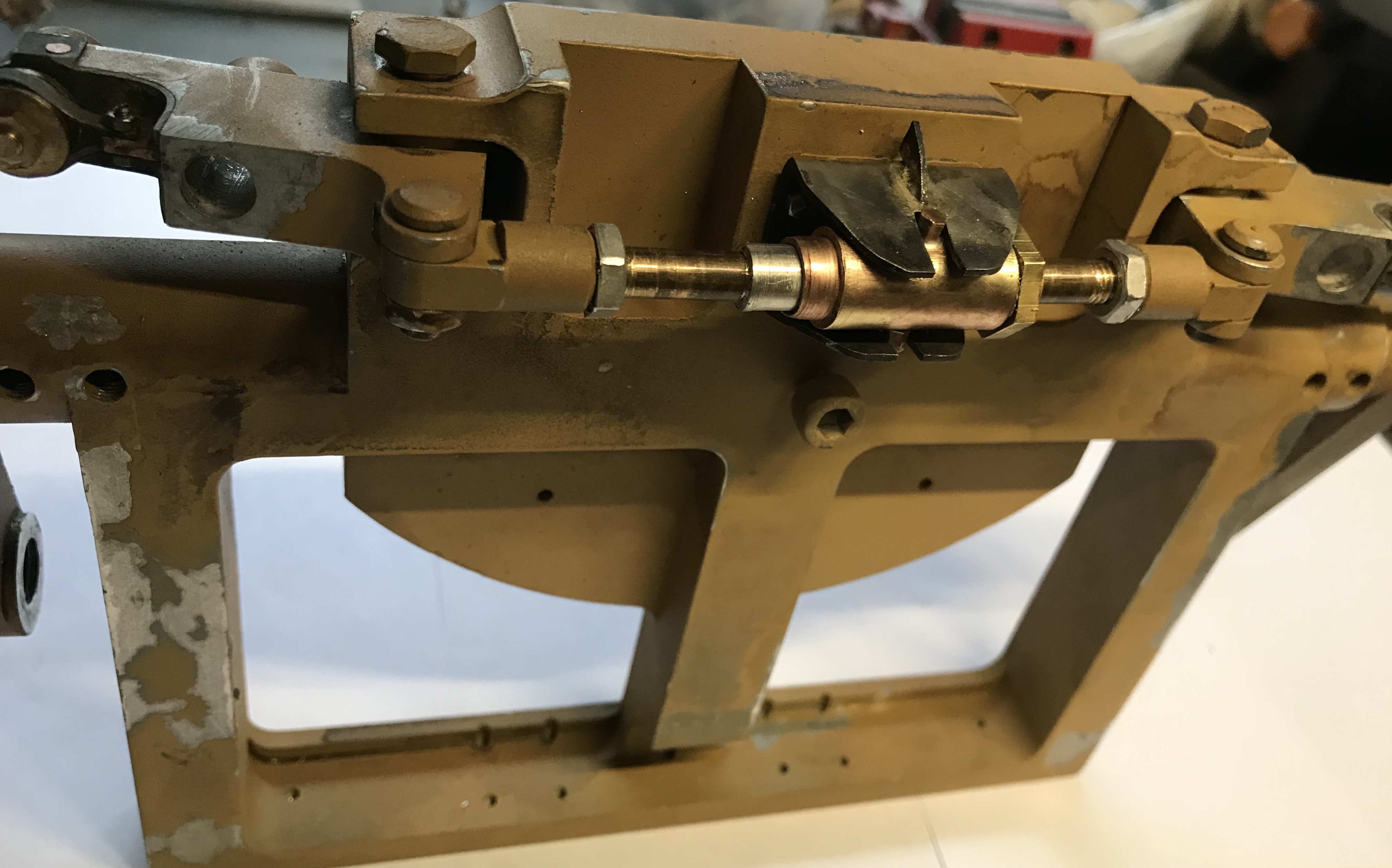

Started some work on the breech block, would have loved to be able to open the breech using the handle in a clockwise half turn, that’s not going to happen, so plan B, there is very little information on the workings of the breech, I assume the long cylinder on the left is for self cocking or locking as the front pawl engages with a pin, I am making what I think it should be, and have positioned it so I can still use the breech handle, this is how far I got today
Regards Jeff

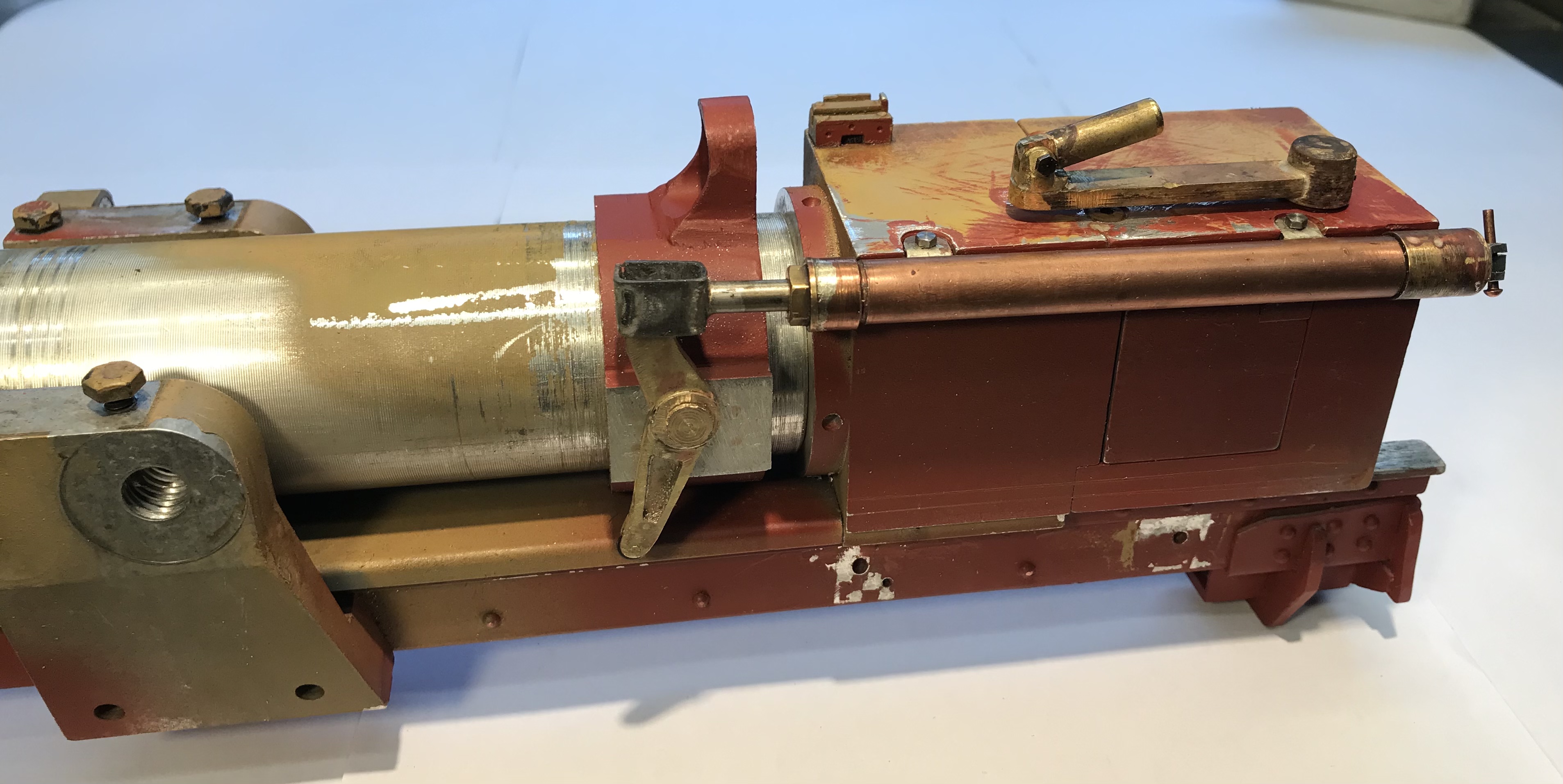

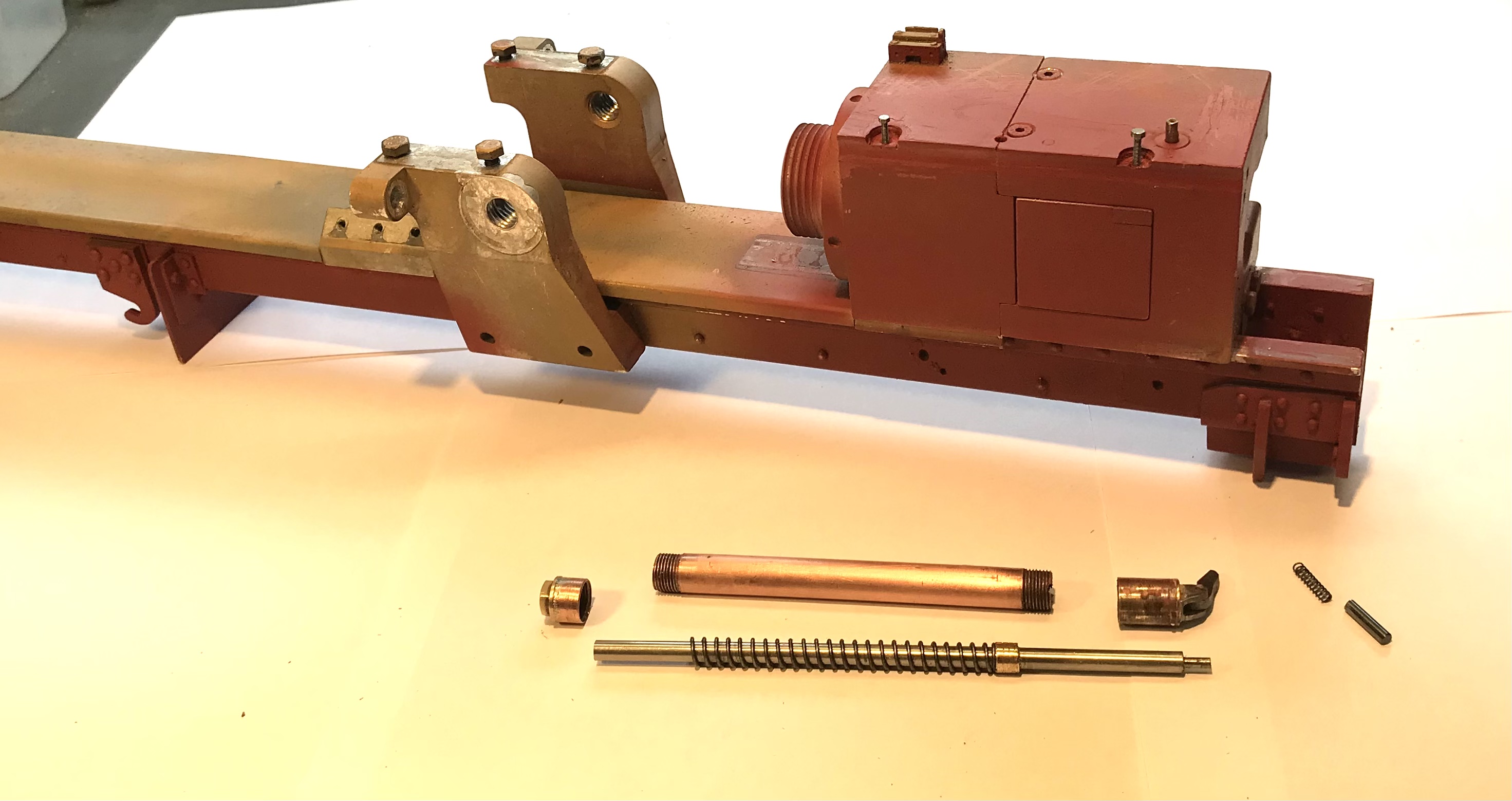

Bit more done today, reduced the width of the barrel collar by 7mm and altered the side lugs, right hand side narrower and left hand side larger to take the pivot arm, gun looks a mess at the moment, but will wait till all is working to put right
Regards Jeff

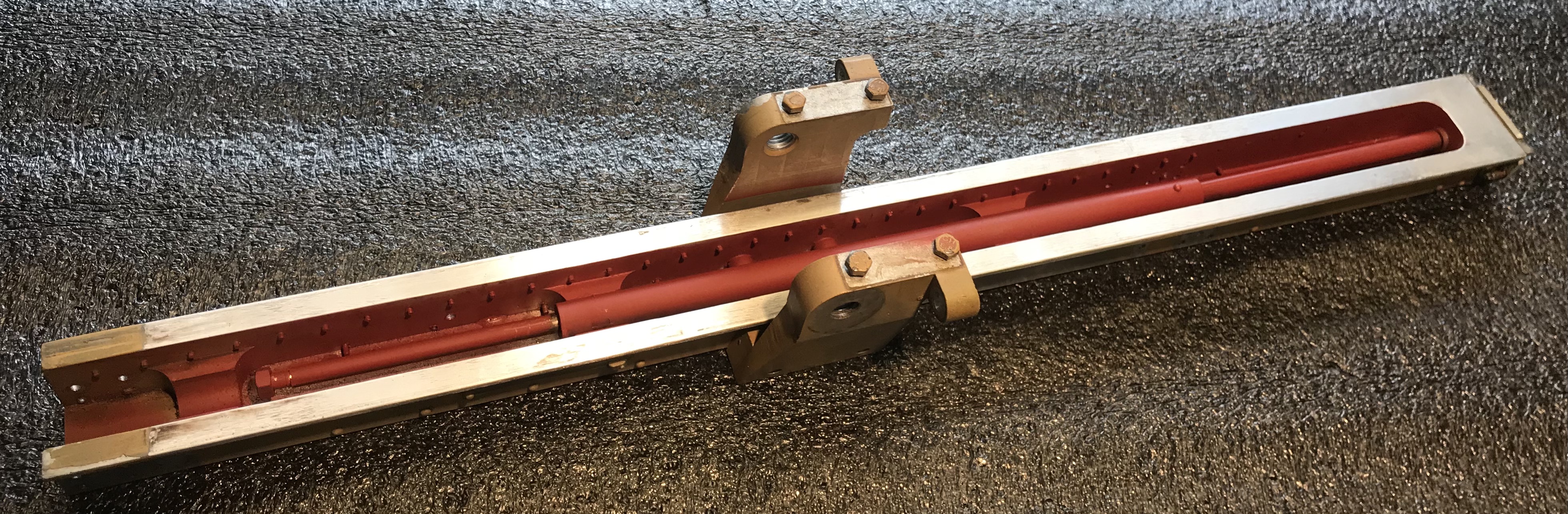

Re: Pak 43/41 rebuild
Post by Jeffrey Goff »

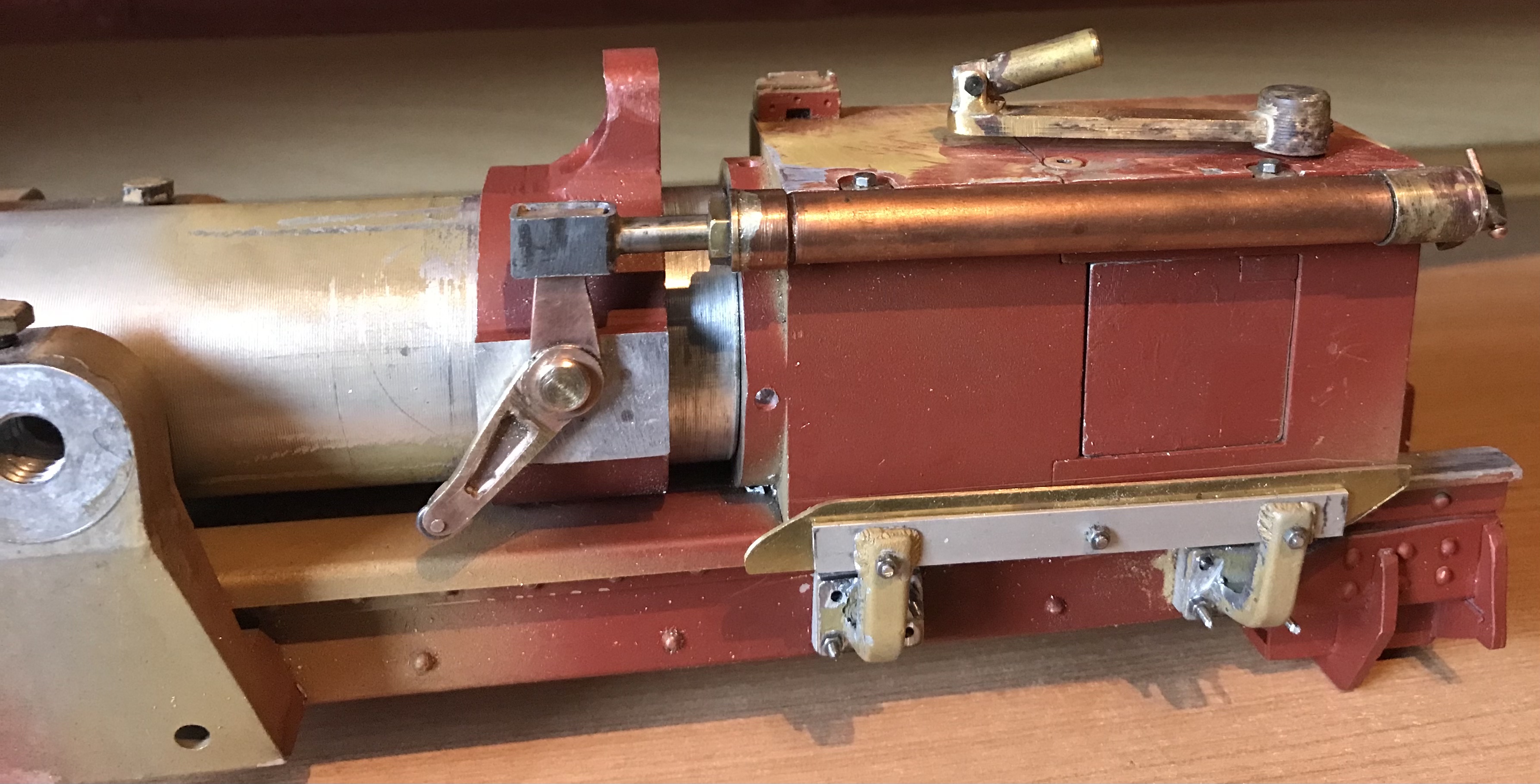

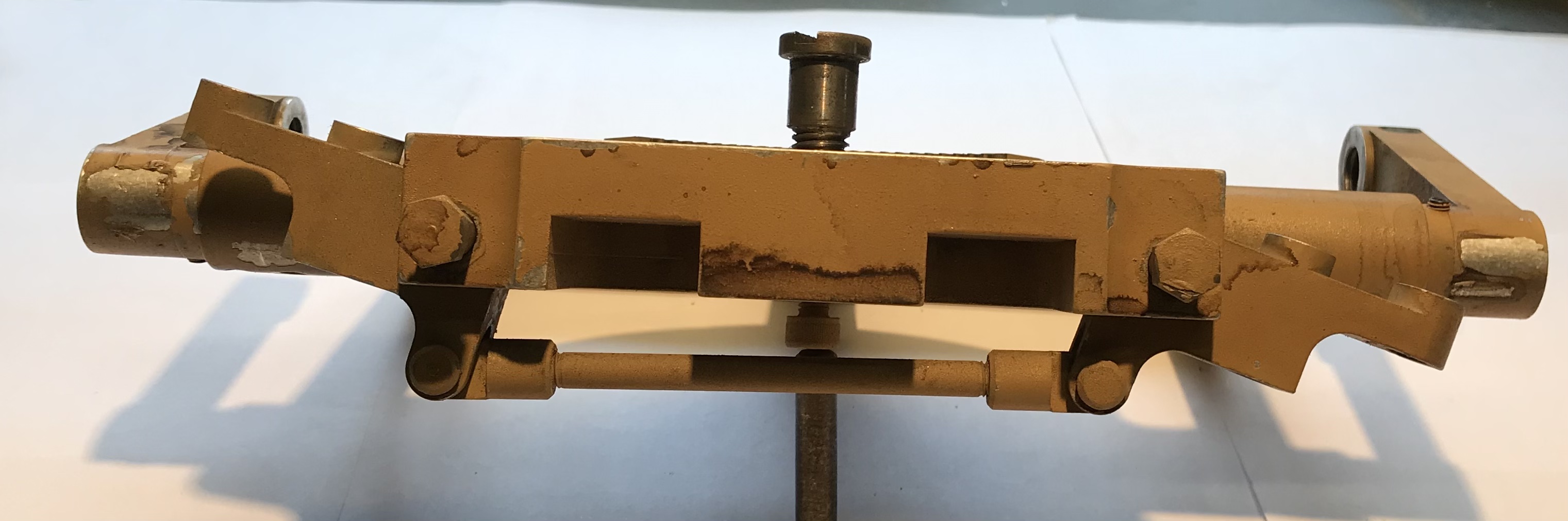

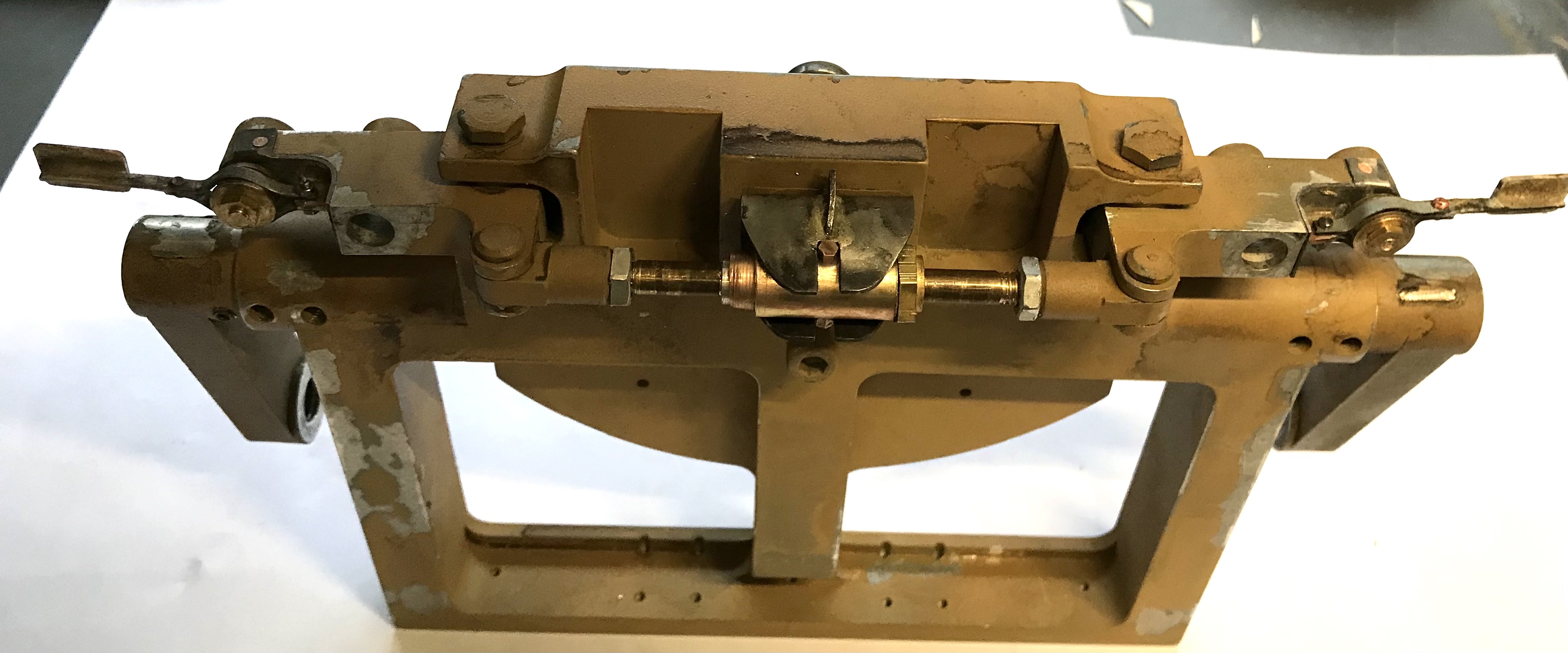

Bit more done today, the bits are not hard to make, what takes the time in insuring all the bits end up in the right place, recoil now looks good with the pivot arm running along the beam, still work to do on beam with fixings and arm stop
Regards Jeff

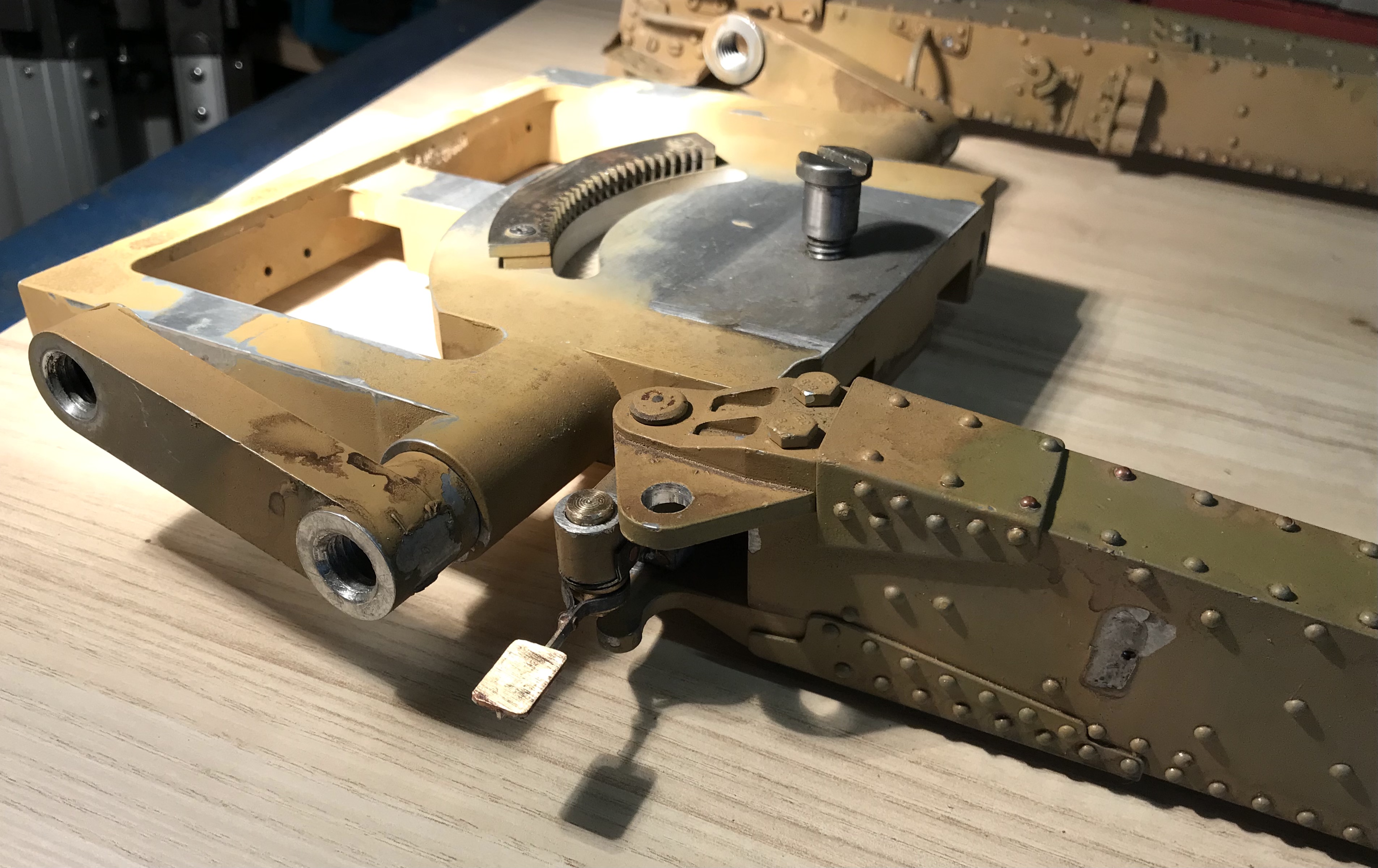

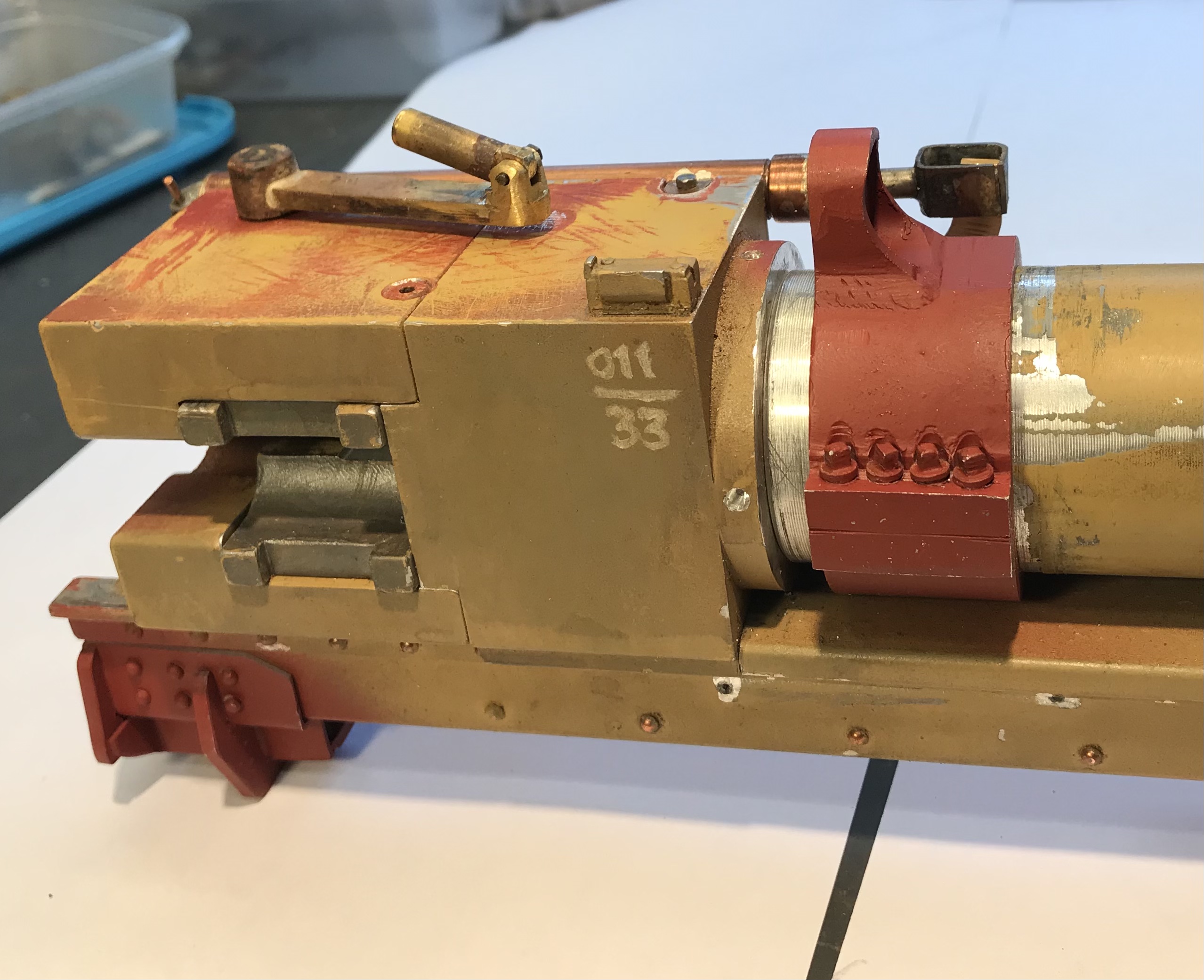

After I worked out the correct position of the beam, I made all the parts so it could be bolted in place, happy with the result, now on to the next challenge
[attachment=3]97E5BE30-5D14-4F8E-B821-7612B763C1CC.jpeg[/attachment

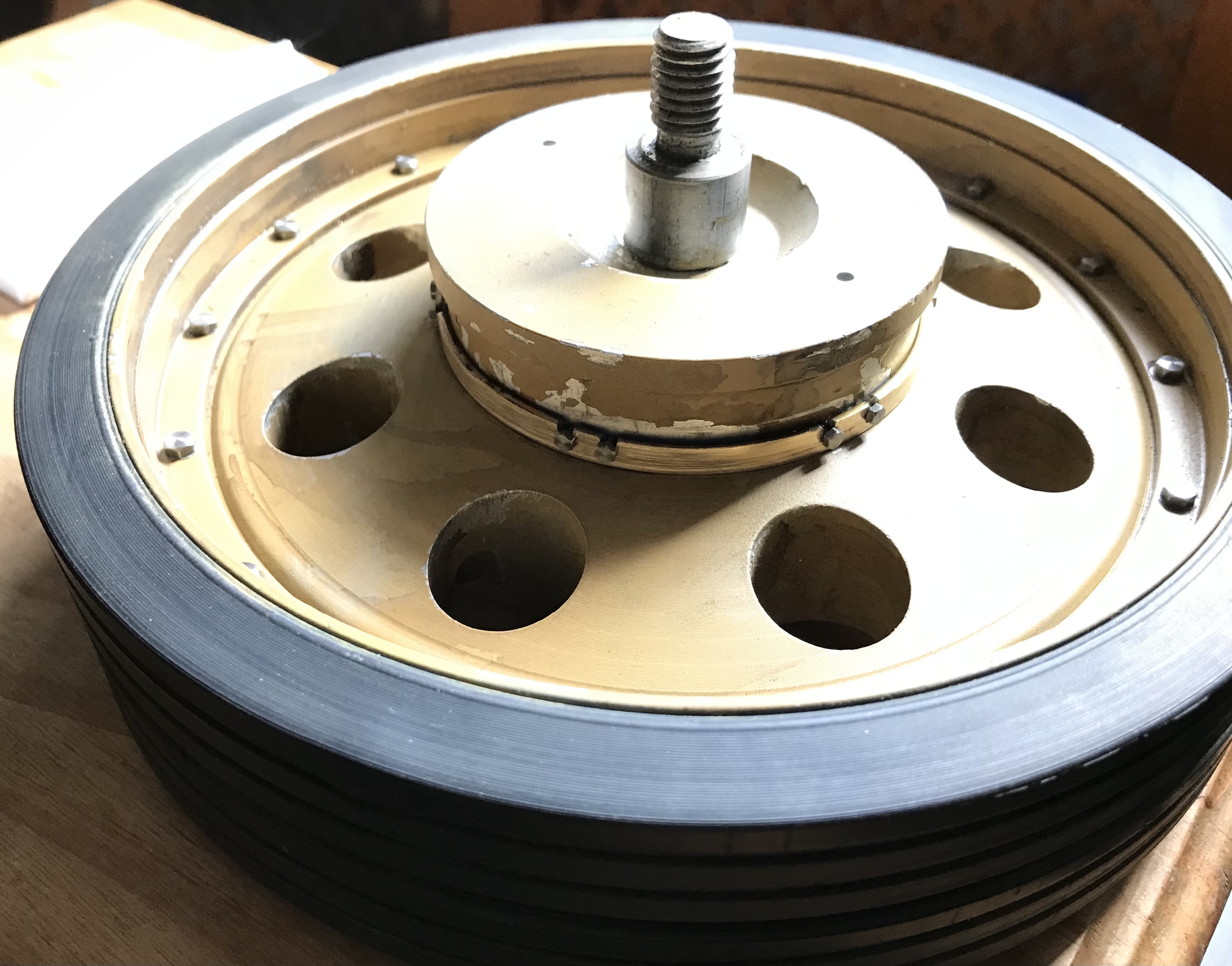

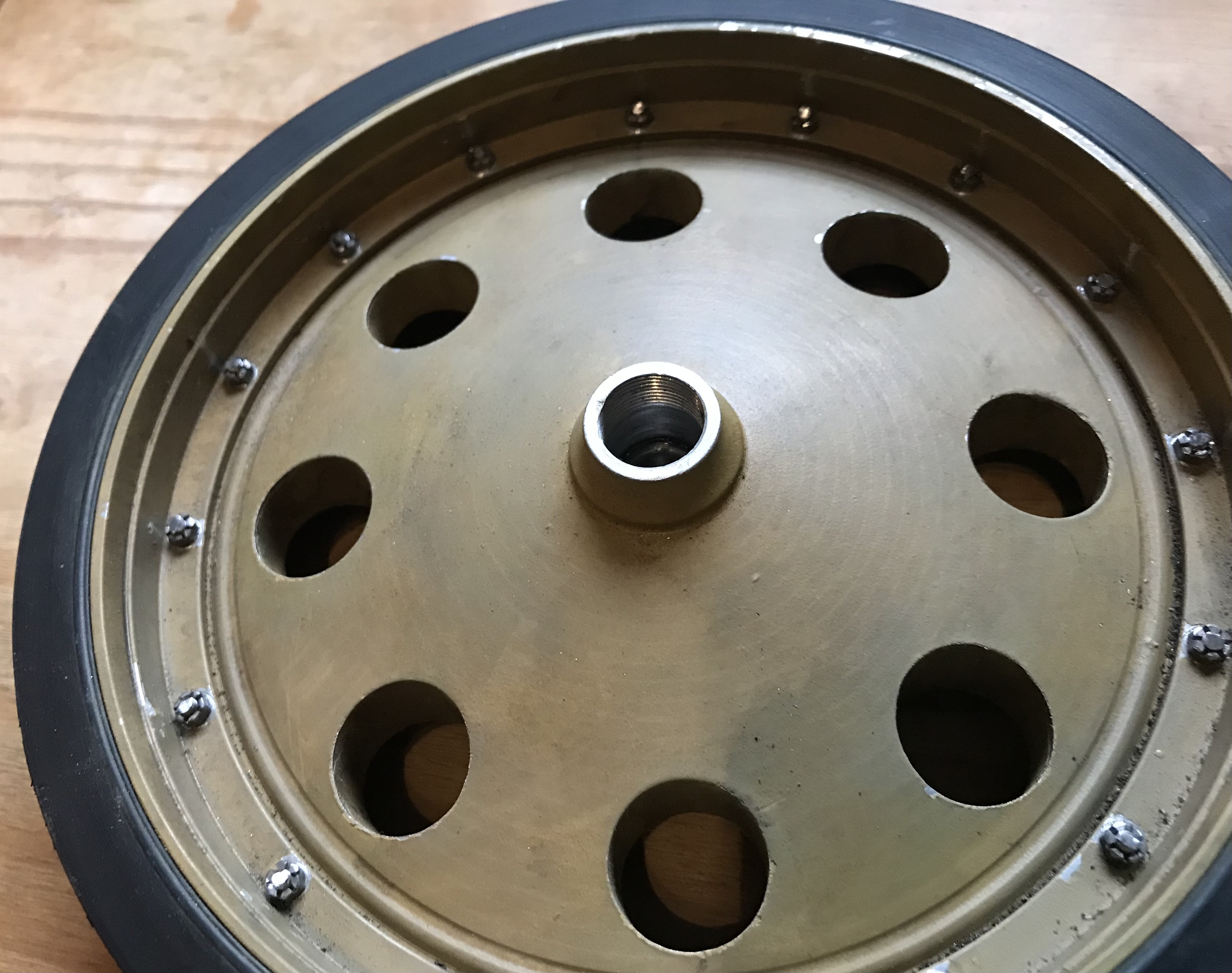

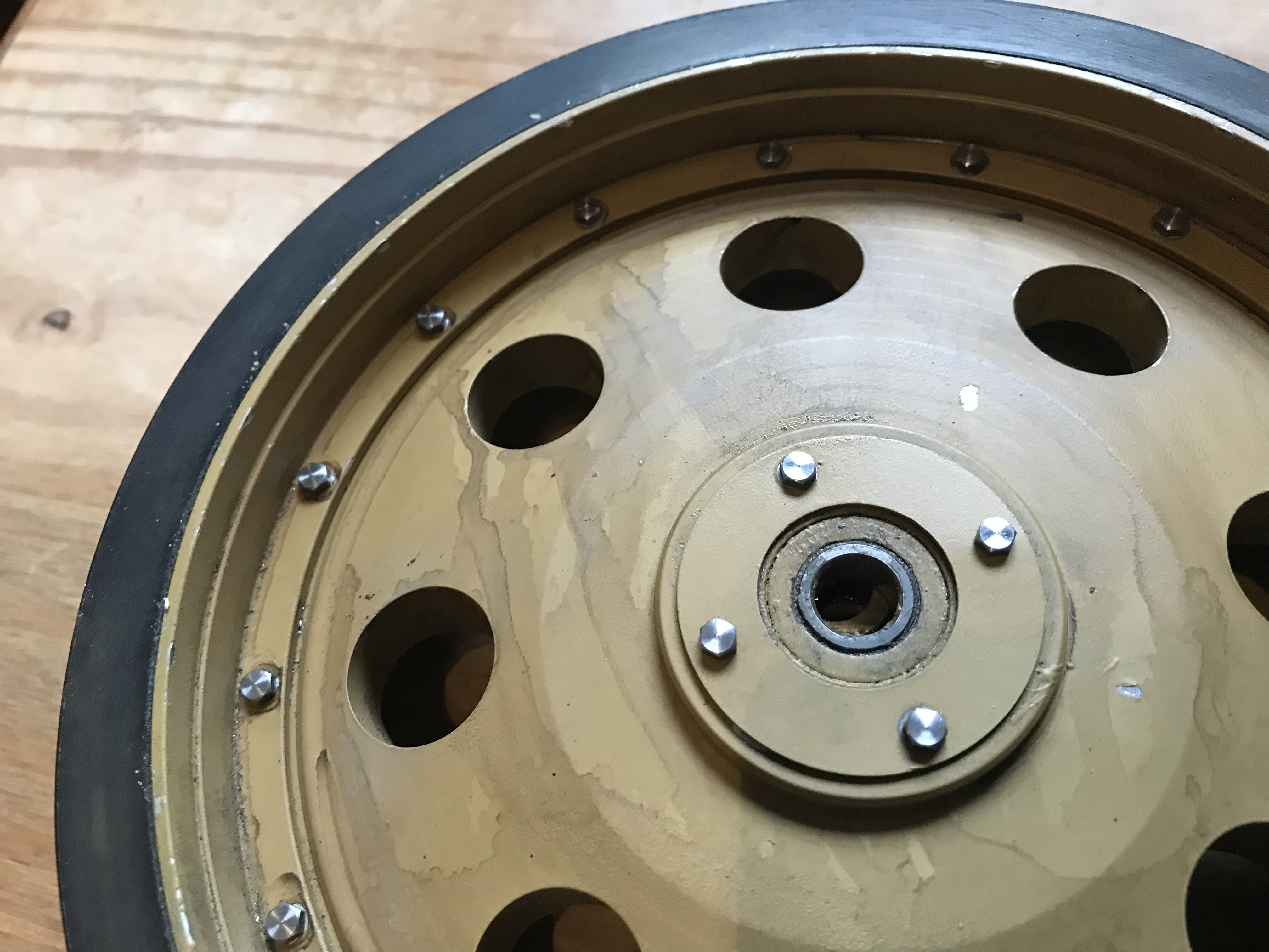

Only had an hour this evening, but now have the assembly instructions, started on page 1 with the wheels, got rid of the Allen key bolts and replaced with 6ba, castellated the nuts on to the next wheel
Regards Jeff
Added the bolt details to the brake drums
Regards Jeff

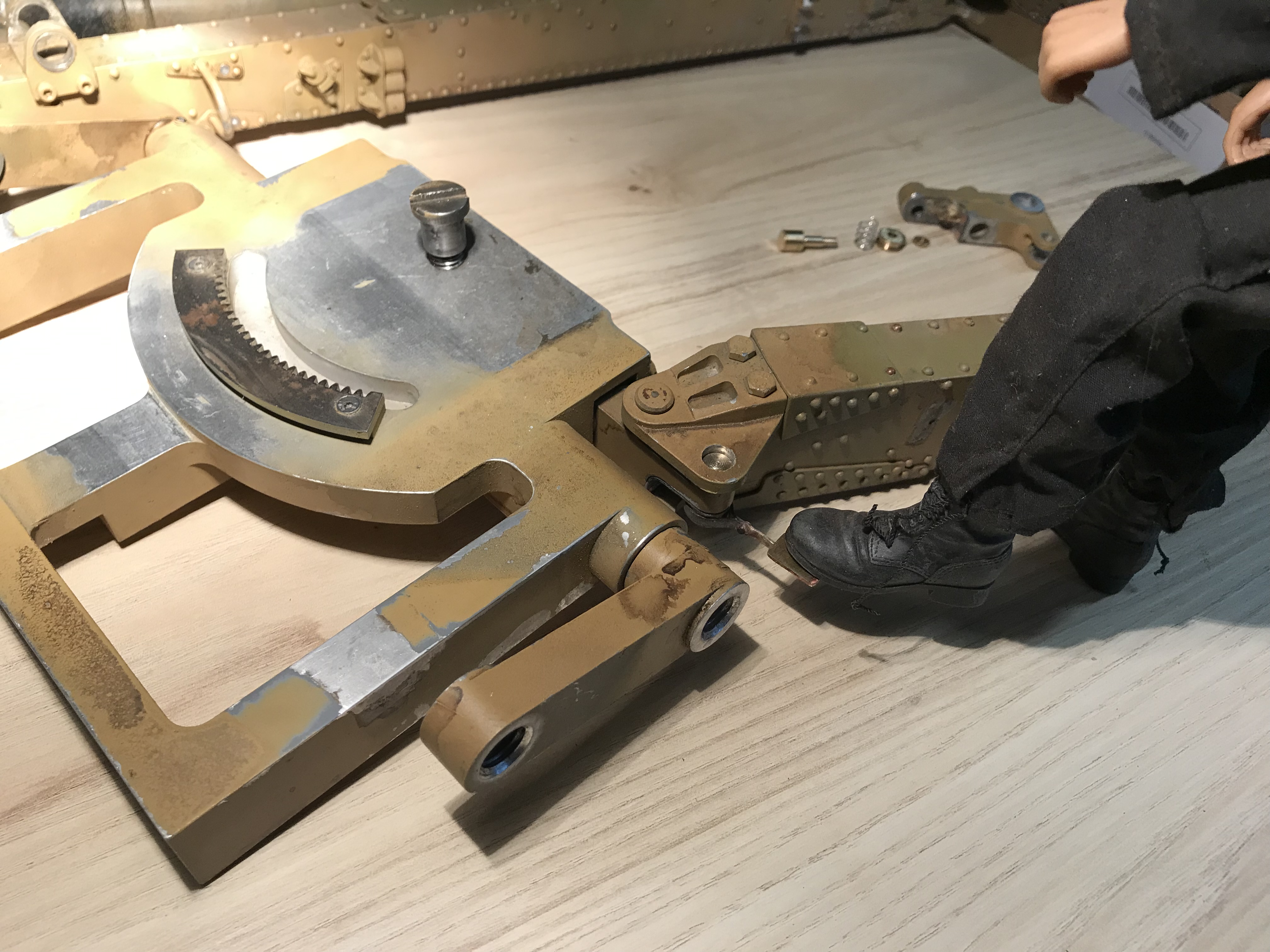

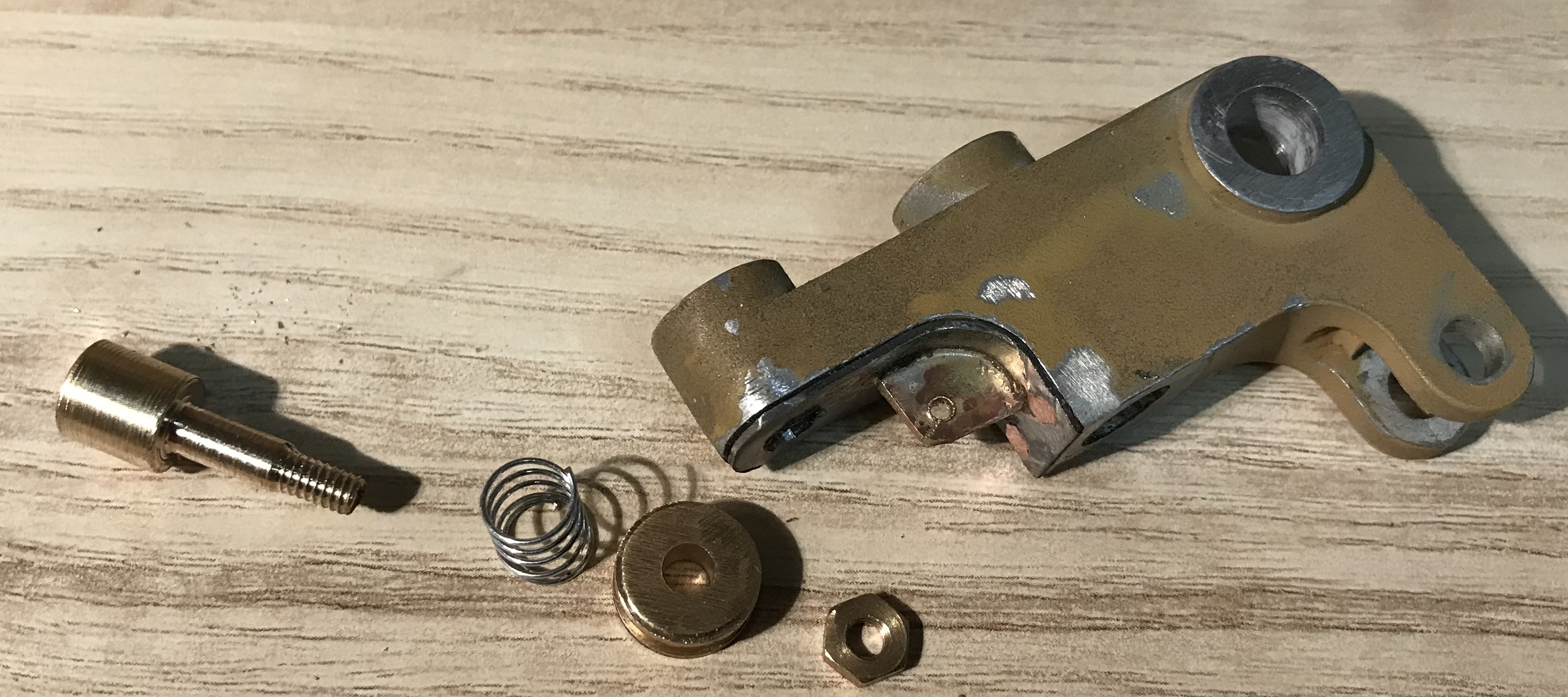

While waiting for some brass to arrive, I had a go at making the foot release bolt for the trail arm, working ok just need to make the foot pedal
Regards Jeff

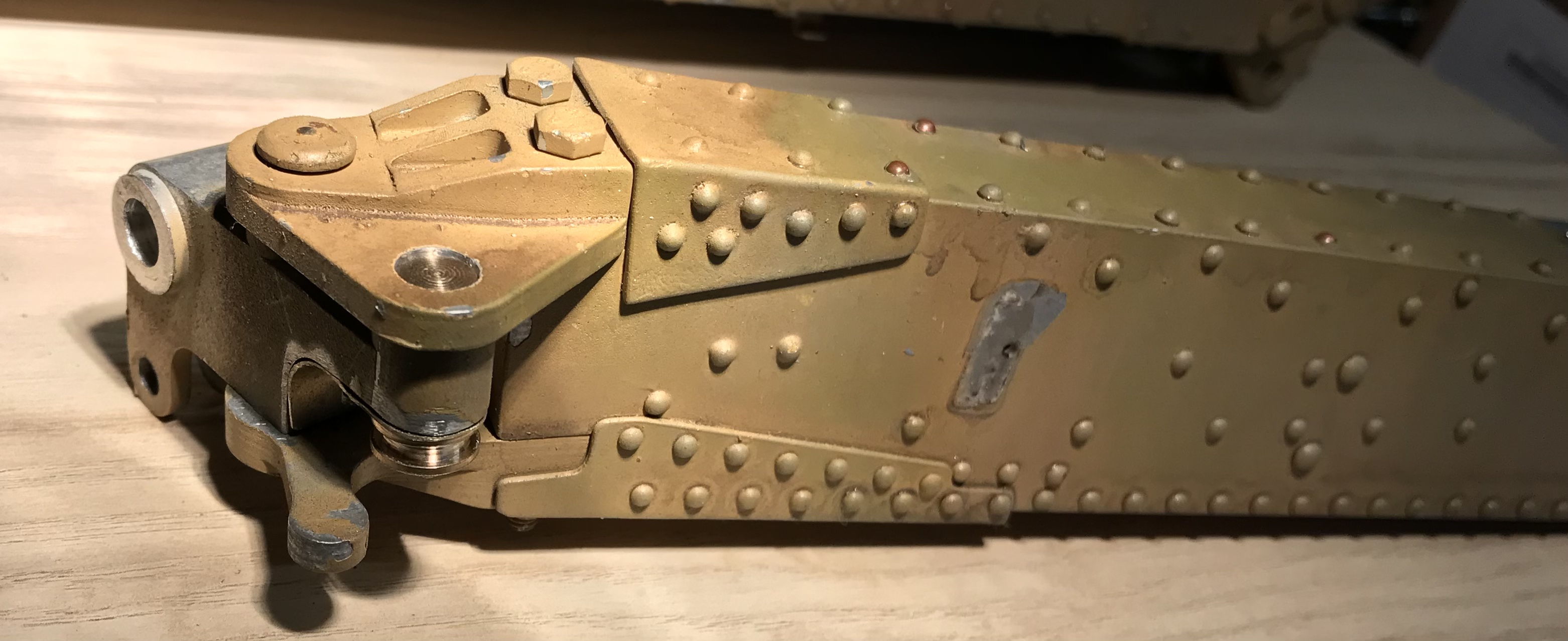

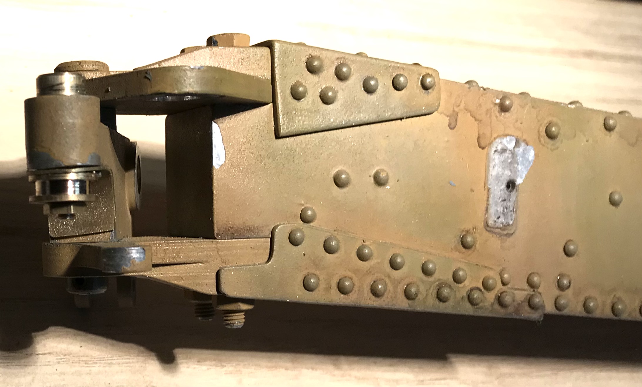

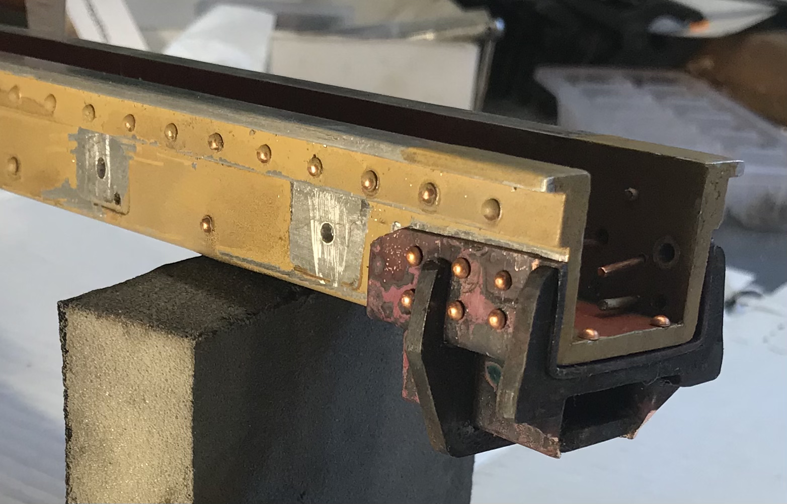

Remade the sprung locking bolts for the trails and added the foot release pedal, used a 12 inch figure to check the dimensions looked right and they were working
Regards Jeff

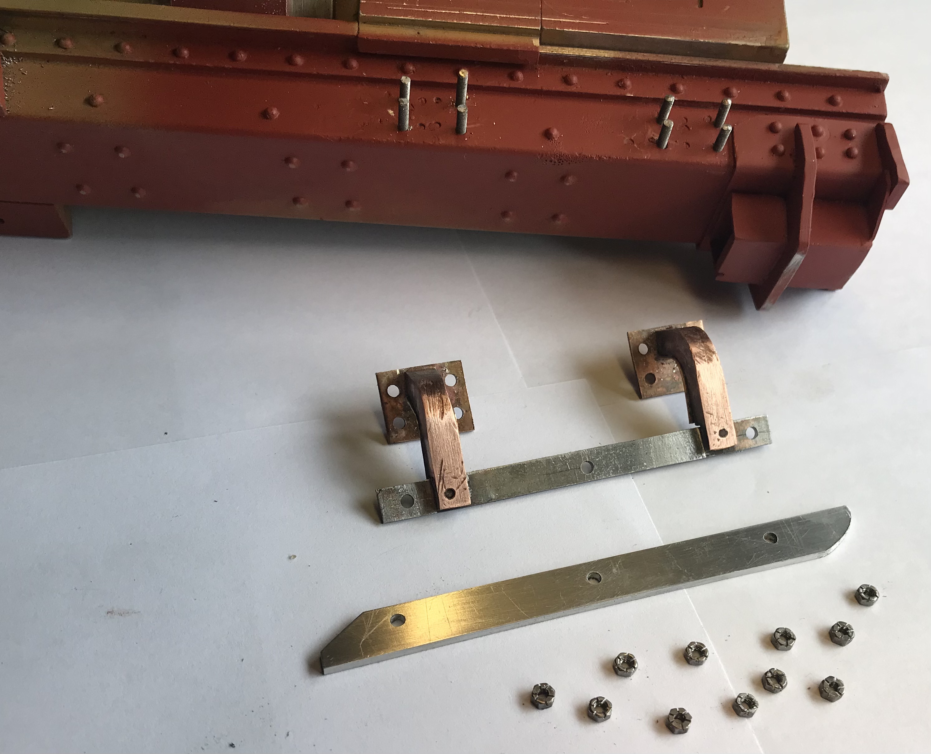

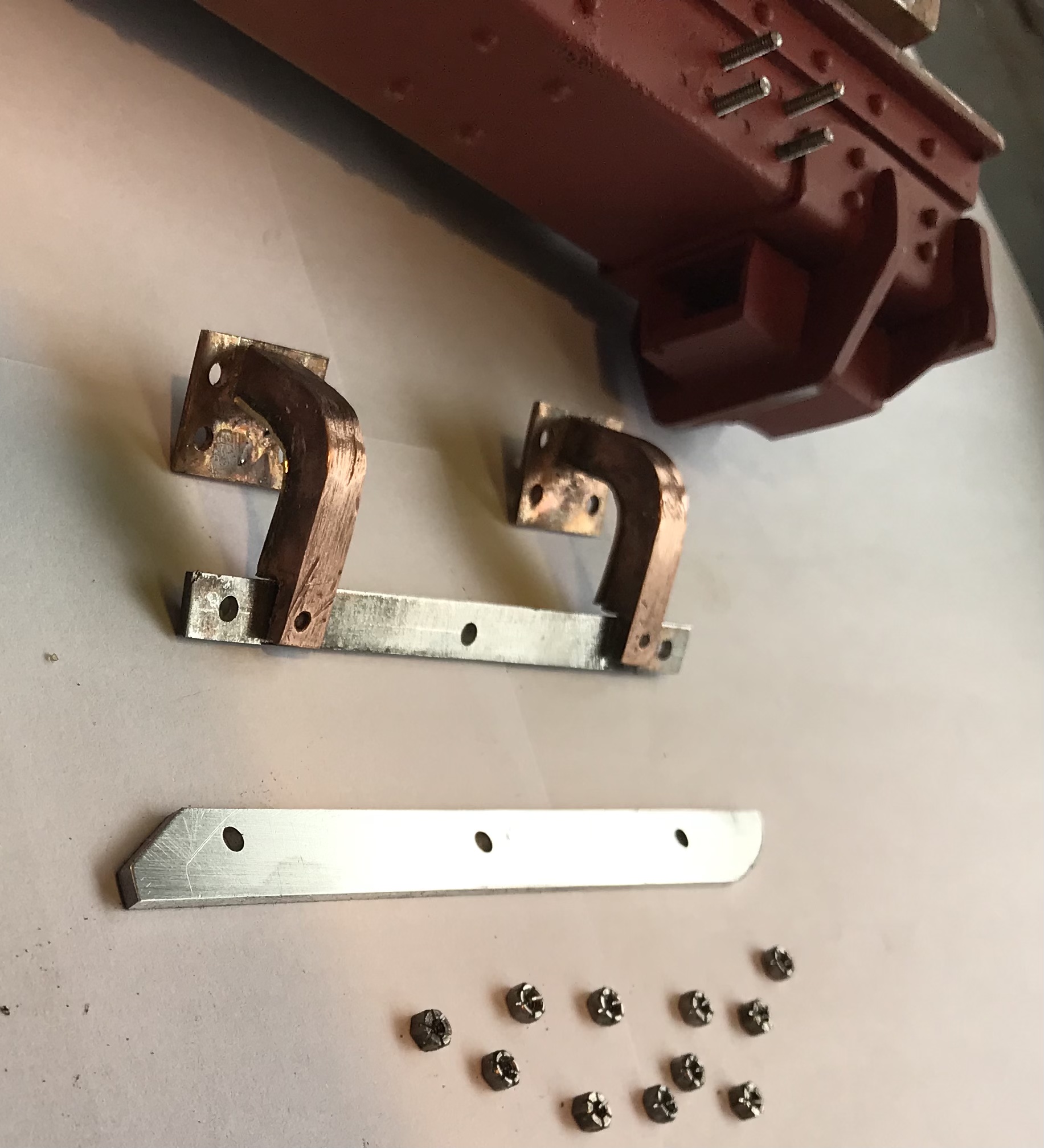

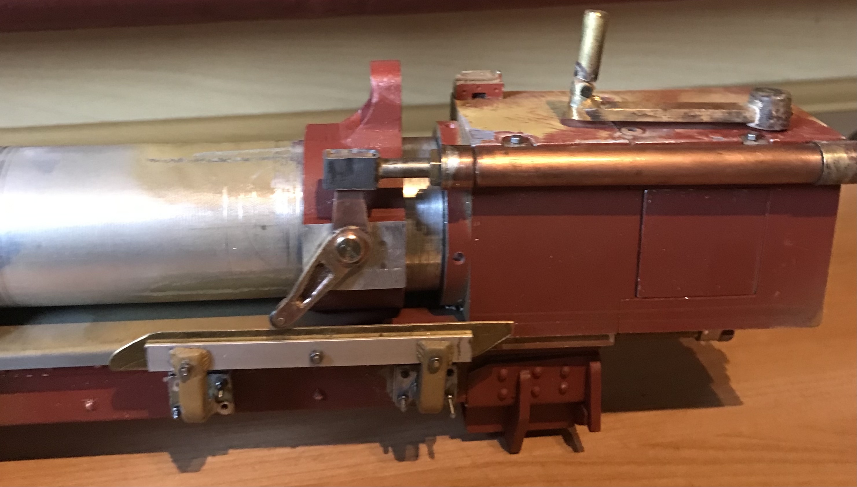

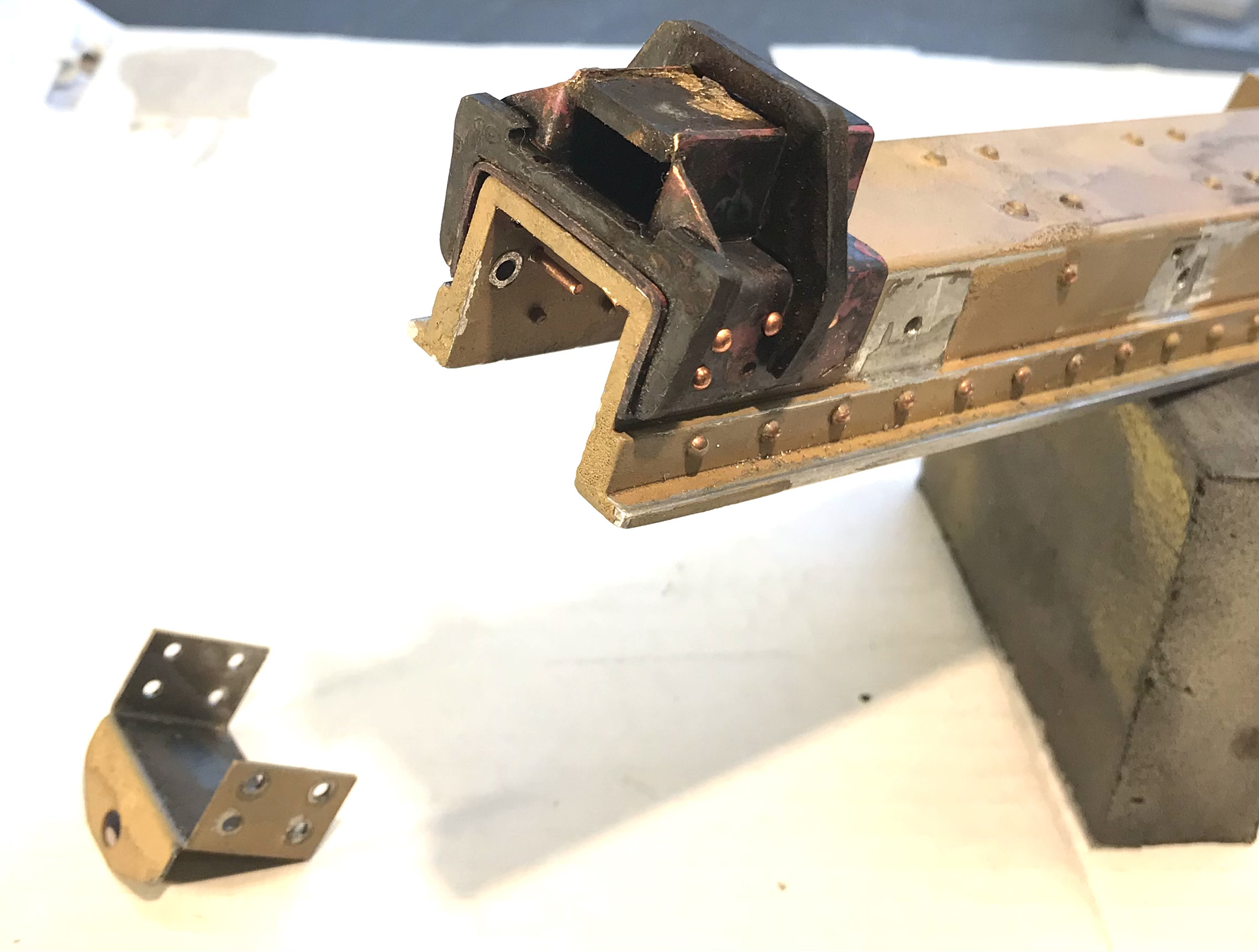

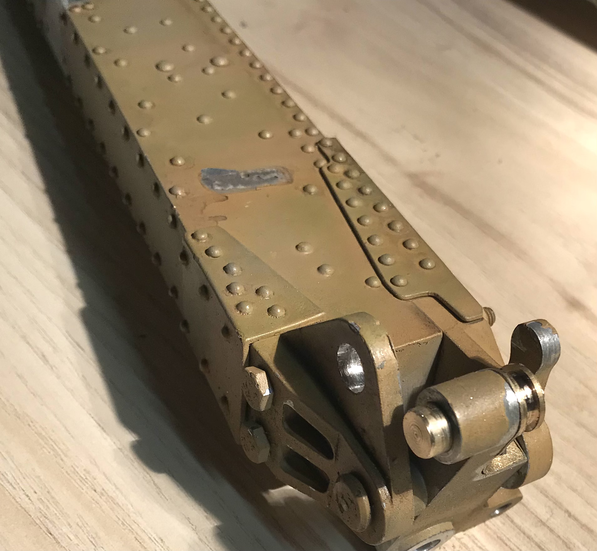

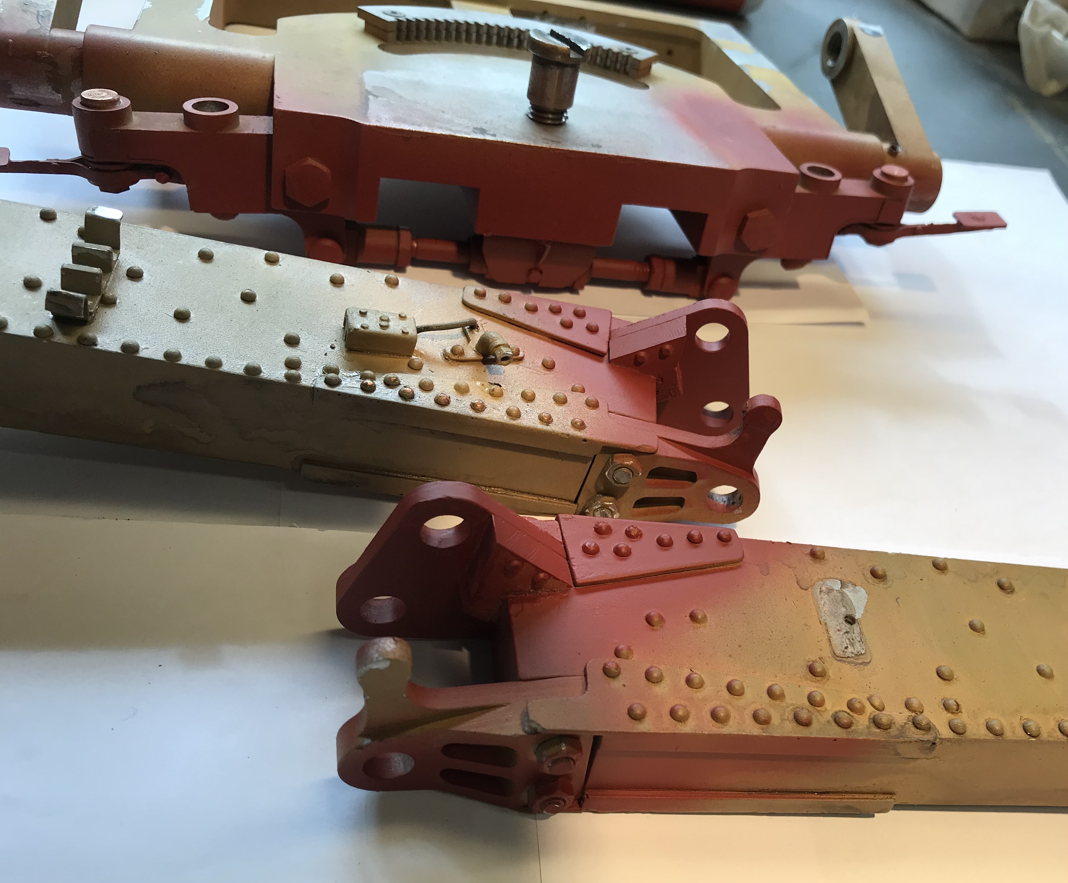

Bit more detail added, have shown a before and after picture, as I am sure a lot of the details are meaningless unless you have a 43/41
Regards Jeff

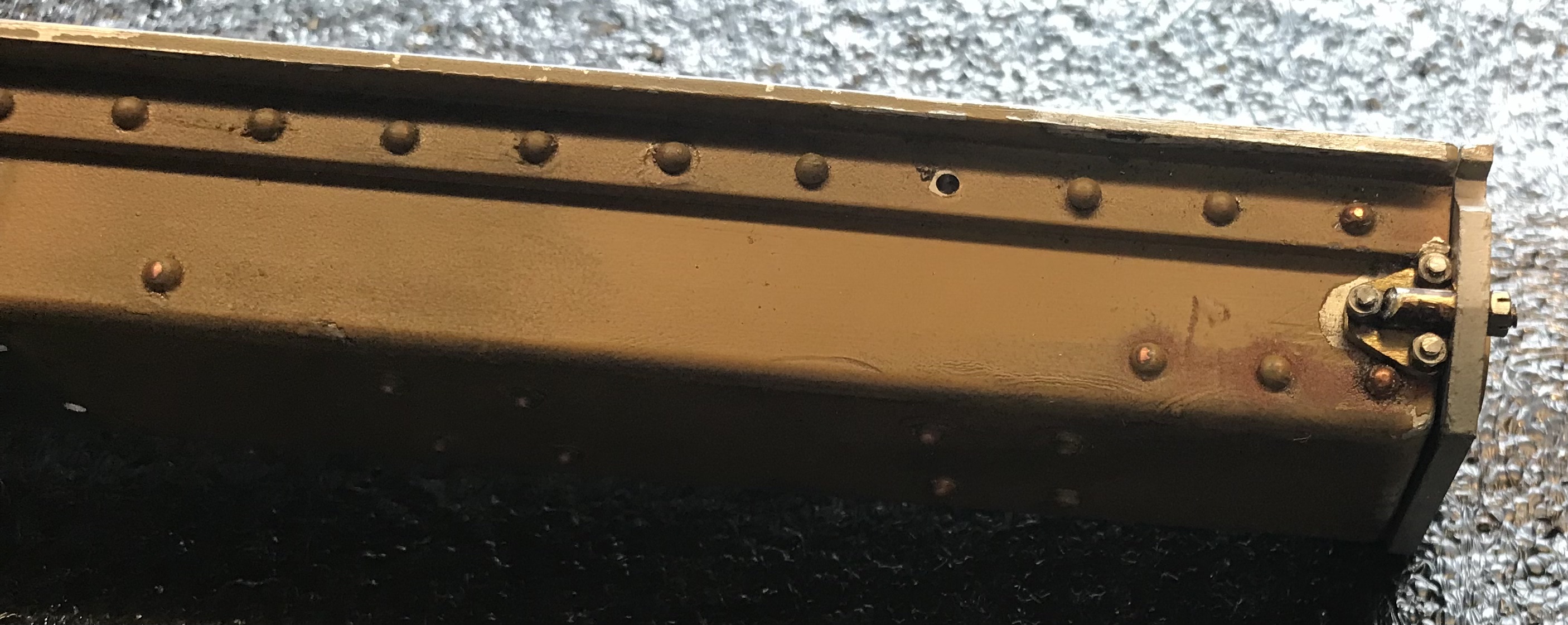

Not much done today, but made and fitted the stops for the trails
Regards Jeff
