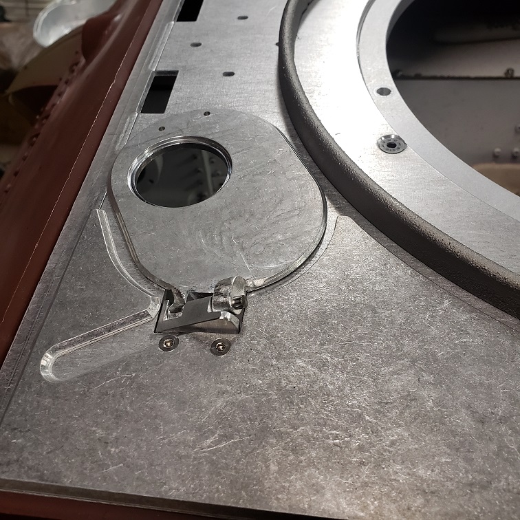

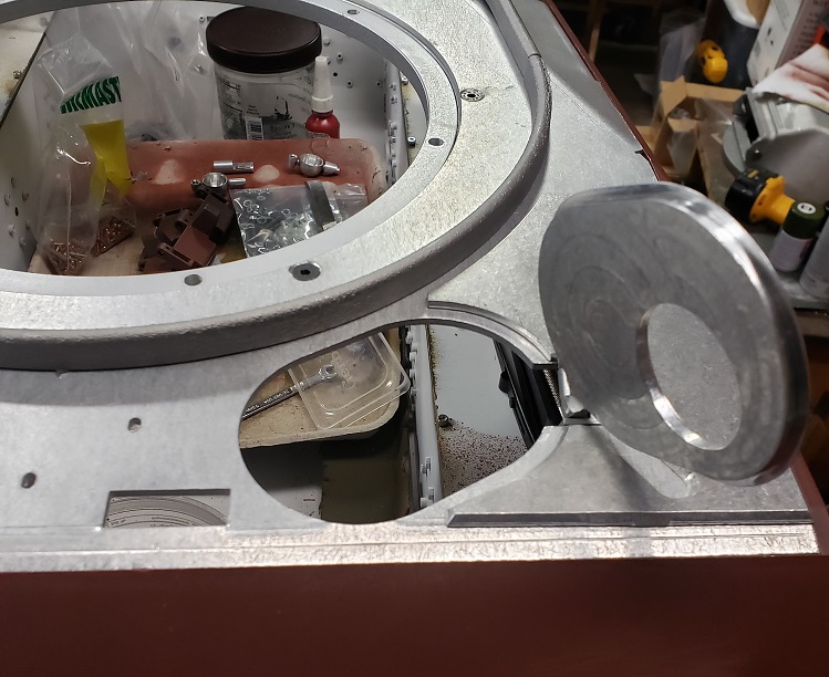

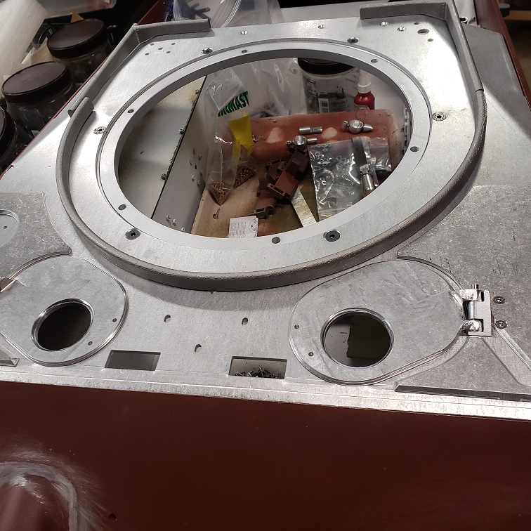

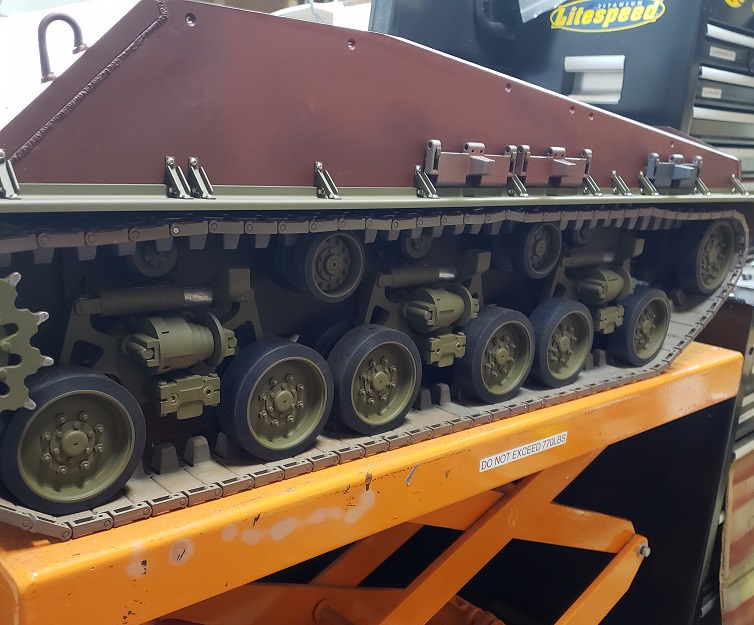

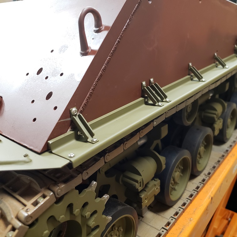

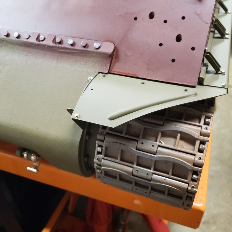

Few photos of recent progress. Got the front hatches fitted and working. Took a bit of fiddling but both now work well. A few fender details and welds added. Thx for looking and for comments.
till next time...
till next time...

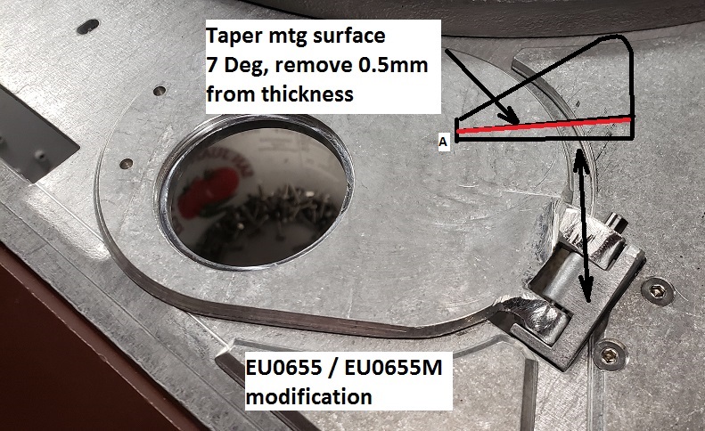

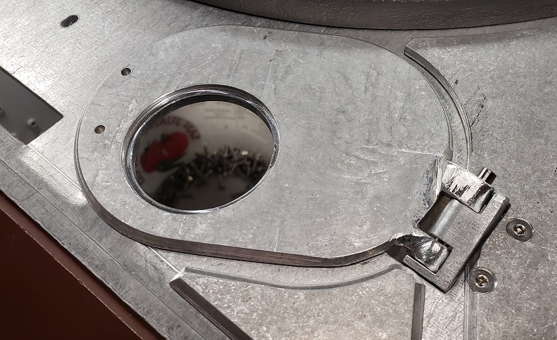

Derek the mod is pretty simple:
a) file the hatch hinge lower arm as in image below so hatch can fully pivot
b) modify EU0155 / EU0155M to remove 0.5-0.6mm AND taper the top surface 6-7 degrees.
c) Drill out pivot hole in EU0155 using #21 drill (0.159") - I found the hole too tight for the 4mm pin
Do same for both sides. The thinner edge "A" points toward front of tank.
B

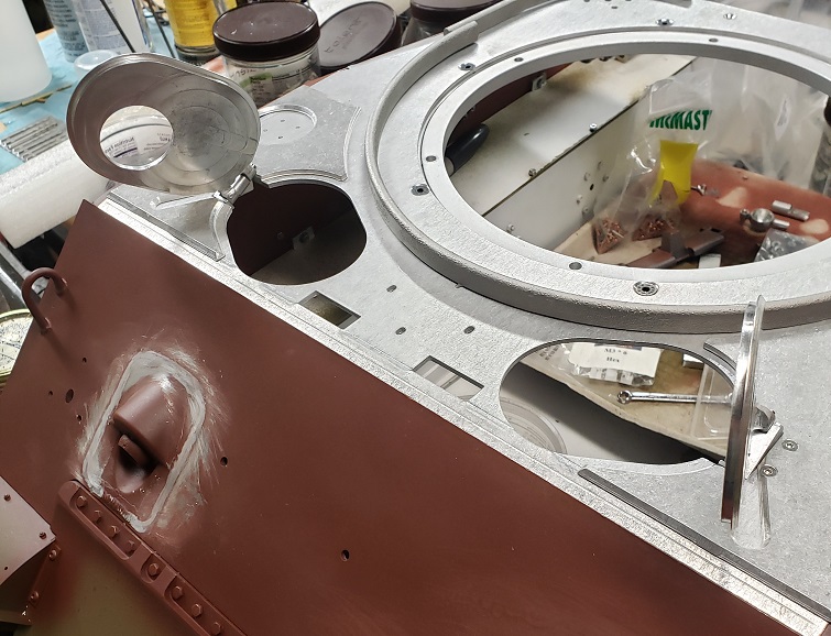

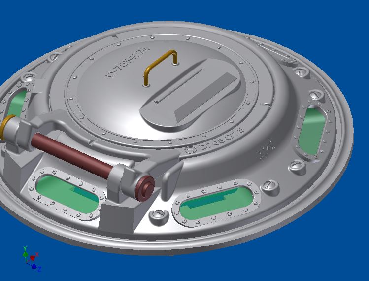

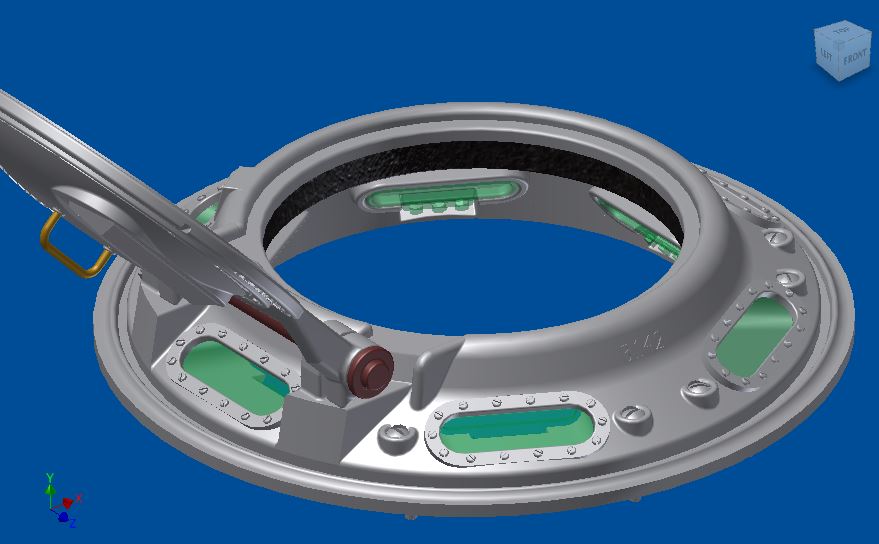

3D printed accessory for E8 forthcoming. Not quite finished with hatch interior details. Will be held on with magnets.
B
B
