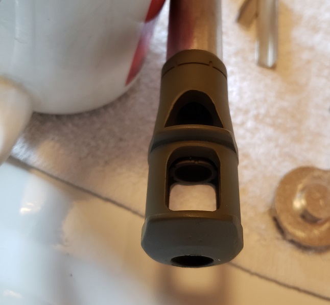

Few tweaks to the muzzle break.

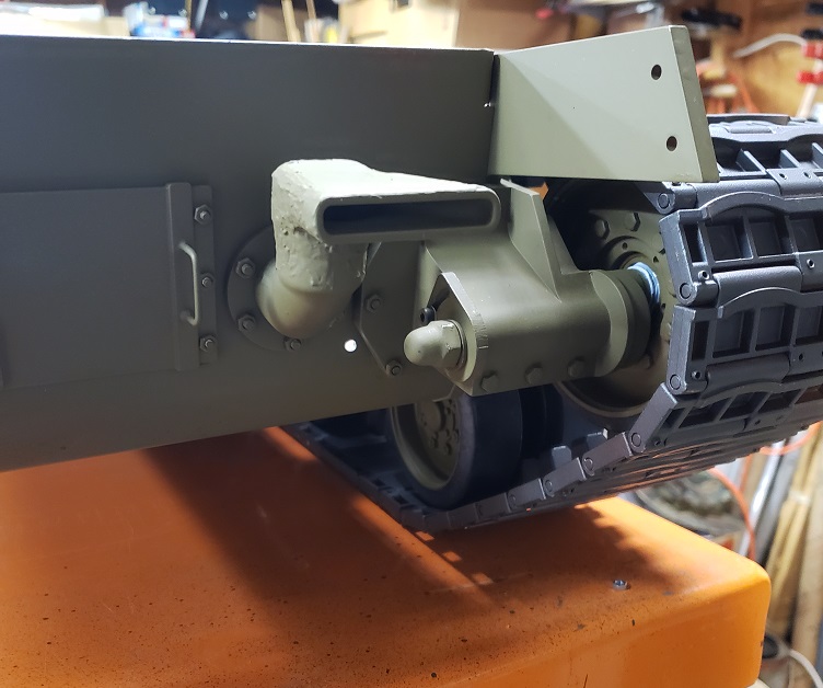

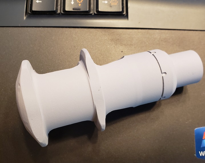

Some prototypes to make the stock exhaust work? Hard to get correct shape with pipe elbow. May just print a scale part?
Different pipe version

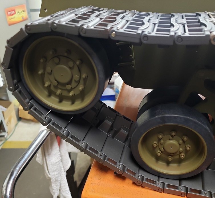

Cleaning, painting, assembling tracks...

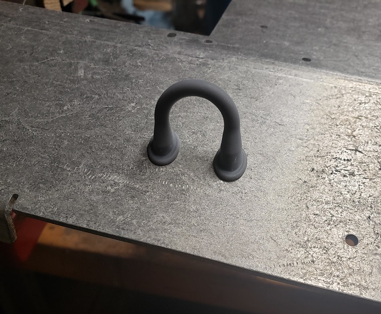

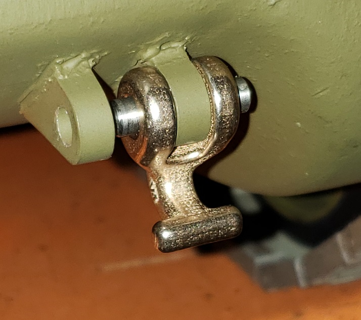

Tweaked the model for the tow hooks. Getting closer to real part now. Eventually will 3D print these in stainless steel.

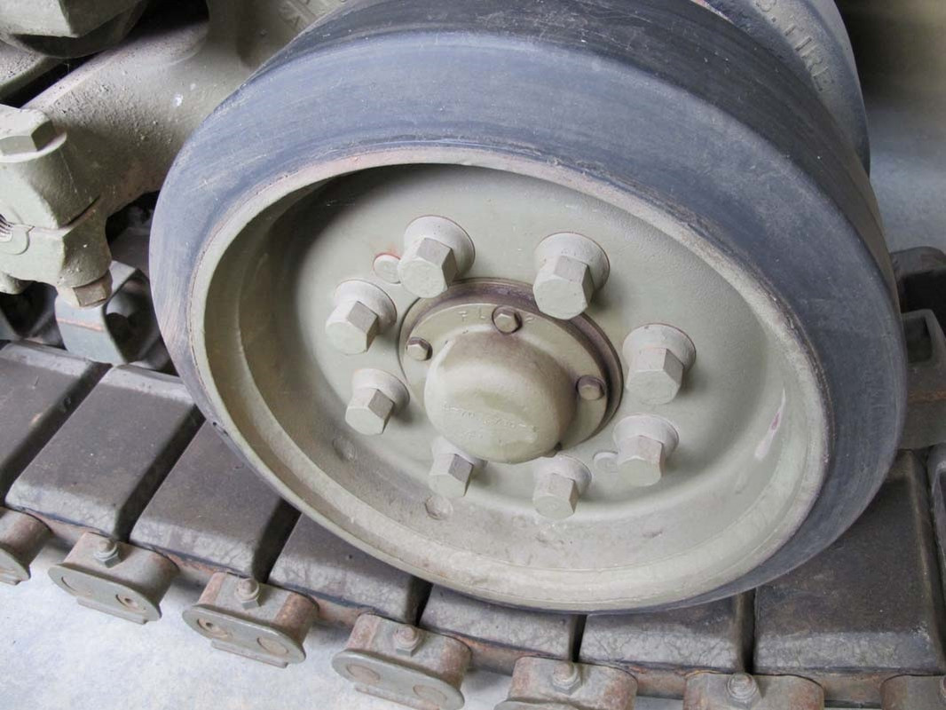

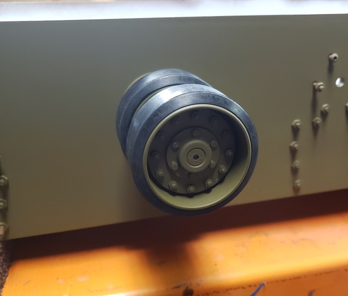

Hi Bob. I assembled my drive gear that way. Looked right. Then on one of the better pictures the nuts are on the outside on the outer face. They're on the inner side on the inner face.
- Posts: 2253
- Has liked: 103 times
- Been liked: 701 times
Re: Easy 8 - BobM
hi Glenn,
I see what you mean - the manual cross section view (Section 07, 08) - shows the nuts on outside of sprocket. However from the actual tank it looks like the bolt head are showing on outside. The hex size of M2.5 in kit is a bit big for scale. A couple ref pix below. One is the E8 of late Jacques Littlefield. The other "Son of Sherman" book. I see on AT prototype they put the nuts on outside of Sprocket - "assembled correctly per the manual". Functionally it wont make any difference either way. The bolts on the inner hub cap part do appear to be "nuts facing outside". These will be the faux bolts in the kit and should appear correct. Hope that helps.

I much prefer the nuts on the inside so I'm super happy this way around is the right way. It makes more sense with all the road wheels being this way also.

Bogey road wheel:

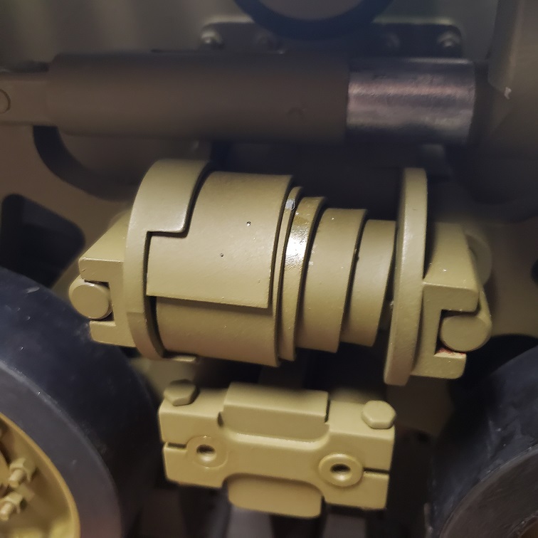

shock damper with light spring inside:

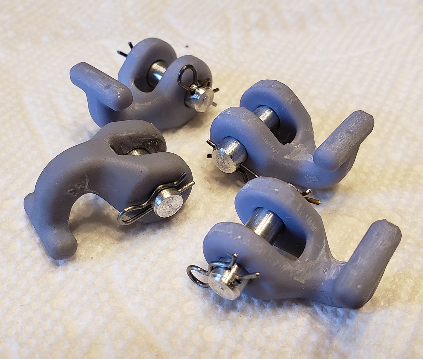

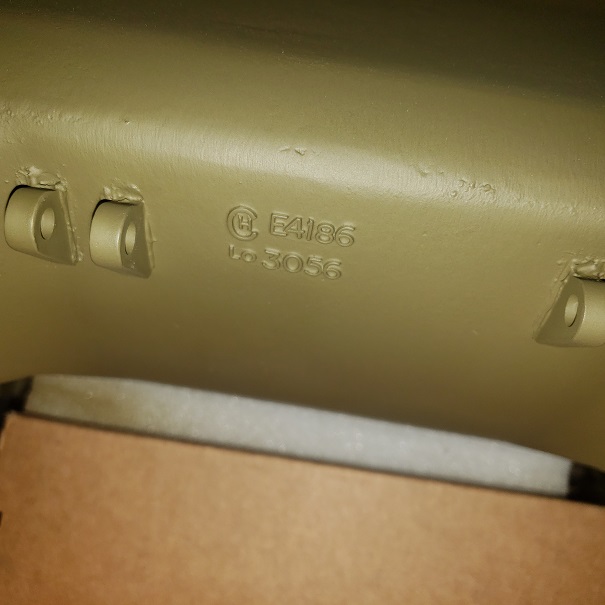

Printed shackle prototypes:
Casting numbers:

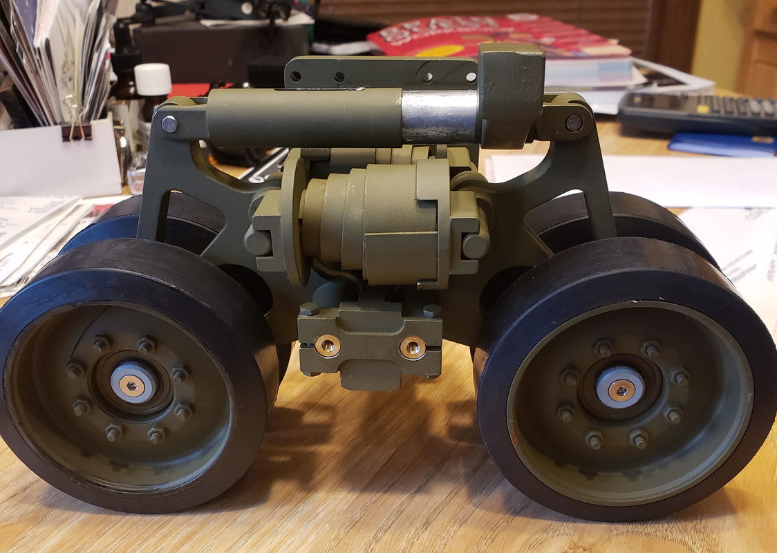

Bogey assembled:
Exhaust pipe installed:

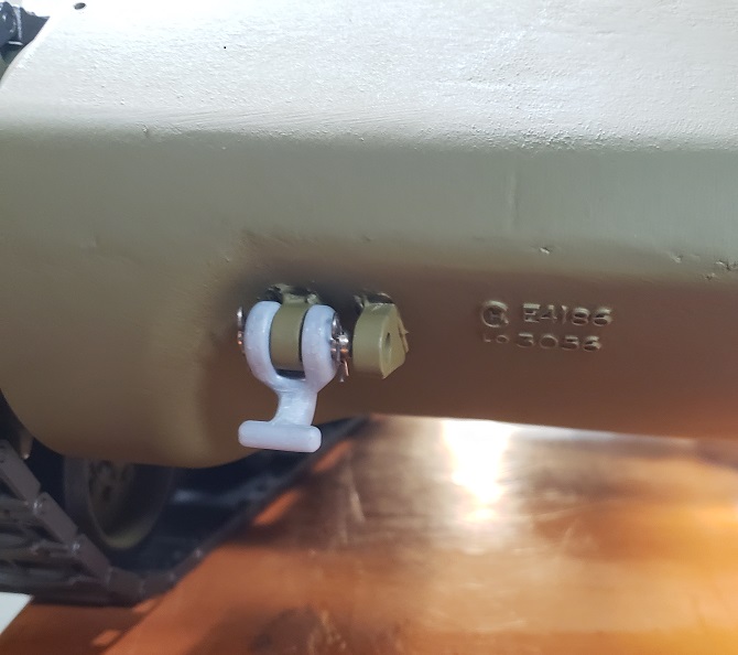

Front shackle installed:

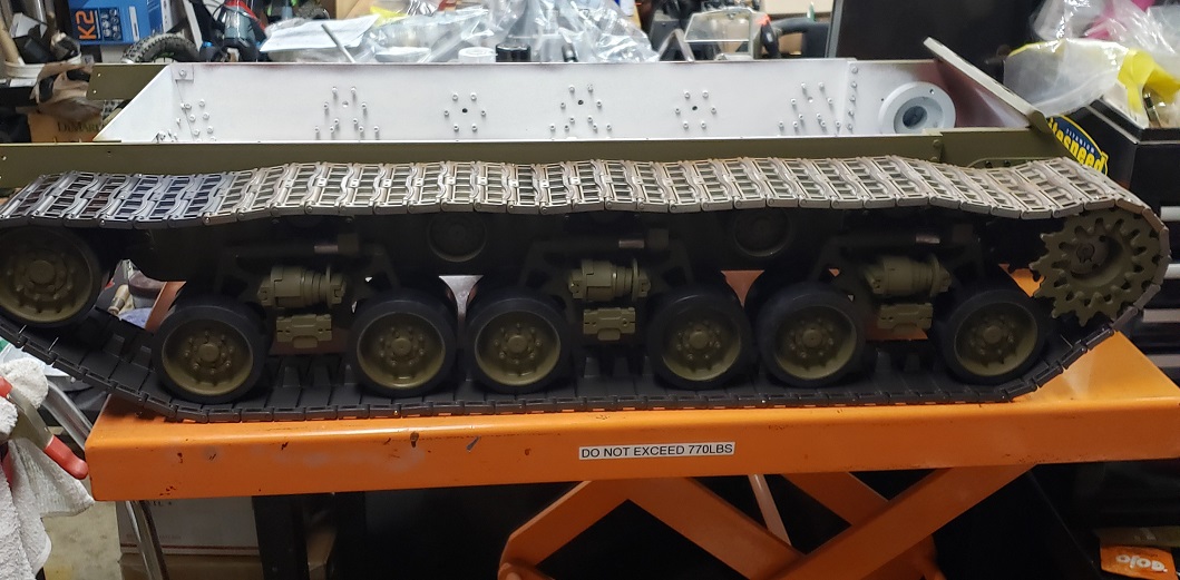

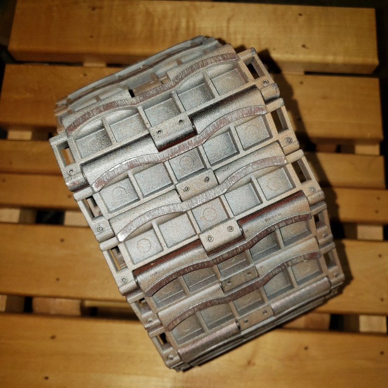

Weathered tracks - 1st pass:

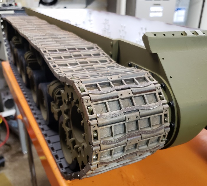

One side track installed:
Very cool to see tracks on one side! Till next time,

Steel printed lift hooks and tow hook:
