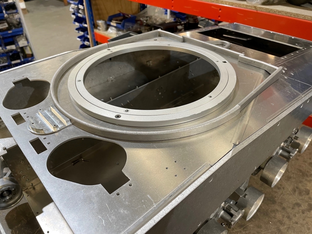

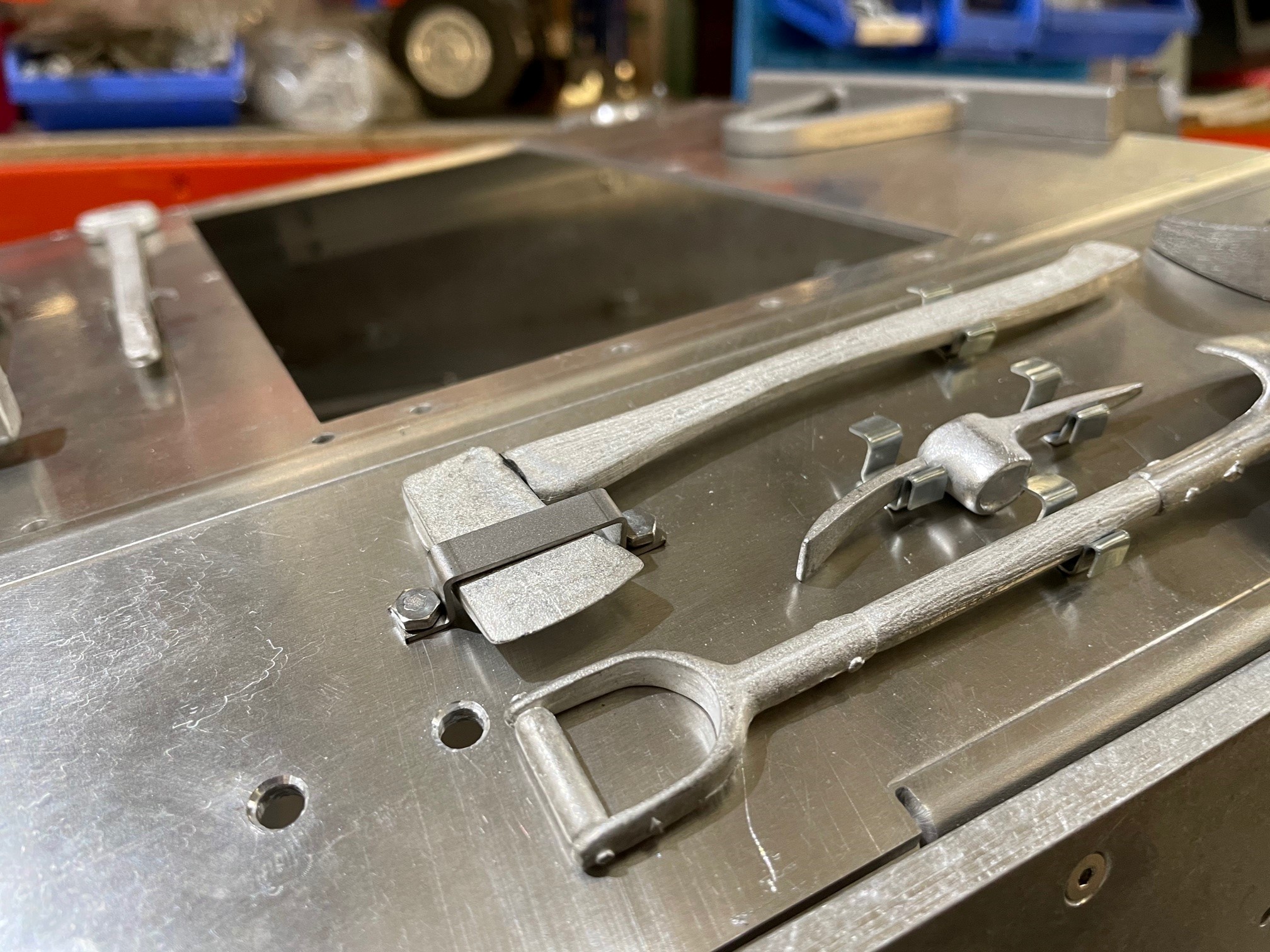

A few more pictures. Very happy with how the exhaust vents have come out.

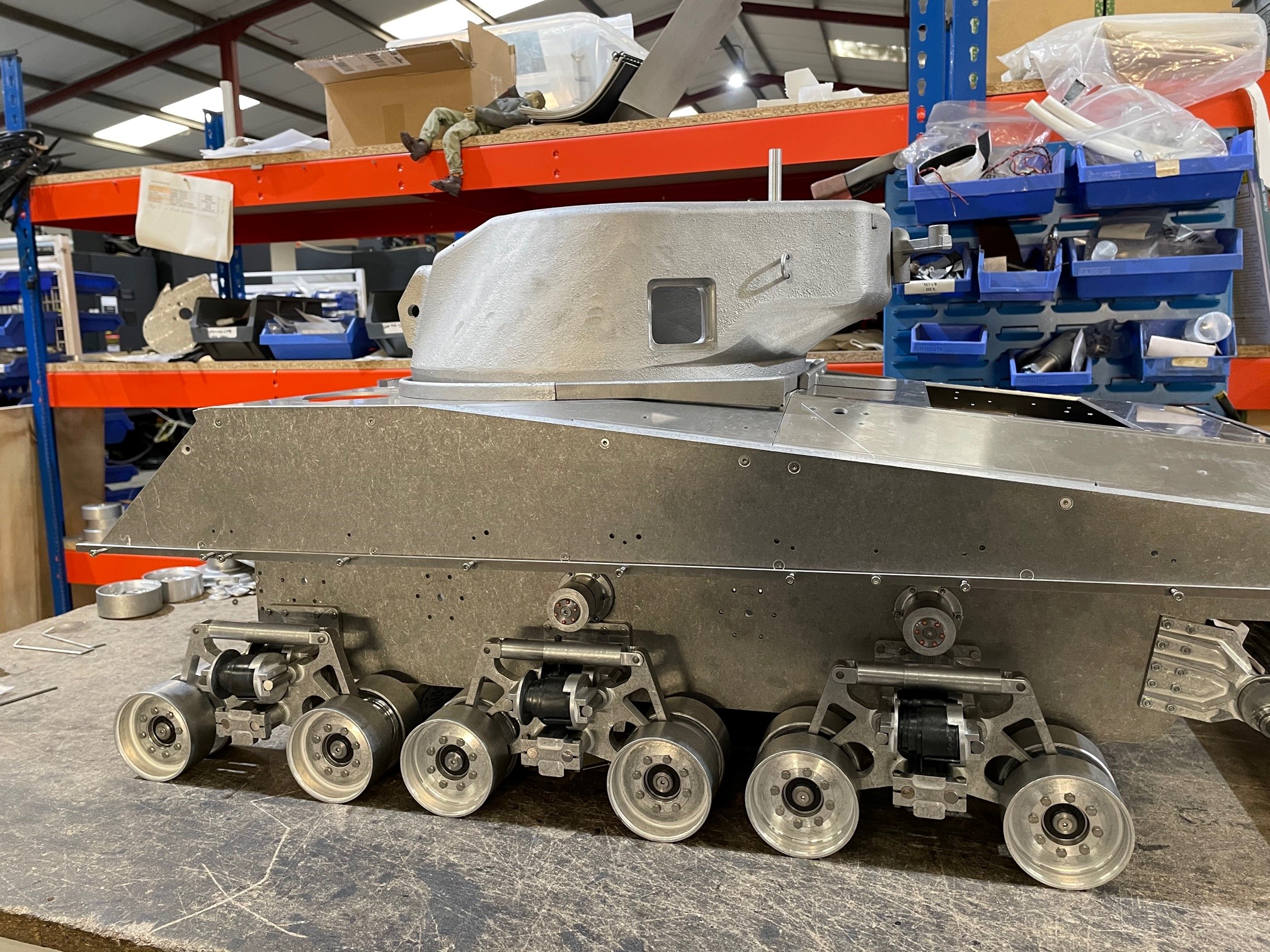

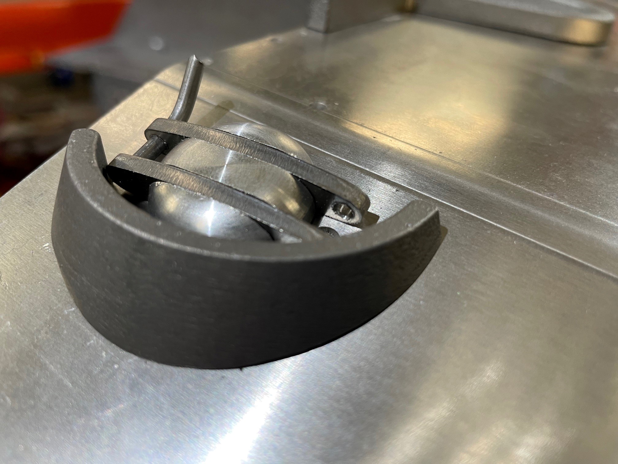

Bit of progress with the front deck, bullet rails and front vent
Gun mount on the turret

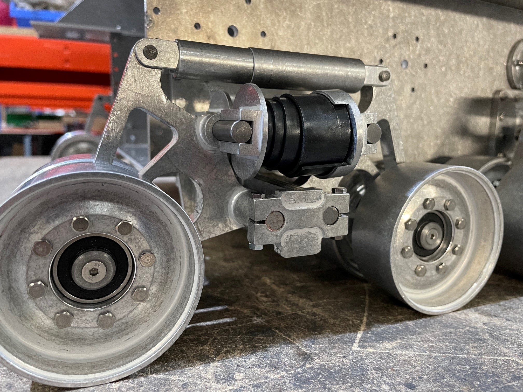

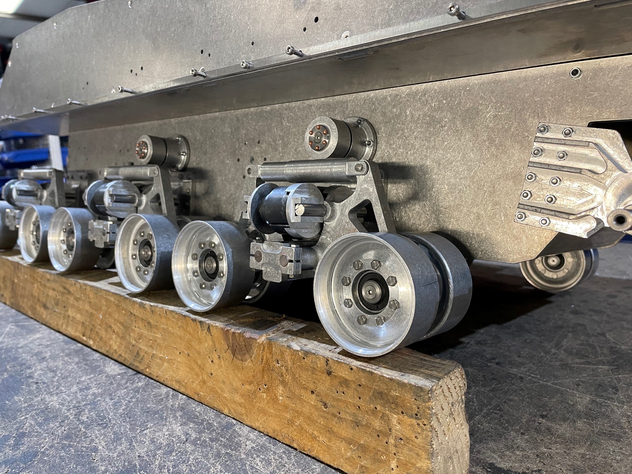

The prototype VOLUTE SPRINGS for the Horizontal Volute Spring Suspension (HVSS) have finally arrived.
Few minor changes needed, but otherwise looking good and working well.
