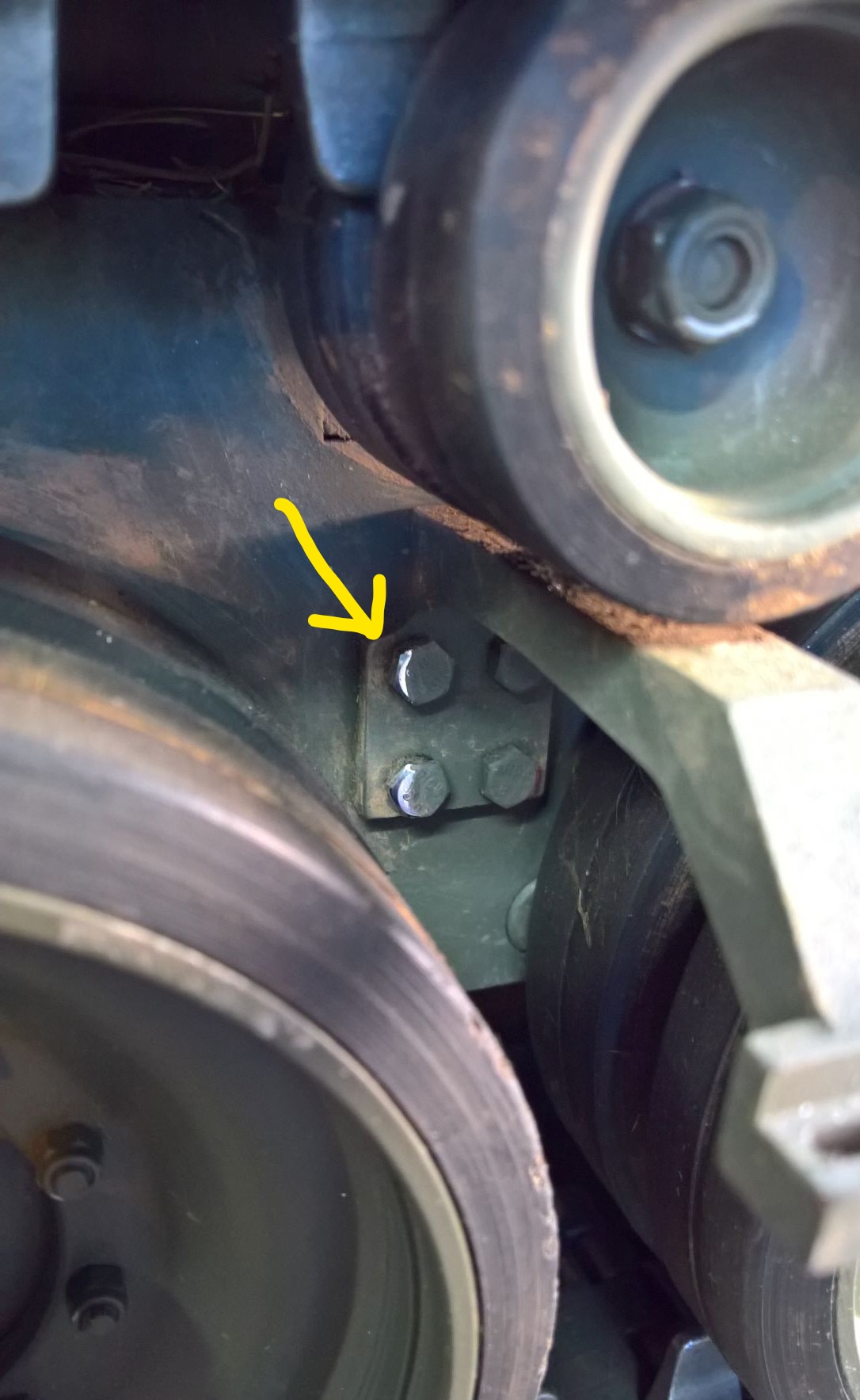

Re: Left tracks get stuck on turns
Hi Adrian,
Do the new red motion control boxes have current limits? I’m having issues with my chieftain where only one track rotates when turning. When the tank is lifted, the tracks function appropriately where the tracks rotate in different directions. It’s not confined to one side of the tracks. For example, if I turn right, it could be either side of the tracks that stalls. Can this be an issue from the tracks being too long or short? As always, your help is greatly appreciated
Wael
Wael
- Charles A Stewart
- Posts: 581
- Location: Cumbria
- Has liked: 510 times
- Been liked: 928 times
Good morning Wael.
I have had this with my Chieftain when I ran it last year, unfortunately I have it on the bench presently. One of the jobs I have done is to fit countersunk screws into the bazooka plate supports as there was rubbing on the tyres. As I say I haven't been able to check if this was the cause
Cheers Charles
