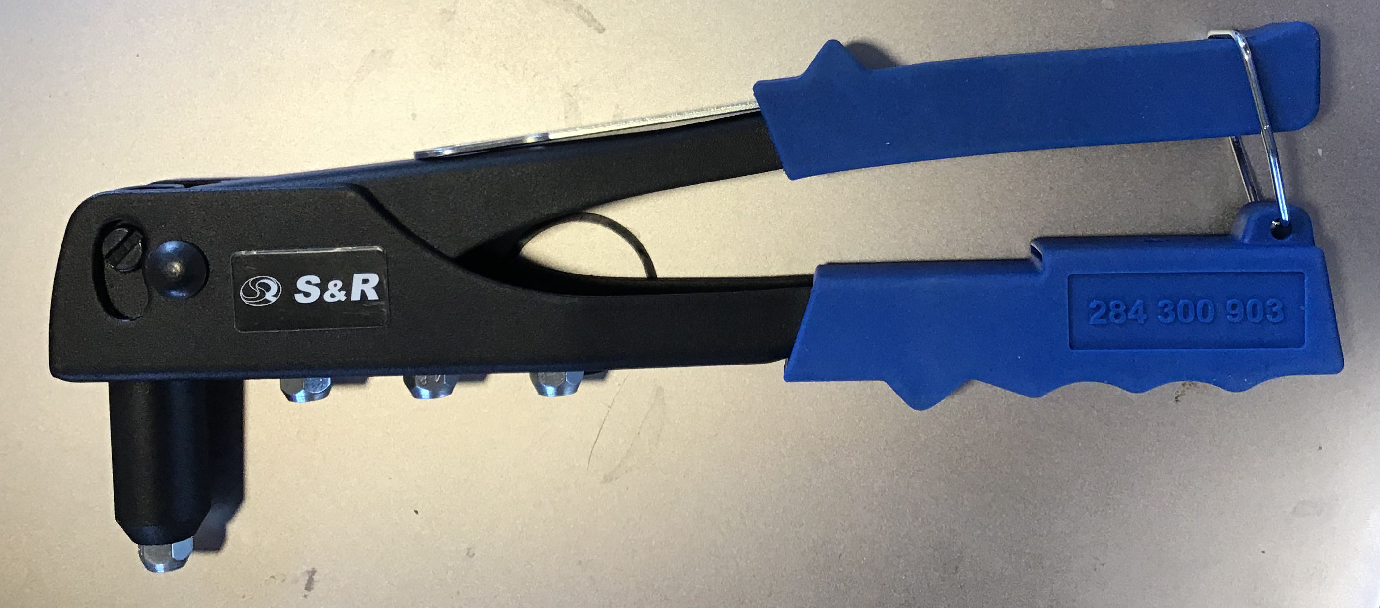

Hi Guys
Rivet tool arrived and it’s not long enough to be gripped by the tool by a long way.
These are the 5mm rivets in the UC.
Am I meant to is a rivet gun or do a bash them in like Rosie Rivet did?

What tool have you received ? Can you post a picture?
I am looking at my instructions for the universal Carrier and there are NO 5mm rivets.
So I do not understand your postings about 5mm rivets.
The list states 1.6mm rivets 10 off and 2.5mm rivets 210 off .
Re: Rivets
Ahh the mist is clearing - the 2 somehow got erased from the packet leaving a 5 and without me specs....
Photos attached.
Photos attached.

The tool you have is for pop rivets (as used in aircraft manufacturing) not for the copper rivets you have in the kit.
You need rivet snaps and a hammer if you wish to rivet rather than glue the copper rivets in the Carrier model.

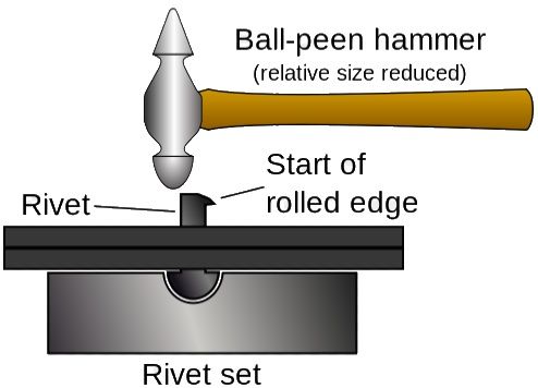

As Derek mentioned, if you want to buy a tool to help peen the rivets then you need a rivet snap and a ball peen (pein) hammer
