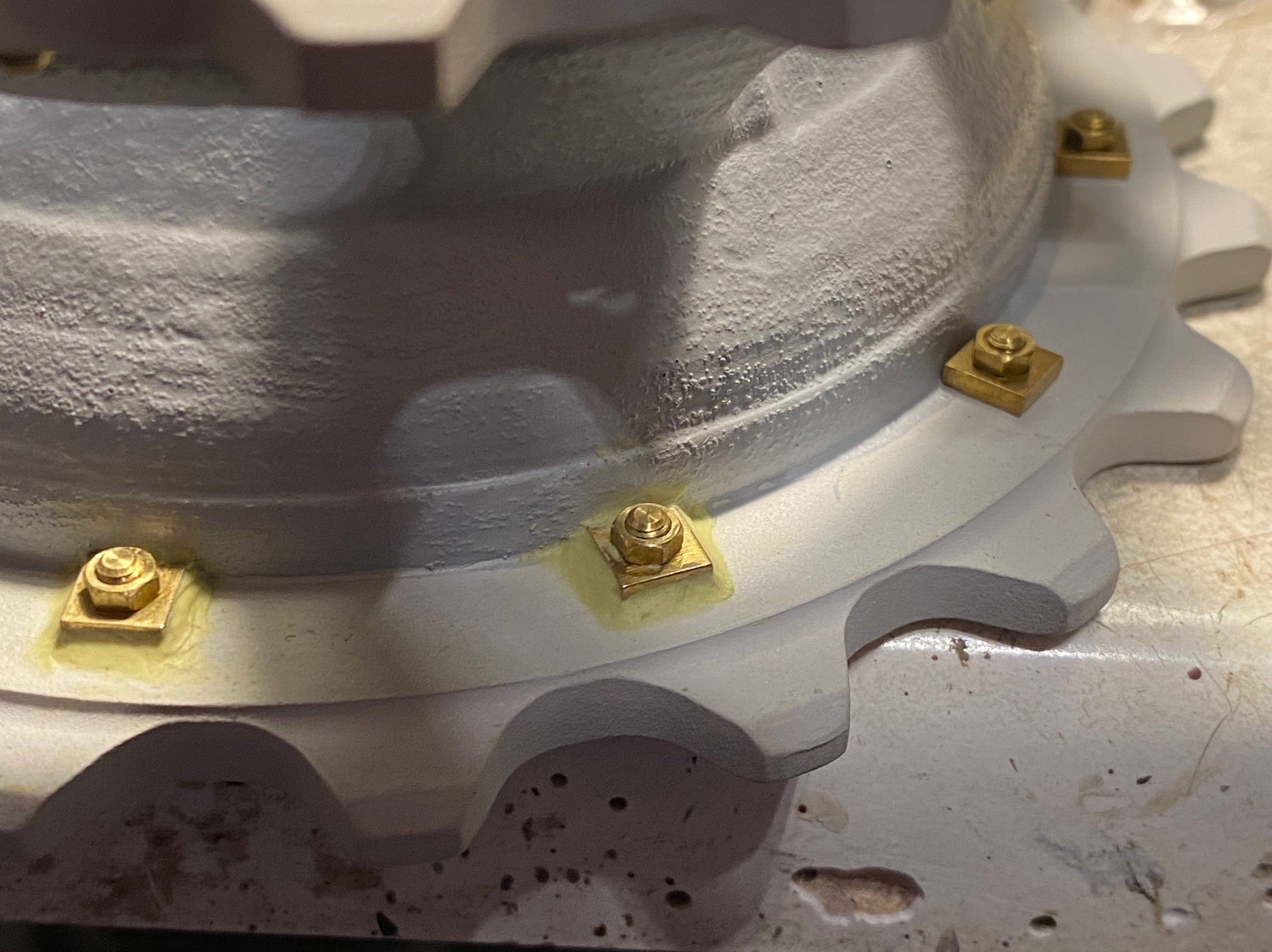

Here are some photos from the sprocket with casting numbers and on the later photos with the first layer of Mr.Surfacer including sand. The next 2 layers are coming without sand to smooth the first one.

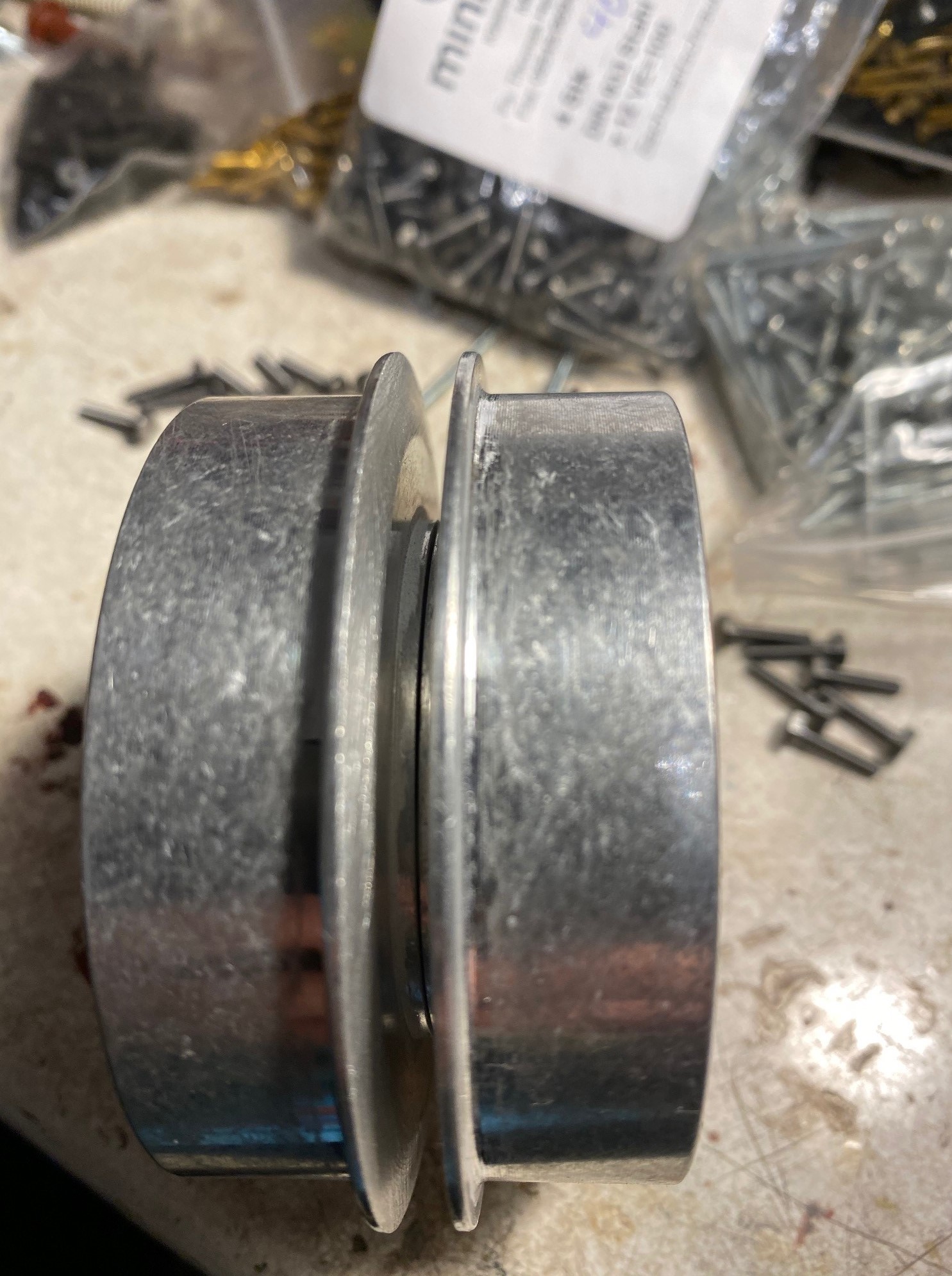

The outer road wheel got 2 threads M5 on opposite side beneath the pin 4x22 and the inner wheel has a bigger hole and a countersink for a countersunk screw M5x30.

Hi Martin,Martin Hofmann wrote: ↑Wed Dec 09, 2020 6:19 pm... The outer road wheel got 2 threads M5 on opposite side beneath the pin 4x22 and the inner wheel has a bigger hole and a countersink for a countersunk screw M5x30...
What is the reason you are adding the M5x30? The two wheels are axially locked up on the shaft and the 4x22's prevent them from turning separately?

The reasons for adding the M5x30 are following:
First: Every pin has tolerances - normally: plus. Also every hole has tolerances - normally also: plus.
But it could be, that the plus in the hole is bigger than the plus at the pin. So you could get some clearance between both parts.
Therefor the half of the roadwheels want to tilt a little. But that is a movement that the bearings don't like. That is the first reason for screwing the halfs together.
Second: when forces are introduced through the horns of the track, the track wants to drive the two halfes of the wheels apart. When the two halfes are screwed together, both wheels transfer the forces to the two bearings. So you can be sure that everytime both wheels are get the same load.
I hope you understand what i mean and why I screwed the road wheels together.

Hi Martin,
No problem, there is no rush when it comes to our hobbies
Thank you for explaining the M5's, it does make sense.
Although the pins have a tight fit in the holes I tried so far, I might consider it applying it on my wheels as well.

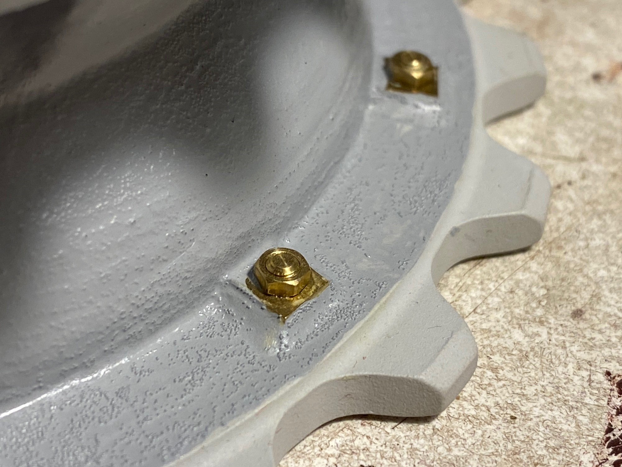

Something done on the sprockets, casting surface in several layers with Mr.Surfacer, new flat area for the screws

What kind of bubbles / sand do you use in your primer?
are the square nuts from knupfer?

Florian: i use sand from a sand blaster with a size of approx. 90 micrometer in the first layer.
The second and third layer has no sand in it to smooth the sand and give the surface a look of casting.
And yes: the sqare nuts are from Knupfer - M3 as used like a washer.
