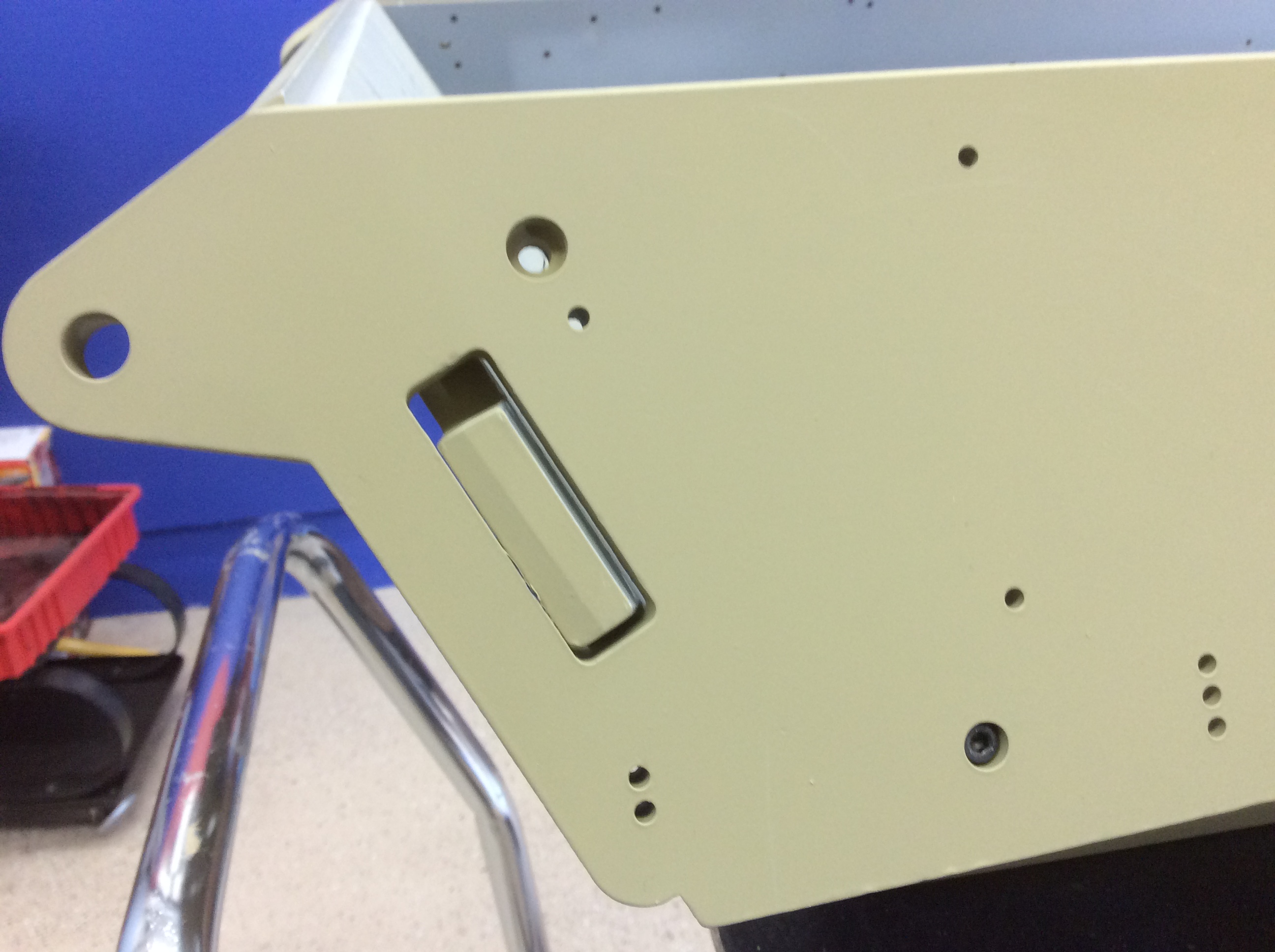

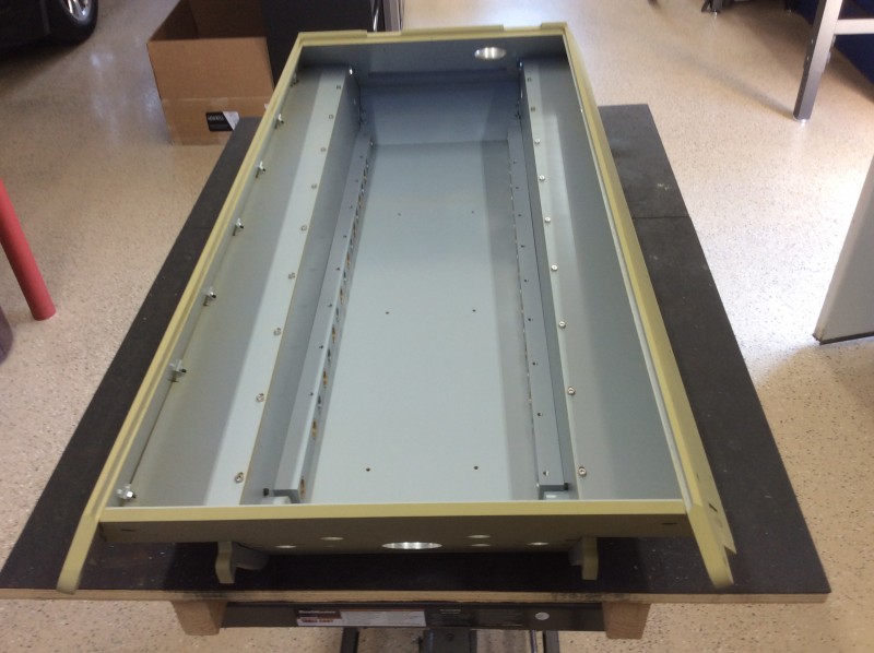

Now that the Panzer and FAMO are complete I have started on the KT project. The project has started rather smoothly except for all the fitting required to get the hull together correctly. The upper and lower side plates had a significant bow in them that I got out by placing the parts on the shop floor with a block of wood at each end and jumping on the center. This is something Armortek should have remedied before shipping. There is also a lot of filling necessary to get all the parts to line up correctly. Not difficult just a lot of it. The rear plate in my kit is about 3/16 of an inch too hi. Since the part is too big to fit in my bench mill I resorted to filling slots in the part where it meets the frame to get it down so the top plates would line up correctly. With all that behind me the rest of the project has bee very enjoyable. I am now waiting for the option paks to arrive. I want to install the drive motors while that area is accessible. Meanwhile I will start applying all the welds where appropriate.

I too had banana shaped hull sides and jumped up and down on them... but unfortunately not heavy enough to make an impression! Not having equipment to straighten them meant filing the decking to suit the bend. Also had to modify the track tensioner on one side to aligne the tensioner bolt with the tensioner slot. Yes, the rear plate needed adjusting too! There are other challenges you’ll come across, including decking brackets that cover fixing holes for the cable retaining brackets. It will be interesting to hear how you get on with the turret! Apart from that, it’s a great model and worth overcoming the challenges to produce a magnificent beast of a tank!

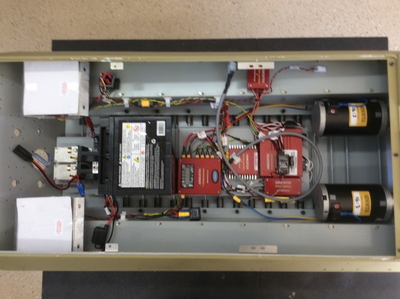

Hi Guys,

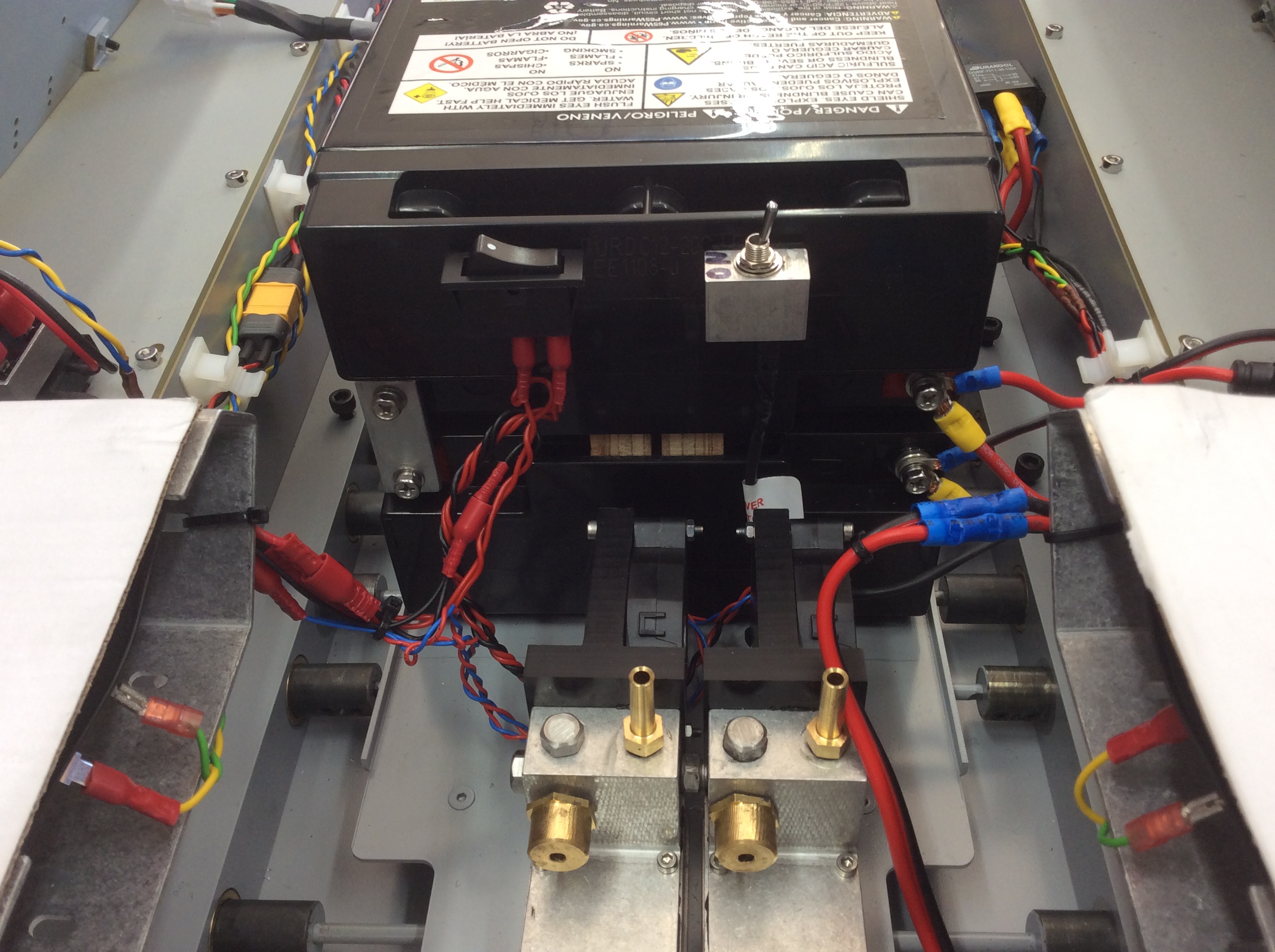

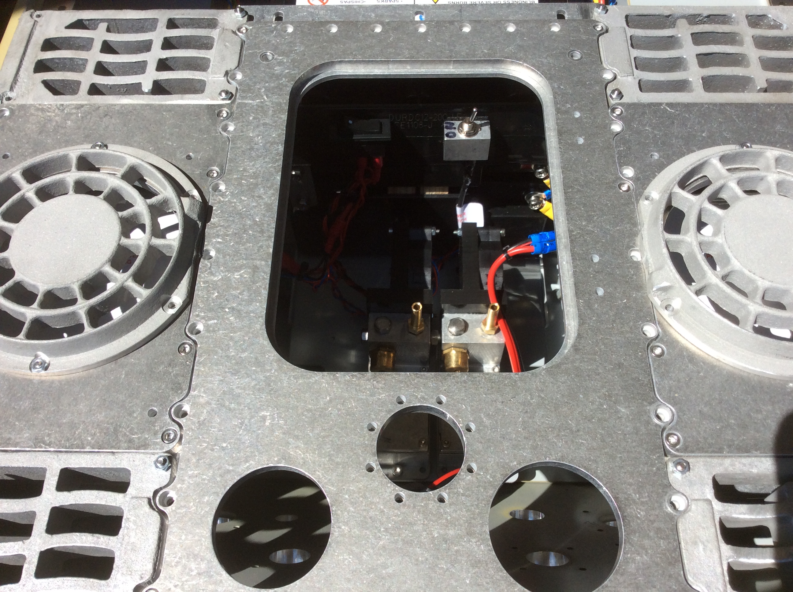

I have been installing the option paks in my KT. Everything went together smoothly and works great. I love the main gun sound.

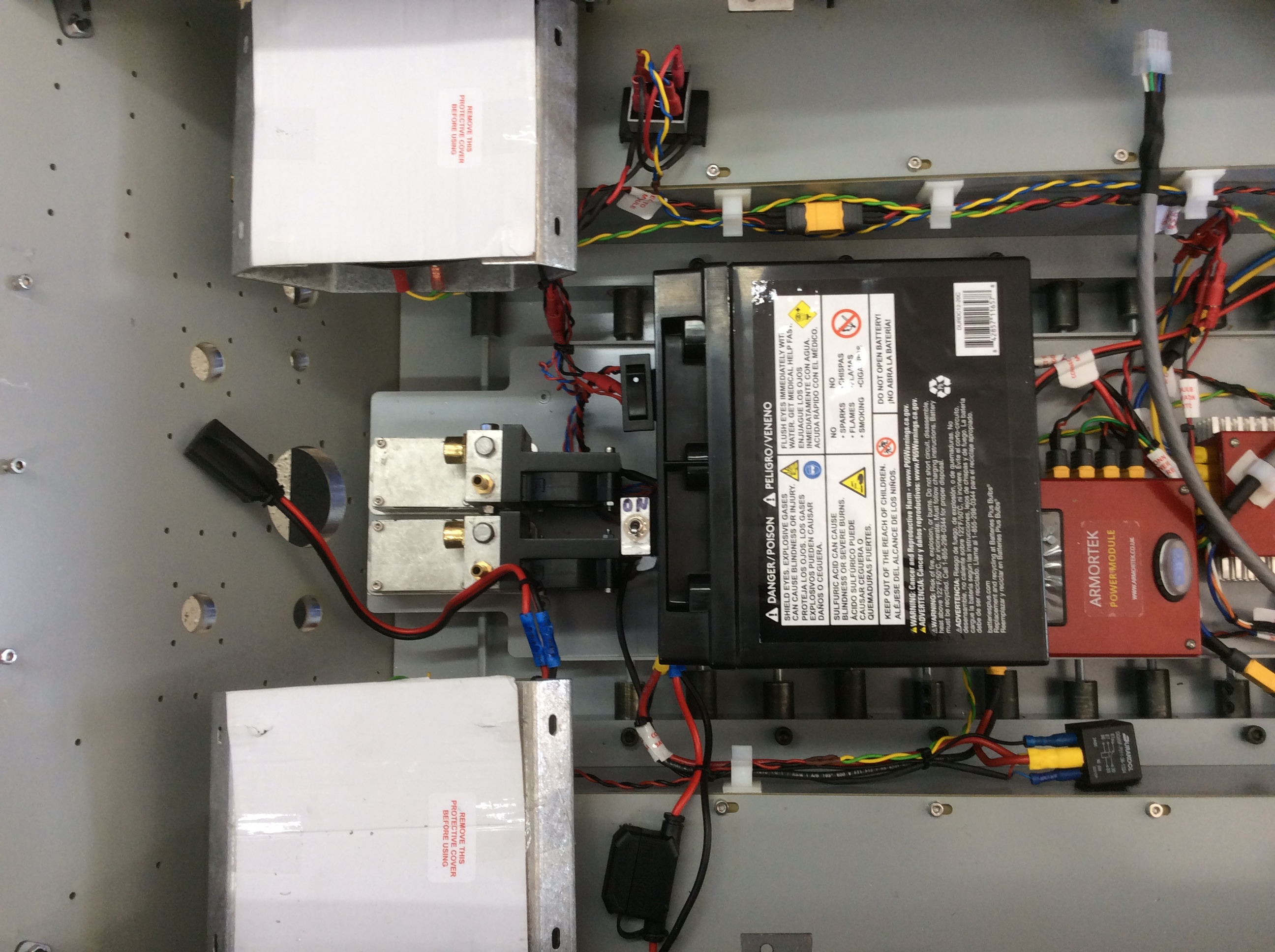

I modified the rear deck assembly to be removable like Simon Manning did in his KT build post. In addition I slotted the 3 holes in the rear mounting bracket to make the hatch easier to remove. Now the batteries can be removed by only removing the rear deck. Inside the hinged hatch in the rear deck is a great place to install the charging plug, on/off switches and smoke refill tubes. The small hatches in the front deck make good access the the volume knob and binding switch on the receiver.

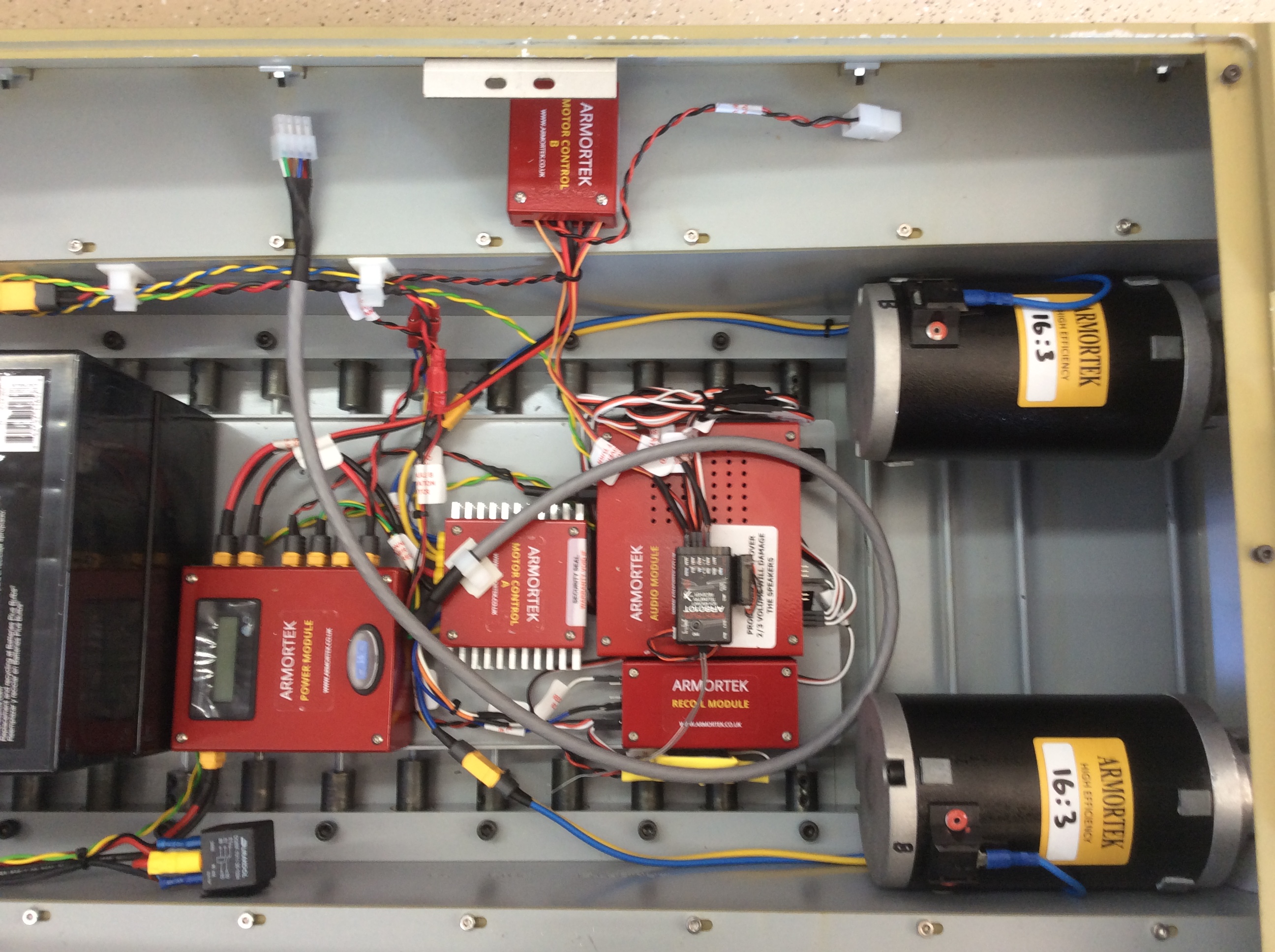

Building is fast and very good.
The "16:3" writing on the drive motor, what is it stand for?
Regards,
Lerh Chang
Regards,
Lerh Chang

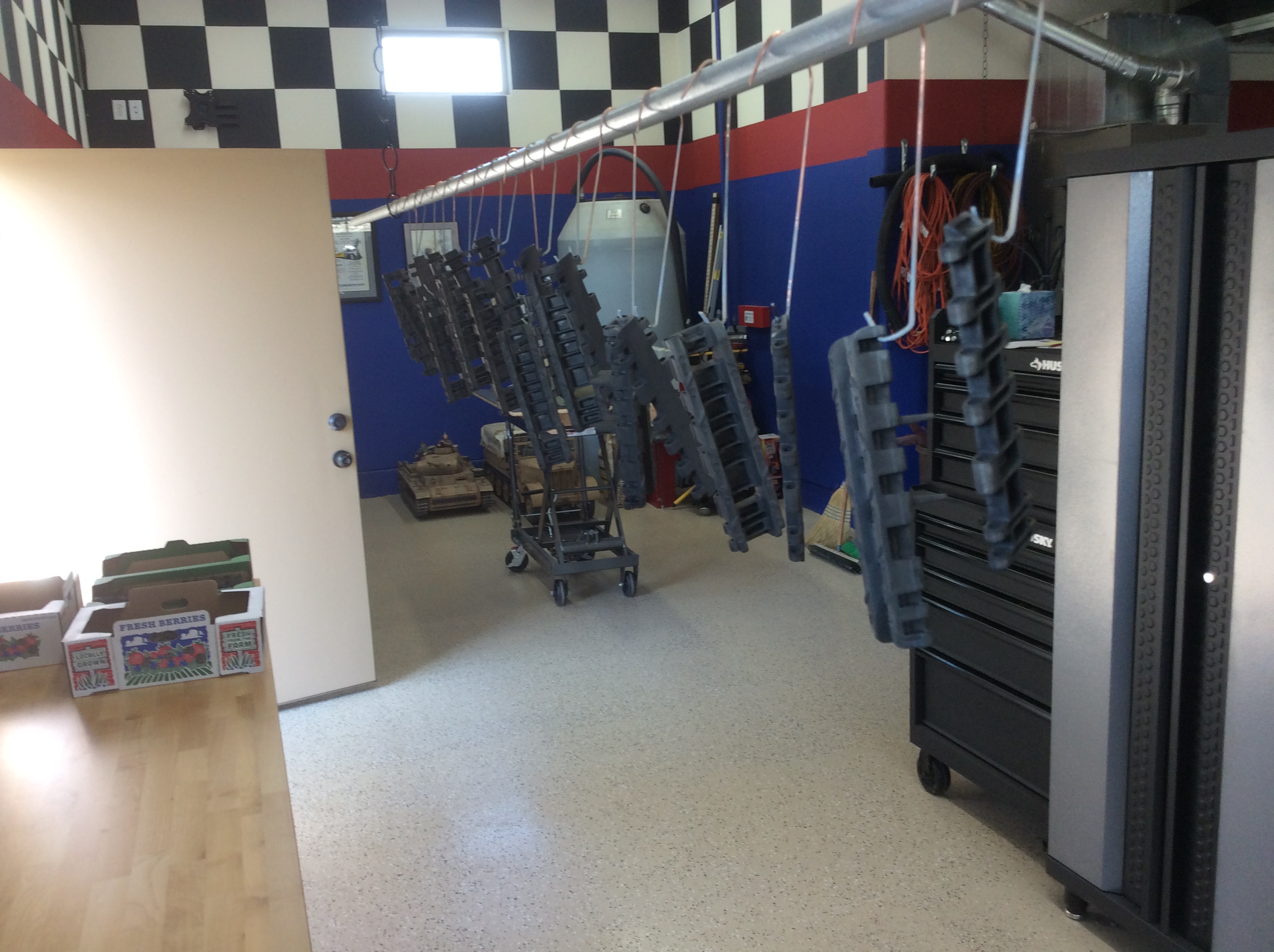

Tom looking good! What kind of burnishing liquid did use for the tracks?!

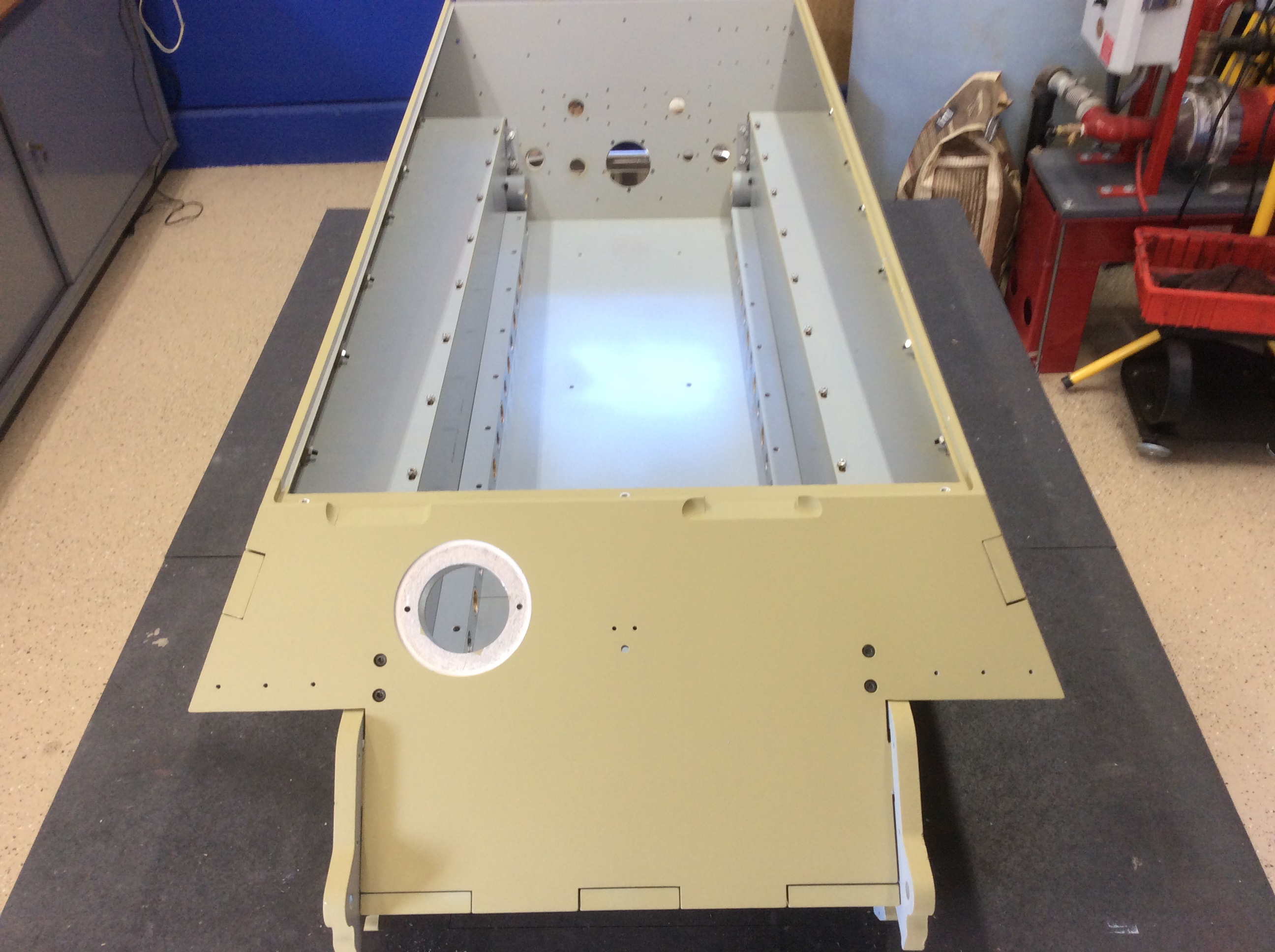

Looking good! On your hull construction, did you find the upper hull sides to be difficult to line up? On my No. 18, the screw hole to the upper front plate is off by quite a bit. The solution appears to be to put it up on a mill and skim 0.0625 or more where the side plate meets the back of the front glacis plate. Your post suggests a lot of filing, but I just want to see how you did yours.

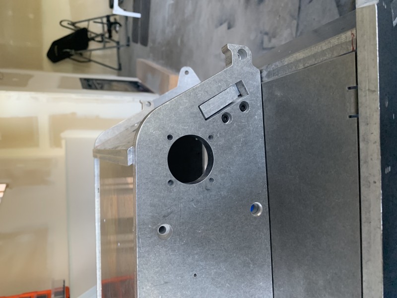

Hi Robert,
My parts lined up pretty well at the front. If you can fit the parts in a mill that would be a lot easier and accurate than filing. These parts have a lot of angles on them and in Armortek's defense, even the smallest misalignment in machining will make huge misalignment with parts of this size. The whole assembly was very frustrating. I am in the process of adding welds to all the seems 1. for realism and 2. to cover the less than perfect seams. Hang in there. The kit is a lot more fun once you get past the hull stage.

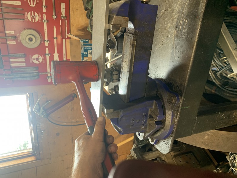

I'm curious about this bent hull side issue. How bent are these pieces? I have a KT kit that I've yet to begin and I want to know what I'm up against.Phil Young wrote: ↑Sat Jul 11, 2020 8:38 pmHi Tom

The upper and lower sides in my kit had about a 1/4" of bow in them. Your press should do the job assuming they will fit. You should support the parts at each end and press down in the center. I stood in the center and bounced up and down. It worked for me because I am 6' 8" and weigh 230lbs. If you do not try to straighten the sides, some of the bow will come out when they are bolted to other parts.

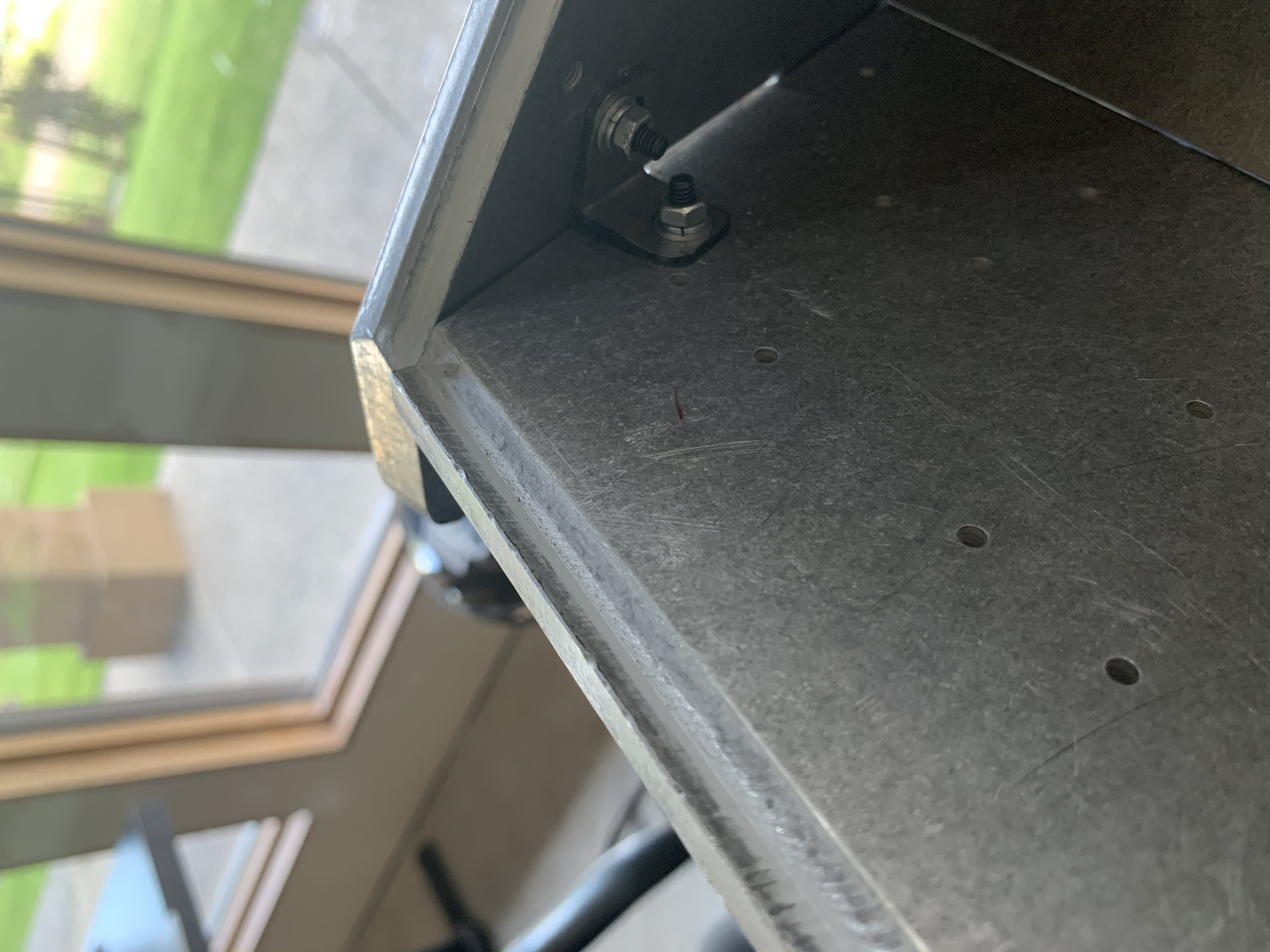

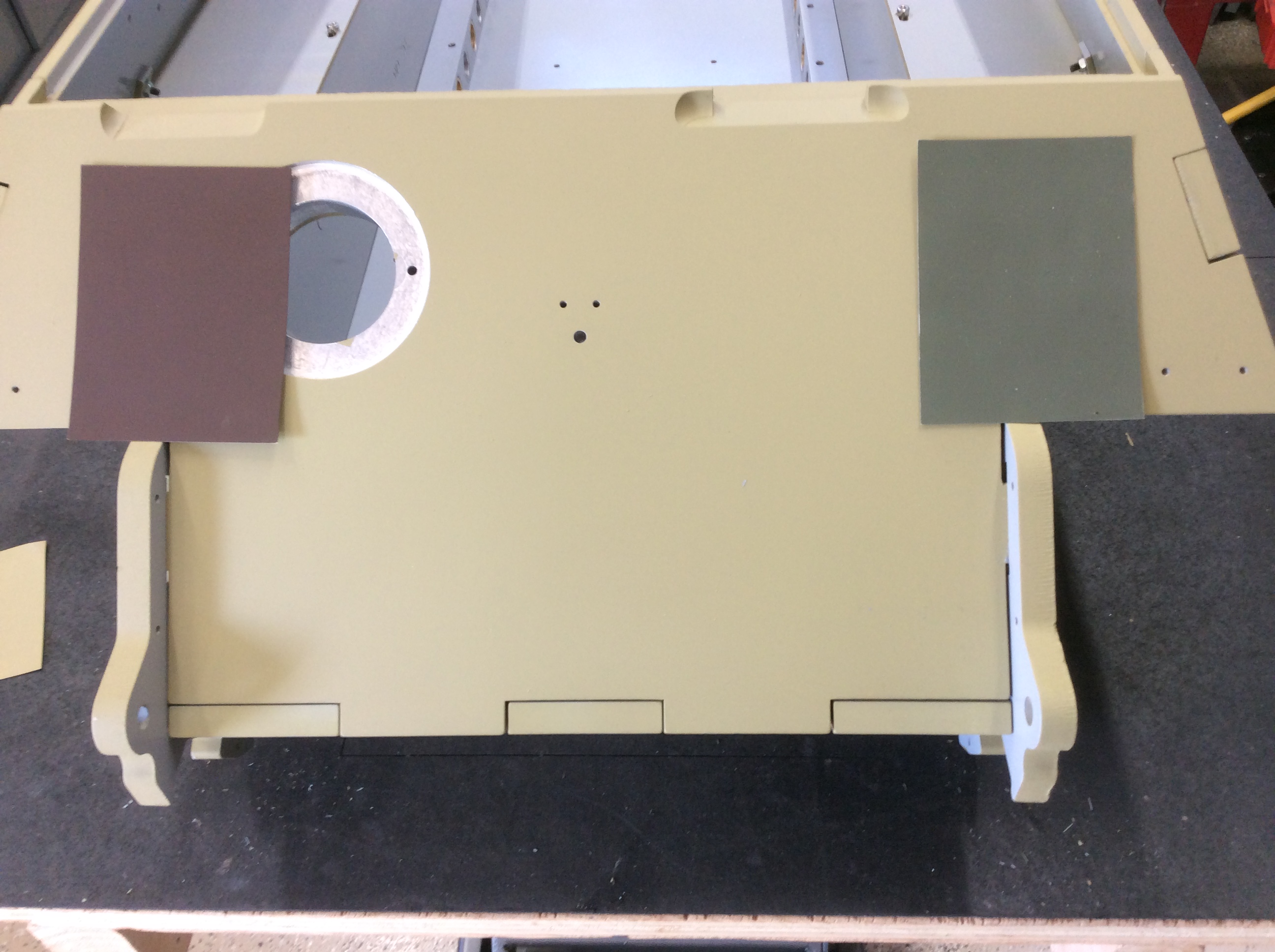

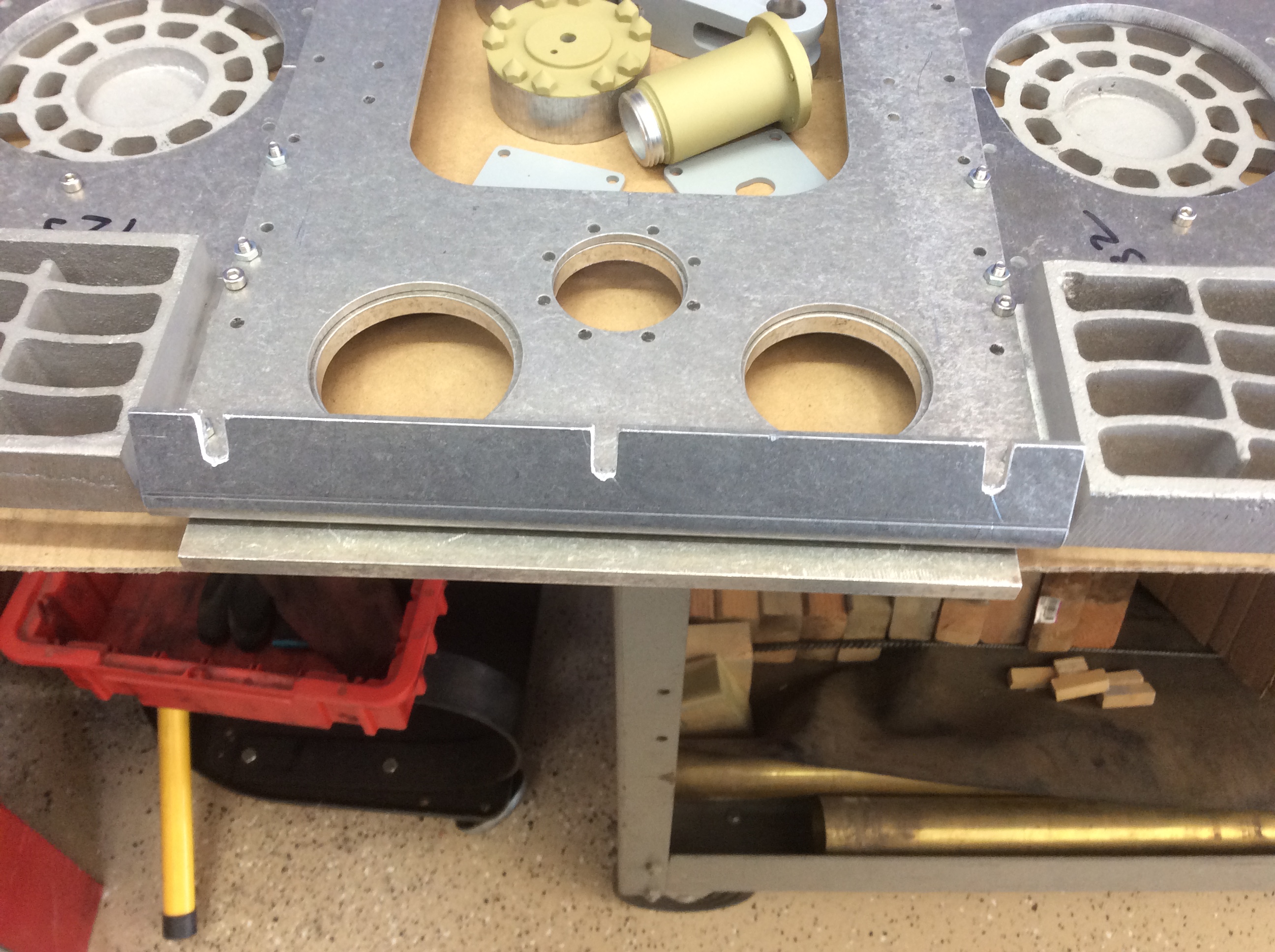

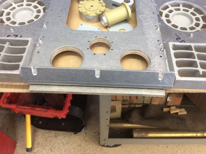

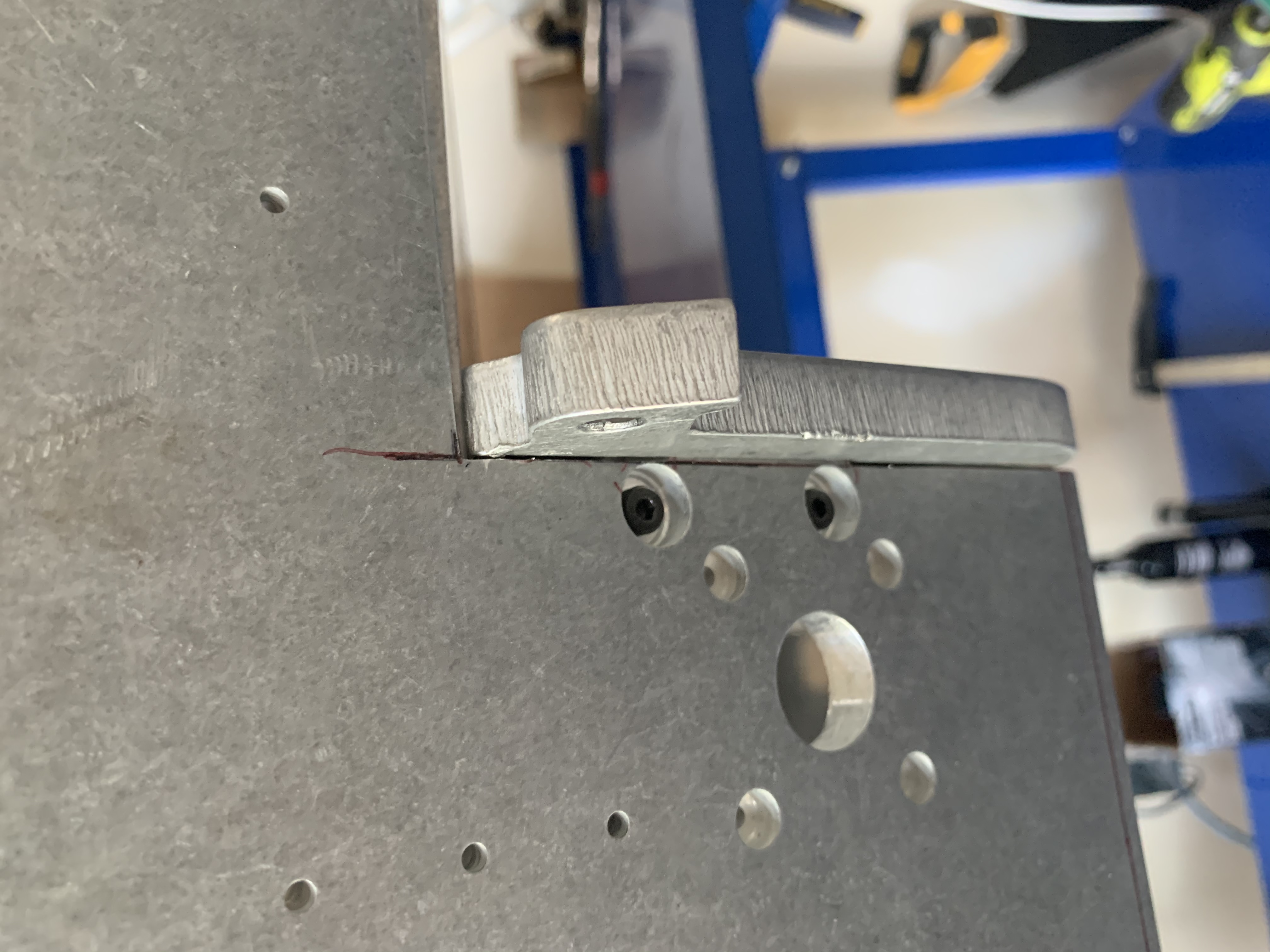

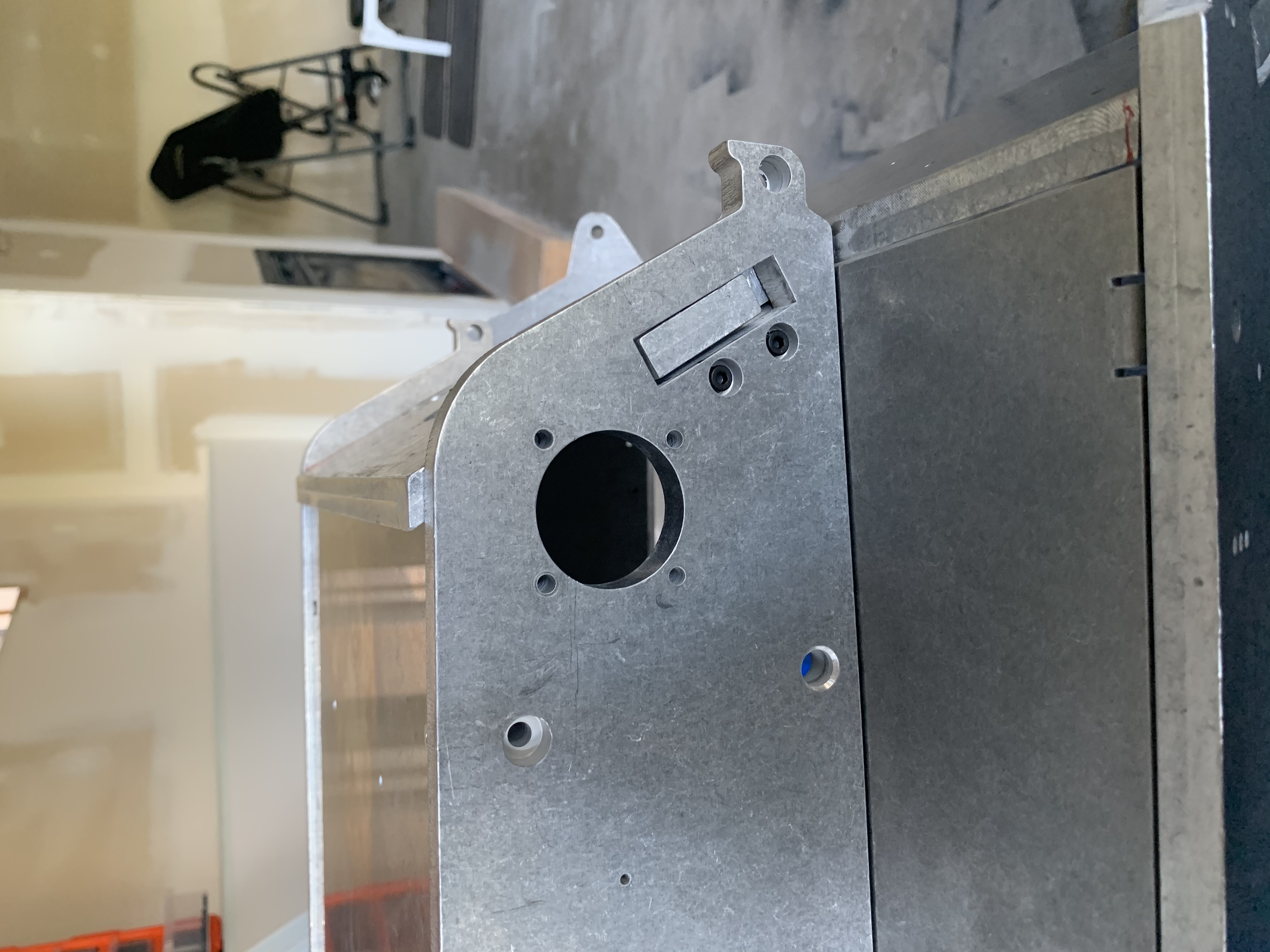

Hello Tom
When you lowered your rear hull plate did you have to remove extra material off of the bottom that protruded past the lower hull side plates ? Do you agree that the rear hull plate when fit should sit on top of side plates to look right. I can raise my rear plate and still make everything fit and level but don’t think it looks right. Here are some pics of how my back end looks at the moment
Brent
