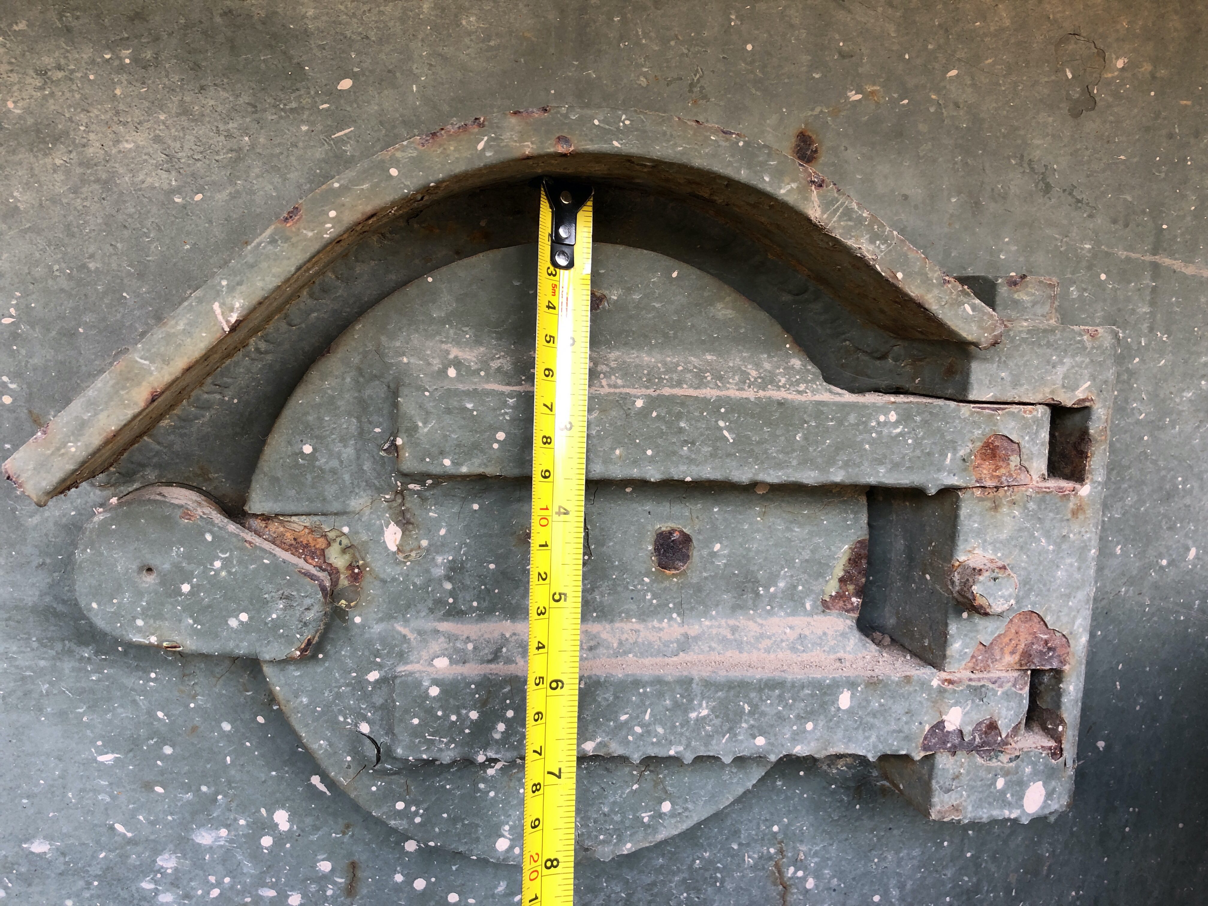

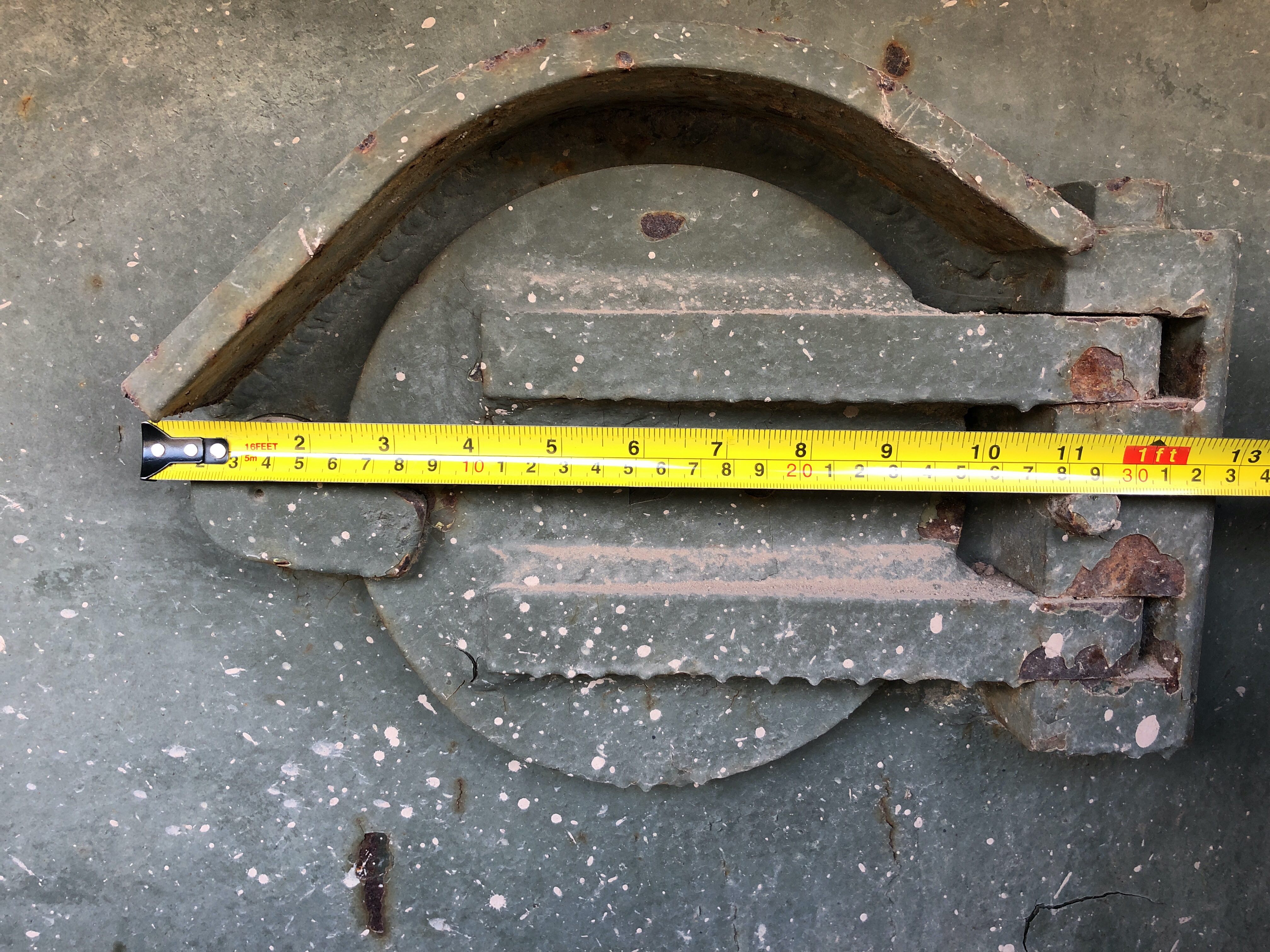

Does any one know what the diameter of the waste disposal hatch is please?

Fantastic service Stephen.
Is that Chieftain in your back yard?

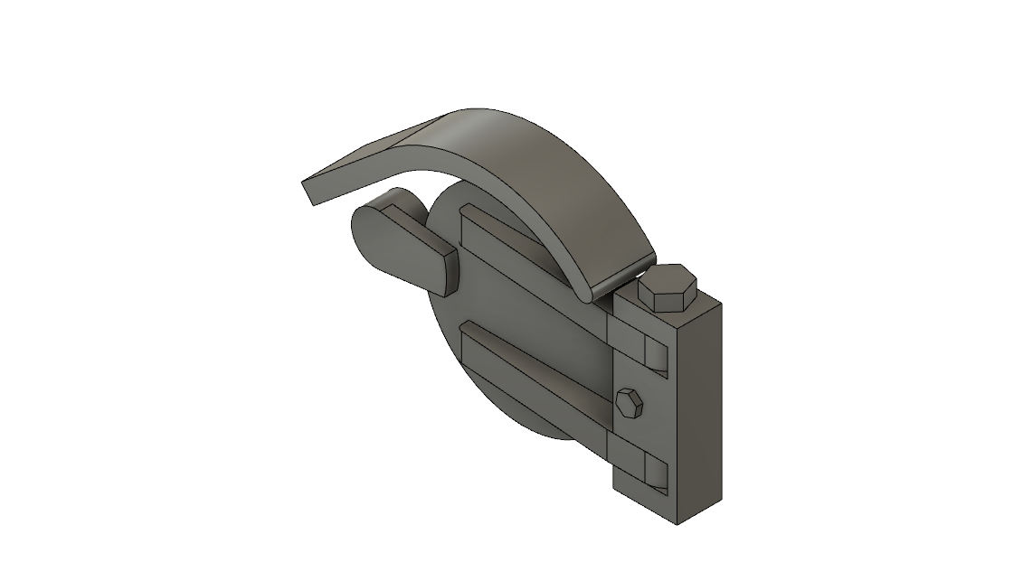

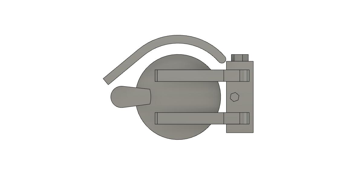

Just to pass the time made a 3D drawing of the hatch.
Could easily be 3D printed and glued in place.

Nice one Vince. Your metal version is great also John. Just proves there is more than one way to skin a cat.
Wouldn’t mind betting that .stl file is soon in Mr Woollard’s inbox

Phil did not ask for it. I just made it to pass the time. One thing I'm still not sure about my drawing is the thickness of the material. I had to use an educated guess.Wouldn’t mind betting that .stl file is soon in Mr Woollard’s inbox
John what thickness are you using for that round hatch? I used 3mm material in my drawing.

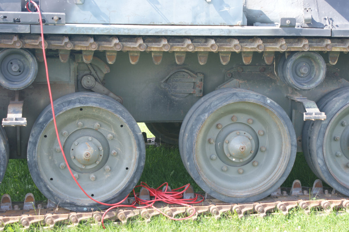

Where indeed, since the bogies are not quite to scale and I'm not sure of the hull height under the mud guards.
It's going to be pin the tail on the donkey time.
I've fashioned a hinge, and step drill cutter is at the ready.
I made the waste hatch inside diameter 20mm and reckoned to use the 20mm and 22mm step on the cutter as my guide for the through hole. I end up with a nice little rebate too.
I have been dreading drilling a 22mm hole in the side hull for some time, but if I want the hatch to work and try and keep one step in front of the 3d printers of this world, an idiot's got to do what an idiot's got to do.
It's all guess work, you make a scale part and it either works or it doesn't. The hatch has been set a little high on the hull side to align with original tank bogie position, but this makes it slightly high from the bottom of the model hull. But any lower it would wrong with the bogie. Hummm, It should look better when I add the guard and latch, I hope.
Better still when obscured by the road wheels, even better when the Bazooka plates are fitted. Virtually hidden from view.
It's mirror Time! Richard G

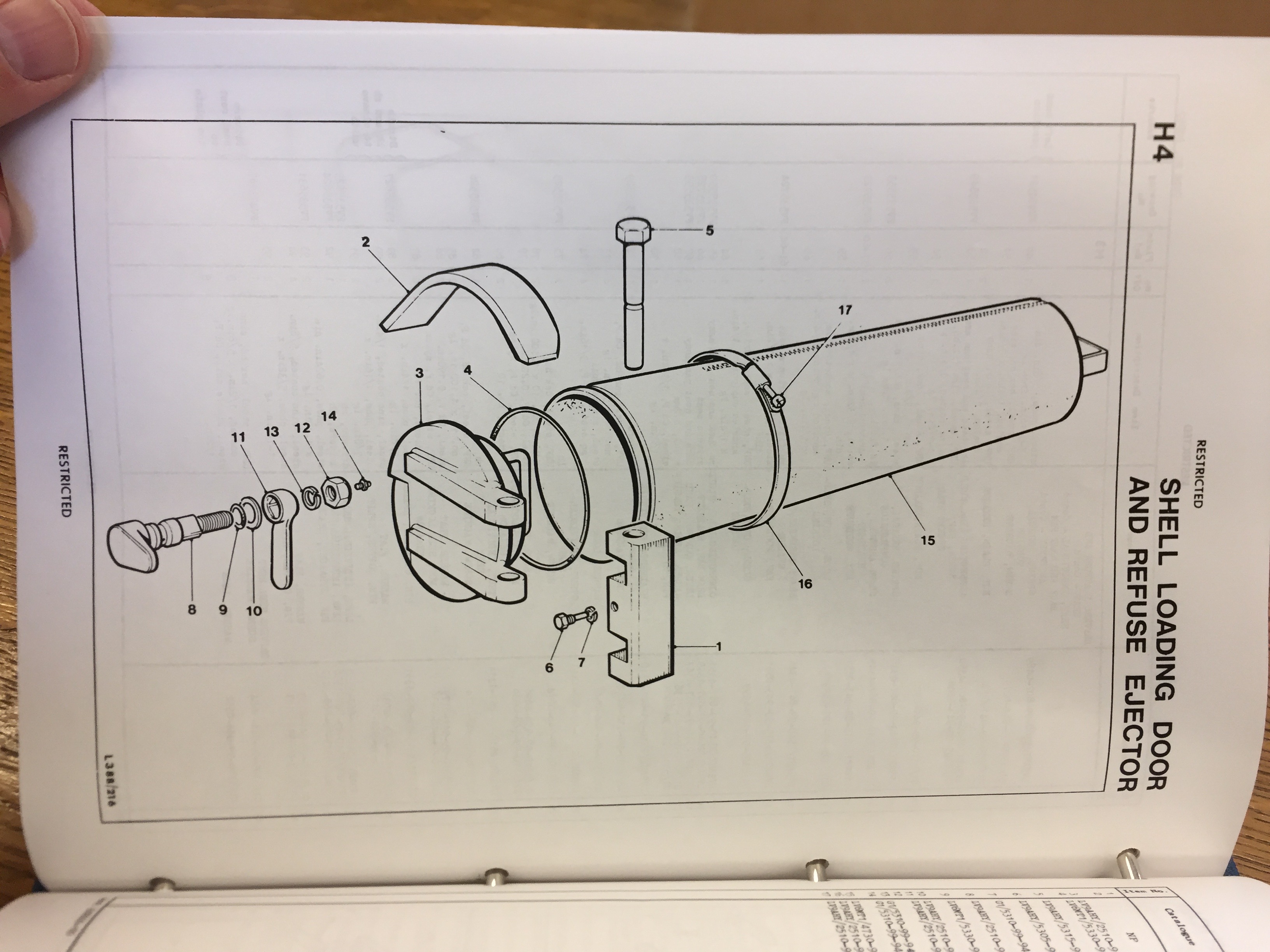

Re: Waste Disposal Hatch
The inner part was not a solid tube but a tube shaped bag with a zip. Normally retained against the hull wall to stop it getting caught and ripped off when traversing ( being eaten by the turret monster was a generally used term for such damage, especially when it was body parts that were caught ).
When needed, release from position, unzip, fill with waste, do zip up, undo hatch and push / squeeze the contents out.
