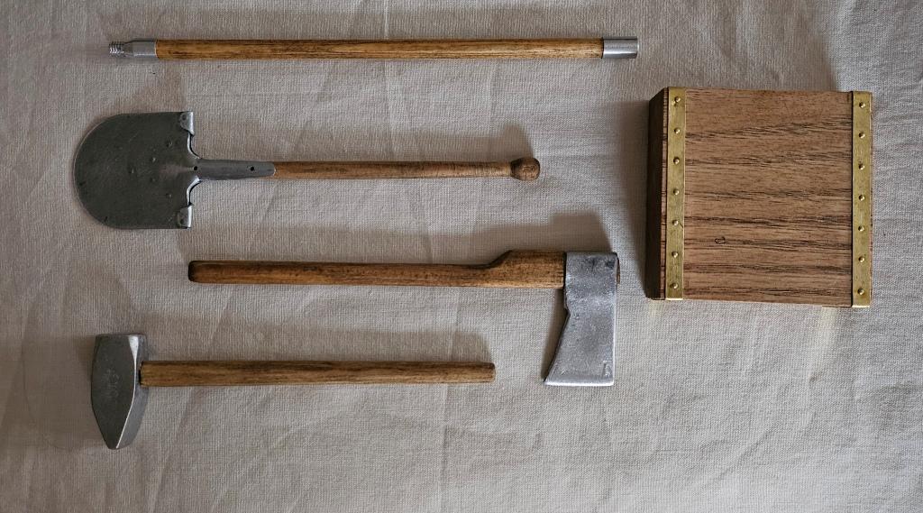

Weathering tool handles...
Just used a range of oil wash colours and allowed them to soak into the wood. Will finish them off with some satin varnish later.

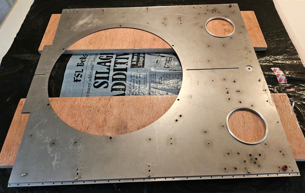

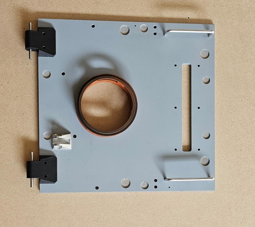

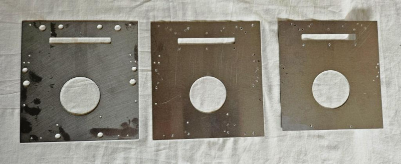

Revised Top Deck
My plan had always been to replace the aluminium top deck with a steel one so that it could be secured with magnets rather than countersunk screws.
Took while to design, as I needed to locate additional holes for the lamp and S-mine bases as well for the prototypical tool and cable/rod clamps. Notice that the plate is laminated to give slots for the weld detail and allow smaller holes to be cut with a laser.

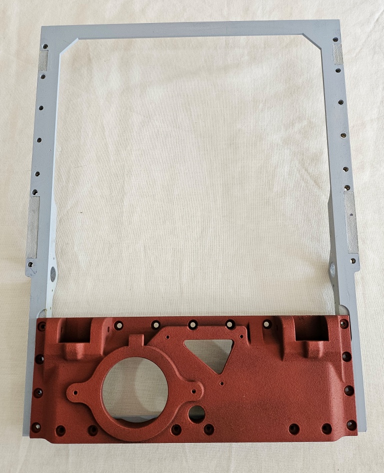

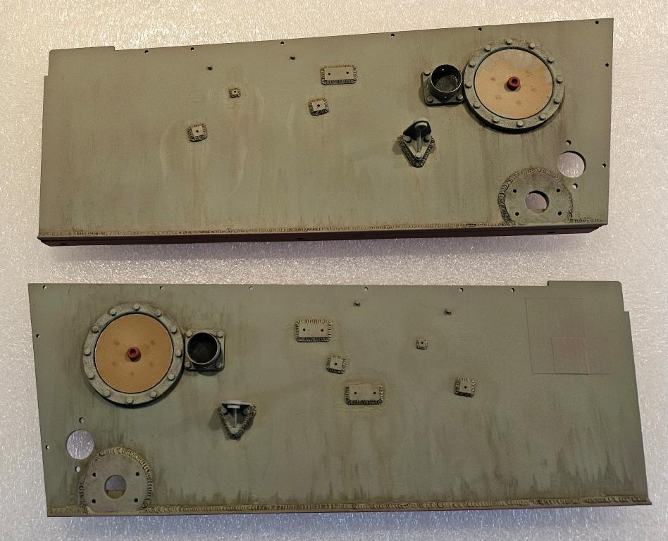

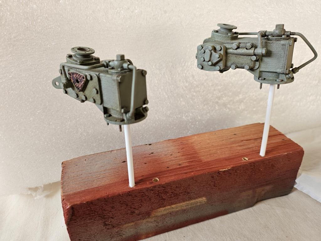

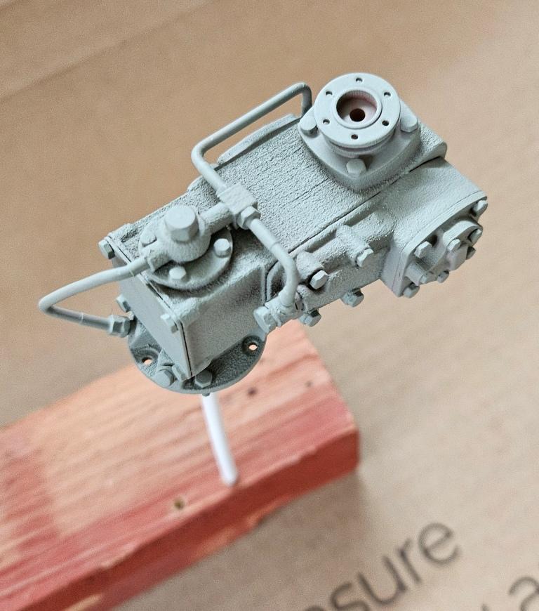

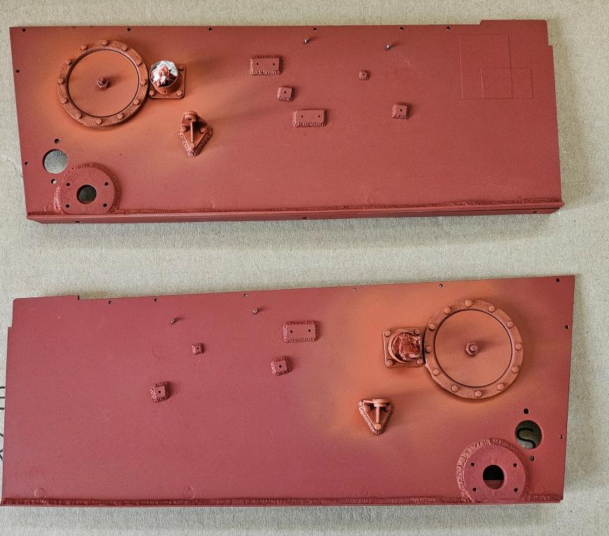

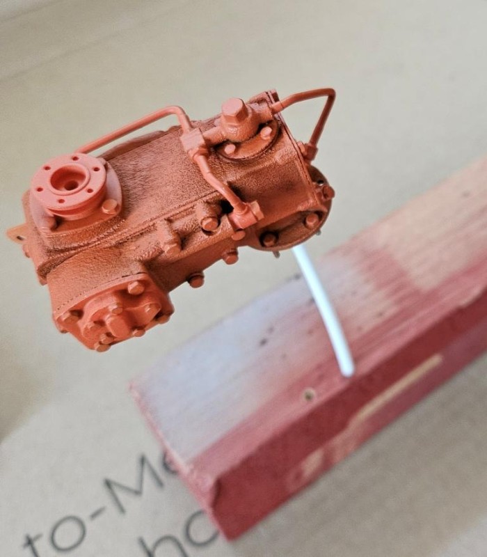

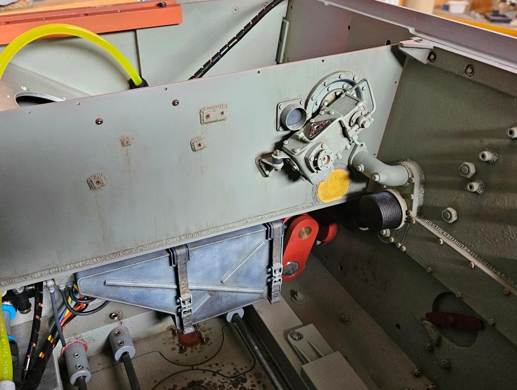

Engine Bay Side Plates and Fan Drive Gearboxes
Primed ready for base coat of Hellgrau - RAL7009 (Light Grey [AKInteractive Real Color RC054])...
Base coat applied, ready for some weathering...
Oil filler pipes will be fitted when gearboxes are mounted to the side plates.

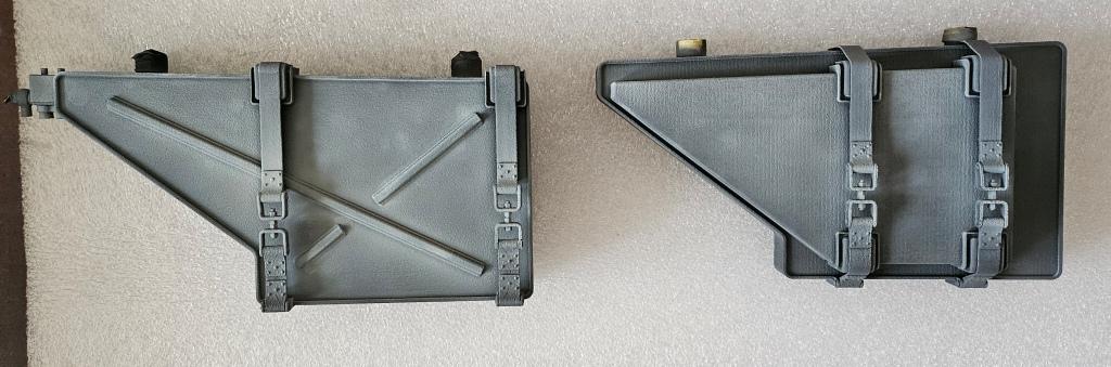

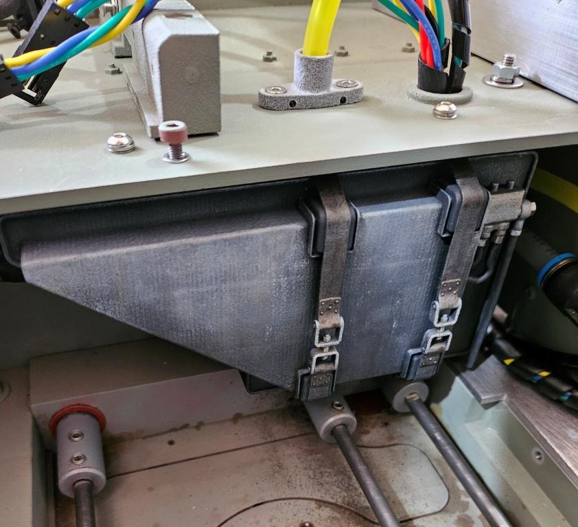

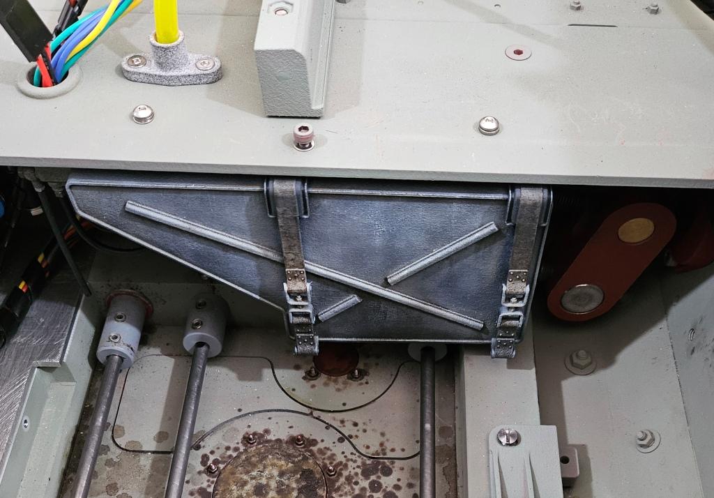

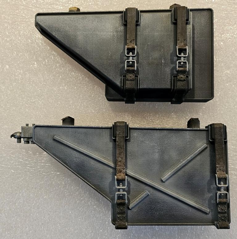

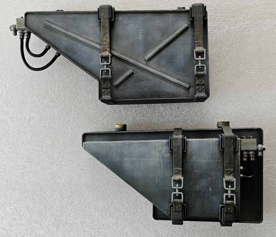

Lower Fuel Tanks
Decided to ‘go to town’ on these. Even though they will only be visible with the engine removed it is good practice for when I get around to painting the engine itself. Painting began with shades of grey applied over a black primer. I tried a technique suggested by ‘Boomer’, from the You Tube Channel ‘River Railroad’, which is heavily thinned Tamiya paint airbrushed at high pressure: I have tried to enhance the volume by graduating the shades: lighter near the top and front, darker at the bottom and rear. Next, some oil ‘dry brushing’, again darker at the bottom and lighter at the top. Note that the scrubbing action has worn off some of the paint allowing the primer to show through for a rather pleasing effect... Citadel wash (‘Devlan Mud’) added as a glaze to make the straps stand out. The valve body and strap joiners were dry brushed with Citadel Dry Colour (‘Necron Compound’) for the same reason. I will now add the plumbing before applying a matt varnish and some washes... In situ with mock balance pipe fitted...
These were weathered using enamel and oil washes... They now need a coat of matt varnish before some chipping and the addition of the fan drive gearboxes.
I gave the gearboxes an oil wash... The darker wash has accentuated the details and the brown wash looks like oil stains.

Lower Fuel Tanks

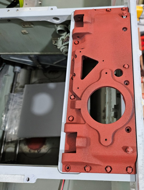

Right hand engine bay side plate is now complete and ready for installation. I shall fit the oil filler pipe later when I have checked the length to make sure it does not foul the engine cover plate... Plate installed...

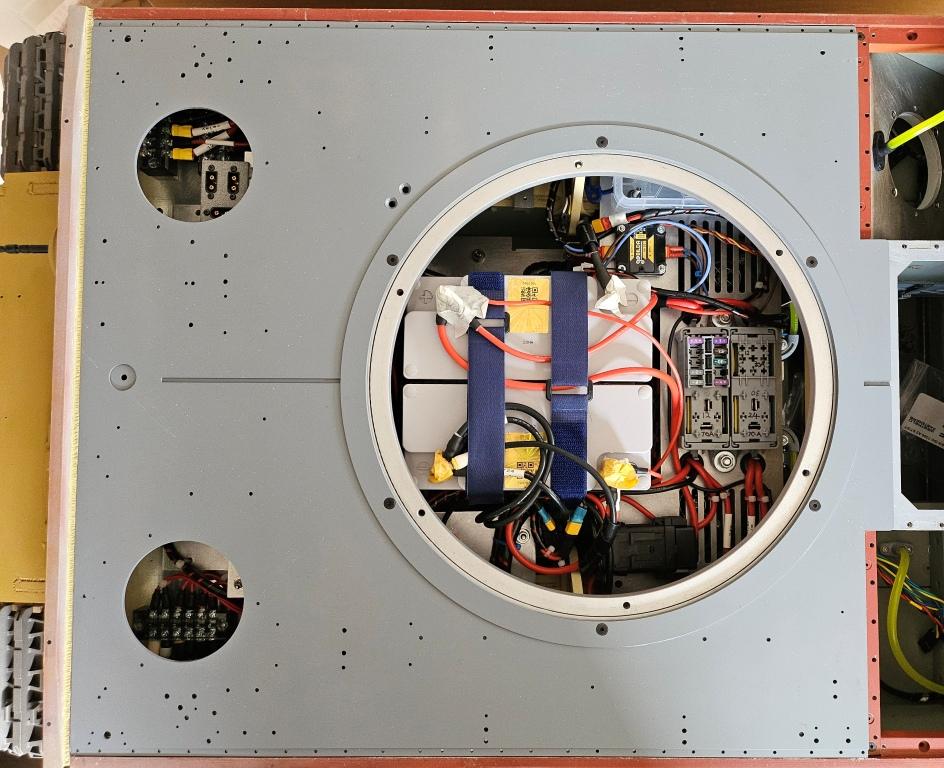

Test fit of revised steel top deck... The steel sheets have a slight bow that will need to be removed before they can be bonded to together. Note that I have added a ring on top. I have included this as I thought it would be easier to countersink on my mill. The ring will be hidden by the turret.

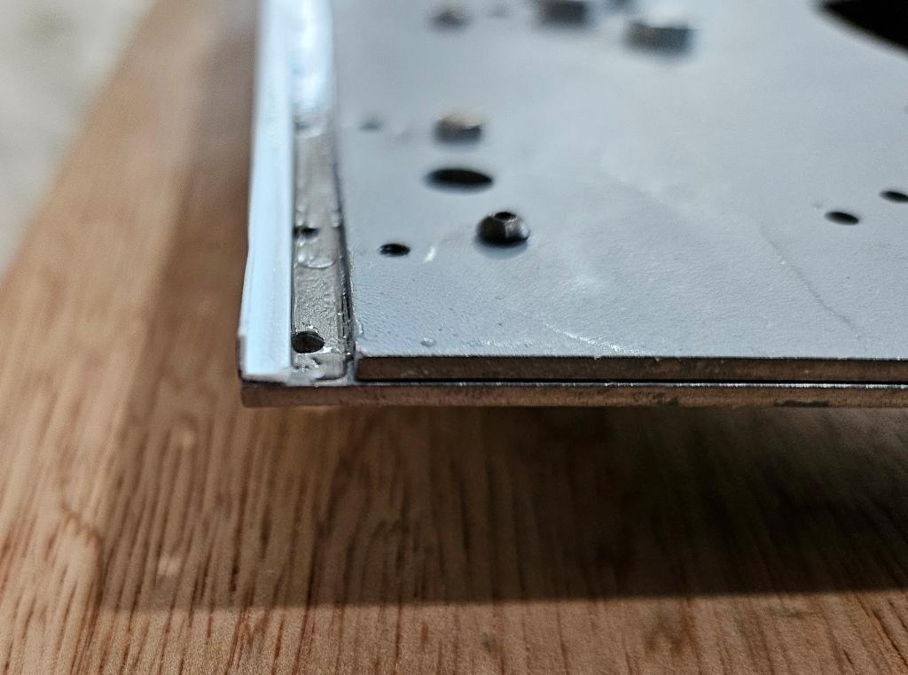

Re: Tiger Ausf E “F01” Gruppe Fehrmann

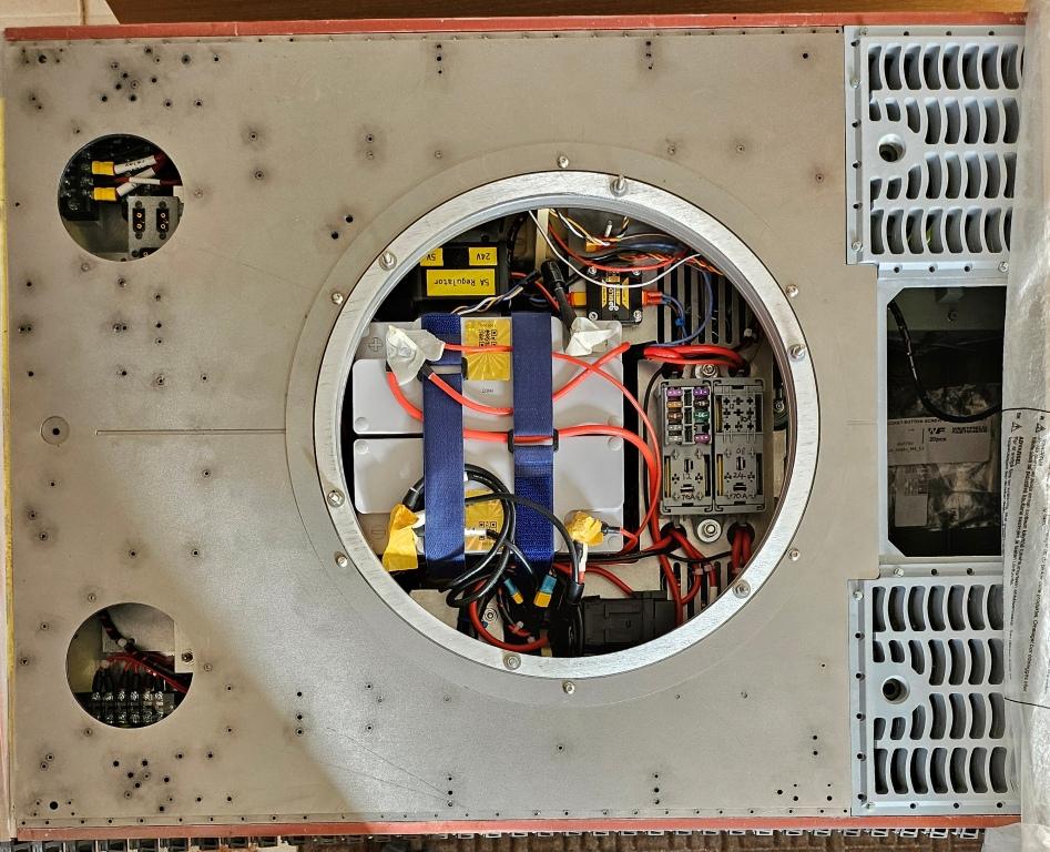

Hi All,
Update 5 Mar 24

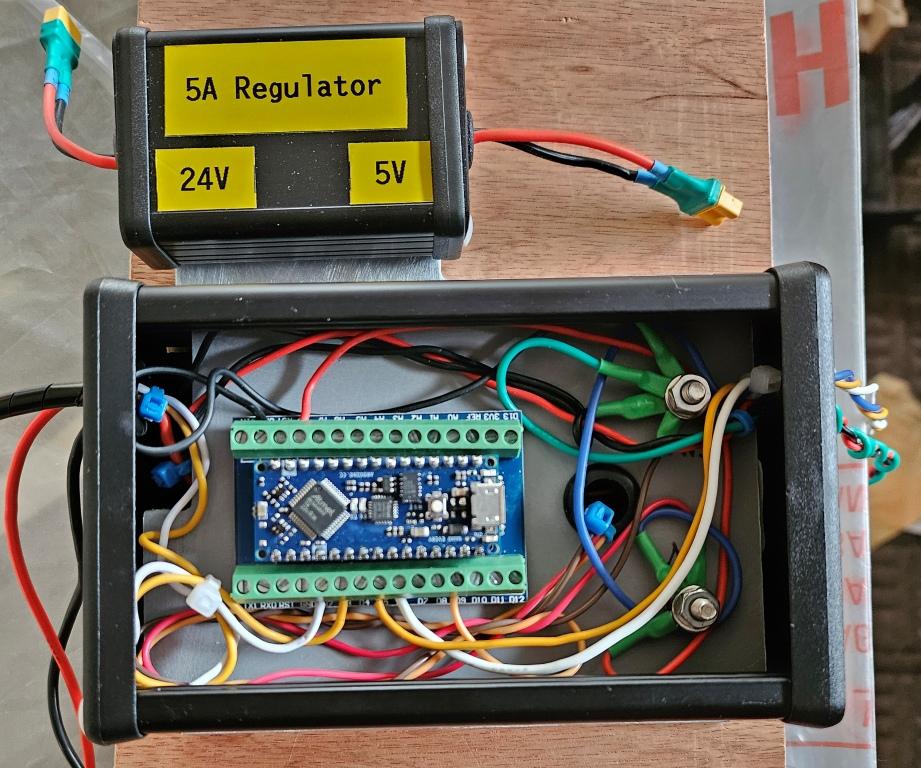

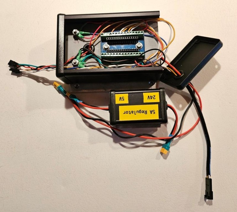

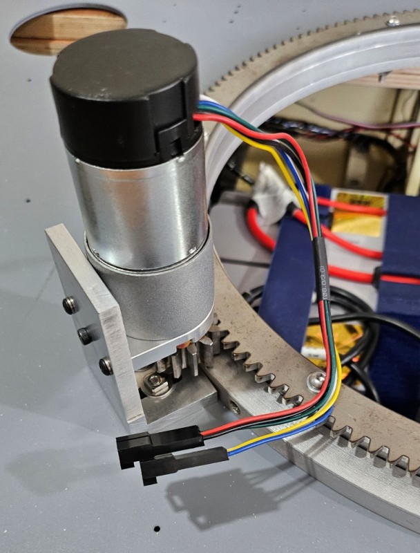

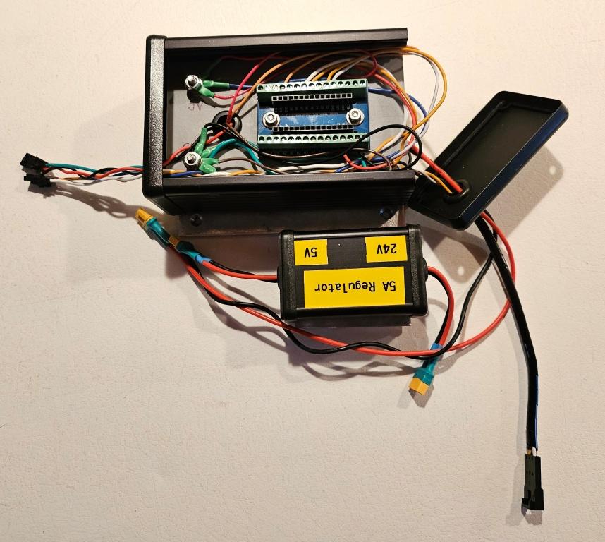

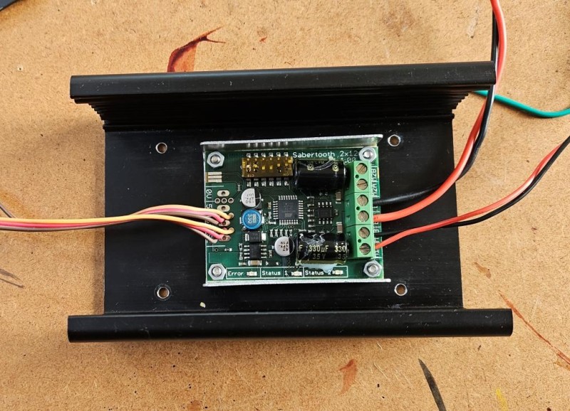

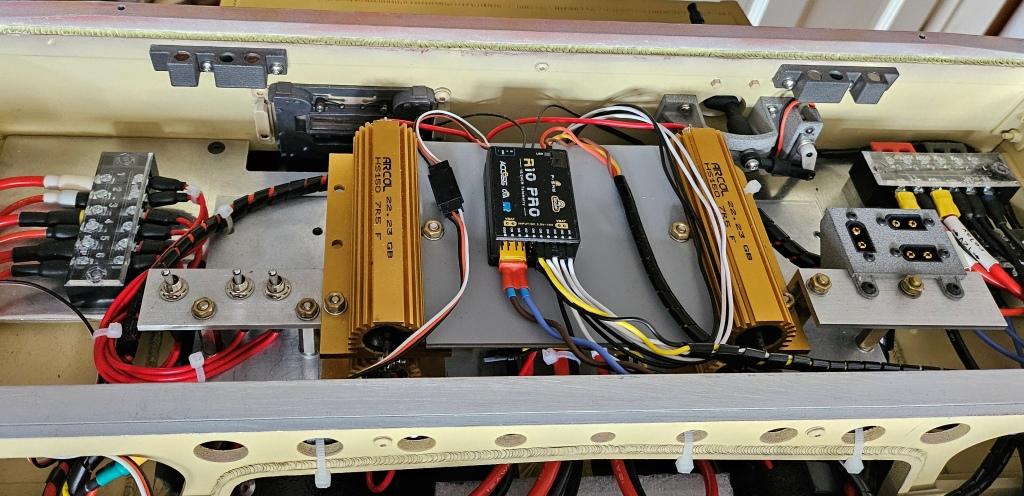

Had some issues with the ‘homebrew’ turret controller. Not sure what, but ended up frying the microcomputer and permanently disabling the motor controller. I have decided to re-build it using the Sabertooth 2x12 R/C cannibalised from the (Red Box) Motor Control B (module) along with an Arduino Nano Every. The 2x12 has an onboard 5V (1A) BEC that should be able to power the microcomputer and the encoder so eliminating the need for a dedicated voltage regulator. In addition the Nano Every has the capability to use hardware interrupts on all digital pins which should simplify the coding. Had some interference between the motor power cables and the RC signal cable feeding the Sabertooth. (The interference caused sporadic and unreliable motor motion. This happened in the previous set up as well. So part of the original problem was probably a result of poor cable routing). I rerouted the cables and now have steady motion. Rotation motor installed...

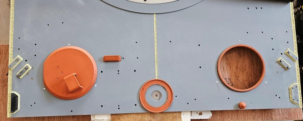

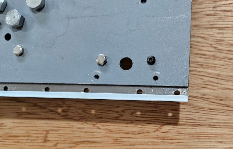

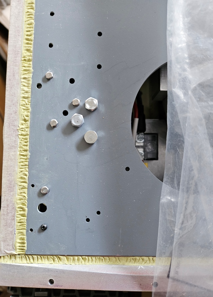

Top deck
The two 1.5mm steel sheets bonded together after some judicious bending and hammering to minimise the bow: Note use of front hatch rings, M3 bolts, and M5 bolts to help alignment.
A bit of pressure applied while the 3M bonding tape adhesive cures. Can take up to 72 hrs! Deck with ring epoxied in place and sprayed with Isopon Zinc 182 Rust Inhibiting primer. Things have got a little tight and I had to skim 2mm off the rearmost edge of the turret bearing to ease the fit. Note that the front weld has been completed and how the two sheets work together to produce a trough for the side welds. The regularly spaced holes in the lower sheet should help the weld to grip. I have not decided whether to use Milliput or go for a 3D printed part. The printed part may be more robust but will not match the other weld detail.

Update 5 Mar 24
Top deck

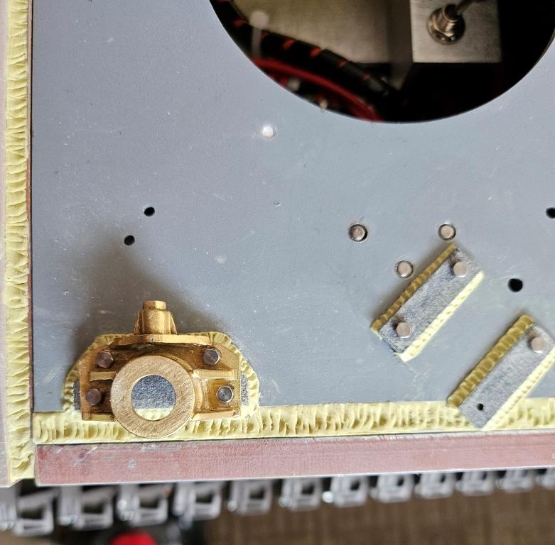

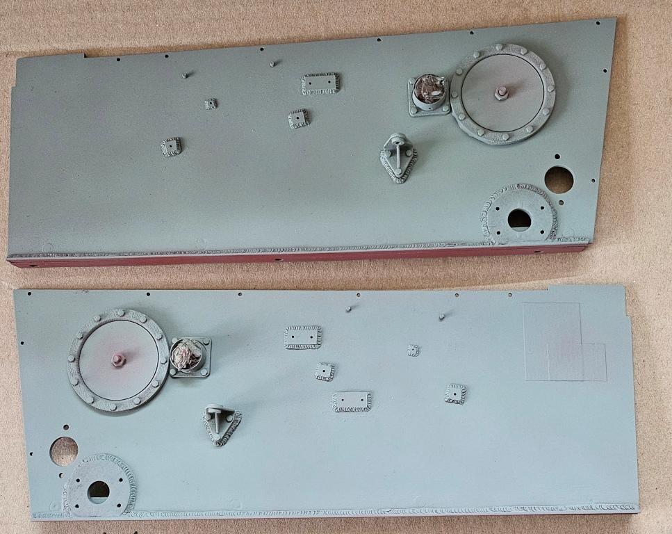

Hi All,
Update 24 Mar 24

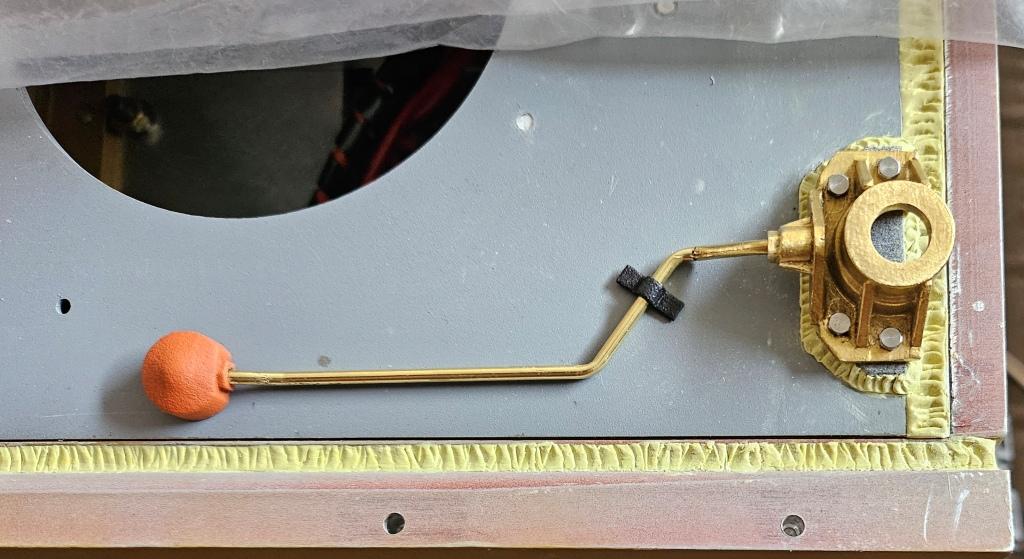

Top Deck Details - Part 1

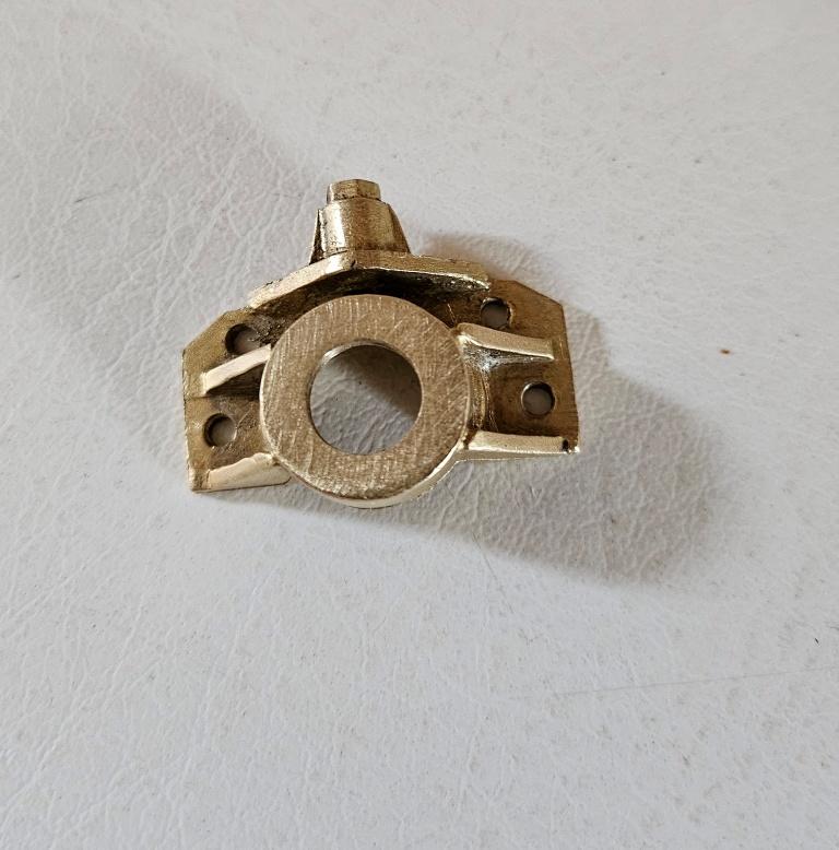

Lamp Housing

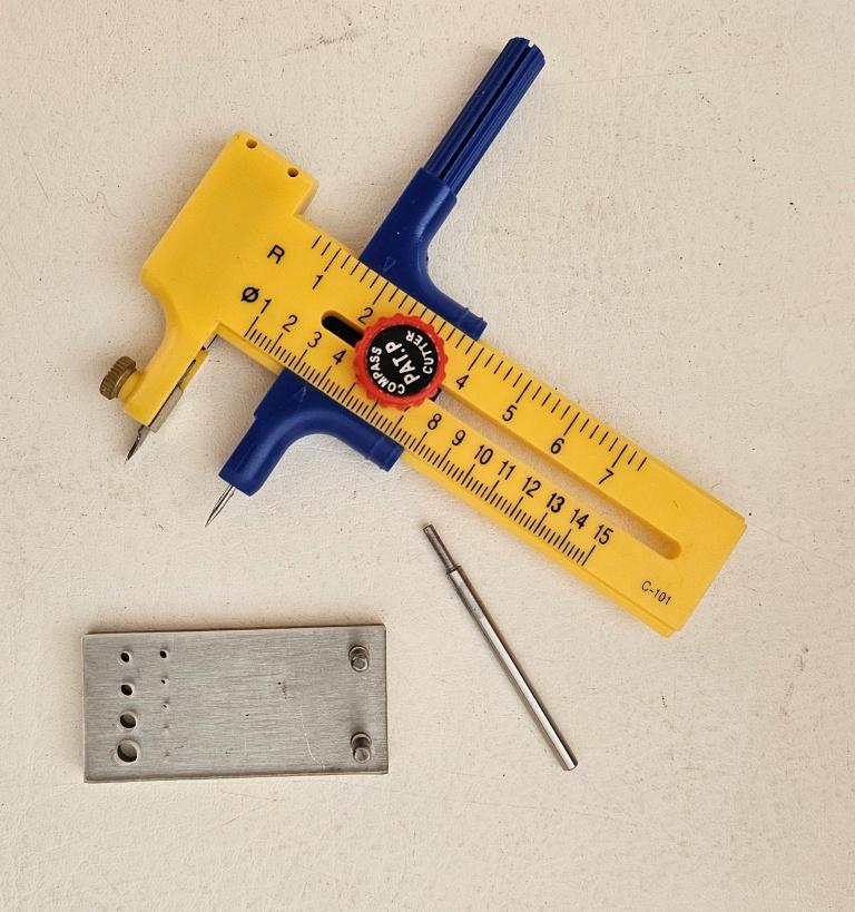

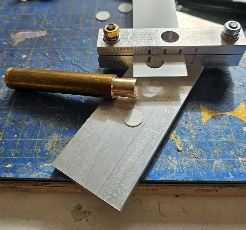

As F01 had only one lamp housing fitted, another baseplate was required. This was sourced from Steve Winstone and milled out to accept the contact plate.

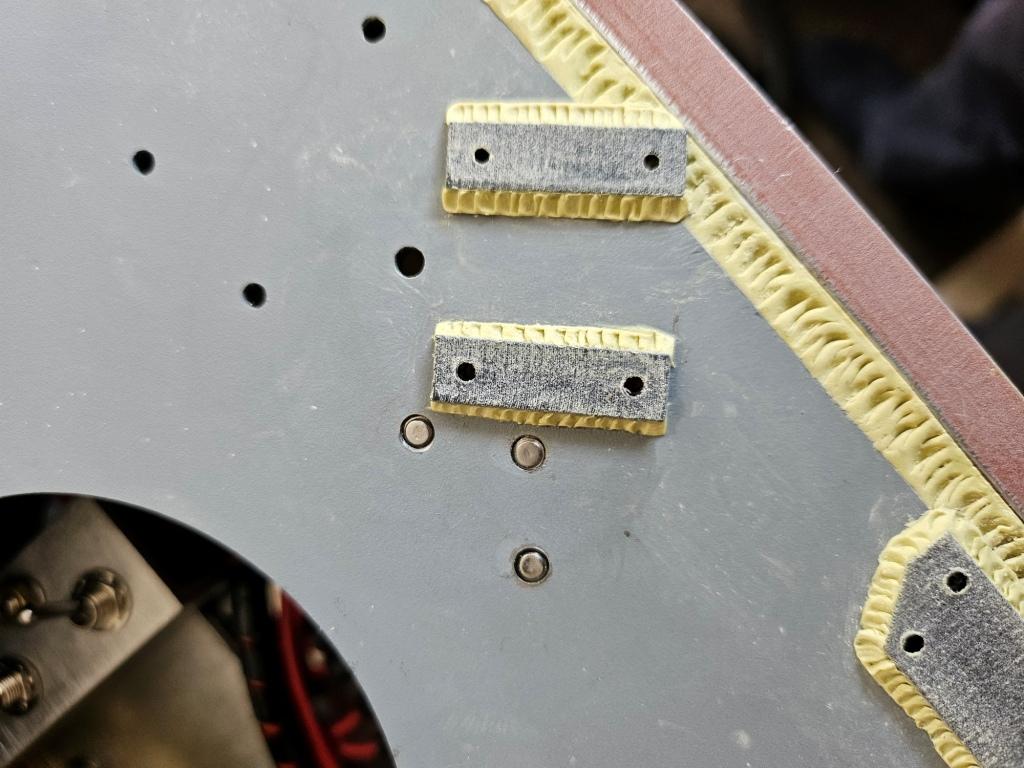

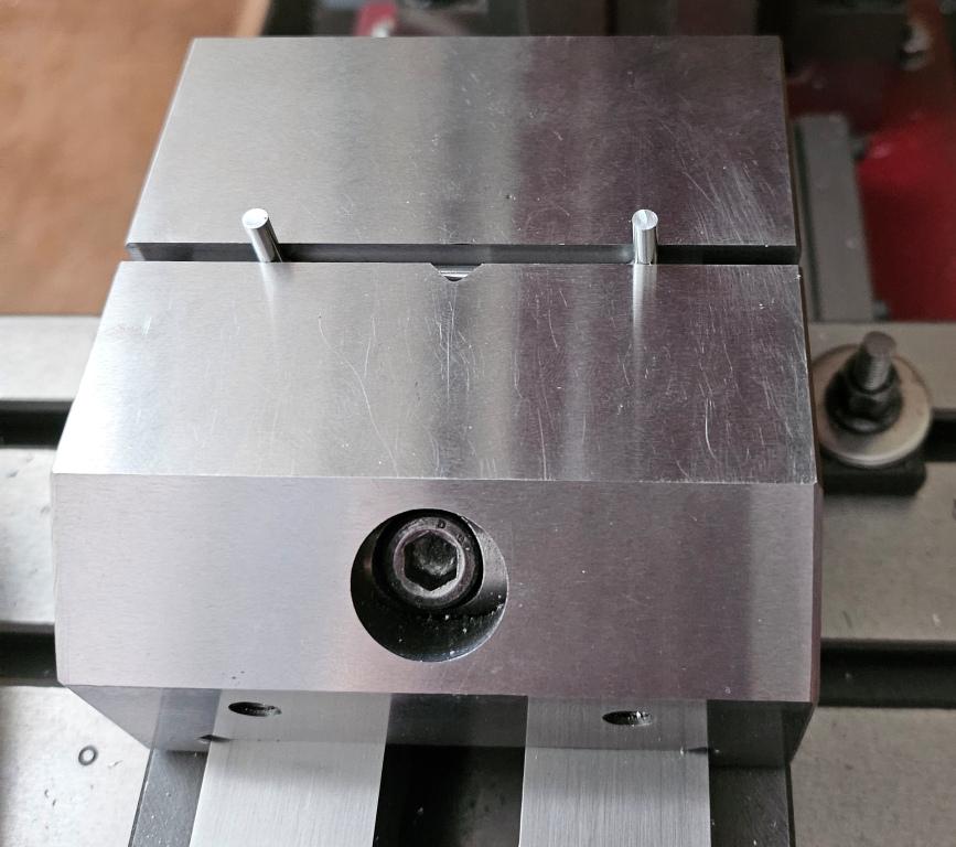

Top plate tapped to accept M2 hex bolts for the lamp bases and S-mine mounting plates. The holes for the hatch hinges will be tapped for M4. I plan to attach the hinge mounting with flat bottomed grub screws and epoxy adhesive to so that I can represent the cone bolts that were used on the full size vehicle.

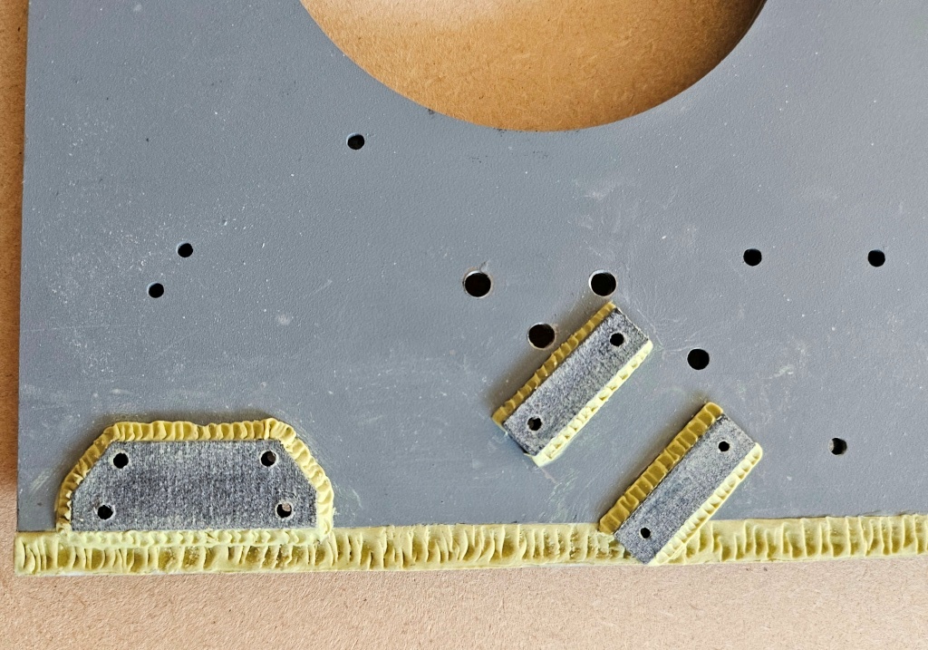

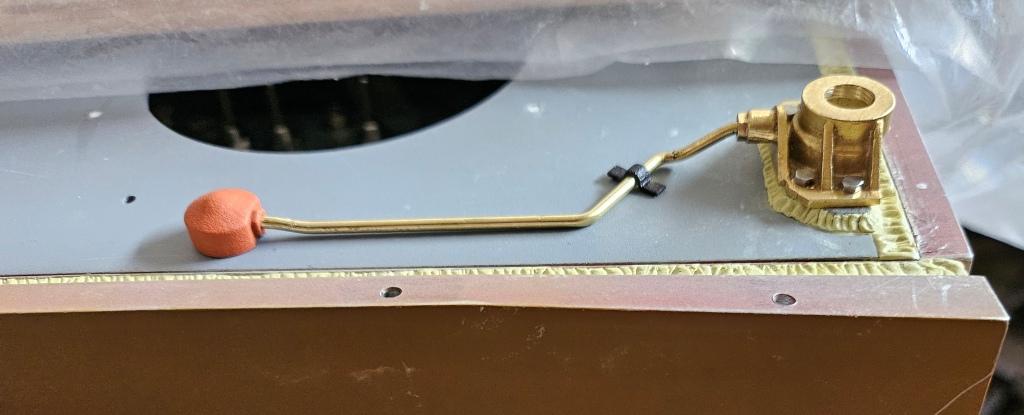

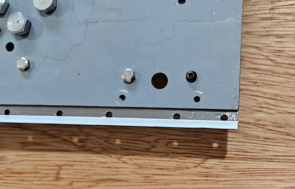

Weld Details
Filled slots with Milliput to represent the weld that joins the two halves of the top deck plate... Side weld detail was also added with Milliput into a slot created using an Evergreen Styrene angle... Masking tape was used to prevent Milliput from sticking to the hull side plates and support rails... Finished look, just need to do the other side. That's all for now.
Update 24 Mar 24
Lamp Housing
Weld Details

Thanks for the complement. Time will tell if this is a durable solution to modelling the side welds. Next task is to install all the fittings on the hull roof. When I need a change of pace I will fit the Beier USM-RC2.

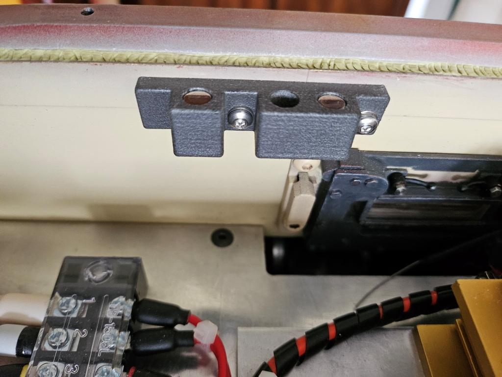

Hi All,
Update 14 Apr 24

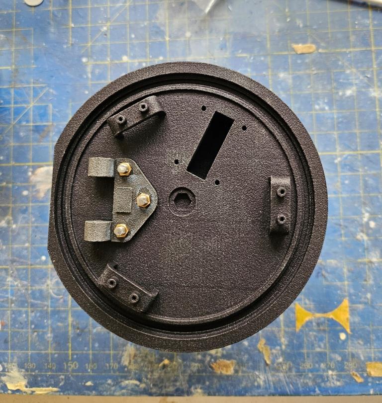

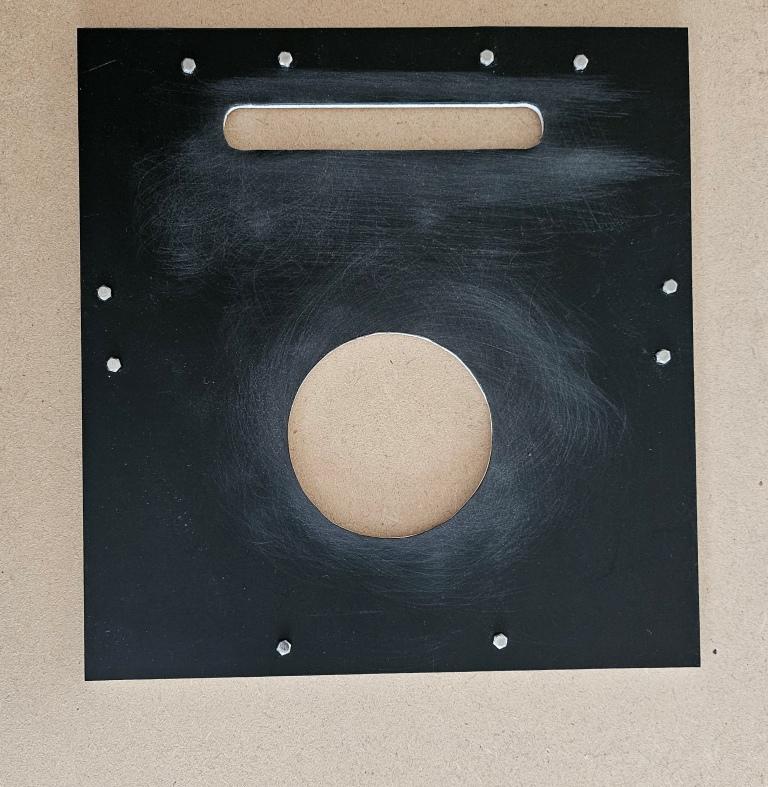

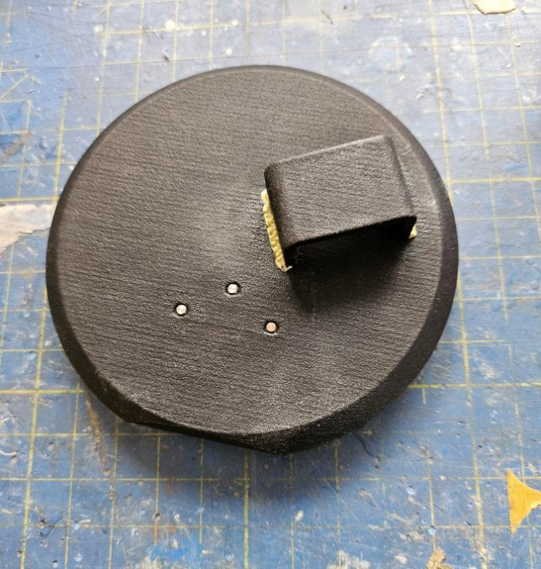

S-mine and lamp base plates epoxied in place with some weld detail added... Magnets added to front supports... Will probably add a third magnet

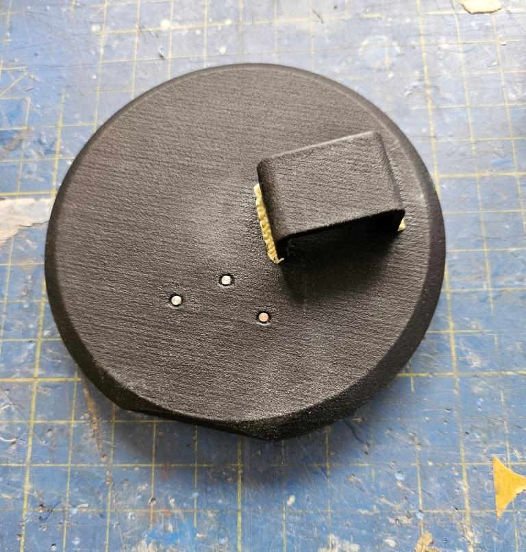

Front hatch lower hinges fitted... Engine cover

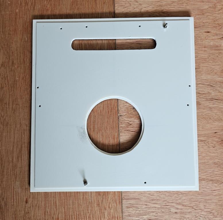

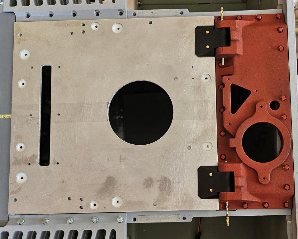

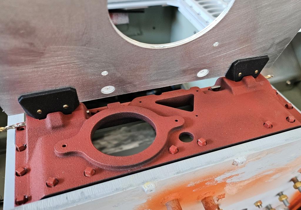

I decided that my replacement engine cover which was cut from a 3mm thick sheet of aluminium could be improved by adding a 1mm sheet on the underside to help mimic the milled edges of the original. This idea led to a complete overhaul of the design to incorporate the locks and a repositioned and resized front slot that better matches the prototype. The interior lock details have been replicated, as my F01 will have a fully detailed engine compartment.
Plasticard mock-up to see if the added thickness looks out of place (1mm + 2mm + 1mm)... I decided that the front slot should be narrower. Note the larger diameter hole in the lower sheet; designed to provide a slot for a mock weld.

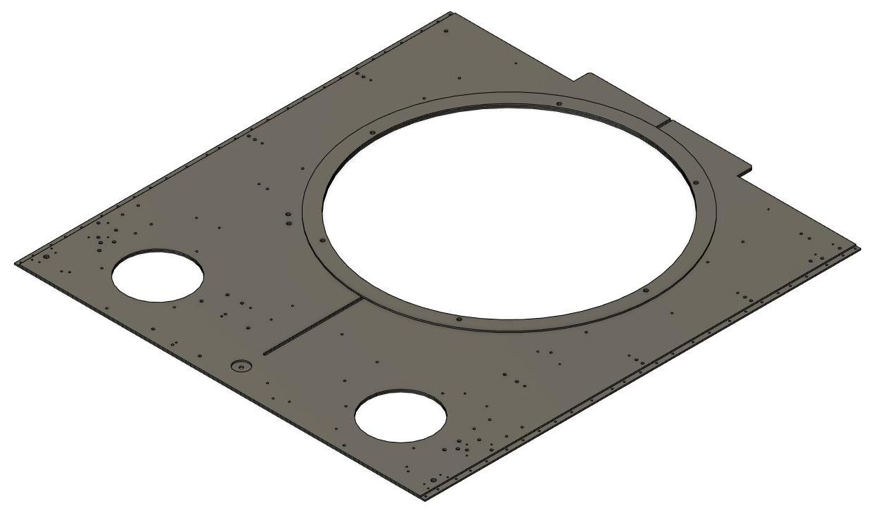

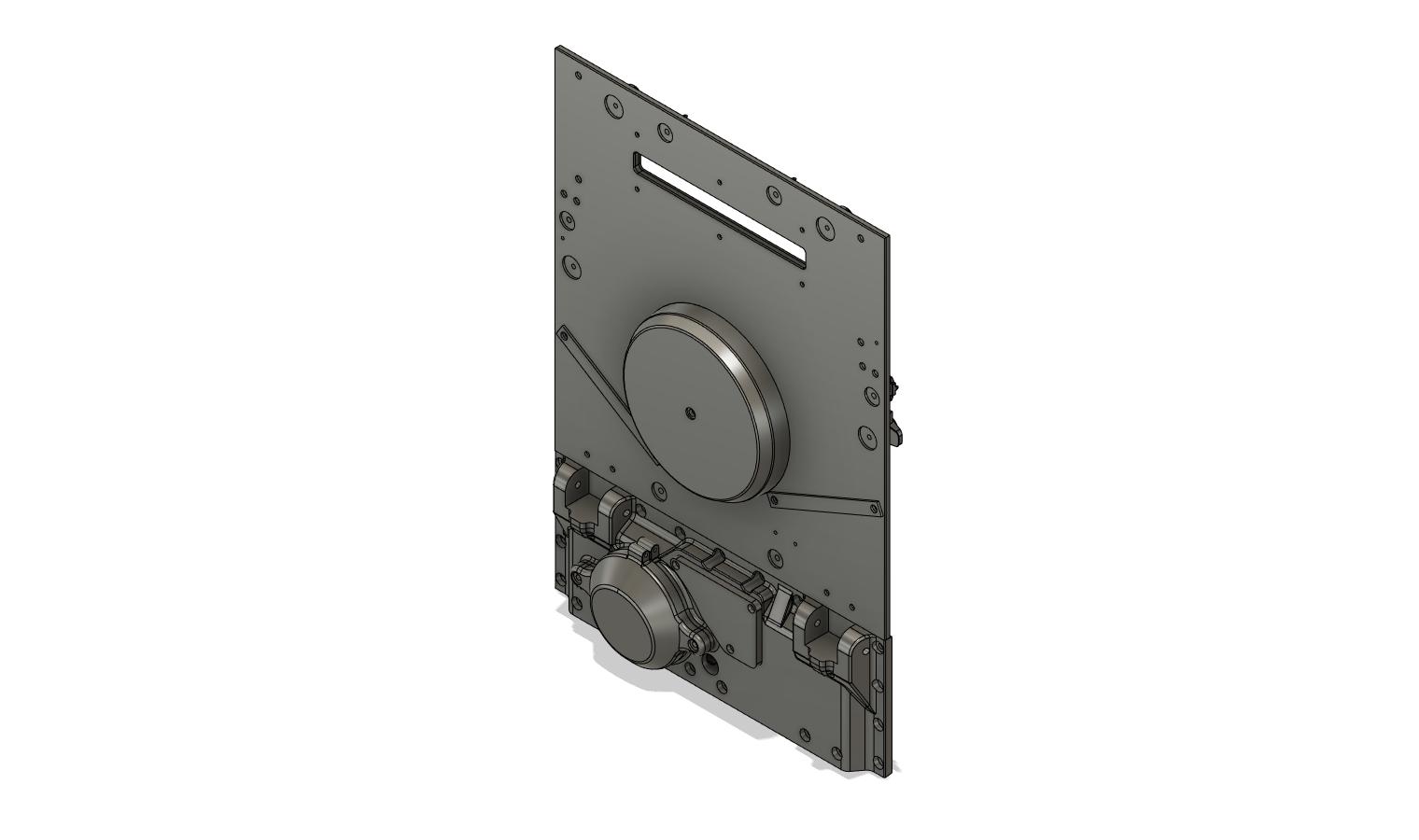

CAD images, created in preparation for some laser cutting and 3D printing... Note that the internal valve mechanism will not be included as it would probably have been removed when the snorkelling capability was dropped.

Update 14 Apr 24

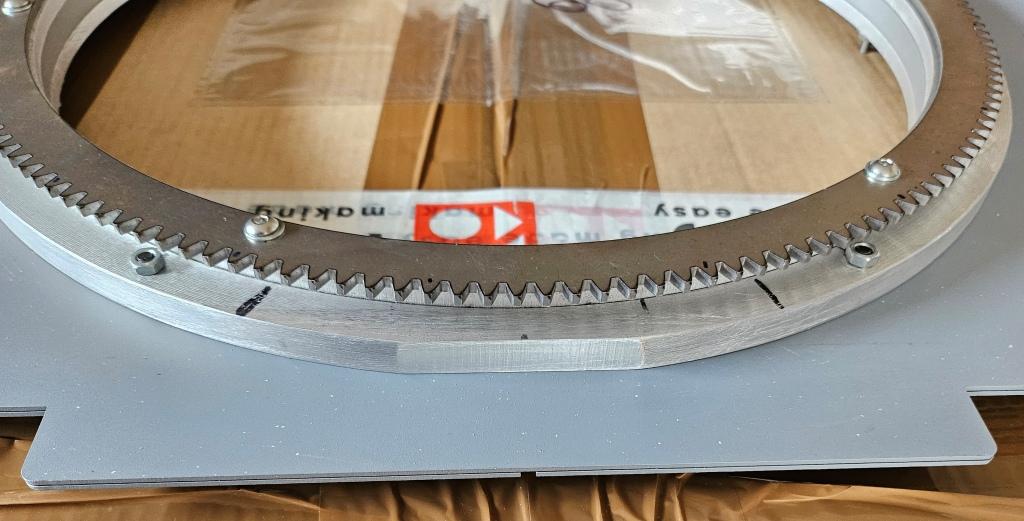

Hi All,
Quick Update 18 Apr 24
(Progress on several fronts)

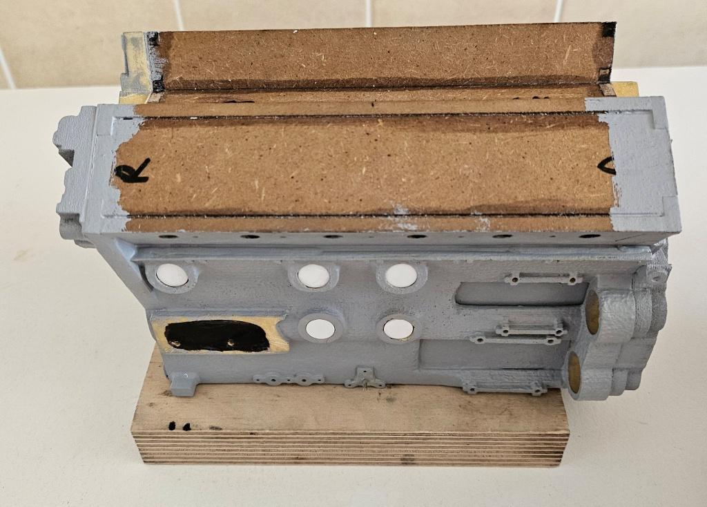

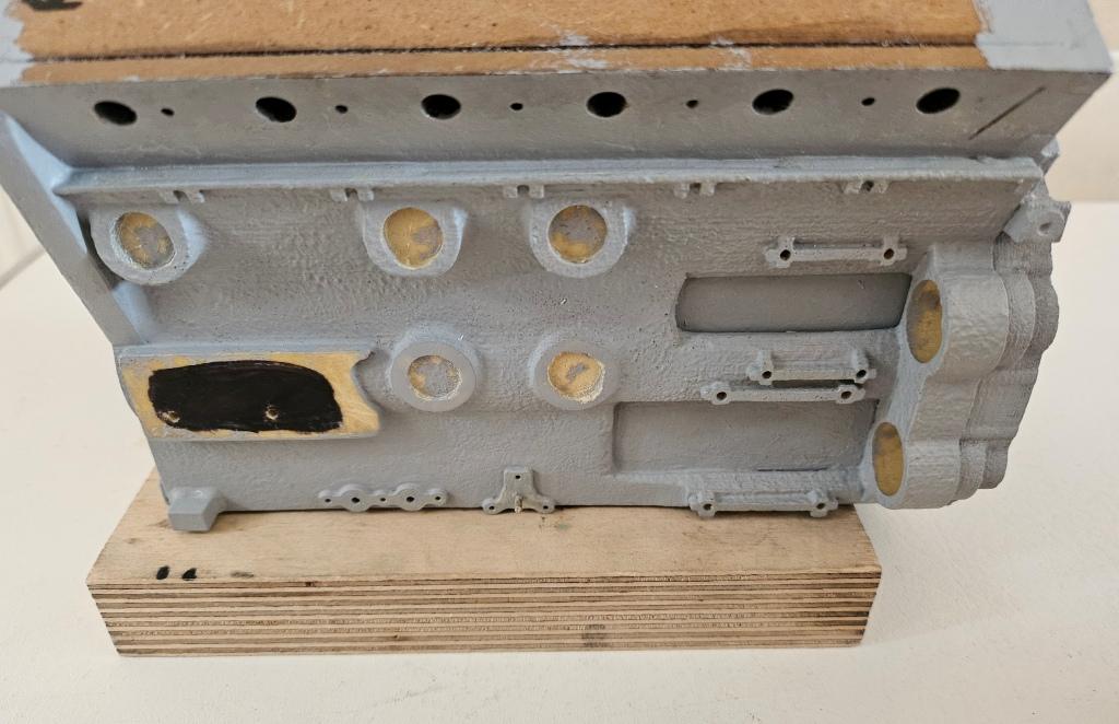

Engine
A change of scene...having put Ivan’s HL230 kit aside for more than a couple of years(!) and with the engine bay nearly complete I was ready to continue that build. Following advice from a fellow model club member, my first task was to enhance the core plug detail on the engine block. This required Plasticard discs of 10mm diameter, which are too small for a rotary cutter but too large for the standard micro punch and die sets. Therefore, I made my own punch and die using some scrap aluminium bar stock and brass rod... Surprisingly this cut neat discs in 20 thou Plasticard. (I am not sure how quickly the aluminium die will wear but I need only about 20 discs.) Modified engine block - before (with the circular indentations trimmed by hand using 10mm end mill) After, with plug detail added. Bottom right one needs a little filler...

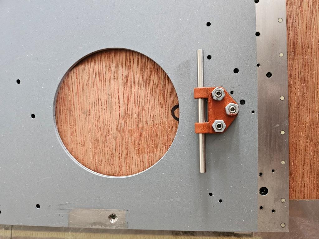

Front Hatches

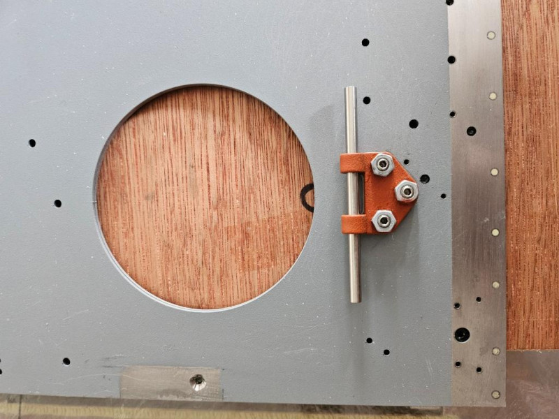

Started to detail the front hatches by adding the hinge bolt detail... These images highlight the need to add some Mr Surfacer to hide the print lines.
Functional Locking Bolts

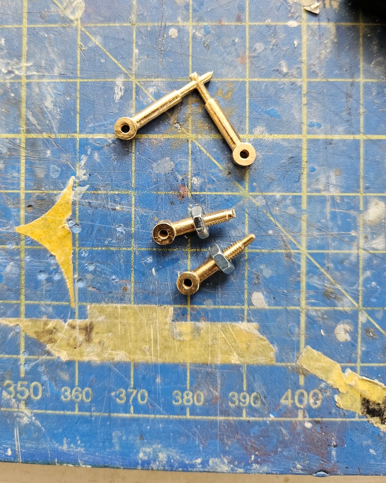

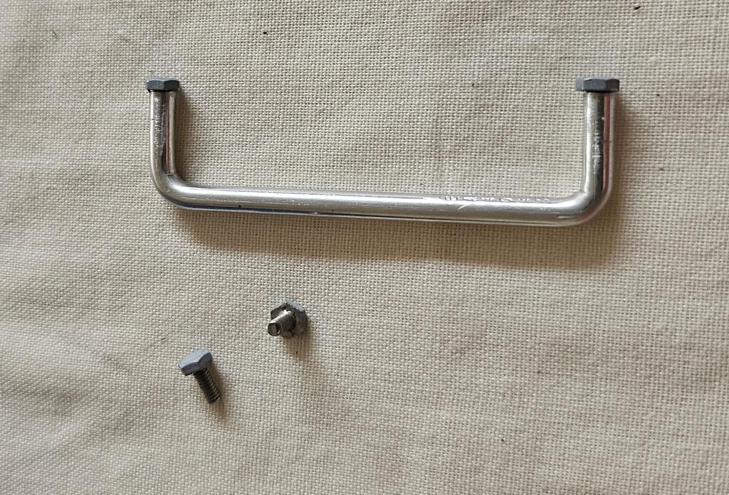

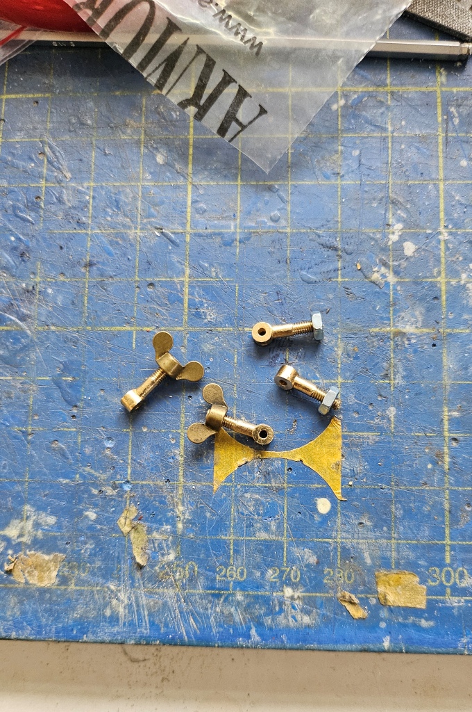

The tow cable, track cable and gun cleaning rod holders all feature locking bolts that have wing nuts. I wanted these to be functional which necessitated the creation of eyelet bolts. These have been made by threading 3D printed brass parts...
Engine

Front Hatches

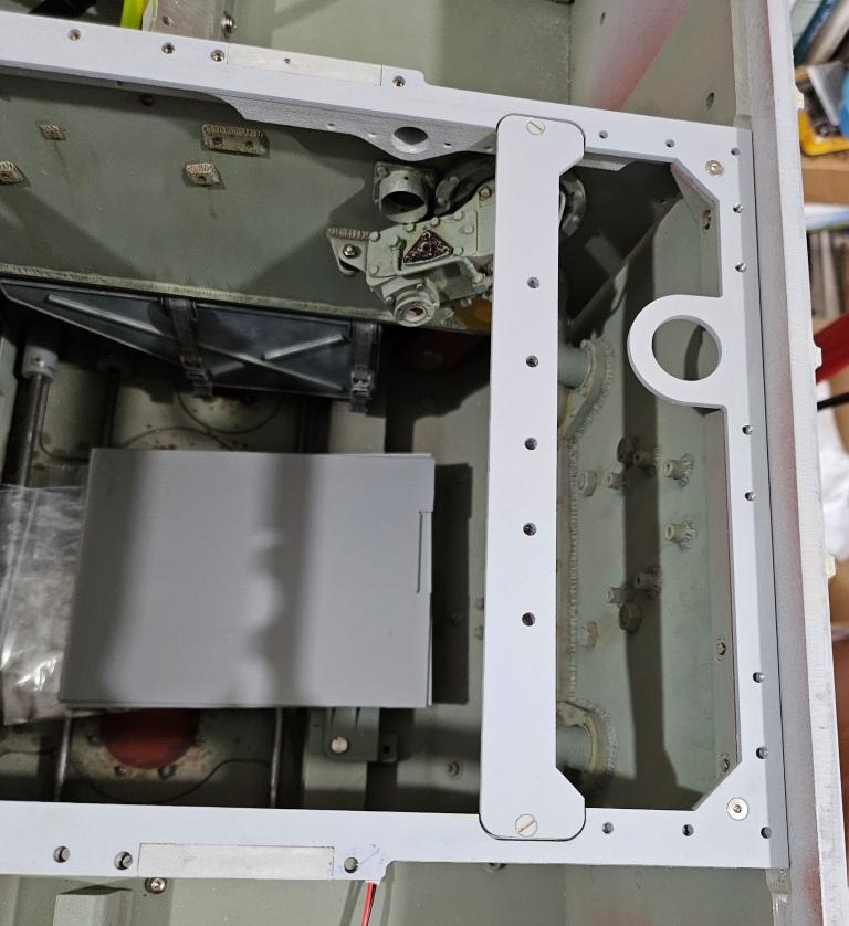

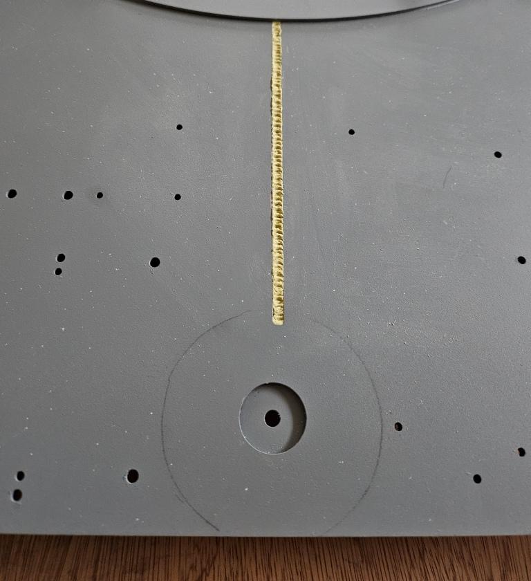

Update 11 May 24

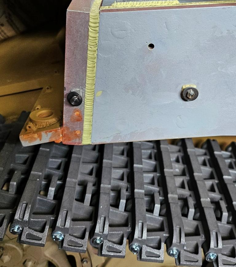

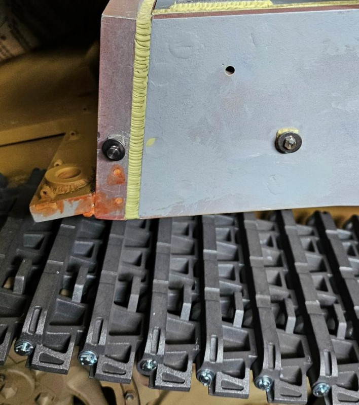

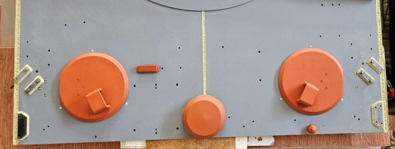

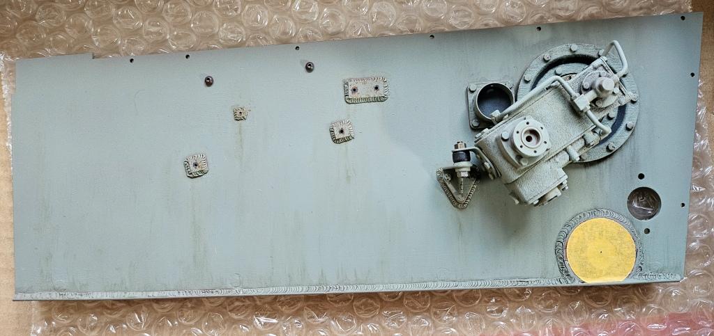

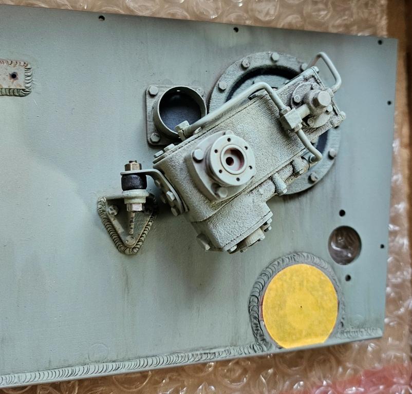

Front sponson weld completed... Note that I have filled the groove that I milled into the side plate right at the beginning of the build. Looks like more work is needed to hide the fasteners used to secure the sponson plates and roof support.

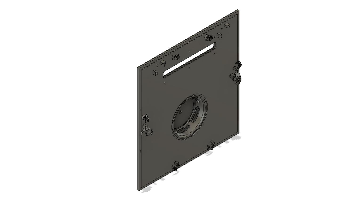

Rear engine bay cover... I had to design a replacement part as I have moved the radiator grills further apart to get a more scale appearance at the hull sides. I have no idea about the size and shape of the aperture cut into this later pattern cover. It does not matter as the cover plate will be fixed in position.
Trial fit of engine cover support frame with countersunk fasteners... Trail fit of rear cover to assess required length of squared head bolts...

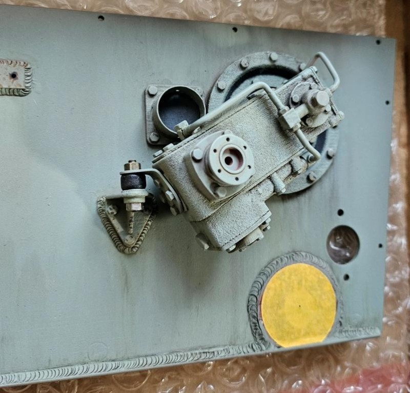

Continuing to detail the hull roof exterior... Hatch rings, vent base, lamp conduit boss and axe holder secured in place... That's all for now...
Update 11 May 24
