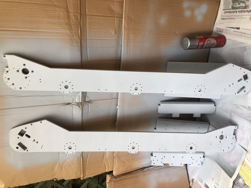

So finally I’m starting the build on Elefant hull #26. Taking advantage of the current nice weather to get some etch primer on the sucker. But hells bells this is one BIG vehicle!
I’ll keep posting and requesting advice as the build progresses, this is new territory for me so any help and guidance will be much appreciated.
