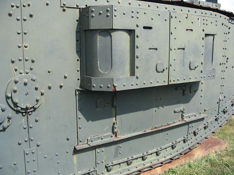

Re: Sponson observation.
Aha, you have fallen into my cunning trap
On the Armortek kit, the sponson mounting plates are the same size and are interchangeable.
On the real thing, the Male sponson fits in a similar way and has a visible line of alternate rivets and bolts running down from top to bottom.
However, the armour plate with the hatches on the Female sponson overlaps the bottom half of those rivets / bolts.
There is a video of the Australians removing the sponsons from their tank and it's bolted all the way down this plate, meaning the sponson is fully removable, but on other females, such as "Blarney Castle" and "Deborah", this line is fully riveted, which seems to imply the gender was fixed at the factory.
Ahh, of course - I merely (belatedly) spot these things, whereas you actually do something about them .....
The gender was certainly 'fixed' at the factory - indeed, it was established by Contract. Coventry Ordnance, for instance, was contracted to build 100 Females, numbered 4551 to 4650, and that was their only order. Likewise, Armstrong Whitworth was only contracted to build 100 Males, numbered 4001 to 4100. A number of the original Contracts still exist at the National Archives in Kew (as an ex-Accountant I find them particularly interesting, but that's just me ). I've got a complete table of Mark IV builds if anyone wants to know who built a particular tank (although I can't publish it for copyright reasons ).
I've always suspected, but not yet proven, that the male / female sponsons were easily interchangeable, as that's where the hermaphrodites / composites came from. I'm not aware of any contracts to actually build them, and the available pictures (especially L Battalion in Cologne in 1919) show pretty well an even number of tanks (Mark V's) with male sponsons on the right against those with male sponsons on the left. That suggests a workshop change, although I've still got no idea why they actually did it !
Thanks Chris.
So the odd thing is that "Grit" has bolts holding the lower portion of the female sponsons in place whereas every other picture I've found seems to show that part riveted in place. I guess at some point they must have drilled out the rivets and replaced them with bolts.
They actually say in the video that it is the first time since 1918 that the sponsons have been removed. One wonders ...
