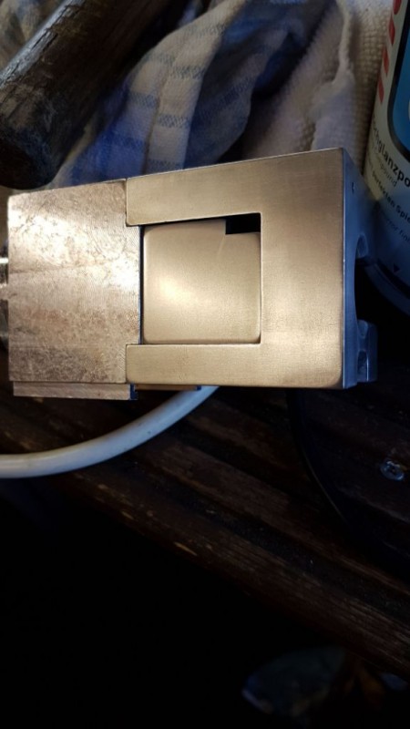

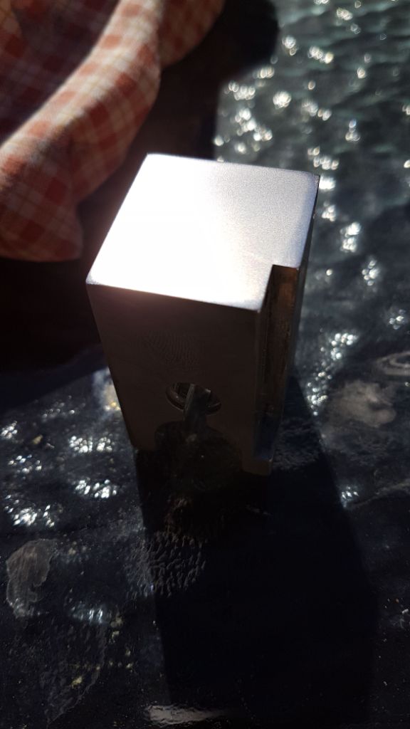

Ive bought a Pak 43 as a sort of practice build before i start my Tiger one build.I intend building the Pak 43 purely as a display so it will be finished in polished alloy and some parts Anodised.Its labour intensive because with having no paint to cover it up youve got to make a nice job.
At the moment I'me just working out the way to get the best finish,so easy bits first.I'me not sure how much ill have coloured untill i start to test fit the various parts together but it will become obvious to me.....I think.
A couple of pics to show the difference between the production finish snd the reworked finish. Not finished by a long way but an idea of how the bits will end up.

Ok Kian,Ill do my best.At the moment I'me using wetndry 240 wet on the heavy machining marks,then 600 wet,From then ill go down to 800/1000 both wet.Ill use rubbing compound then T cut on the final finish.Although I've got a bench polished but I'me in between sheds at the moment so can't mirror polish them.
Ill post up as I reach the various stages.Regarding the protection I would be tempted to go for Canuba wax then a Meguires quick detailed.But until I get to that stage I'm not too sure about that.
I'm just about to do the breech end of the barrel which I suspect will take a couple of days.Ill post a before and after Pics.

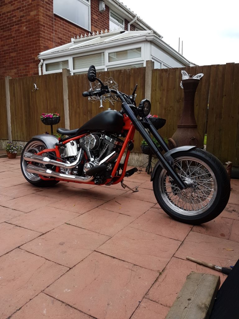

I love the way Eric Ho's Pak 43 looks so ill go along the same lines.Ime not sure how much ill have anodised and how much ill leave polished alloy.
I think the secret to keeping it looking ok is staying on top of keeping it clean.The most dificult thing i have found to keep on top of cleaning it is my chopper.Its got Superbike priced components with cheap chinese moped quality an is a pain to keep looking good.The anodised parts will pretty much look after themselves but ill see how the alloy keeps.

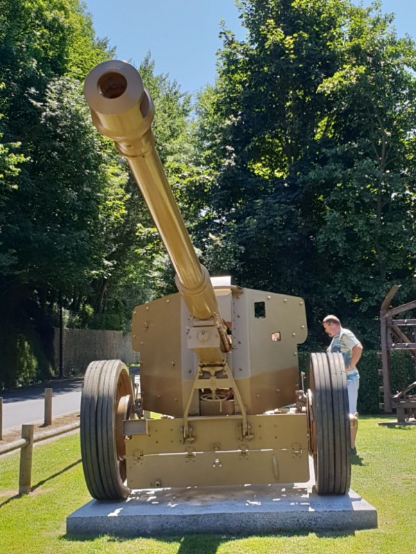

I almost forgot I came across this popgun at Omaha beach in Normandy,ill be back there in July,for some reason i may find myself having a closer look at it this time
.I will probably have a little look at the tiger they have hanging up on the floor....it would be dangerous not to

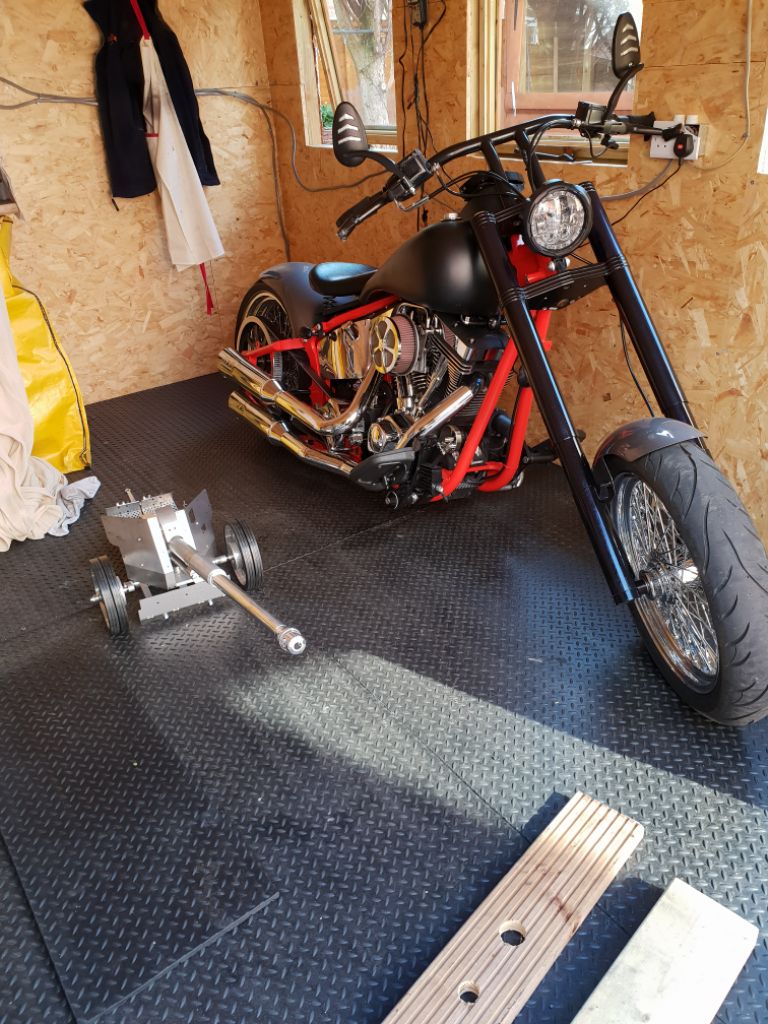

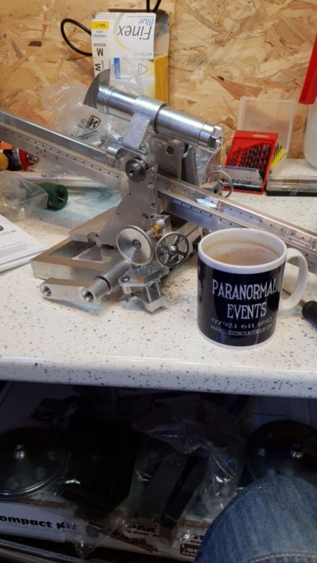

It's been a while since I last posted,ive been busy with new shed and gardening chores required to keep the wife happy.

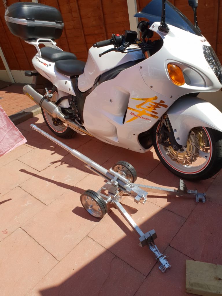

Although the plan is still to polish and anodized the gun I've decided I need to mock up the gun so I can work out what needs anodising and what will just be polished/painted.
It goes together really nice once you get in the mindset,it takes a little time to switch from tabbing stuff for a chopper to tidying up 2.5mm threads and reaming out 3mm holes.
I had to remove the barrel slid setup because it's big and makes working on the chassis quite awkward.Ive deliberately left a cup in the picture to give an idea of size. Glen.

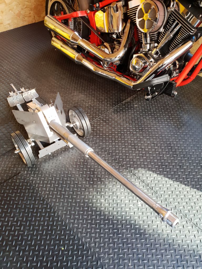

All in one bit now,then strip it for final finishing.For those that haven't seen one of these I've left the bike in the picture to give some idea of size.
Glen.

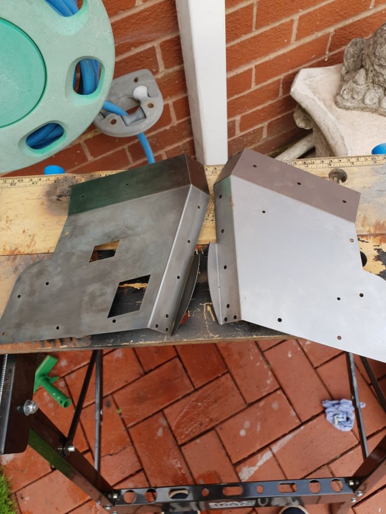

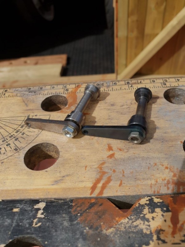

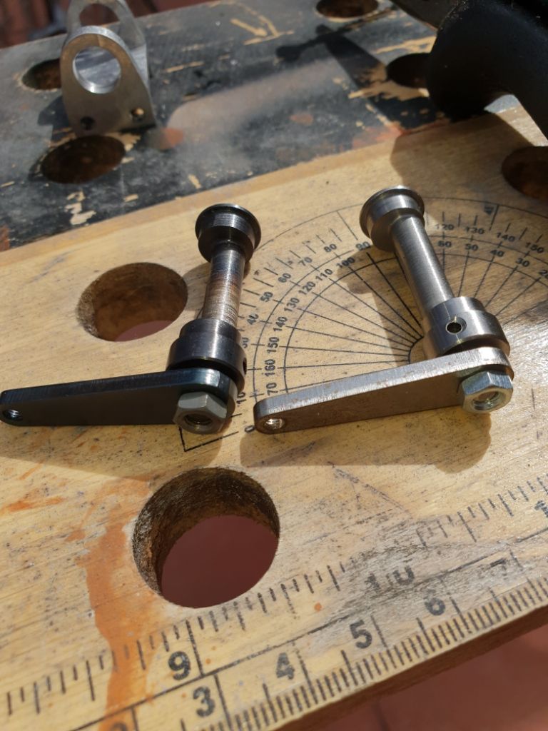

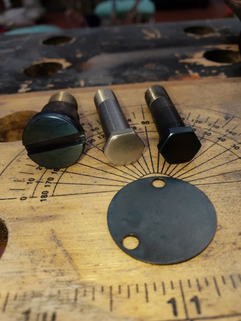

As I am going for a bare metal/polished and anodized finish for my gun I was a bit worried about various bits that I originally intended to paint.Things like pivot pins and small steel brackets.
I've tried a process that sort of blues the finish to save painting the individual parts.It looks kind of ok to me,I'm not sure about the durability of the finish but it looks how I want it to look. I like that it gives an untreated rough type of finish.I may look at gun bluing the armour and other plates and avoid paint if possible.
Glen
Glen

It looks like I'll have to go back to plan A.For somebody with the patience of a Tasmanian devil this gun bluing isn't doing it for me.After 5 applications of the bluing solution it's still streaky and uneven. I've done exactly as the instructions say it is something beyond my pay grade/patience level.
Back to painting them gunmetal grey then. l You don't know until you try.
Glen.
