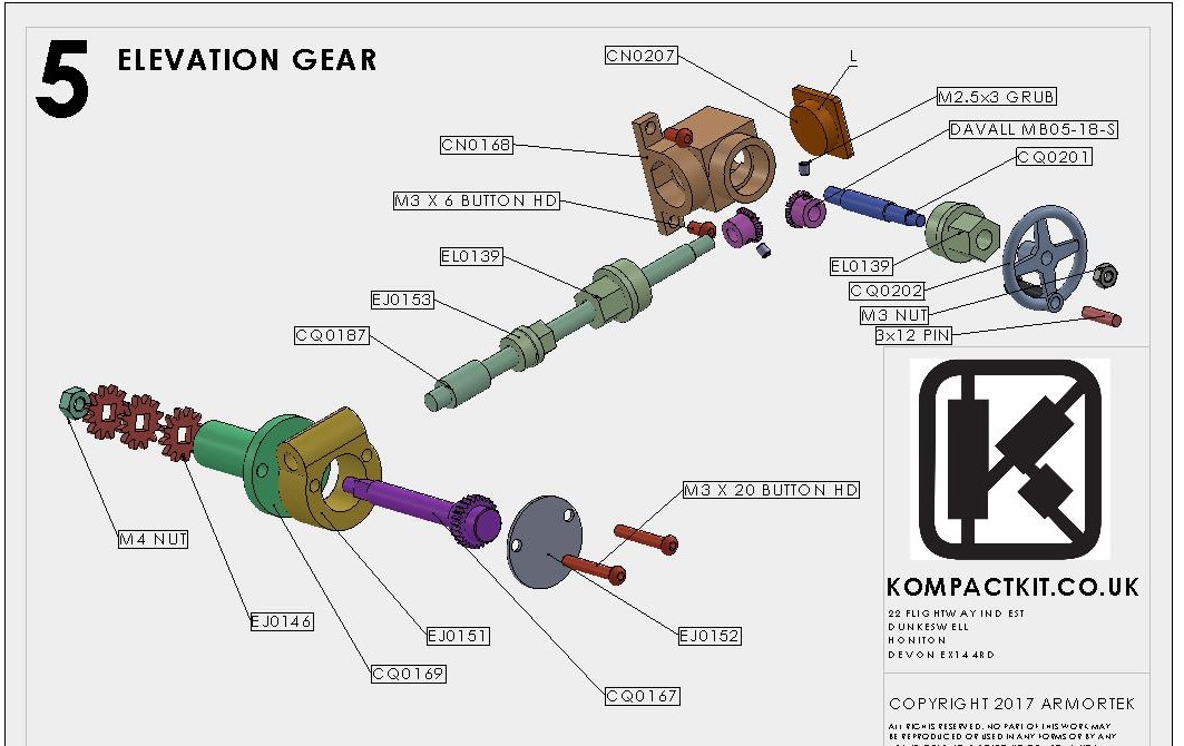

(1) On stage 5. The Elevation gear and Slew gear, when I screw in the EJ0152 cover tight, the gears wont turn. If I keep it loose, it works, but rattles. Is there a trick to this?
(2) on stage 5. When I screw EJ0153 into the housing EJ0151 it wont allow the gear to turn if its screwed down tight. Is there a trick to this?

1) the elevation gearboxes I took a dremel and relieved a lot of the material in close proximity of the gears. This helped them rotate freely.
2) I shortened the treaded length on CQ0187 just a fraction which helps when the brass hex bosses are tightened.

1. Make sure EJ0146 is deburred and the inside edge is taken off. Same goes for CQ0167. The fit of CQ0167 and EJ0152 should then be good. If not, file the top of CQ0167 slightly. Do not file too much as you do not want slack.
Same will apply to the other gearbox.
2. Make sure to take the edges off the inside of CQ0169 and EJ0153. If that does not solve problem then there are two solution. You can either do as Bob suggested, or do E0153 up to be finger tight and loctite it in place.
