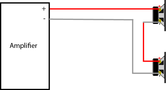

I see that the new Audio Module has one speaker wire and the instructions describe that the unit uses a Mono amp and is designed to use a single 8ohm speaker or a pair of 4ohm or 6ohm speakers connected in series.
I have a pair of the Tannoy speakers already, but don't know if they are 4, 6 or 8 ohms.

the satellite speakers, which is what we use, have an impedance of 6 ohms. I would wire them in series as per your diagram and see whether they are loud enough for you.
The amplifier chip is the Maxim 9736A, which will produce 30W into a 4 ohm load when used in a mono configuration, which is how the new Audio Module appears to have been laid out. Two 6 ohm speakers in parallel are a total load of only 3 ohms, so I doubt the amp would play for long before going into thermal shutdown.
I'm not sure what you mean with the "Join Here" on your diagram, as that will short out the bottom speaker completely

Hi Adrian, sorry, I grabbed a couple of pix and then uploaded the wrong one
Will fix now.
