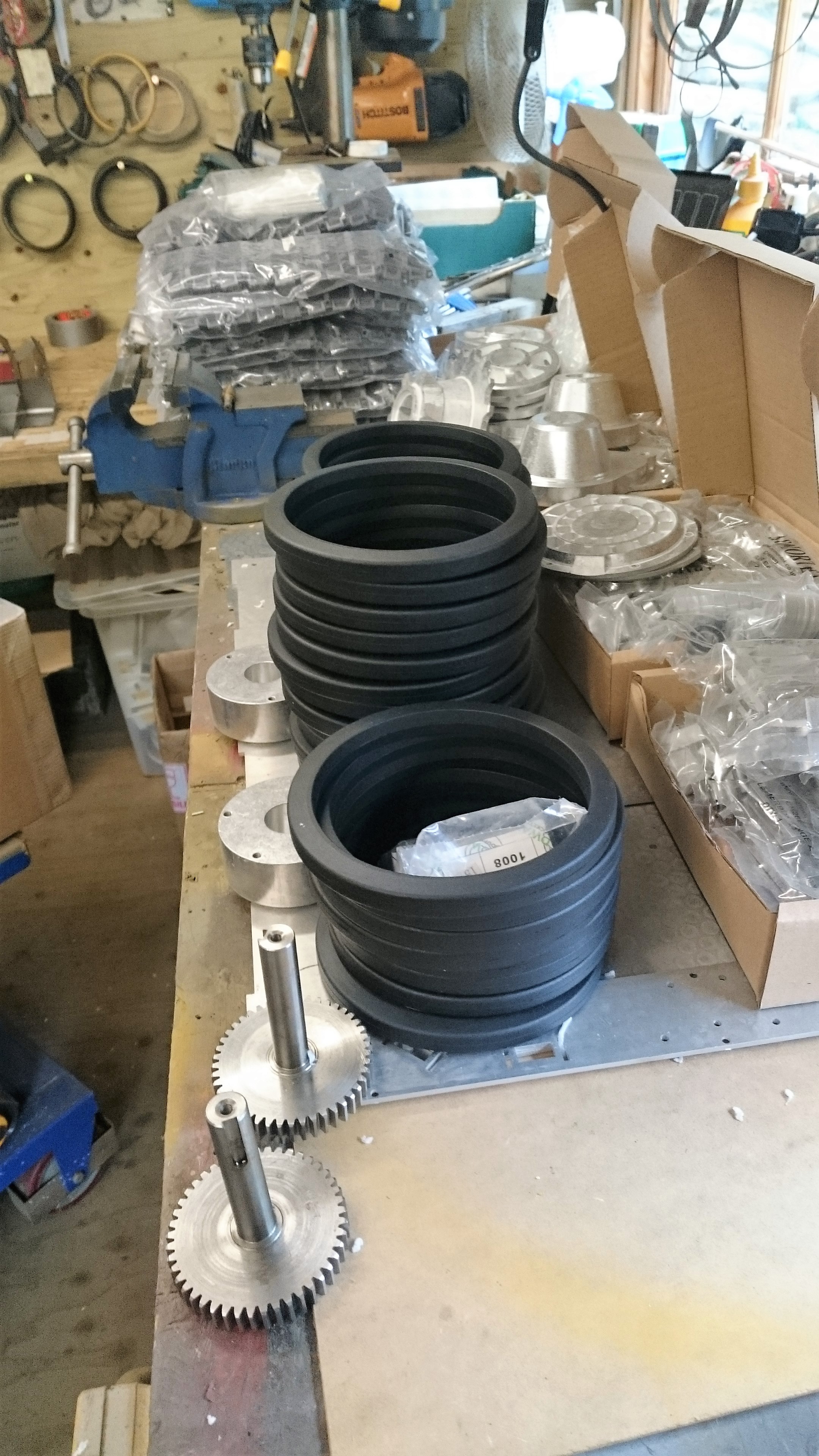

From a pile of parts.

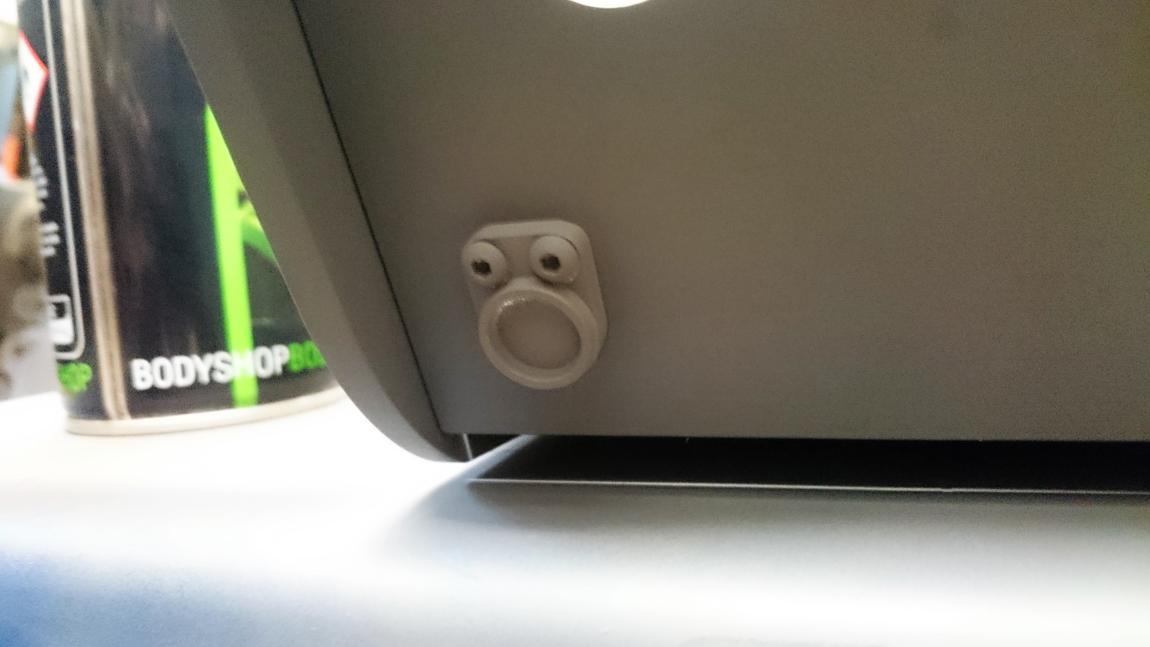

Heres a tip.
Heres a tip.

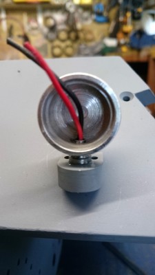

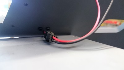

Fit the driving light now and run some wire even if you are not planning to fit working lights.
The bracket fixings are extremely difficult to get to so fix it now.
The same goes for the rear reflector
Fit it at this stage or you will be cussing later.

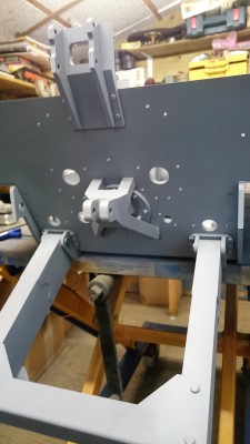

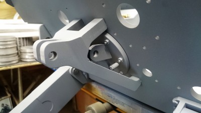

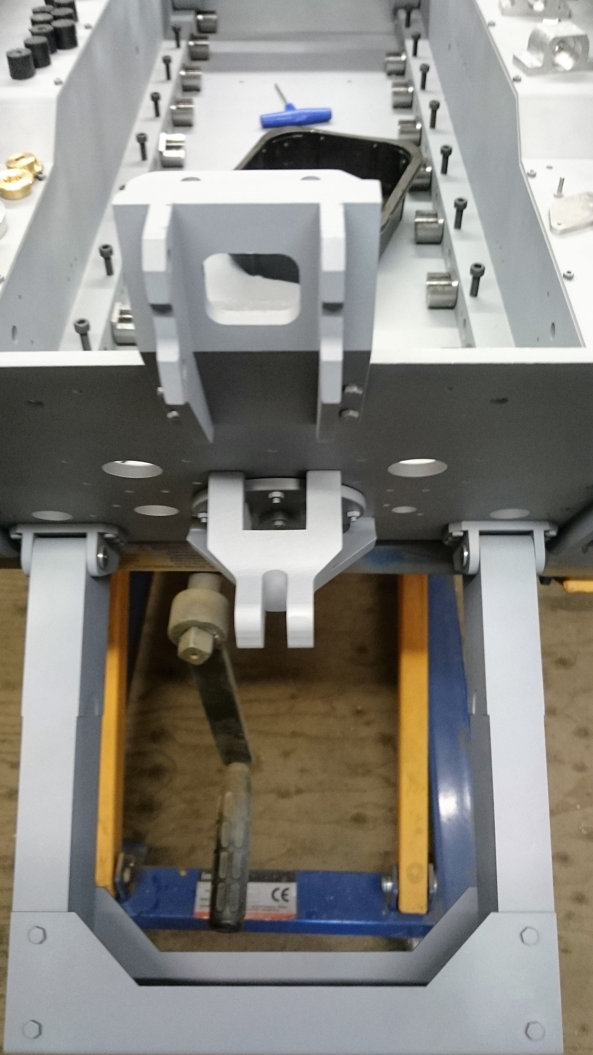

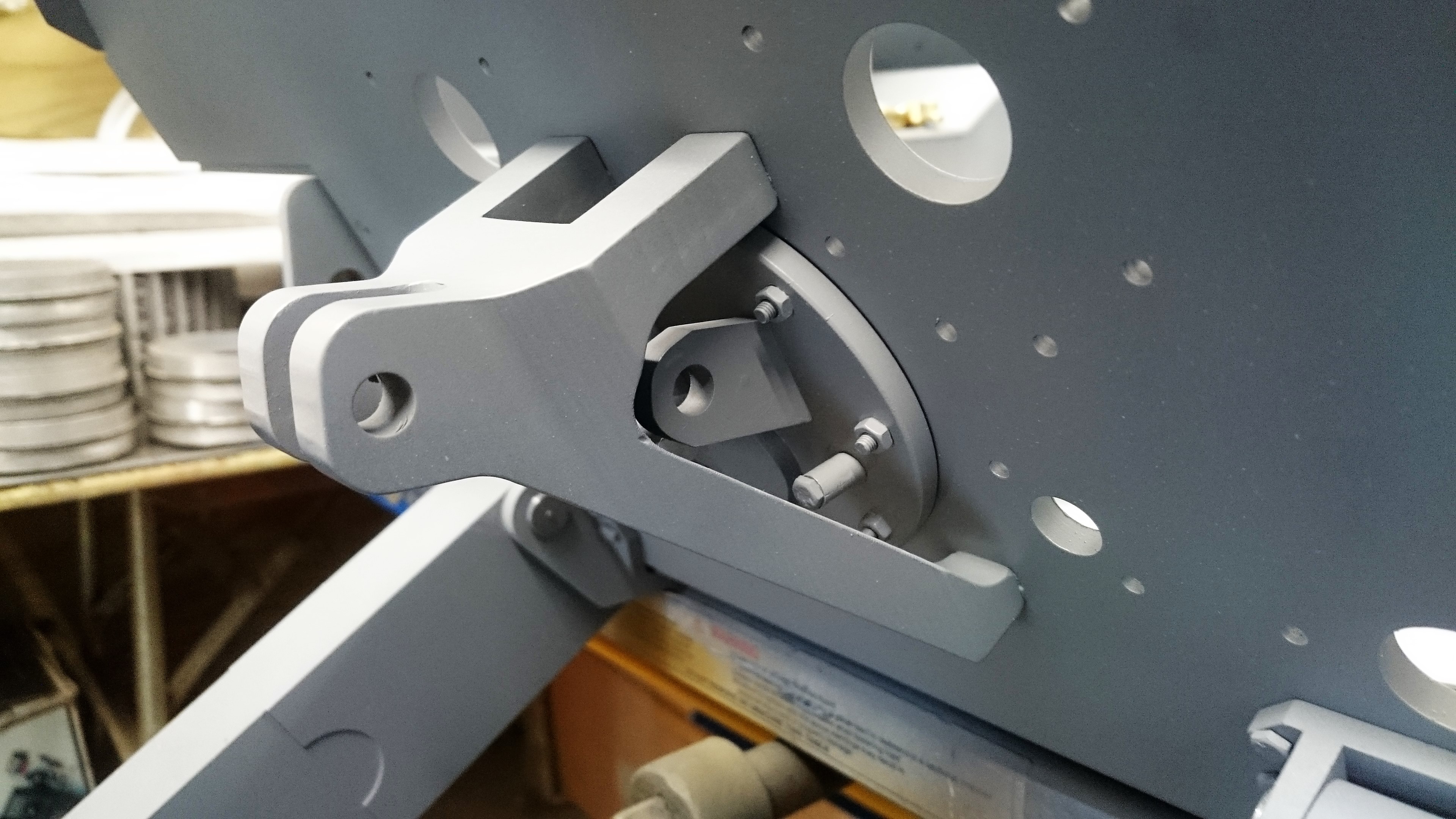

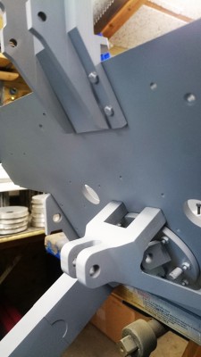

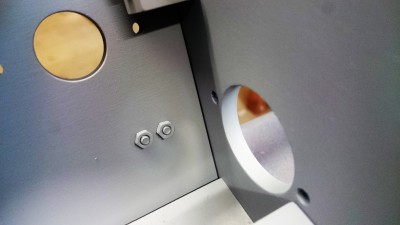

Progress made on the rear plate, I just love all those unique parts for the Bergepanther, although you can hardly see the starter plate I have used M3 studs with nuts on the outside for added detail, the nuts should be castellated but I don't got nun (good modern English that).
The spade saga I will go into later, as I have to manufacture the pointy spade part from 2 mm mild steel plate, I have no bending machine so I'm thinking of contracting that job out as the bends are tight for 2 mm sheet.
I have no rollers for the wire rope feeder device so will have to turn four off on the lathe.
I'm so glad that Mark made a spare rear tow bracket as that is a complex shape.

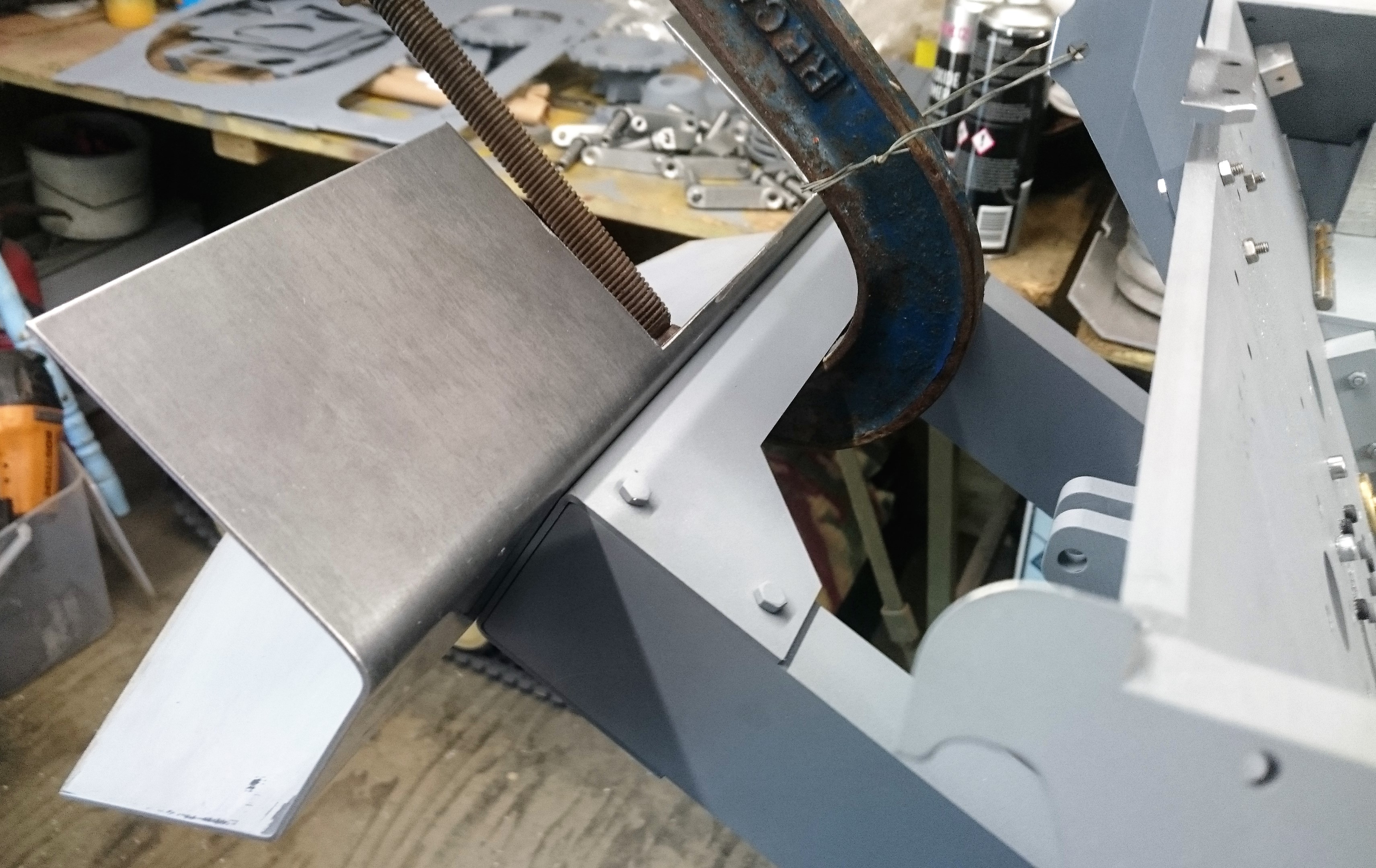

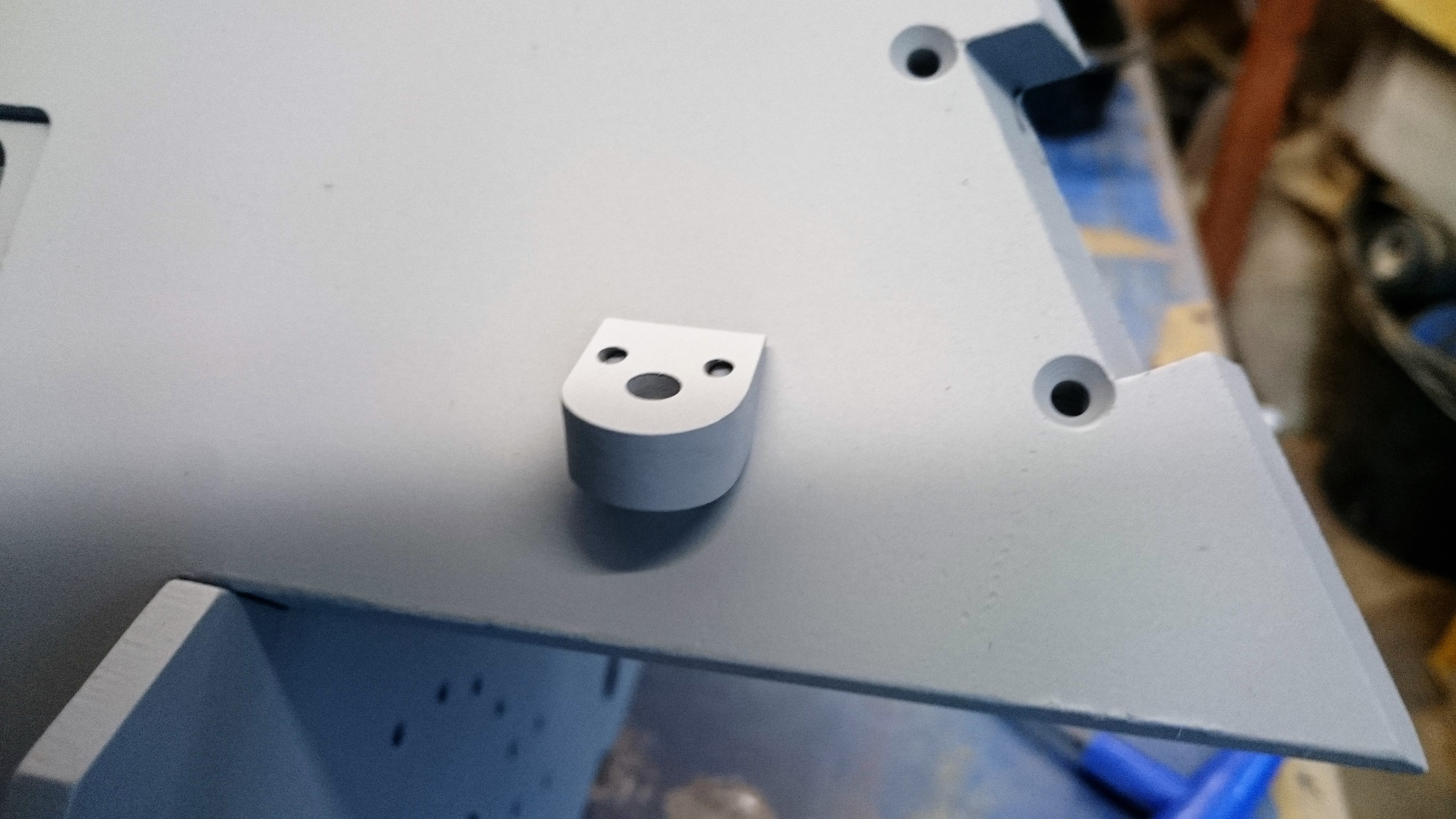

I have added the starter plate lugs also.

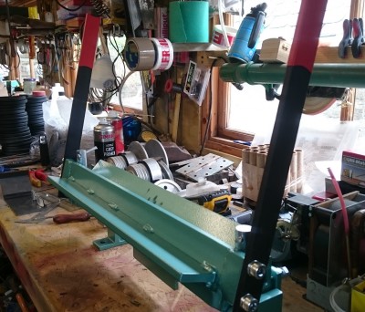

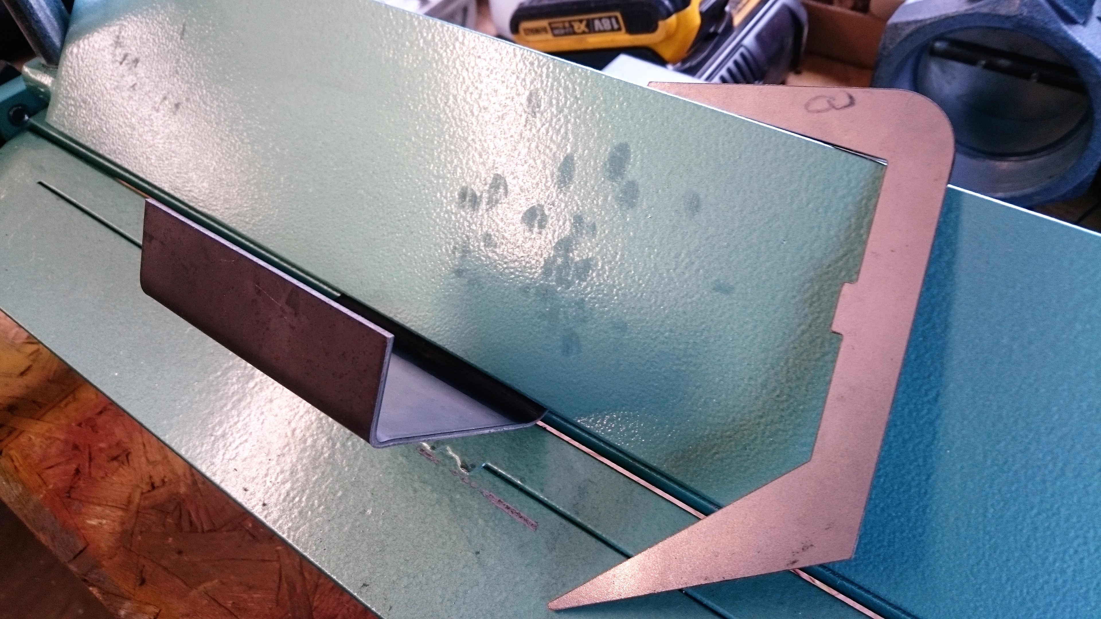

Well I have bitten the bullet and splashed out £140 quid on a new bending machine, it's heavy duty as far as modelling goes and will bend up to 2 mm mild steel at 500 mm wide so it will cope with most of the Armortek fabrication of mud guards, fenders and brackets.
I haven't done an awful lot of sheet metal work since my apprenticeship many moons ago so I have had to brush up on the dreaded bend allowance tables, there are so many variables in material and bending machines that your best making a few test pieces from off cuts until you have it right.
Bench mounted bending machine.
The 2 mm test piece, I almost got it first time.
The test piece in 2 mm mild steel to ascertain the correct bend allowance, I don't want to mess up the pre cut sheet.

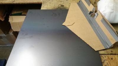

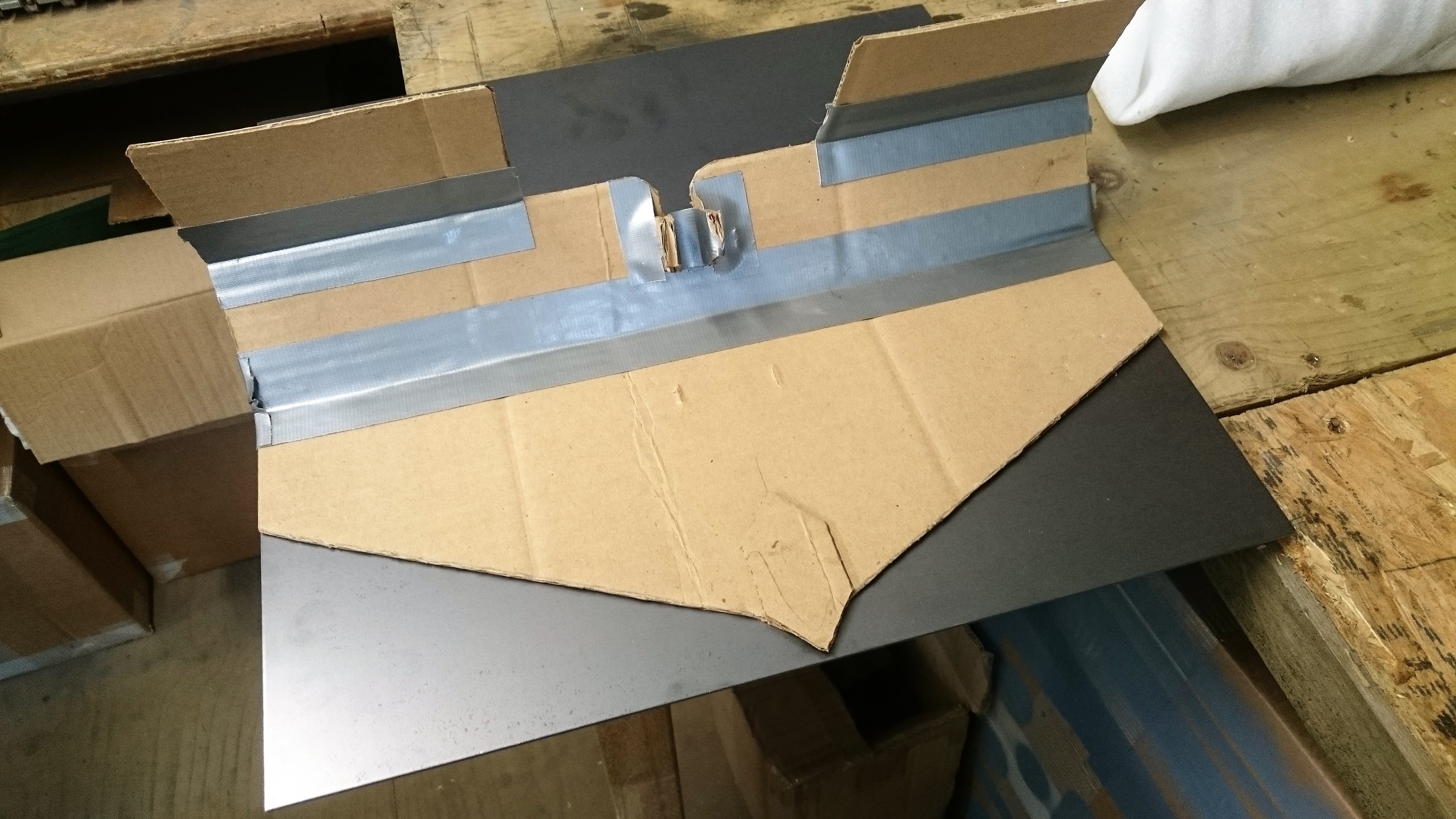

My lovely cardboard spade template copied from the "G" Berge.
2 mm sheet bought from ebay.

Interesting stuff Phil. I found a 300mm formit from Warco to be really useful for sheet metal work, it has a press brake, sheer press and bending rollers. if you wanted to refresh on metalworking tools and techniques, the place to go is the YouTube channel by Ron Covell. He does a lot of very clever things with sheet. Search on "Ron Covell Metalworking DVDs".

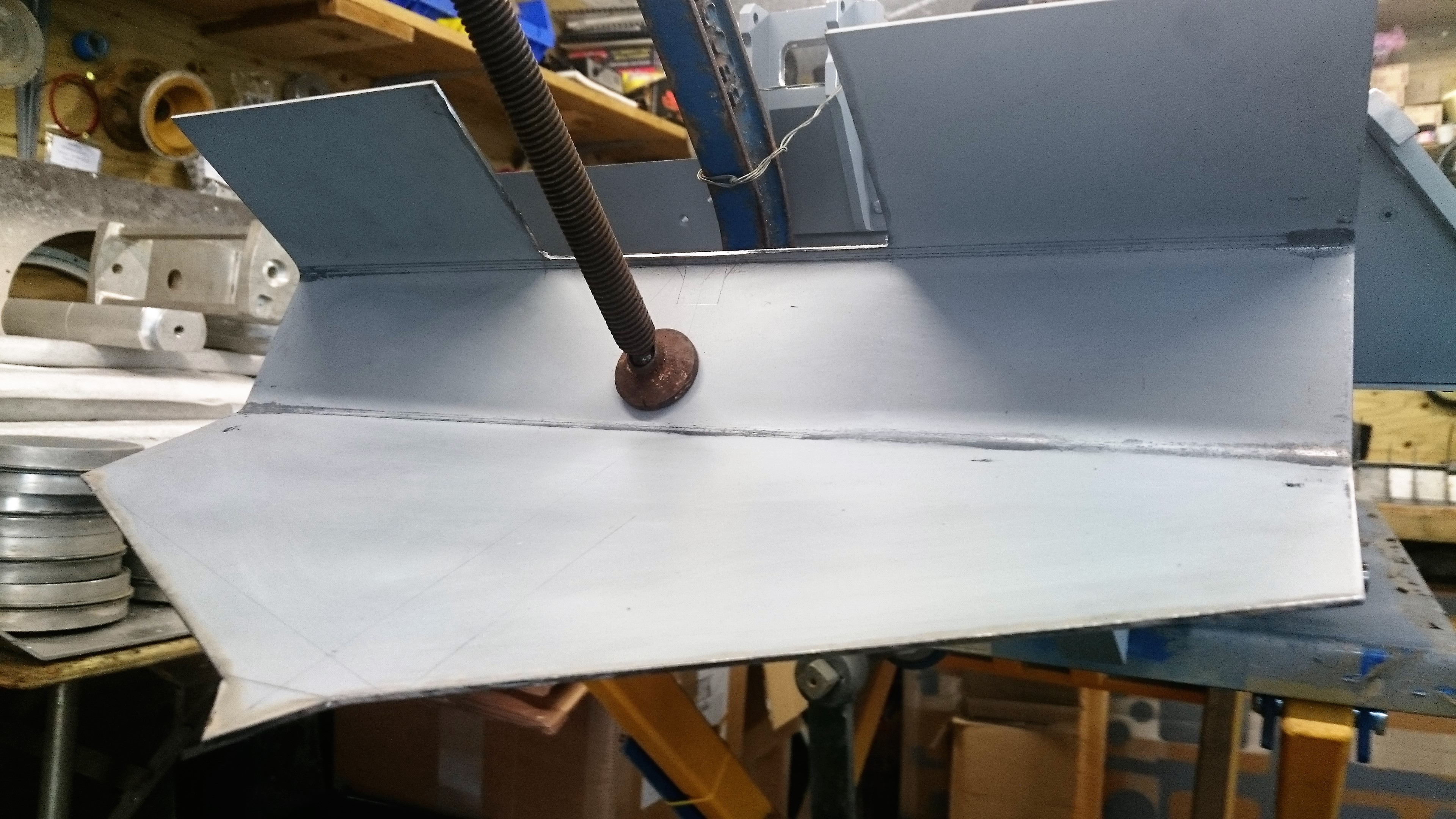

A little progress. I shall mill the 2.5 mm slots into the spade to accept the stiffening braces, that will be a long job as there are around thirty of them.
Just roughed out with a 2 mm angle grinder ( the ultra thin cutting discs allow a fair degree of accuracy) lots of filing/dressing to do.
Checking for alignment and correct angles, which need tweaking a little.
