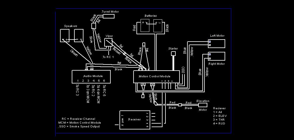

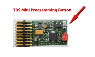

I have the latest Audio System and I have looked and looked on the printed circuit board for the program button and I can't see one anywhere. I have even used a magnifying glass. Can someone please help me. I had it working on the bench without pressing any buttons but wouldn't you know it now I have fitted it in my tank it is not working.
Cheers Frazer
Cheers Frazer

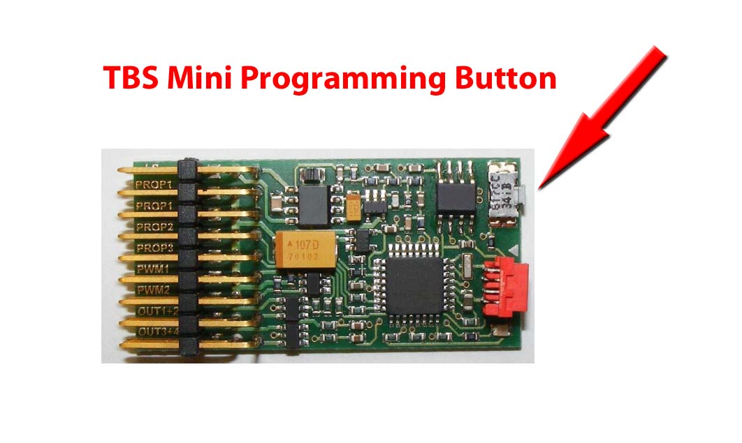

You should see the TBS Mini shown below plugged into the main Audio Module board.
If it worked on the bench but not in the tank then it's far more likely to be the wiring than the programming, so I would double check that before trying to reprogram it.

I did see that tiny black button but when I push it nothing happens. I think there must be a fault with the sound card as when I had it working, I did a drawing to make sure I set it up exactly the same. I have my transmitter No six channel configured with a three way switch, so the sixth output on my receiver plugs into the No six input on the audio module. I connected this input to a servo and it works fine, so I know its getting a signal from my transmitter. As I say I think it must be a problem with sound card. The Viper also is not sending the current through to the turret moror.
Cheers Frazer
Cheers Frazer

First off, being pedantic, I'm not sure you have the battery connections (red + black) going into the MCM the right way round
You drawing makes it look like the Viper and the Audio module are both fed from the same 10A feed and if neither is working, that would seem to indicate a fault common to both, which may well be the 10A fuse.
If it is blown, disconnect both the Viper and the Audion Module before replacing it, in case it blows again when you plug one or the other in.
I can't recall if the Audio Module has a power light but you should be able to see a small green LED flashing rapidly on the TBS Mini card, between the red connector and the PCB edge. If that isn't flashing, the TBS isn't getting any power.
Do you hear the single squeak from the TBS Mini when you power up ?
