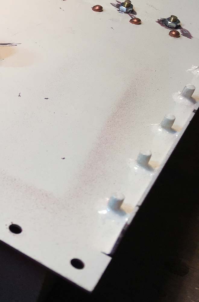

Hello Kevin,
I used 2-component epoxy resin adhesive for heavy-duty requirements like "UHU Endfest".
In the picture below you will see some painted examples.
Oliver
Oliver
