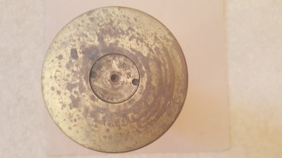

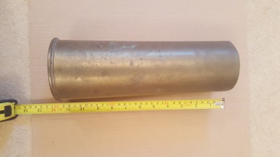

Hi Adrian,
I just happen to have a 25lber casing, All sorts of marking on the base, here are a few CY06/85 030 030 3BN 85 IIMK4 MK2/1 25P PLB 1A. The base is 104mm across 4mm thick, step 3mm high by 1mm thick, 285 mm length from top of step 292mm overall length.
I make the top 90mm across, skin 1mm thick The tapper looks approx. 3mm over the length ie base excluding step 96mm top 90mm therefore 3mm over 285mm
Hope this helps
martin

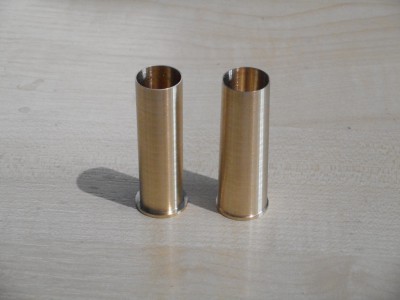

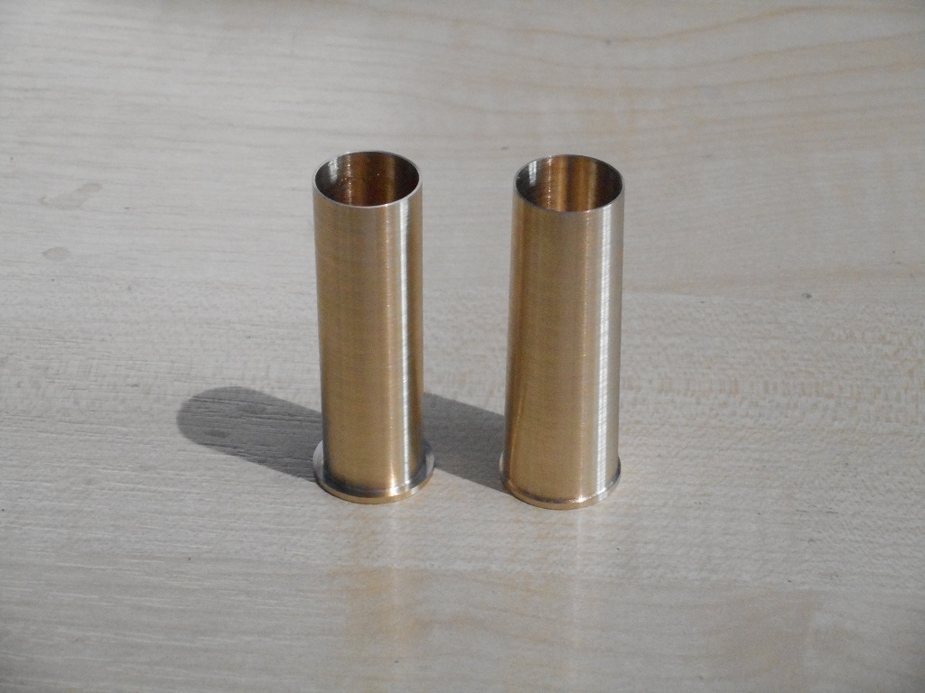

Here is the latest casing.
1mm taper from one end to the other, with the open end wall 0.25mm thick.

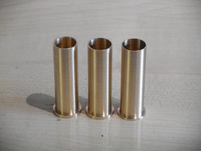

Last go for the time being as I'm all out of 3/4" brass bar
On the left is the casing done to Martin's dimensions, compared to the previous tapered one.
A flash shot shows up the machining marks, so I need to work on the programming to try and make the final cut smoother.
