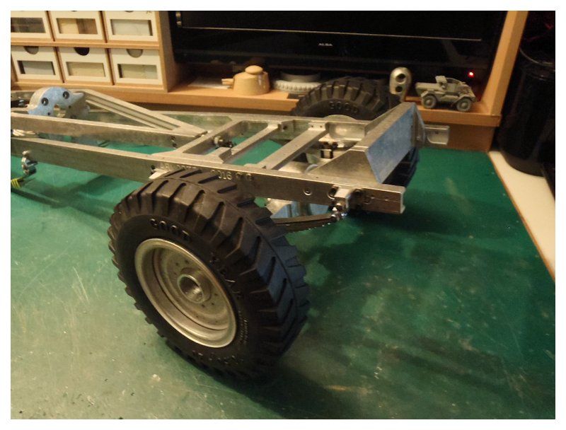

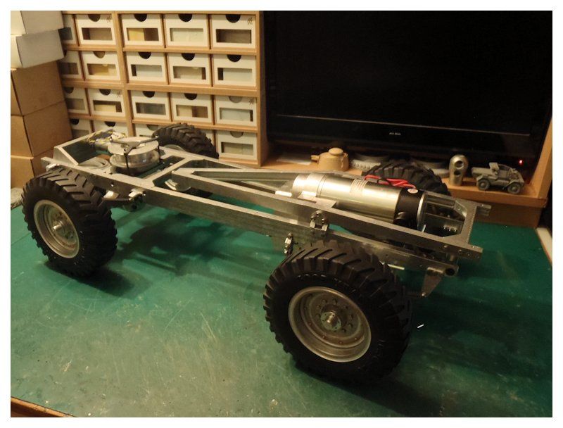

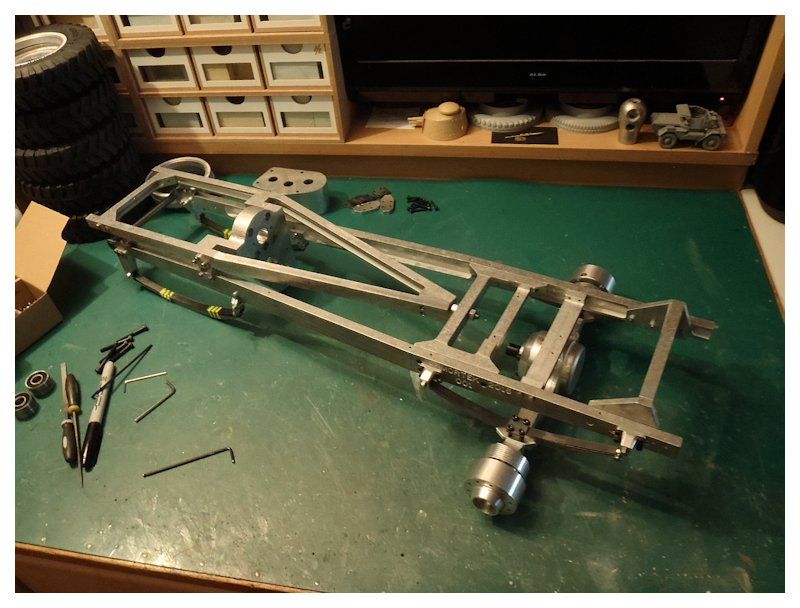

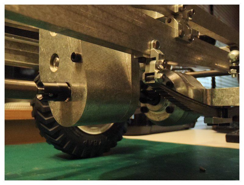

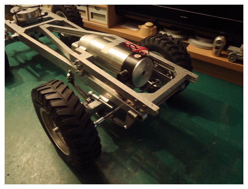

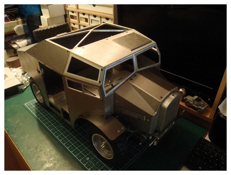

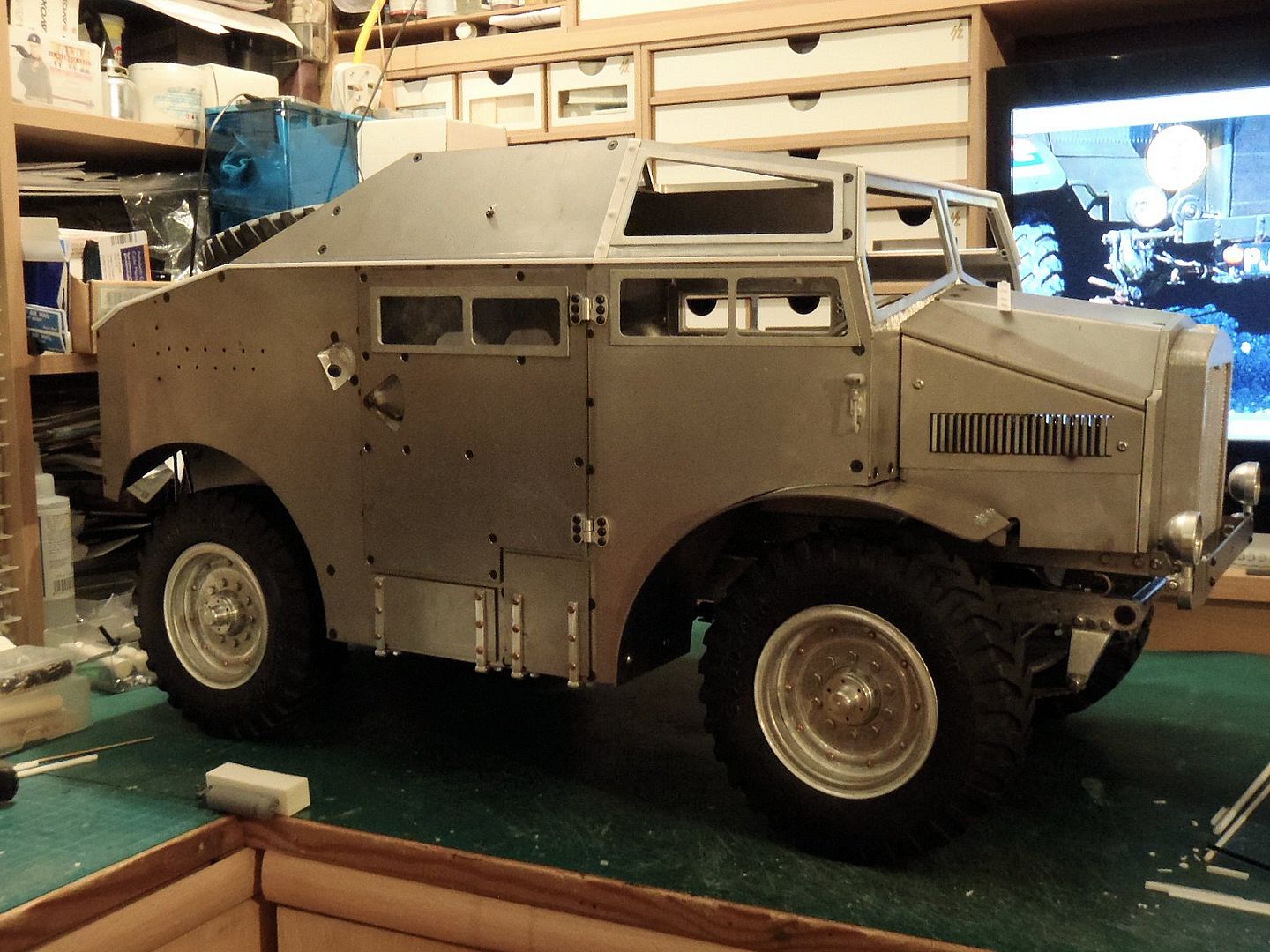

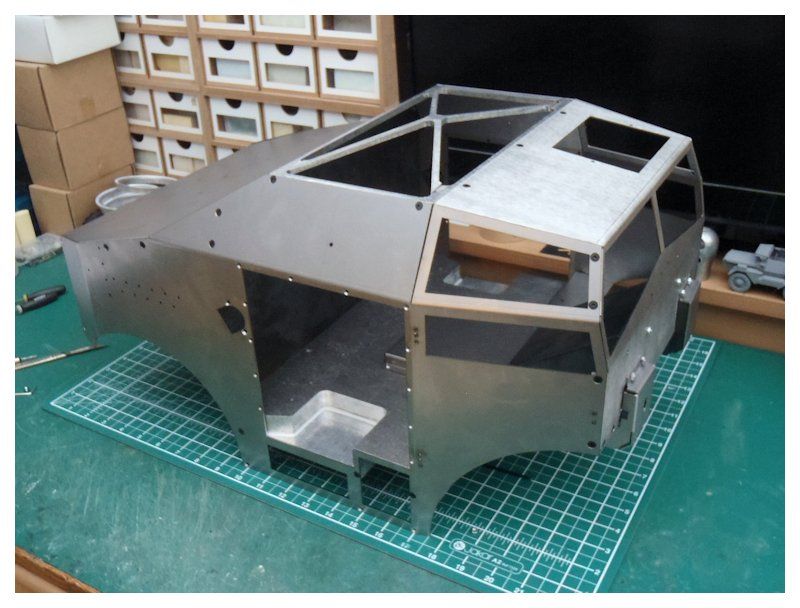

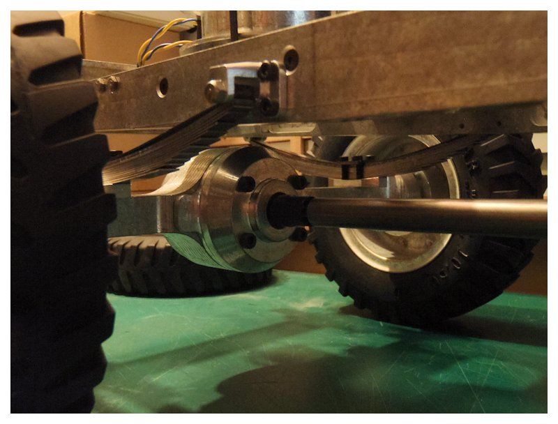

I think its safe to say progress although slow yesterday has been good today. My fingers have the usual signs of working with plate but nothing half a dozen plasters can't fix

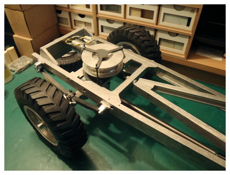

I think I have all the drive parts in the right relationship but the main aim for now is to get the model far enough on to start on the upgrade stuff. Gear box rotates smoothly and I think I have the diffs right based on Marks post. I might have the front axle a little too far forward but it seems to be the best point for the shorter of the 2 drive shafts. Once the upgrade stuff is done I can spend more time on the drive.

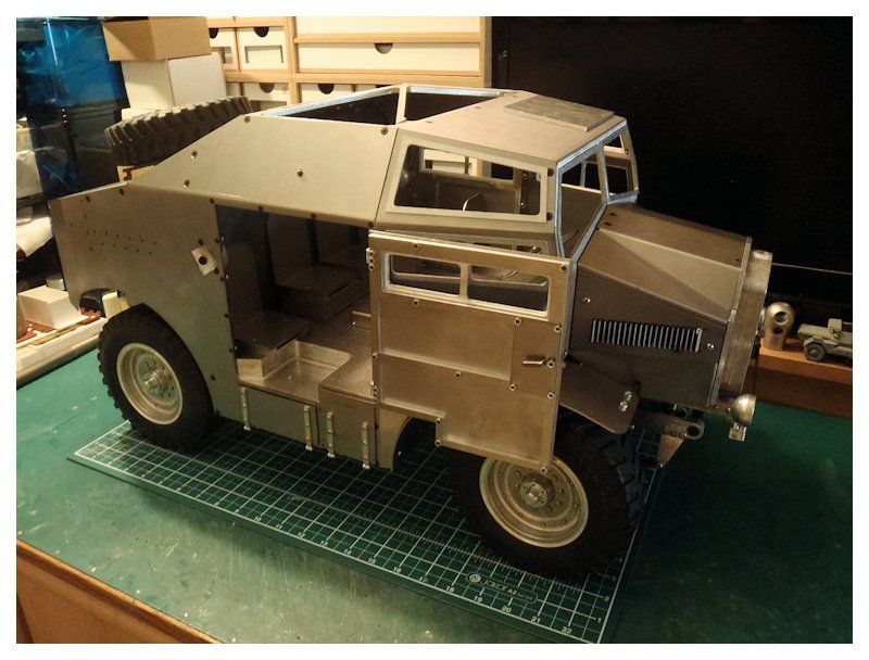

I have to say that considering the number of different angles on the body work etc that assembly was very easy and the fit is spot on. The only holes I have had to ease were on the door frames and I had one small area to file where the return angle on the front plate just fouled the lower window frame.

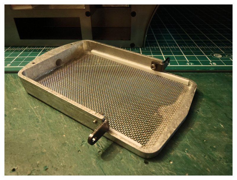

I've added a couple of plastic strips down each side of the radiator grill to lock the mesh between the fan housing and the outer frame. Although I have also glued it this should stop it getting pushed out if the glue go's

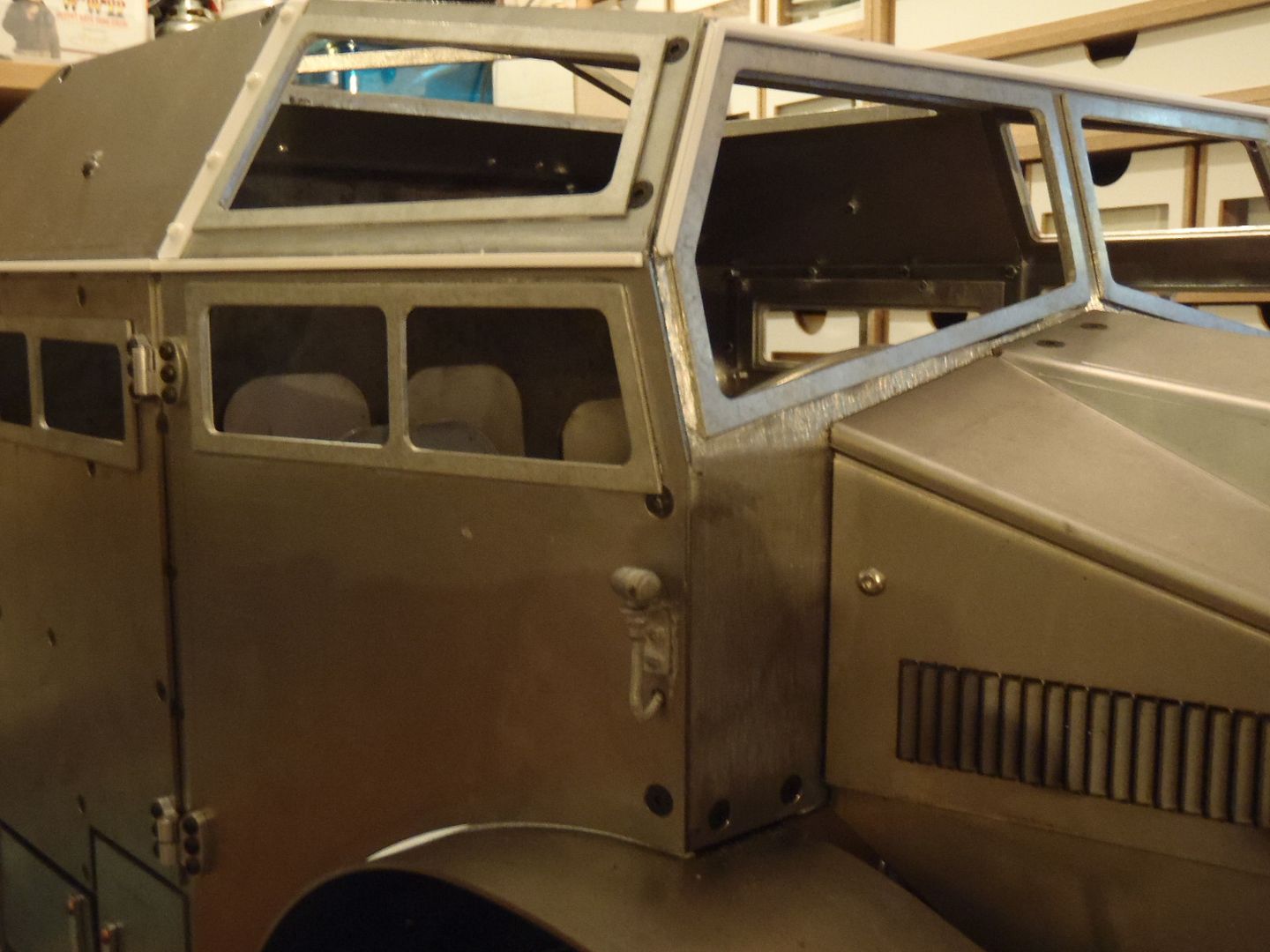

Re: Bryans Quad with yet another touch of Armorpax

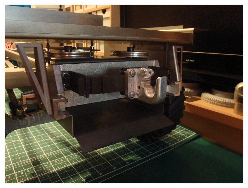

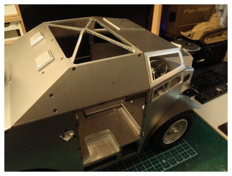

Hello Dave, that's just amazing, how on earth have you made so much progress. The photographs are an excellent aid to the many 'Quad' builders, well done matey.
A very small observation....does the part EMO221 simply rest on top of the drum EMO220, as I cannot see how to set EMO221 clear of the drum......
There appears to be many interesting Quad builds ongoing, looking forward, the paint schemes will create much debate.
Saturday evening was spent watching 'Fury' yet again .....Mick
Hi Mick,
I have it just sat on top of the drum at present. I am contemplating a little araldite around the base of the 3 screws to hold them vertical as they can move a little in the countersinks. Not sure if that's 100% correct but I think will be OK.
I figured I'd better get on with this and try and get ahead of the other builders so I can tell you what not to fit yet if you want to update the kit
Progress would have been better but I had my daughters birthday party yesterday and my sons today....slowed me right down
Michael (and Dave)
Good question about parts EM0220/221. Believe the top frame is stop winch cable slipping off the drum, so too loose and cable will escape, too tight and it will clamp the drum and burn out the motor. Rather than just allow the frame EM0221 to sit loosely on the drum I wondered about using a few spare M3 nuts underneath to lock it in place on the M3 x45 screws?
Dave, that might even add a bit more rigidity and ease the wobble.
Have to confess I'm not there yet, so let me know how you get on
Kevin

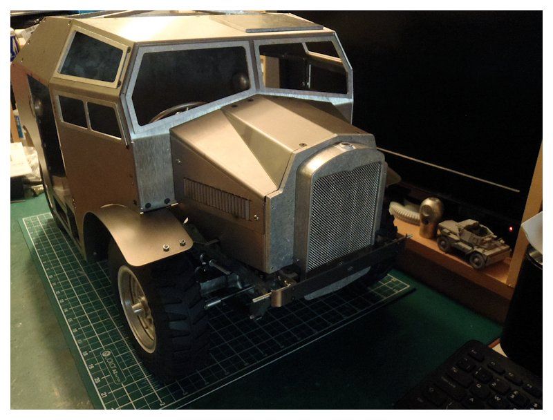

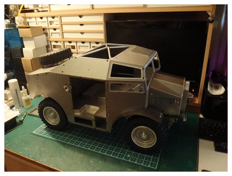

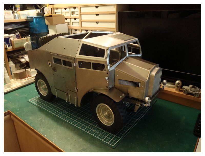

That's the basic build finished. I'll be starting on the upgrades in a few days once I have had time to go through the various reference pics and decide where to start.

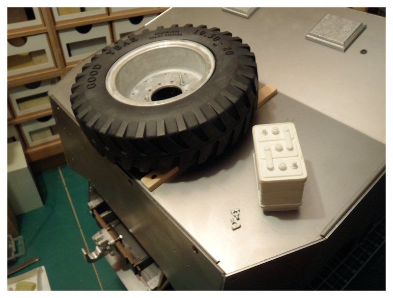

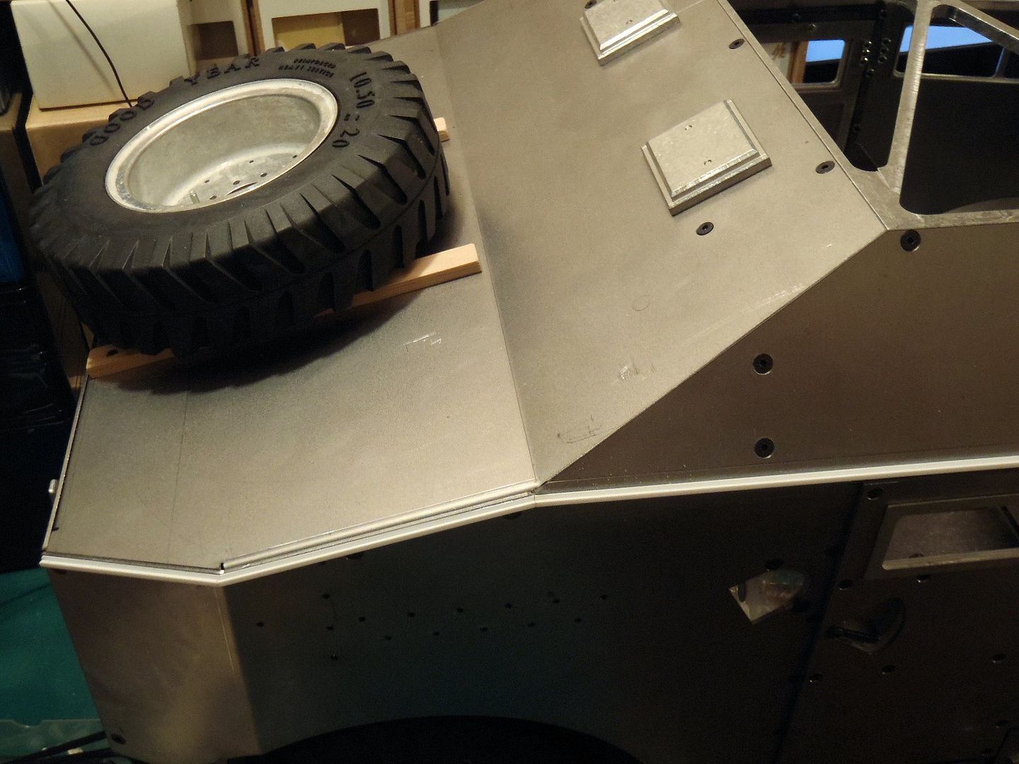

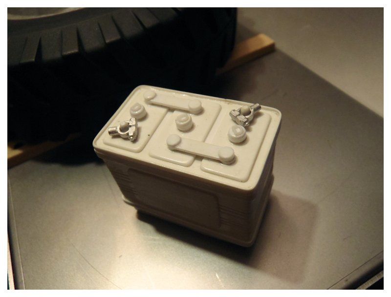

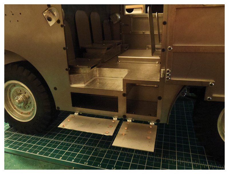

I've changed the rear metal spare tyre supports for two timber runners and will be adding the tubular outer frame and traversing wheel clamps at some point in the build. I already have a suitable battery and terminals for use in the cab which I'll make the frame for later.
Probably going to get the externals done before I start on the interior so gutter channels and hatch doors, hinges, padlocks etc will be next.

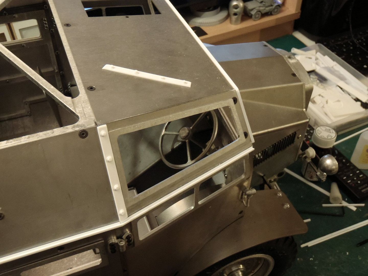

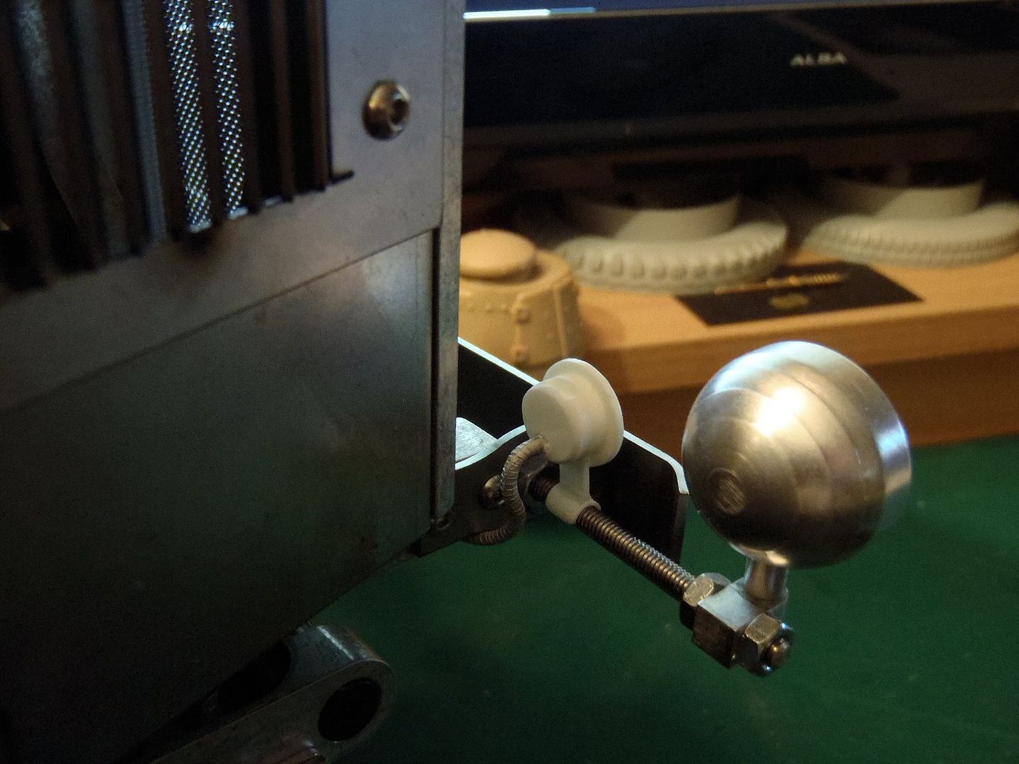

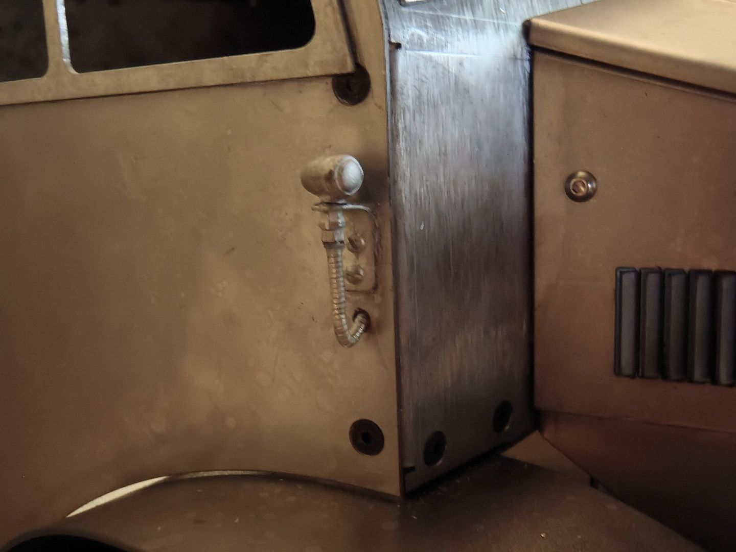

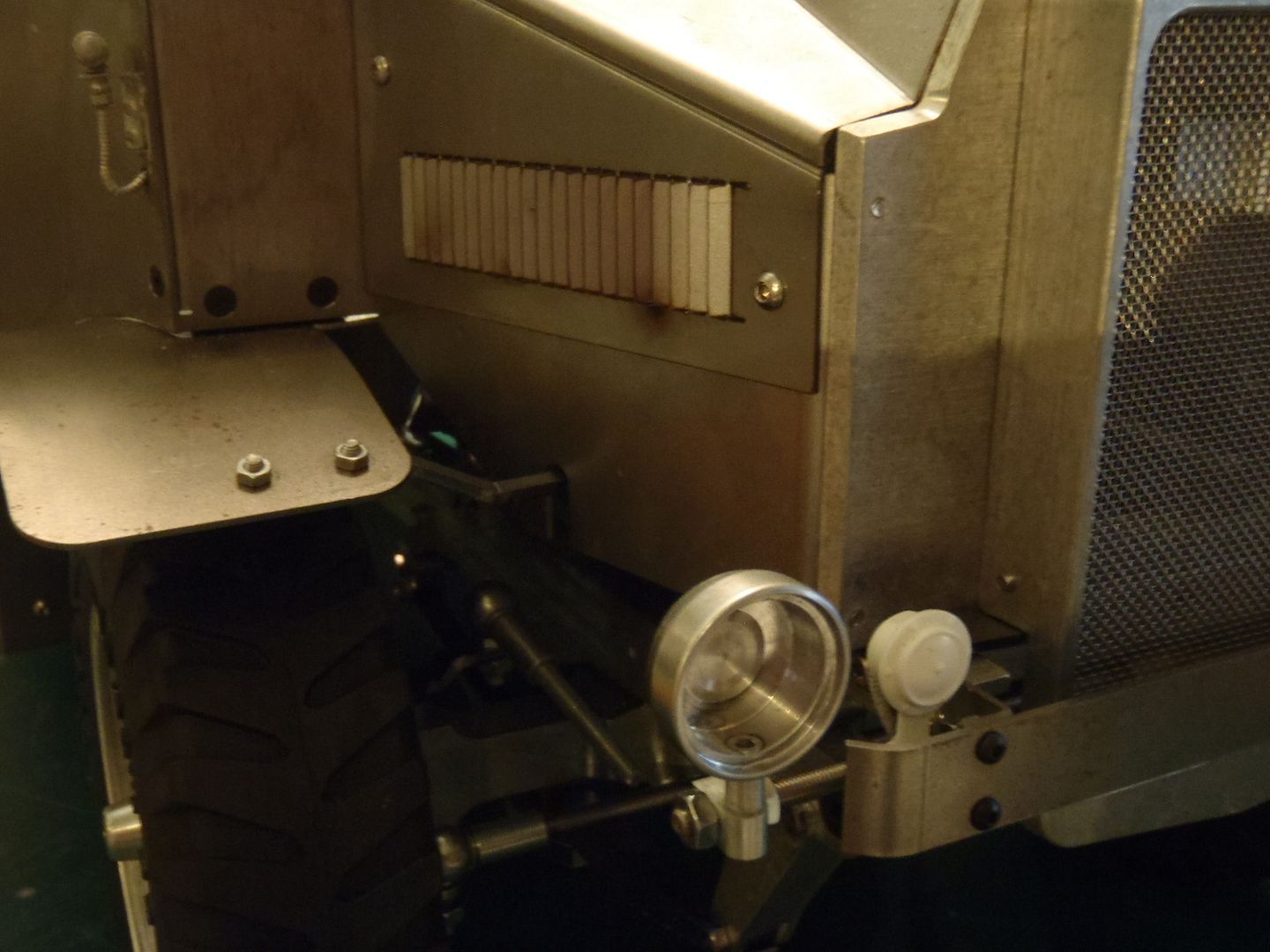

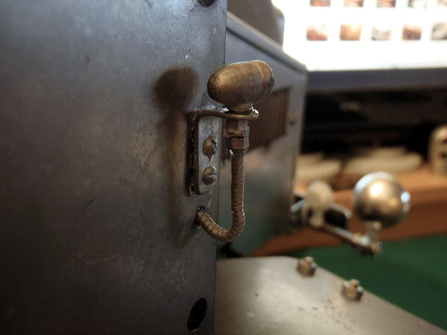

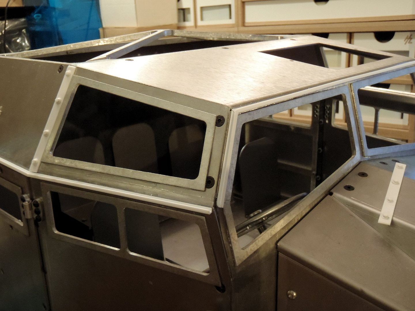

A little work on the Quad today. Side light assembly, horn and the first of the guttering.

Nice looking parts
Will you be doing the wipers and the front cable guide rollers ?

Yes, also lots of other odd bits like the chassis front D tow points, bonnet spring catches,hasps and staples, hinges etc for the exterior. Battery and battery frame, fire extinguisher, seat pads and general interior detail.
