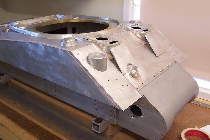

Hello Sean . This is how I do my welds and filling of screw holes using car filler . I tape up the area to the correct scale thickness spread on some filler with a peace of thin plastic . Then stipple the weld with a brush about half way through the drying time , when happy with the look remove the tape as quickly as possible . Once dry light sand the top edge . The best thing is to practise on some scrap alloy first .

Sean I think the kits are strong enough without the use of any type of epoxy on the joints this is my thoughts anyway !! In this photo you can see that all the bolt holes have been filled and sanded early in the constrution . Once I was happy that I did not have to strip down the model any more . Sean make shore that the heads of the bolts are counter sunk at least .5 mm below the hull plates to allow for the filler . I re-countesunk most of the holes in my tiger and sherman . Dale

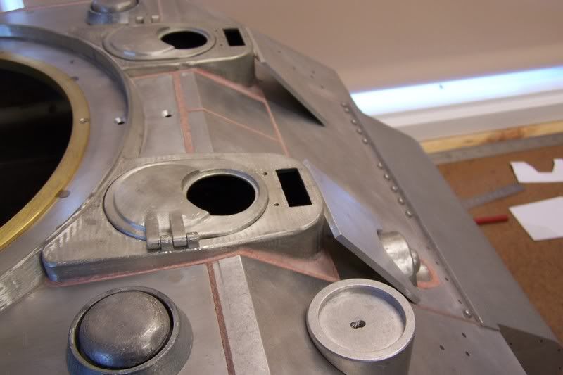

Sean this is a good photo showing the fake welds around the small parts like the stand off nuts . I also did the track cable holders as well they where done after this photo . I used wet and dry sand paper on a very small wooden block to sand the bolt holes flush with the hull sides . I hope this helps Dale
