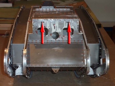

One thing I've noticed on the cab - there are more holes in the glacis (EK0123) and the bracket (EK0615) than in the cab roof (EK0124):
shown here arrowed on one of Chris's build photos.
Are these supposed to be blind or should I drill them out ?
I can see on later pictures that Chris has fitted bolts into these holes, so I'm guessing they were missed from the drilling plan. They do appear to be missing from EK0124 in the Section 9 exploded drawing.

On Bovington's Mark IV and Lincoln's Flirt the hole immediately above the vision slit is filled with a Bolt whose head size is slightly smaller than the Rivets.

Those holes .... I've no idea what I did ! I know that it was a right royal pain finding that extra strip - I ended up taking off the rivet heads with an angle grinder. So I probably did drill those holes out, but I can't recall for sure. Anyway, Steve's photos are an excellent guide - if in doubt, just follow history !

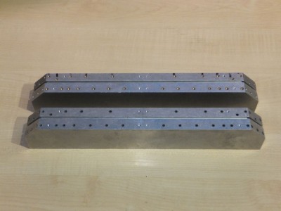

Thought I ought to keep my build ramblings in one thread.
"Kathleen" has had her brow lift, or forehead tuck, or whatever the appropriate phrase is :?
Heavens I'm in so much trouble if the lady in question ever finds this forum :shock: :oops:
This was the easy part, five minutes with the angle grinder and Proxxon sanding wheel.
I fear getting the cab sides to fit the new profile will prove more difficult.
