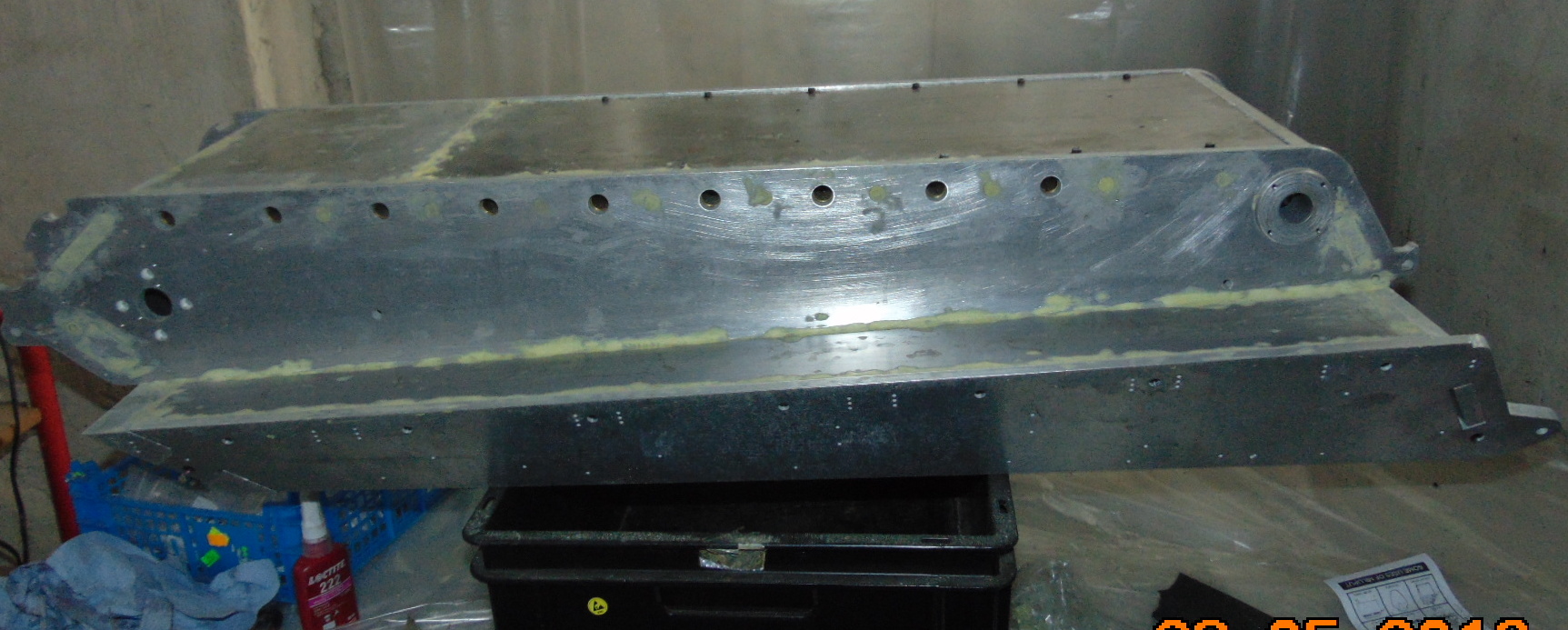

Progress has been made and stage 1 now complete.
A bit of filing required and the Hull Floor Rear needed to be shortened quite a bit at both ends to enable the bolt-holes to line up. Used the angle grinder for that.
Once everything lined up, tightened all bolts hand-tight, and then went round removing each in turn, applied Loctite, re-inserted and tightened. I do not want anything vibrating loose later on.
Now filling the bolt holes and gaps with Milliput prior to spraying the underside and lower part of the hull. Not bothered about weld details in this area as it won´t be seen. I just want the gaps to be sealed and waterproof.
After thinking about how I was going to mask the suspension bushes prior to painting, I have ordered plastic bungs in the various sizes, pack of 20 for bush in suspension bar (18 needed), pack of 20 for holes in hull side plates (18 required)and 4 for the idler bearing. Total cost 11 Euros

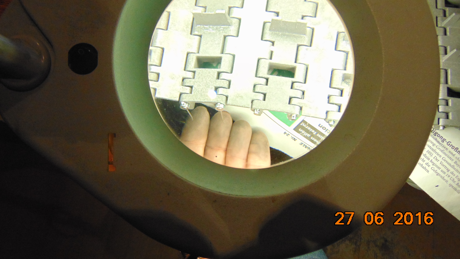

Having used the good weather recently to work on the garden (at present renewing the lawn which is taking a lot of time and effort), did further work on the KöTi today, attacking the inside circumference of the sprocket rings with 80 grit wet & dry so they would fit on the sprocket carrier.
The build manual states "One tooth on each ring has a small dot machined on it. The tooth with the dot must be fit to the same hole on the sprocket centre each side"
Why must or should the dots be aligned ? I can see no reason for it as long as the teeth line up.
Chieftain, Challenger 1 and Challenger 2 all had sprocket rings with a dot machined into one of the teeth. It was not an alignment marking but a wear marking. The leading edge of the sprocket tooth naturally wore down faster than the trailing edge. When it had worn down to the "dot", the sprocket rings were "reversed" (switched between inside and outside)to get more life out of them. When they had worn down to the dot again, then they were considered worn out and had to be replaced.
