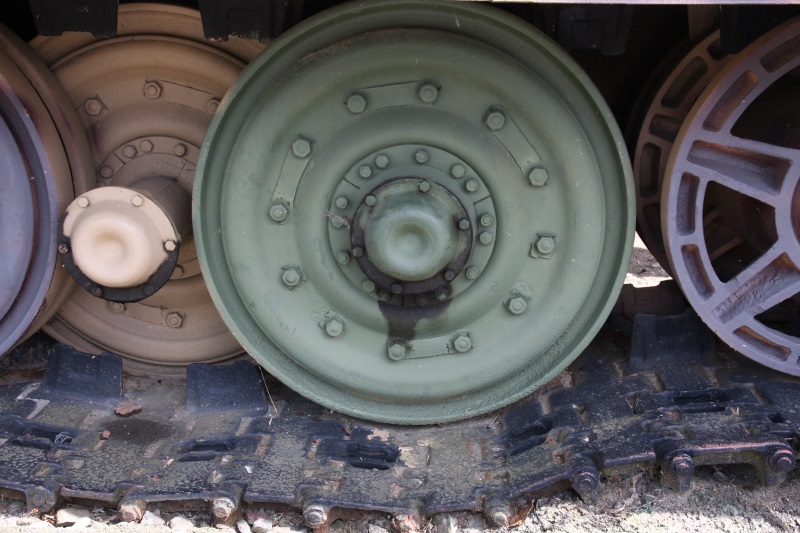

I generally thing that in the case of wethering that less is best. Rusty tracks and massively chipped and stained tanks are a real turn off for me.
Ive attached a photo that i took last year of the King Tiger in La Gleize clearly showing the leaking oil seals on the hubs. I realize this is not an in service tank, but the oil staining is likely to have been a common occurance in the field.
