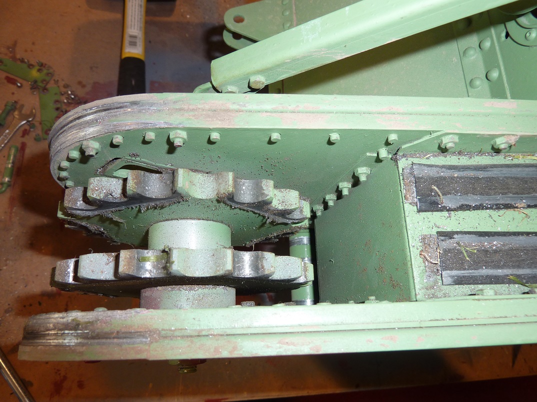

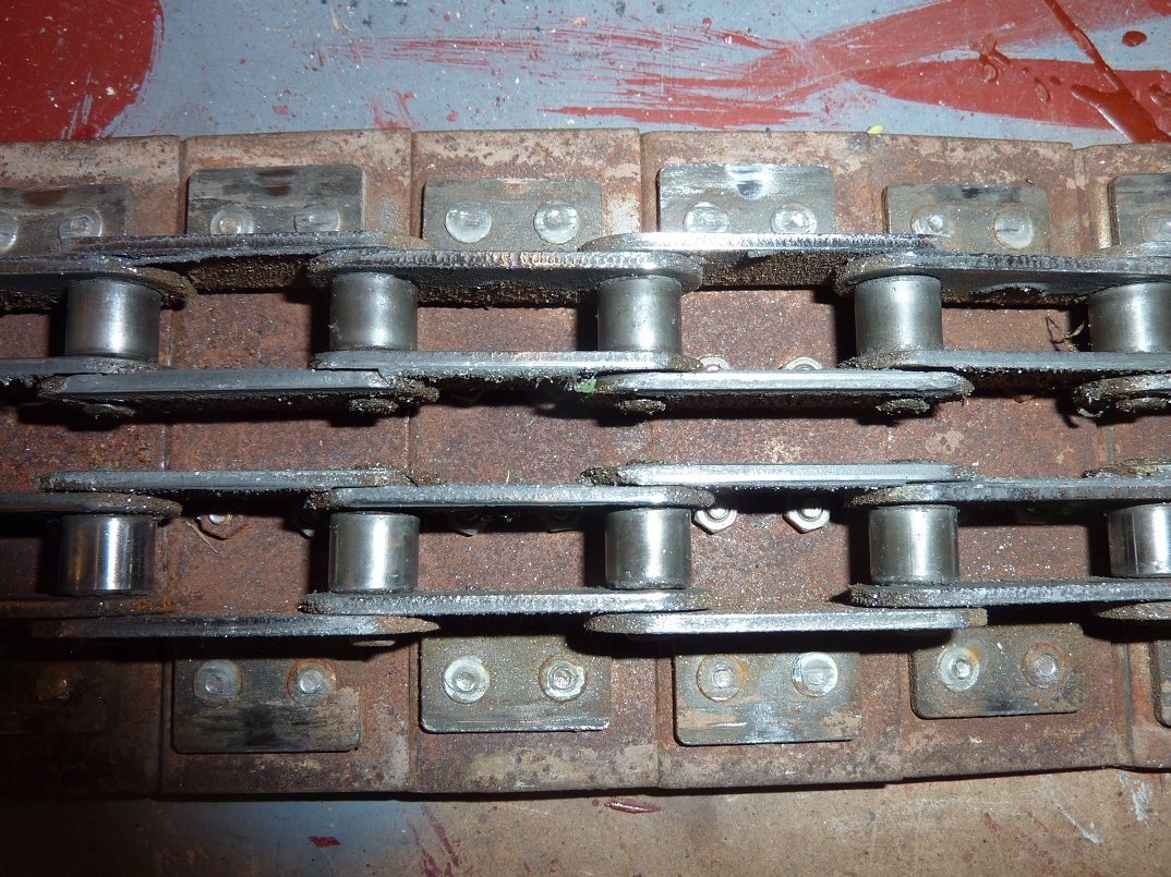

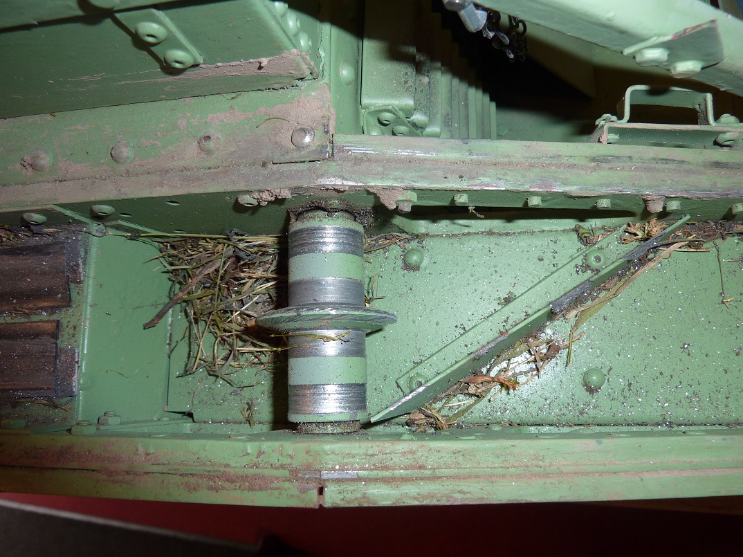

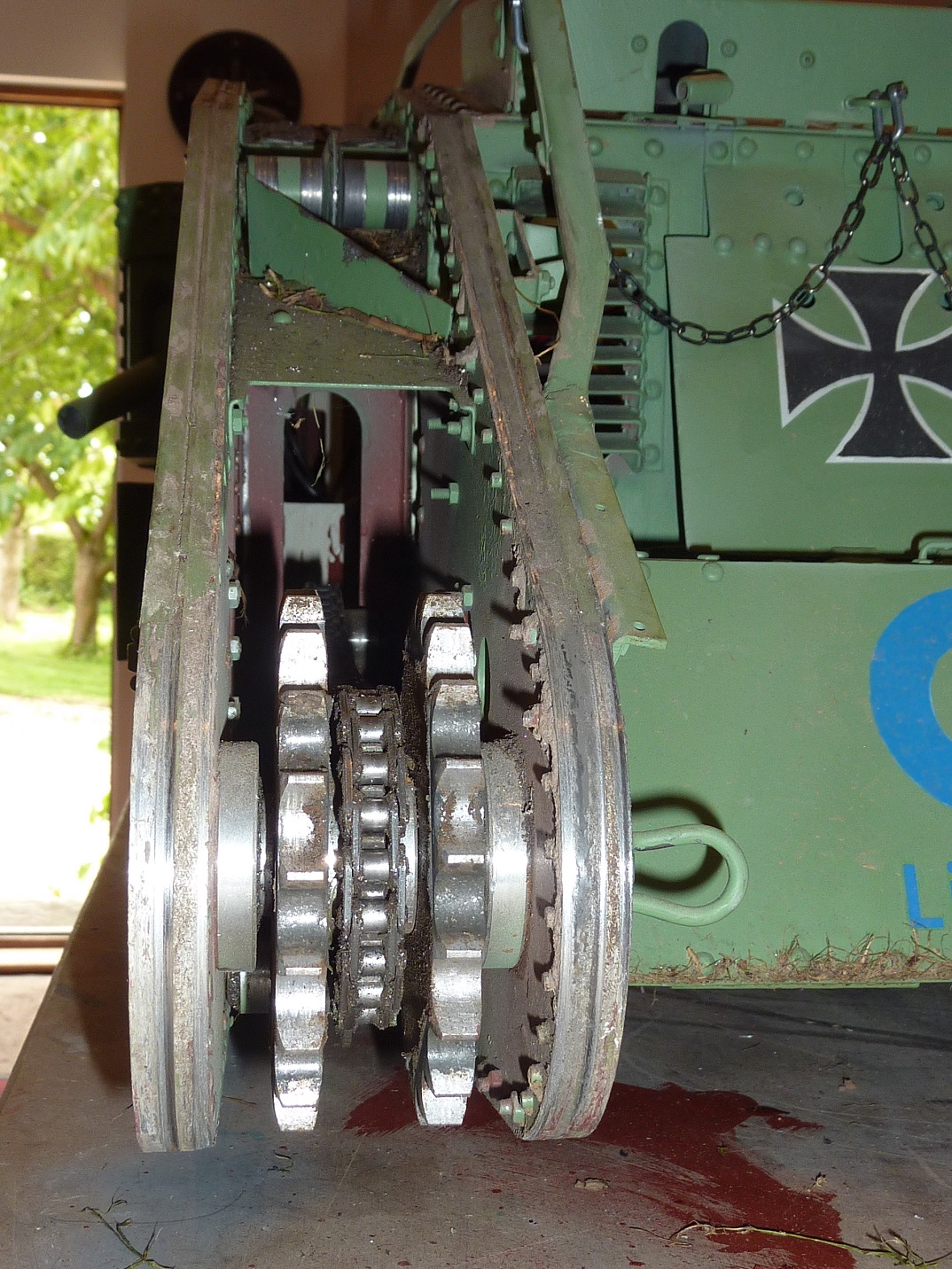

Track removal on a Mark IV is relatively straightforward, in theory. Slacken off the tensioning bolts to the front drive sprockets, allowing the drive assembly to drop down inside the front horns. It helps if you take off the front track inserts EK0239 and EK0240, to get in a screwdriver to pull down the tracks even further. Then unbolt a few of the track plates covering the track chain joining links, pop off the clips, remove the joining links and the tracks just lift off. Simples ! In practice, of course ... the real problem (I'm assuming you've adopted Steve's fundamental suggestion of painting the joining links so they stand out, otherwise you'll never find them) is undoing all those little M3 bolts on the track plates (the outer four per plate). On all the plates I took out (you'll probably need to undo four) three came out relatively easily and the fourth was a complete pain. But, 3 hours later, the left track was off ! Time to look at 2 years of wear and tear.

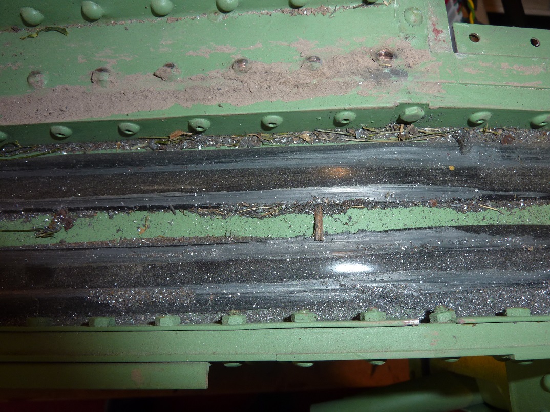

There is, of course, a lot of crud. But surprisingly little wear:
The drive chain is incredibly floppy - no wonder it was skipping ! The solution is to loosen off the bolts securing the motor, drop the motor a bit to tighten the chain, and then re-tighten the bolts. Fiddly work with a long-handled Allen Key in a confined space. I hope Mark is right to say that you only need to do it once !

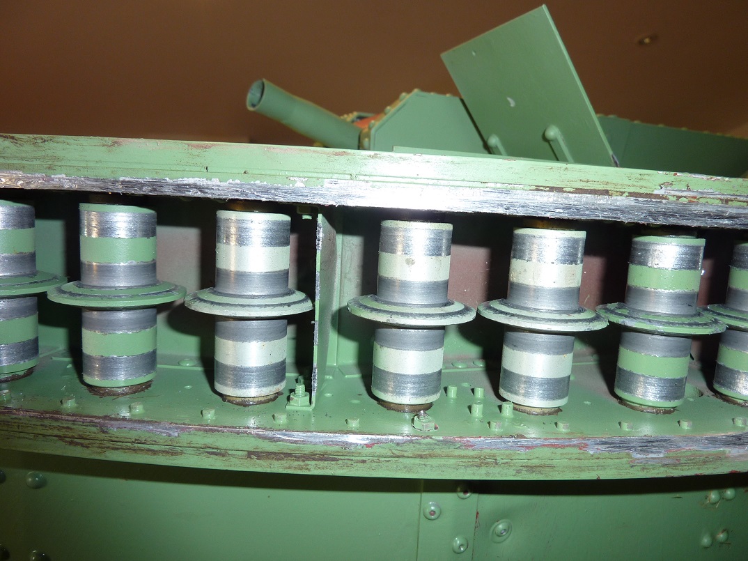

Surprisingly little wear. Paint has, of course, been worn off, but the metal is bright, with no obvious sign of pitting or other corrosion. And the rollers all spin easily - in fact, probably more easily than when they were originally put in !
There's very little pressure on the top. Most of the crud is carried around the tank (hence the 'bird's nest'). The plastic strips (largely, I suspect, to reduce the sound of the tracks dragging over the top) are still intact. The only obvious wear is to some of the rivet heads on the side of the front cab and rear roof, which have been flattened a bit as they're under the track edges.
The track chains are fine. Some of the track plates have buckled a bit from going over rough ground, but the tarnishing is surface only. The only work required is a wire brushing to get rid of loose crud and some bike chain oil for the track chains.
This one intrigues me. The lines of crud, and the lack of wear to some of the teeth, suggest that the track chains go round more like 'four sides of a square'. It doesn't seem to be a problem - just an odd effect.

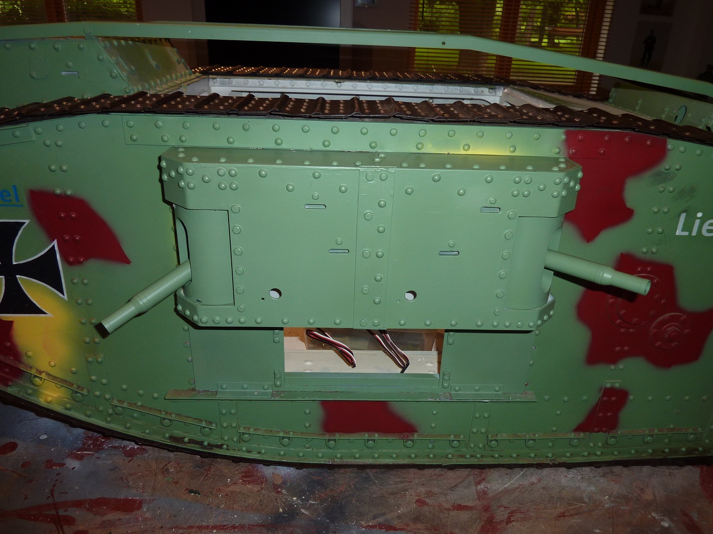

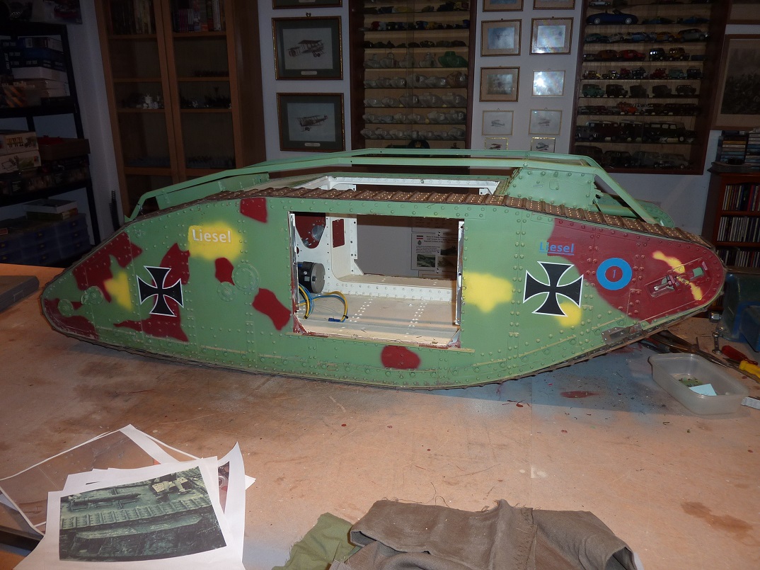

The sponsons are easy to remove - they're only held on by a few cap bolts. Liesel looks a bit forlorn now ....
It did put me in mind of a postcard in my collection:
(Although, from the exhaust plates on the roof, this is either a Mark I or a Mark II, probably being stripped for use as a supply tank).
Perhaps I should have posted this in the 'Real or Fake' thread !
My replacement sponsons are already coming on nicely (just some rivet holes to drill into the top plates) so that shouldn't take long. Then I can start to think about all those servos and LED's. And, of course, I have the old ones as painting guides.
Tightening the drive chains, though, is a different matter. Getting an allen key into such a confined space may not be practical. The right-hand motor is even more precarious, as the whole assembly has worked loose (although, as a benefit, the drive chain is a lot tighter !). Therefore I'm considering a variant of Oliver's solution of drilling through the outside armour level with the cap heads. The holes can then be filled with a very flat grommet which, fortunately, will largely be covered by the big Iron Cross at the rear. So, over the weekend, I'll be in the position of measuring (several times) before drilling (once). The upside will be that any future tightening can be done with the tracks in place.
Fortunately I have Flaming Fire II's internal frame to refer to !

The new sponsons look good, and work well. They're now far more historically accurate, with the revised viewing / pistol port layout (see my earlier posts, if Photo****it will let you ) and a row of rivets around the top plate. But, from a modelling perspective, the drums now swing smoothly. This required an awful lot of refinement, with several disassemblies to file another piece down just a little bit more .... even some of the glued rivets needed to be cut down as they were jamming against the drum. Then I fitted Adrian Harris's new Lewis Guns, which look superb (and, of course, there's a lot more of them than on Steve Stuart's Male !).
'Wiggly guns'

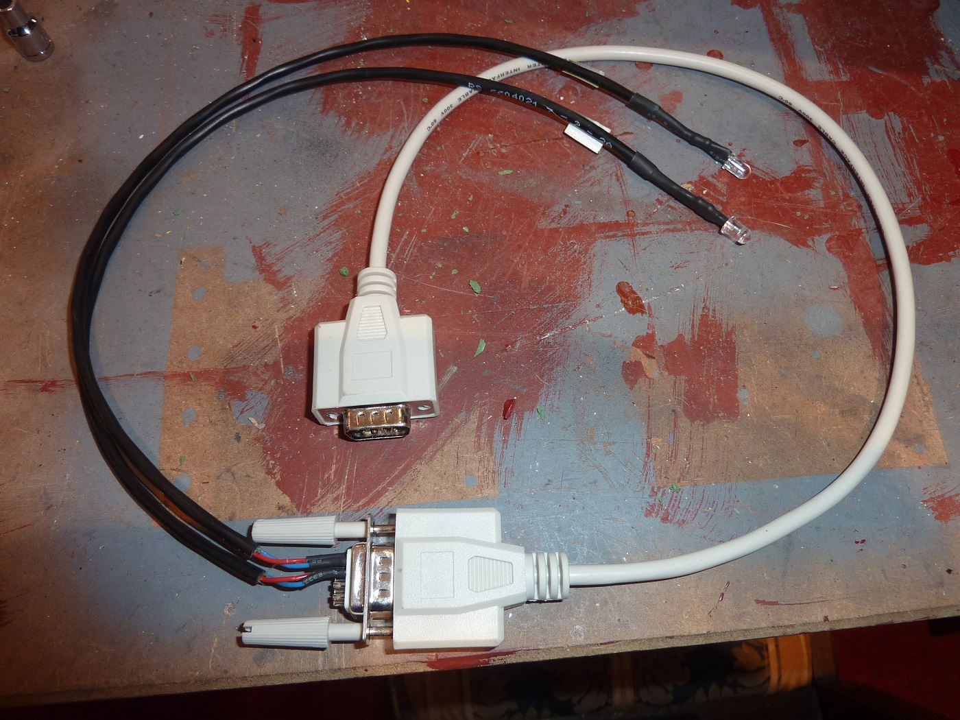

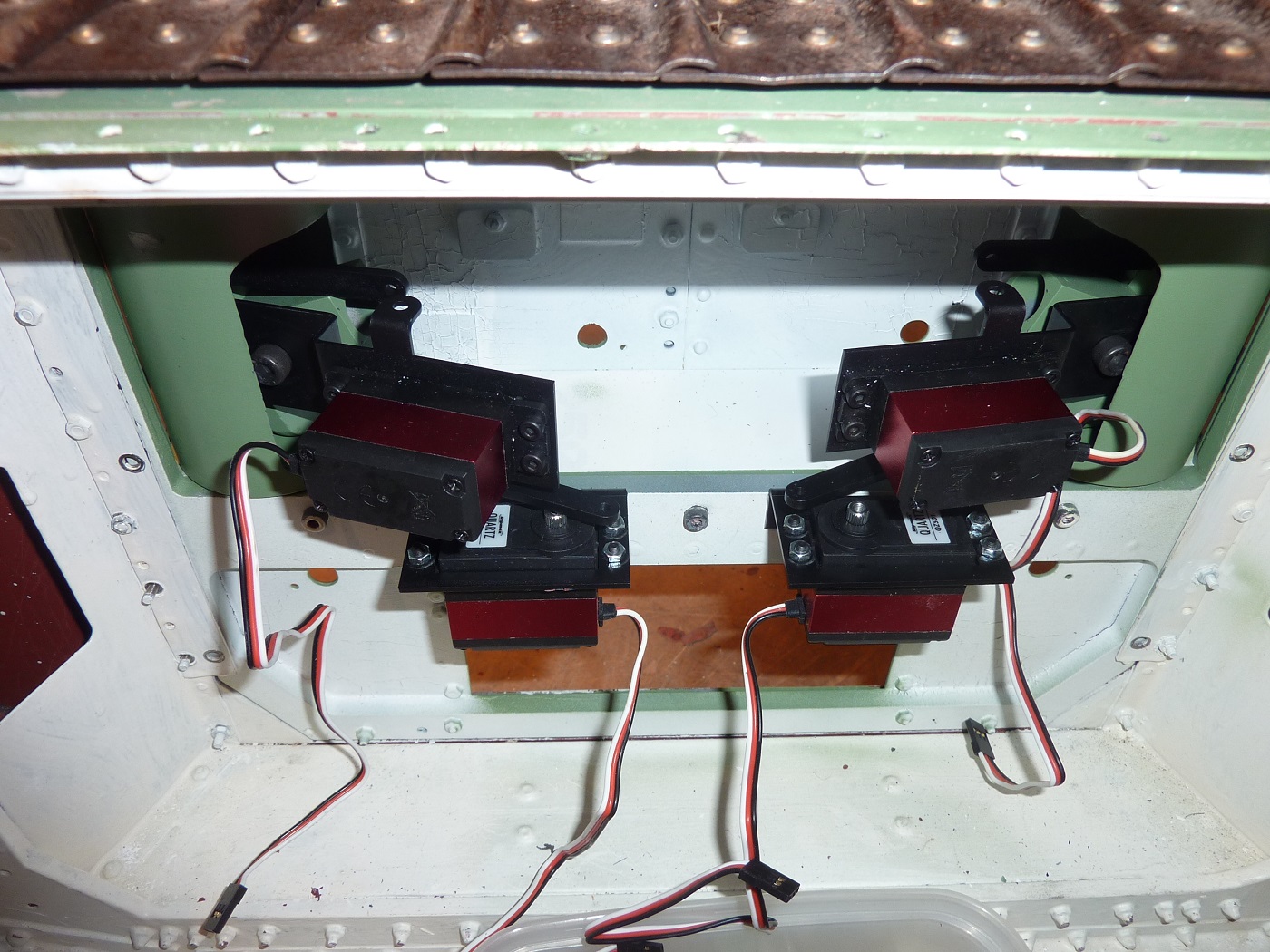

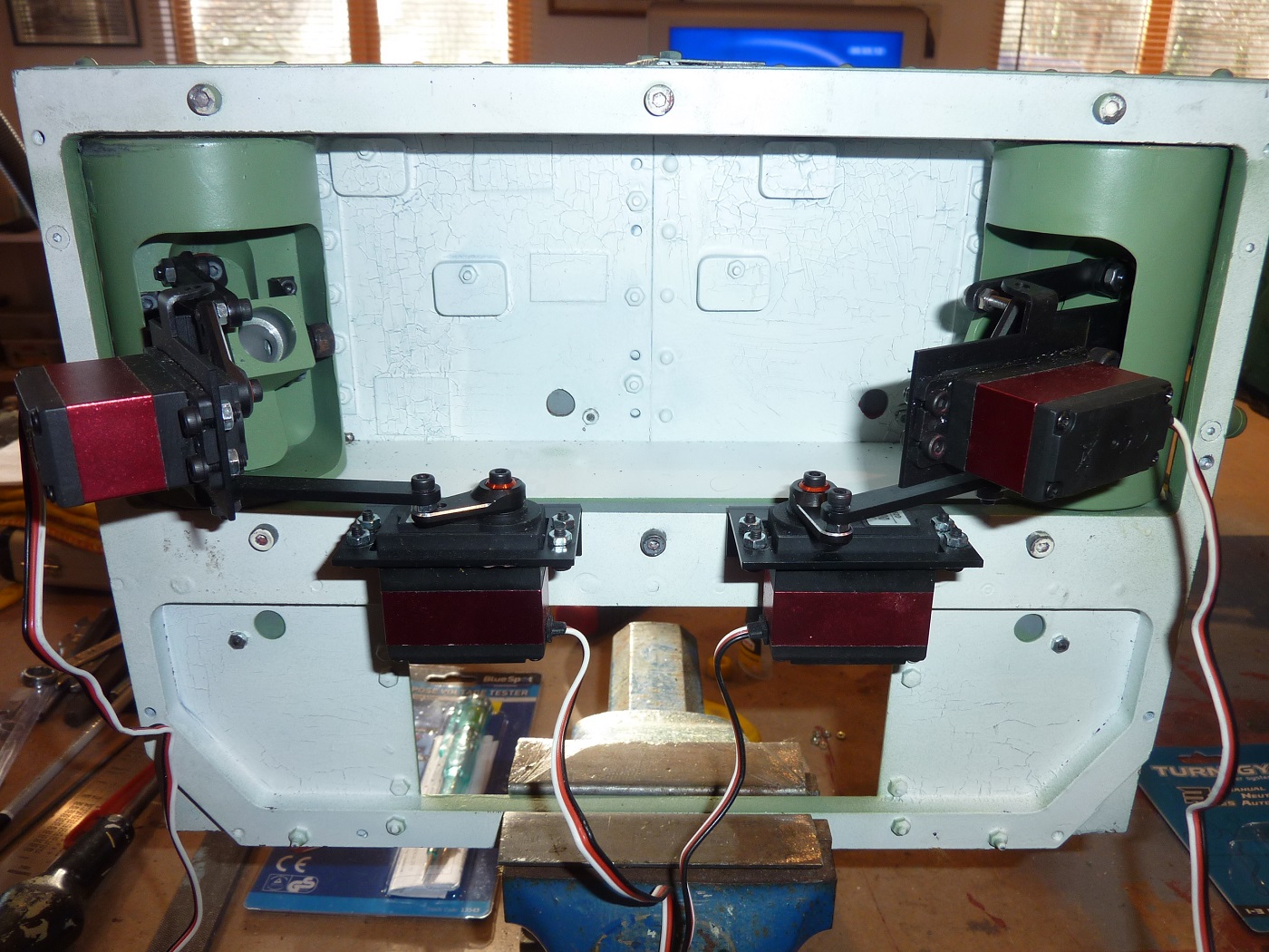

Then, finally, I got down to the 'wiggly gun pack' that I got from Gill over a year ago. There are 9 servos in there ! 2 for each sponson Lewis (ie. 4 per sponson) and 1 for the Commander's Lewis in the cab. The instructions are relatively straightforward, but it's not entirely clear that the con rods have an M3 hole at one end and an M4 at the other, so check carefully before thread-locking. And I found most of the nuts and bolts I needed in a pack quaintly named "Other Fasteners (21 pcs)". But it all makes sense if (as usual) you approach it slowly and methodically:
There is a problem, though - the servo and LED leads are too short for where I want to put the control box. The servo leads are a relatively easy fix (now that Adrian has pointed me in the direction of Hobbyking, that is ), but the LED's are a bit more of a problem as they use d-sub connectors - Adrian and Steve are working on that one.

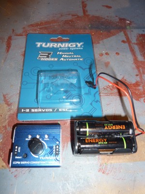

Well, I’ve been running Liesel around without any problems, so the tightened drive chains certainly work (no more 'clicking tracks syndrome' - hurrah !). But I’ve only just got around to working out the servos and wiggly guns ......
I mentioned that the servo leads are too short (well, I suppose it depends on where you put the ‘wiggly gun pack’). Extending the servo leads proved simple, once Steve Stuart and Adrian Harris had pointed me in the direction of Hobbyking and the Component Shop. Ten 12” Futaba leads for £8 including p&p – can’t be bad. One for each servo, and a spare. The problem was with the LED’s, which fit to a d-sub plug. Again Steve came to the rescue by supplying the extension cables that you normally see on computer printers !
So everything worked, but I still couldn’t figure out how to adjust the servos. And then Steve came to the rescue once again (a constant theme throughout this build – I’m truly indebted to him) by telling me about a wonderful little gadget called a Turnigy Servo Tester (other manufacturers may be available, I suppose ), available for around a tenner from Amazon or other suppliers. A life-saving little gadget, for evermore known to me as the ‘Turnigy Thingy’. Next to no instructions, but it’s pretty straightforward – centre the servo (the neutral setting), work out the mid-point of the thing you’re fitting to the servo (machine gun or drum), connect one t’other using the servo arm, then run the automatic setting a few times to make sure it all works – if not, tweak a bit until it does.
I found out that I hadn’t followed the instructions perfectly , in that I'd fitted some of the machine gun con rods the wrong way round. I bodged my way round this by using longer (M3*16) bolts between the con rod and the servo arm, which hasn’t created a problem (yet).
The only thing I would say is that I can’t see any way of easily doing this with the sponsons in place ! So I popped them off again (for the umpteenth time) and held each one in the bench vice while getting the servos set up. It’s all pretty straightforward when you know how.
So, basically, I think I’m there. This weekend’s job is to put Liesel back together again – refit the sponsons and reconnect all the electricals. Then some paint touching up, new Iron Crosses on the rear horns, and I’m done (for the time being). If it all goes that smoothly (it seldom does !) I’ll try and put up a YouTube video of all the guns moving and flashing. Fingers crossed.

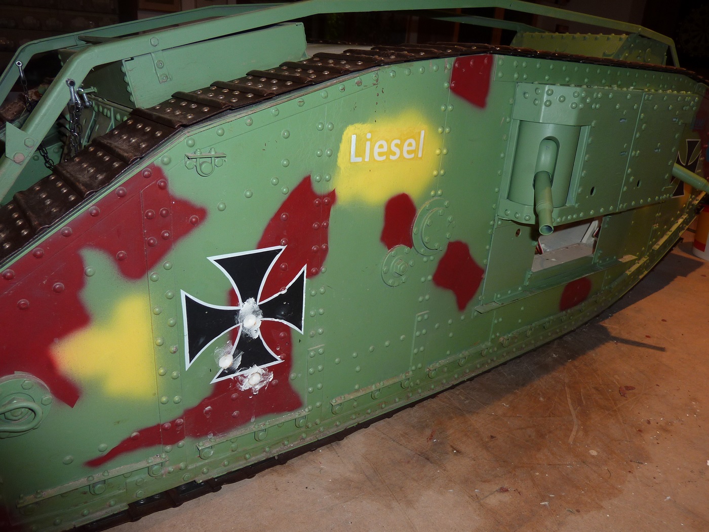

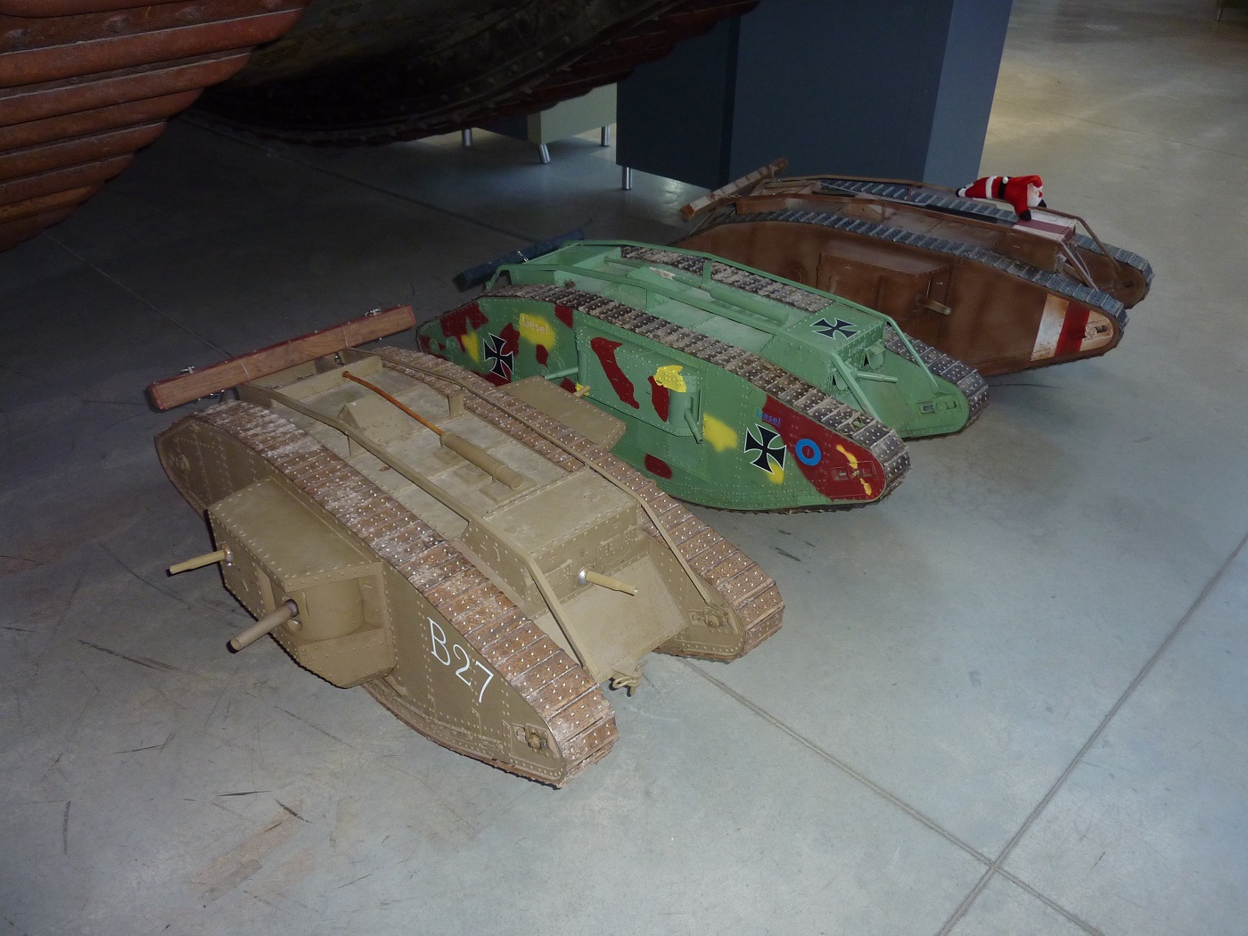

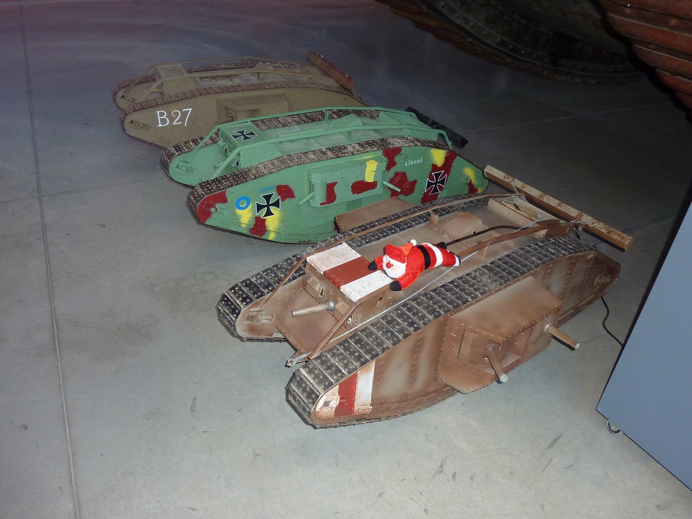

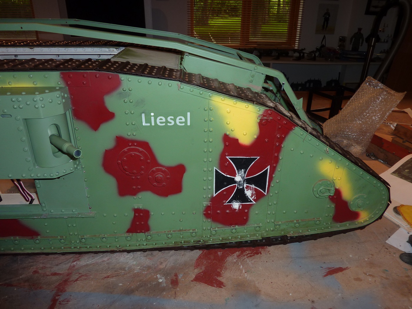

Well, Liesel is now back together, with fresh markings, tightened tracks, corrected sponsons, more realistic gun barrels (thanks, Adrian !) and a working 'wiggly gun pack'. I took her down to Bovington yesterday for a meeting of the Southern Armour Group (down, Denny ! Down !) in the Tank Story Hall, which gave me a chance to drive her over to the 'sacred ground' beside the Mark II to shoot a video:
And I was joined by Steve (with B27 Bloodstone) and Brian Clay (with his unnamed Mark IV Male in 1918 colours), so there were three Armortek Mark IV's together under the front horns of the Mark II all with guns firing away:
Brian took a video of it, which I hope he'll share (bound to be better than mine !).

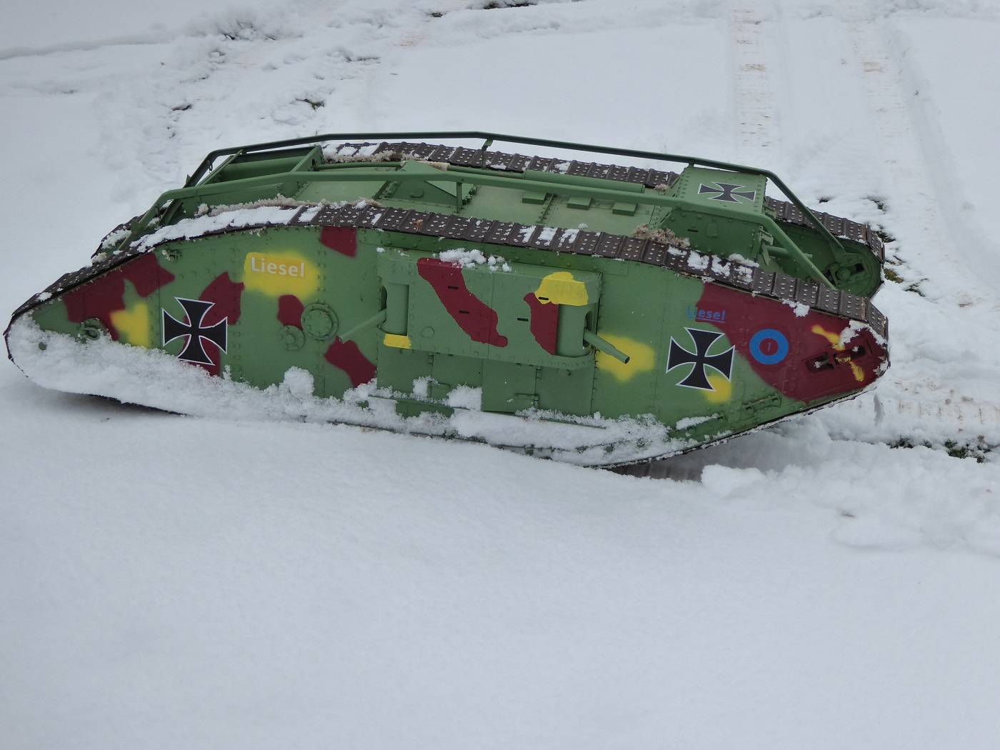

I wasn't able to enjoy the first visit from The Beast at the end of February, as I'd just got home from emergency eye surgery (thanks to all of you that have sent good wishes). But The Beast has returned, there's a good 4 inches of snow on Salisbury Plain, and I have one good eye, so there was no way I was going to miss the chance again ........
And my lovely wife took a video:
Chances like this don't come along very often in the south of England, so it would have been a crime to waste it (health issues notwithstanding).
Enjoy !

Going back a bit, to when you had the tracks off Liesel, you made the comment:
Do you think that is because the drive sprocket has been chosen with an even number of teeth (20?), so the chain always meshes with the same teeth, whereas an odd number of teeth would ensure that they were all used evenly ?

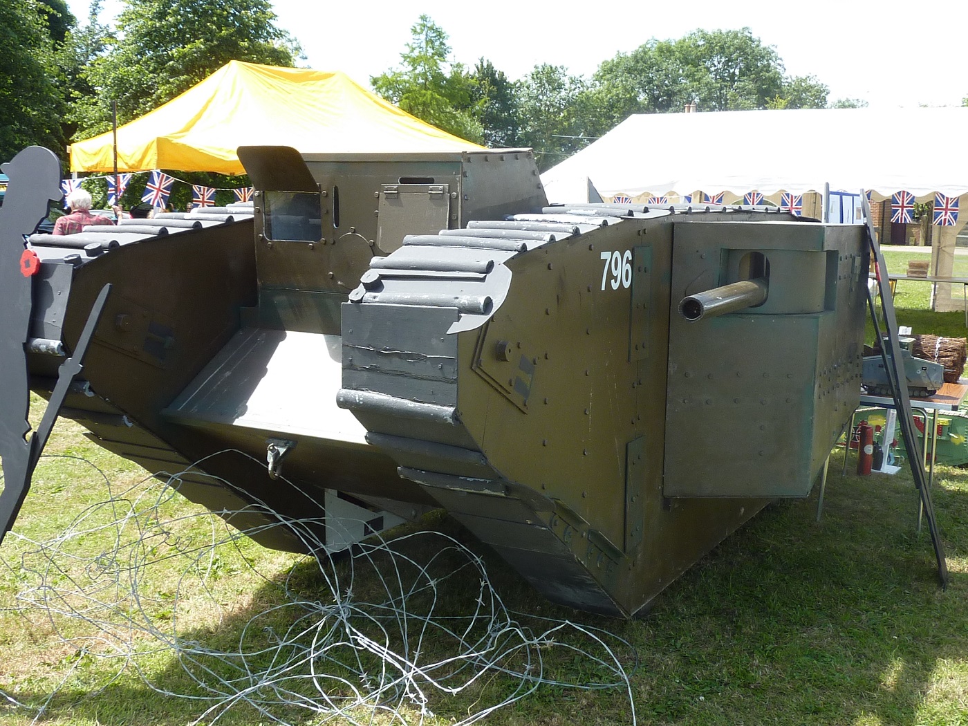

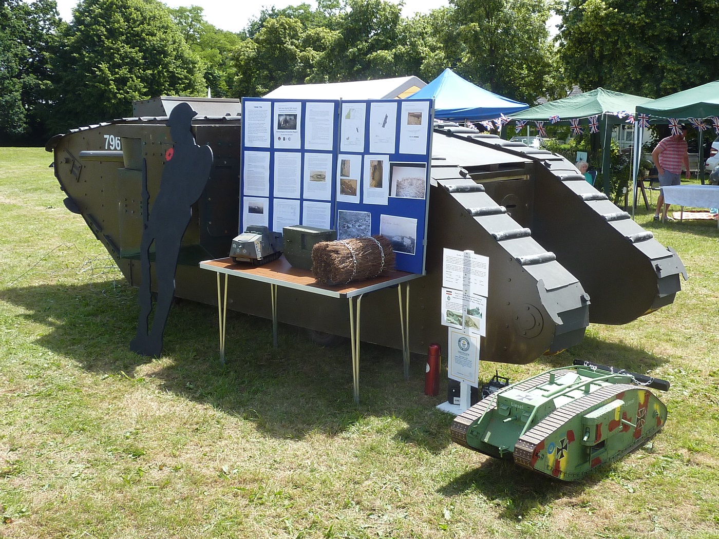

Those of you interested in WW1 archaeology may be aware of the ongoing 'dig' at the presumed site near Bullecourt of Mark II Male 796. This tank was knocked out while supporting the Australian attack in April 1917. The attack didn't go well - indeed, the Australians mistrusted tanks thereafter, and didn't really learn to appreciate them until the Battle of Amiens on 8 August 1918.
796 (or D23) has the reputation of being the most photographed tank on the Western Front, as the Germans used it as an MG and Observation Post for the rest of the War. Athough the tank was broken up sometime after the Armistice, the team are finding fascinating remains still left behind, including the bodies of two German soldiers who have now been given proper burial. More information can be found at http://www.breakinggroundheritage.org.u ... -of-arc-17 and on their Facebook page.
As the dig is funded by the Heritage Lottery Fund (like Tiger 131), the team are required to do a number of Public Displays, which include a 2/3 scale display tank built by disabled ex-servicemen supported by Help for Heroes. The tank is actually kept by a friend of mine in our village - he told me it was going to be on display at a neighbouring village fete, and suggested I might like to bring Liesel along. Well, how could I refuse ?
When I got there, I found the tank, a notice board .... and nothing else. The (Army) chap who had requested it was busy running the fete, so he asked me to run the display for him. Poor deluded fool had me pegged as some sort of an expert .....
Anyway, it was a lovely afternoon, and I had a fair amount of interest from adults, some of whom had even heard of Armortek. The children, of course, just wanted to see Liesel running around. And I brought along a few extra bits, like a Male sponson, one of my new fascines, and a 1/16 scale r/c A7V I recently picked up (it would have been rude not to). So here's how the display looked:
And there was a fly-over of this .... which was nice.
A nice afternoon, a good bit of PR, and strengthened links with the local Military.
All the best,
CHris
