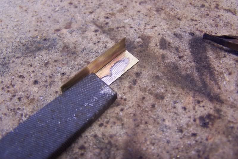

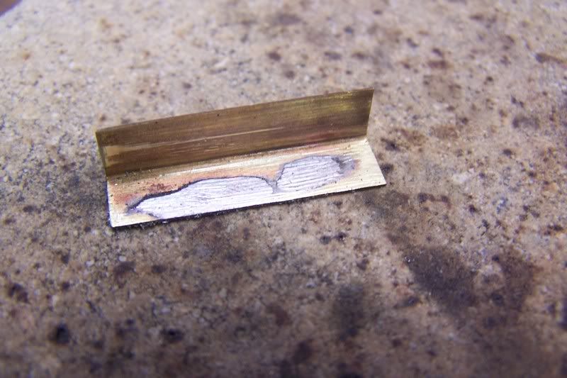

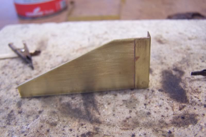

Once it has cooled .. File flat , so as to leave a thin layer of solder .

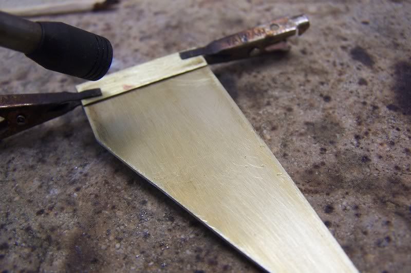

Re clamp the parts and add flux to the other part .
Dale jordan
Posts: 1460
Been liked: 525 times
Post by Dale jordan »

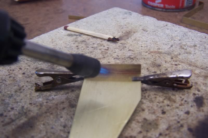

Now re heat with torch
Dale jordan
Posts: 1460
Flip over and bring heat to the other side . You will see the parts sweet togerther

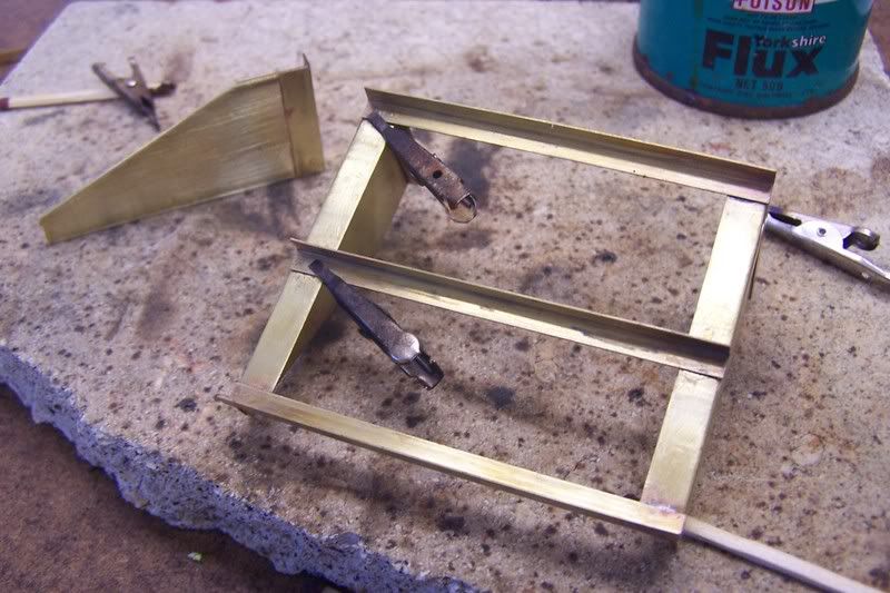

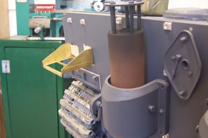

Here is the finished part with no mess
Dale jordan
Posts: 1460

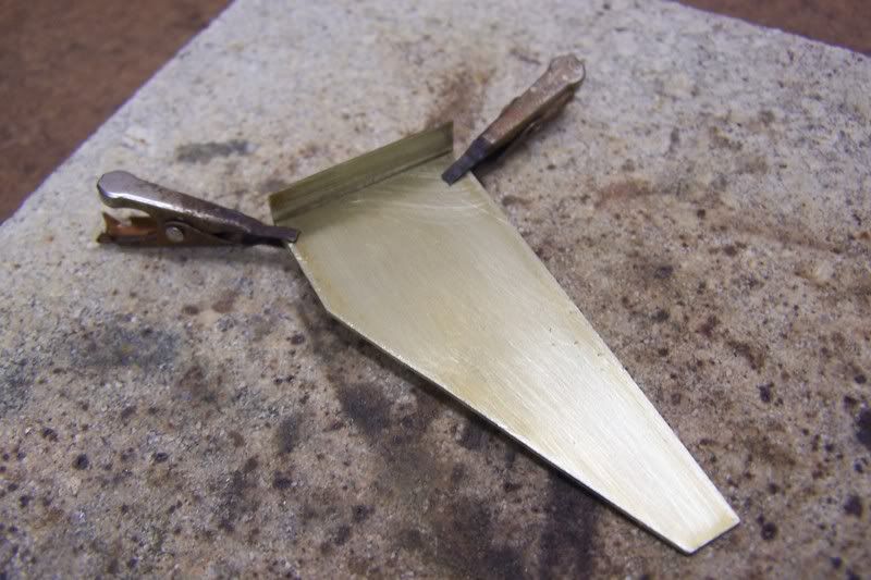

Do the same with the cross peaces . If you have problems with heat un doing some of your work next to the part you are working on , use clamps on them as well or use wet cloths . I hope this helps the best thing to do is to pratice on some scrap . Dale
