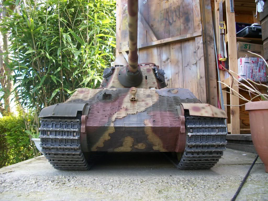

hi gary i am currently applying a zimmerit finish on my k.t. i have been using bathroom waterproof tile adhesive mixed with p.v.a. glue and water, quick, easy, the paste when mixed gives you a long time to play around with the finish, and goes off like rock, once cured give it another coat of p.v.a. glue the consistancy of milk, then let it dry, just my method if it helps, mike stannard zim tools are a must if you can buy or borrow them. regards simon manning.

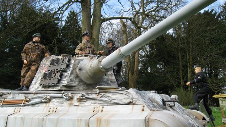

Hello Gary.
As Lee has said Milliput is the most widely used and I find the best and most hard wearing for our tanks.
I have gone over the methods I use a few times on here if you want any hints or tips please don't hesitate to contact me via e mail or P.M. or you can check out my facebook page for tips and loads of photos of various stages from start to finish.
Hope this helps, cheers Paul. :wink:
