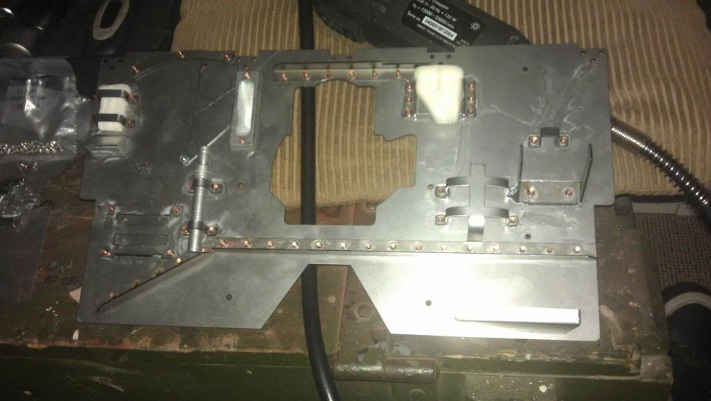

Here's my little package :D
I'm not gonna count all the rivets.. lol
Has liked: 1495 times
Been liked: 1699 times
Re: Leon's 25 pounder

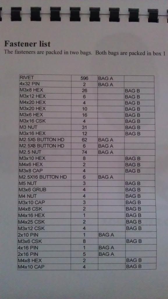

Lucky chap :D
596 rivets :shock: That's going to keep you quiet for a while :lol:

Yep, 596.. and I need more for further detailling :lol:

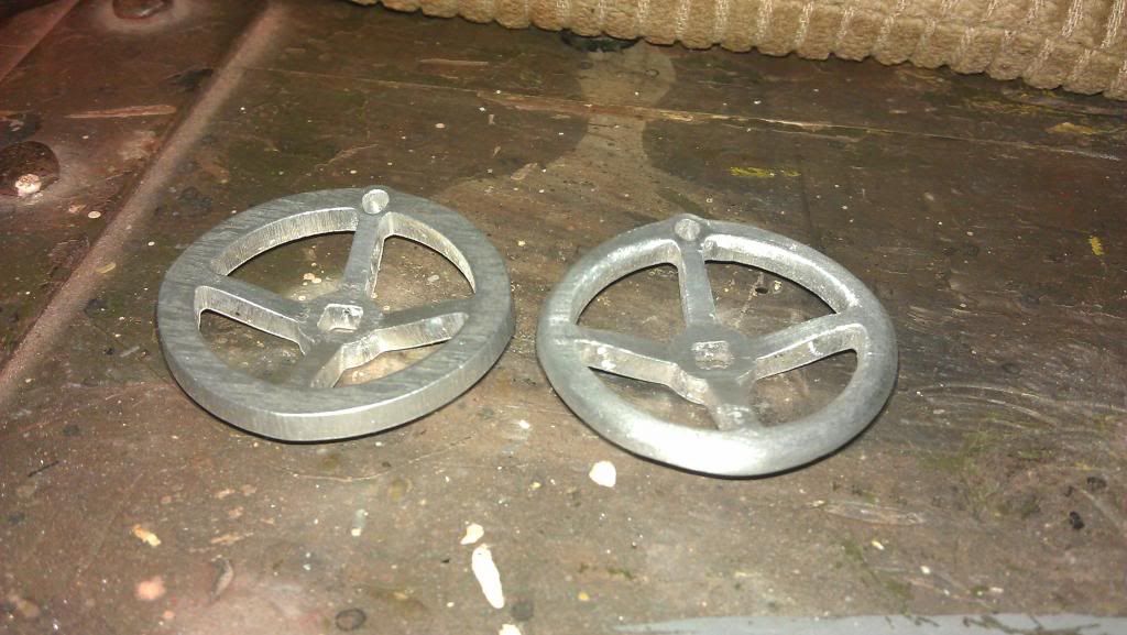

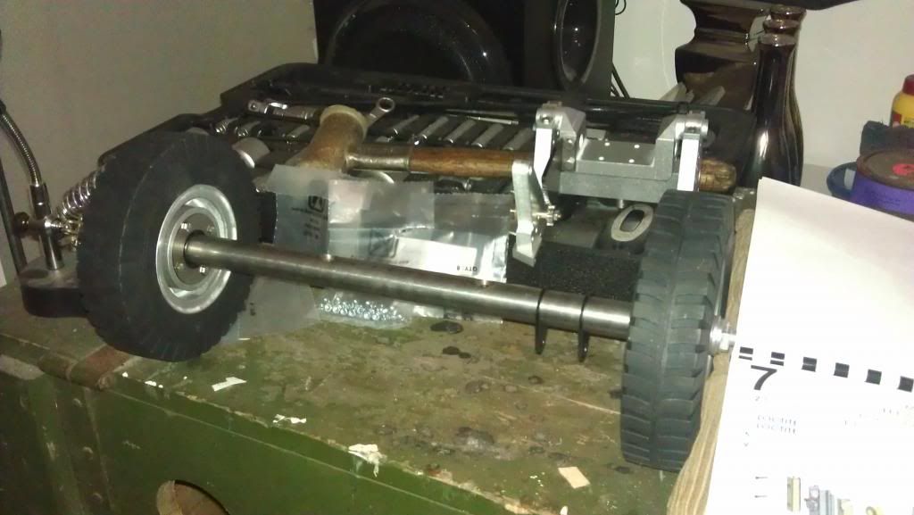

The rims wont fit.. the tires are too thick I guess, how can i fix this?
The halves should fit nicely on eachother, but there's a gap.

Hello Leon
I'm afraid you just havn't used enough force. These rims fit just right, compressing the rubber tyre just a tiny amount and clamping it firmly in place. Apply adhesive and use clamps or a heavy weight while it cures. It's really very easy.
Remember it is always best to ask us by e-mail as a first action, rather than broadcasting it on the forum.
regards

Im sorry Mark, I will E-mail in the future if I find problems.
As for the rims, on the picture, it was a dryfit.
I put a weight on it an now it has a tiny gap I can fill easy with putty. Thanks for the tip!

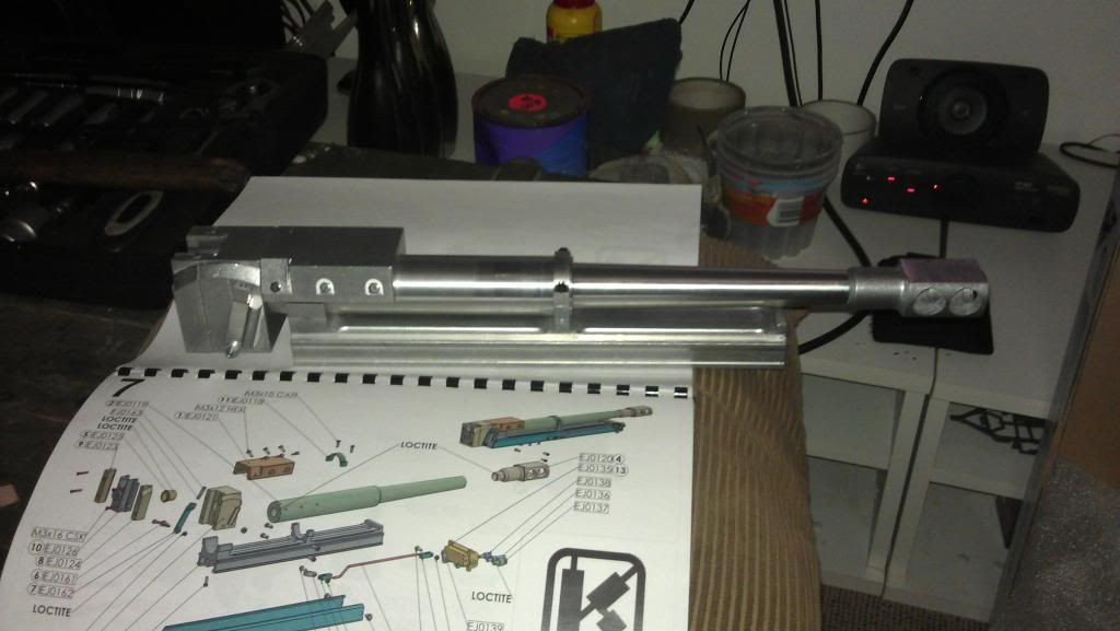

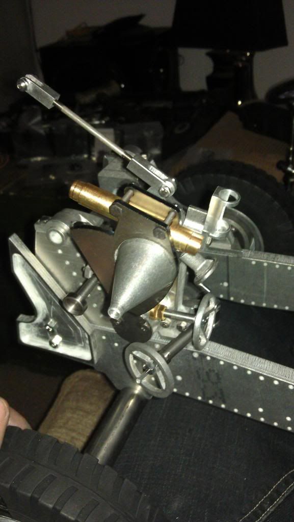

Dryfitting time.
I do this to get the shape in 3d, so I can see how and what I can modify.
It's an easy kit, only the search for a type of small part, bolt or nut takes time.
After the full kit is complete (not entirely assembled, but just the things to see how it fits) then i'll start modding some things 8)
Luc De Weirdt
Posts: 128
Joined: Wed Aug 17, 2011 5:38 pm
Location: Belgium
Been liked: 16 times
Post by Luc De Weirdt »
Looking good, Leon! :D
Maarten Schutjes
Posts: 197
Location: The Netherlands
Been liked: 3 times
Post by Maarten Schutjes »
Already looking impressive

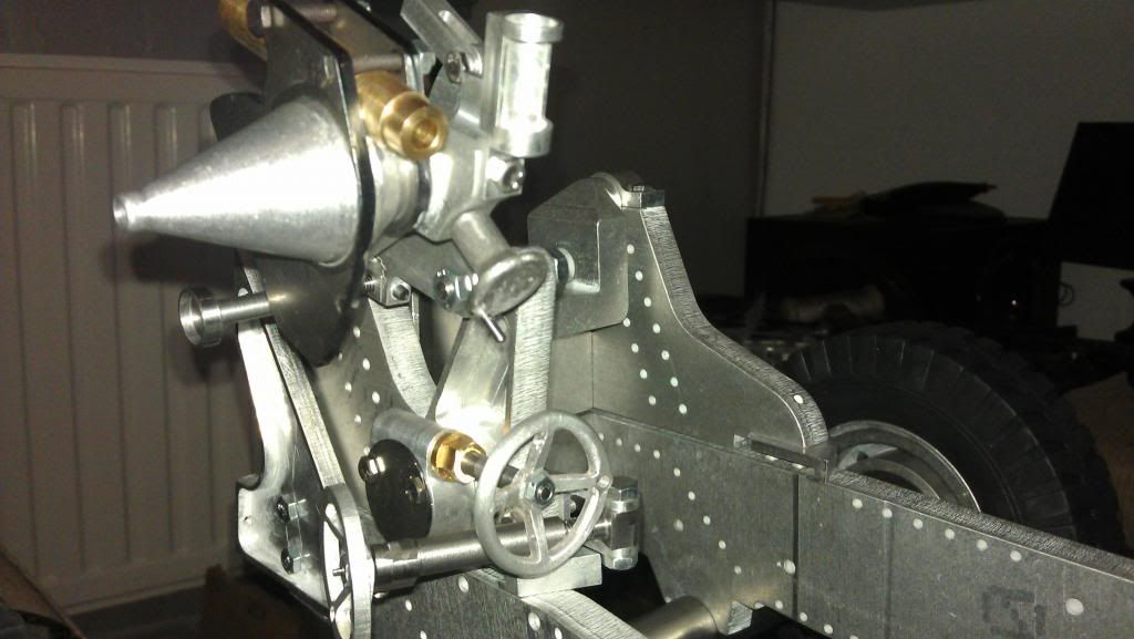

Making the model a bit lighter:
In a few weeks i'll be adding more weight :lol:

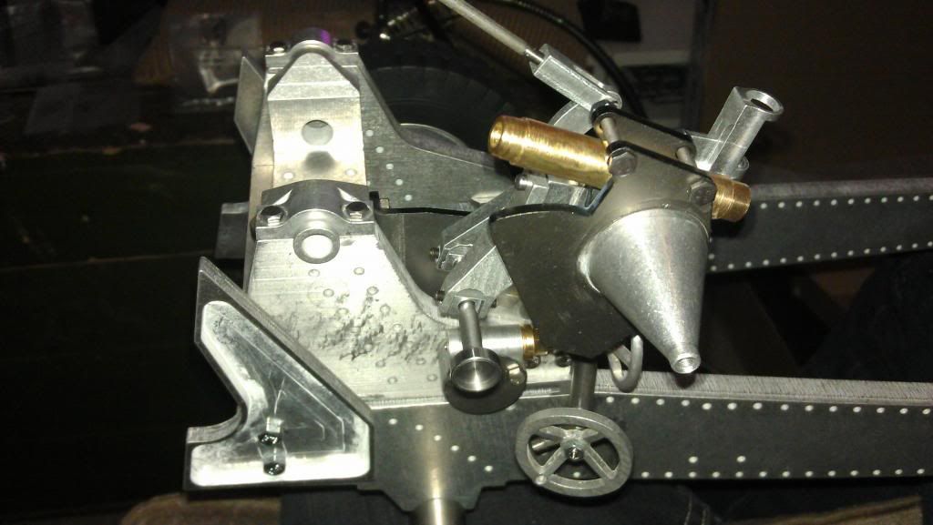

More dryfitting:

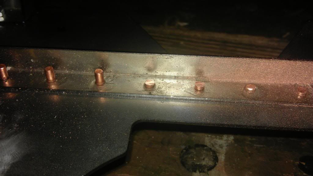

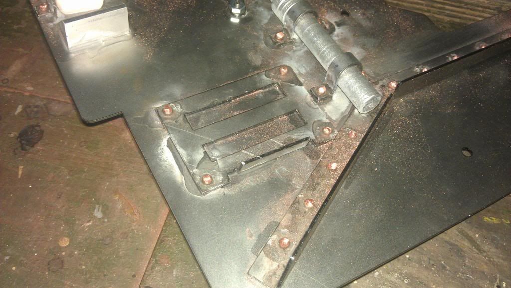

Shield almost done, need to cut the rivets and round them off on the back.
The drawing says it needs nuts and bolts, but I placed rivets instead, like the original.

Cutting time! Making the pins in the back look like rivets:
Added some extra glue, some came loose by the shaking of the dremel tool
