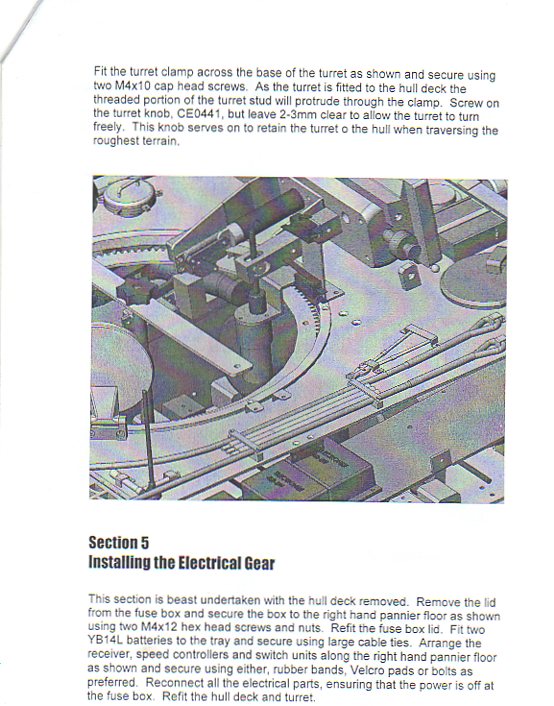

Another question for the knowledgeable of you out there, I purchased my 'mid' Tiger built and running, ish. It now runs, and I have a sound system that eventually after a little re-programing of the 7c, also works, my new question is this, everybody I have spoken to has informed me that this Tiger, from a build in 2003, was designed for a blank firing system, rather than recoil, but here is the thing, the instructions are most specific about how to assemble the gun, if you do NOT fit the RECOIL, and the option pack that the last owner purchased, also refers to the mechanism for recoil, although he did not buy it. I am confused as I want recoil.

This is what I am told, but there is no mention of blank firing in the instructions, or the option pack, only recoil, I have pictures as well!

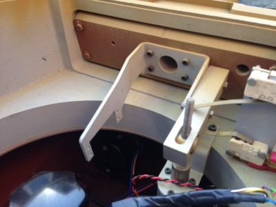

Ah Adrian, that probably explains a couple of things, I am uploading a picture of the inside of my turret, and the recoil mechanism, which is of course a facsimile, rather than an actual photograph, I am certain that I can make recoil work, if I can purchase suitable components.

I'm in the same boat as you here, William, with my 2010 mid tiger. It's also not recoil compatible, so we are on our own without any parts to rely on. The barrel is threaded on the inside, so my idea is to thread a tube to match and pass that through the hole in the mantlet and attach to a linear bearing, which, in turn, would be attached to the mantlet. All it takes is some threading in a lathe and machining of parts. Piece of cake!
Now, I don't happen to have the required machinery, which adds a dimension of complication...
