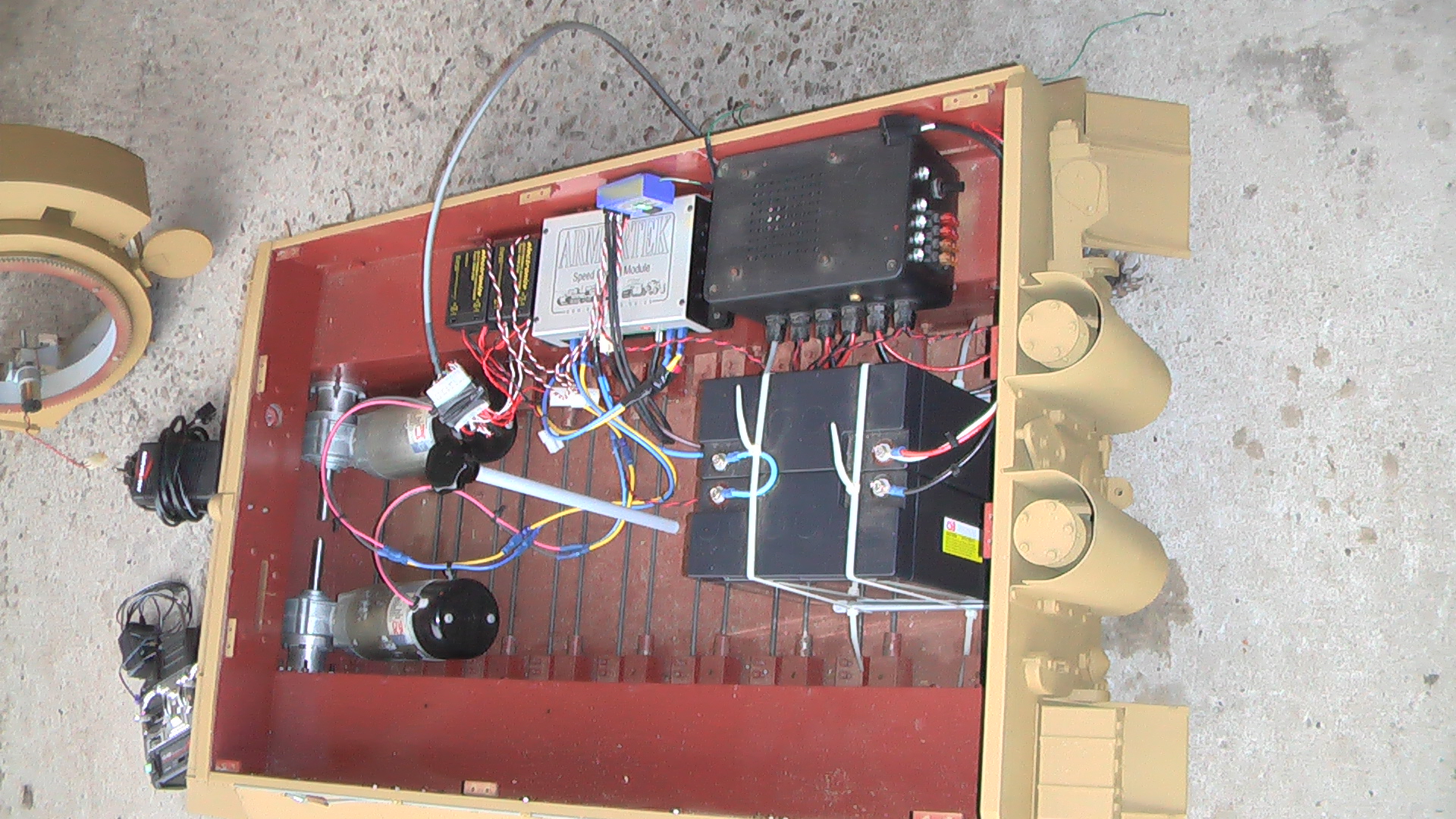

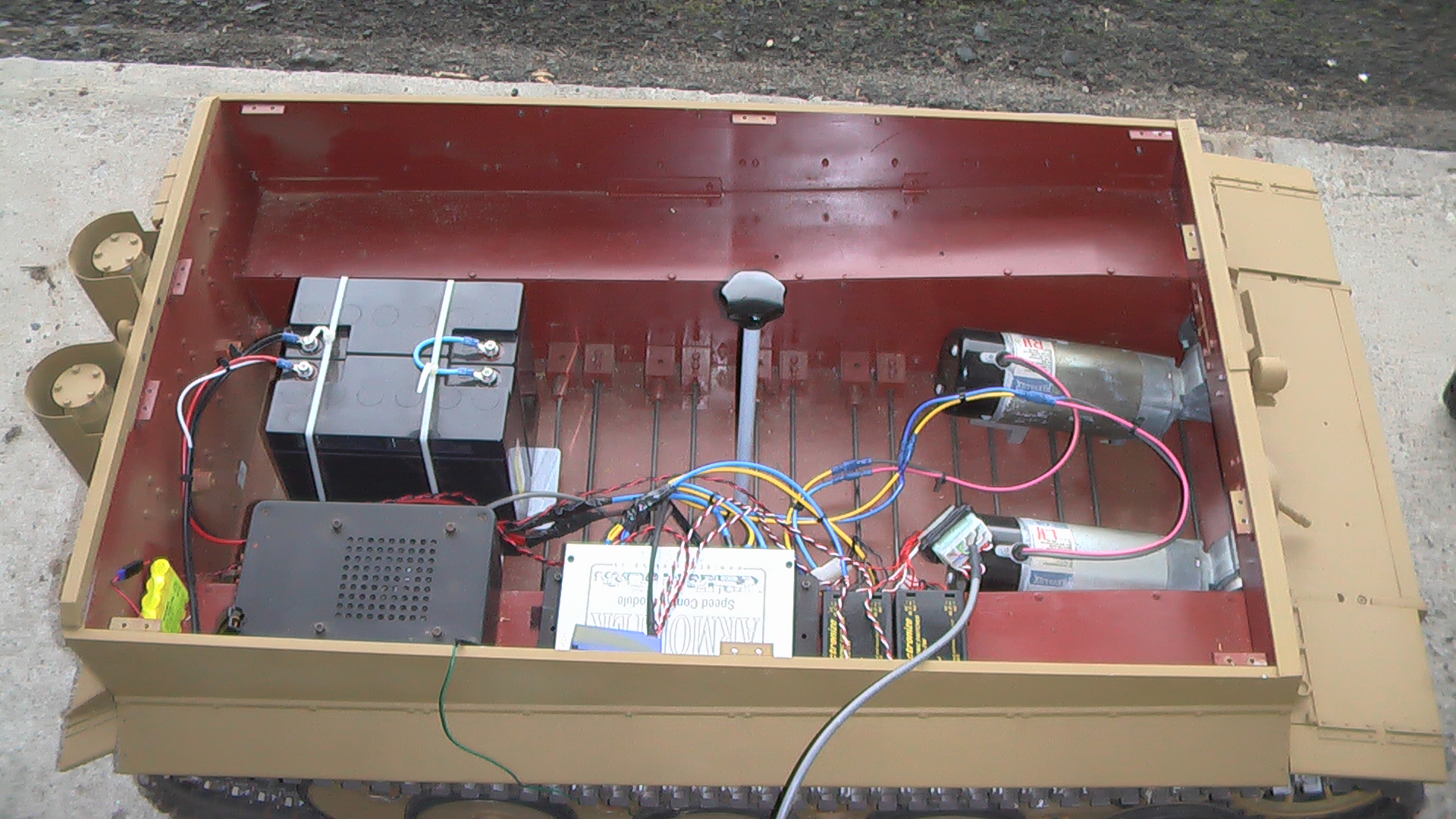

It may be helpful if you could post some pictures of the wiring for tank, so we can see how it looks now.

I already had the wiring diagrams, so I checked through and all seems to be OK, the turret now moves in one direction, but the limit switches on the barrel do not function. I would also like to drive it with one lever, is this possible with this R/C unit or should I upgrade? Any help and advice is very welcome.
